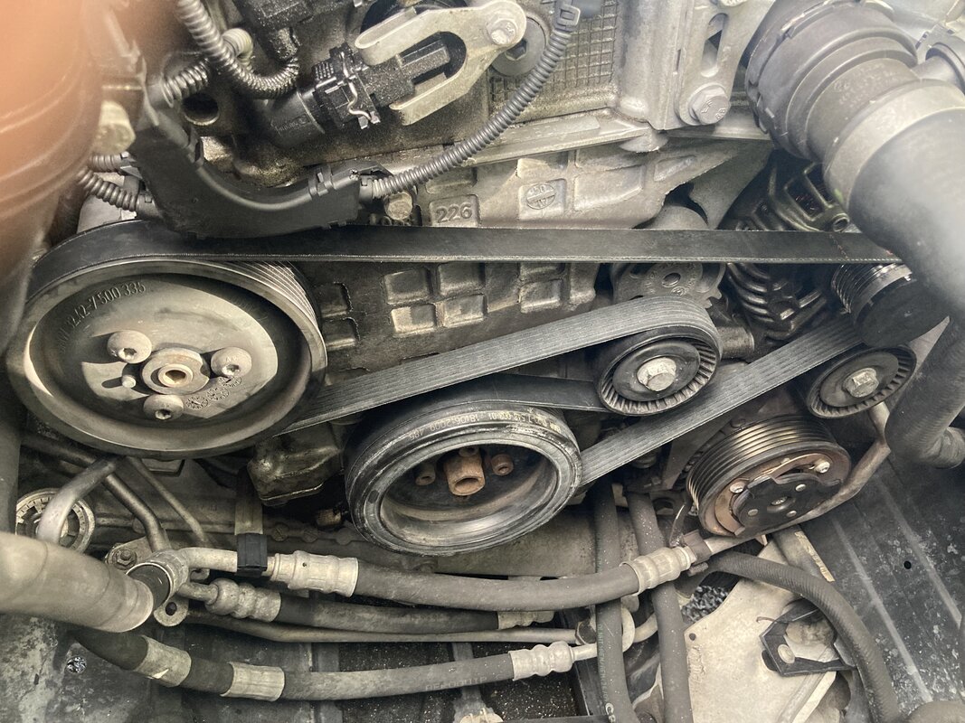

I'm in CPT, I just need the size of a shorter belt to fit, So I can drive the car while a I get the a/c compressor repaired.
holdenspecial
Hi all, not that it will help you now, but for future reference I measured up when my ac compressor died to get moving. You’ll need a PK6-1660 to bypass. Now to replace the pulley/bearing…
