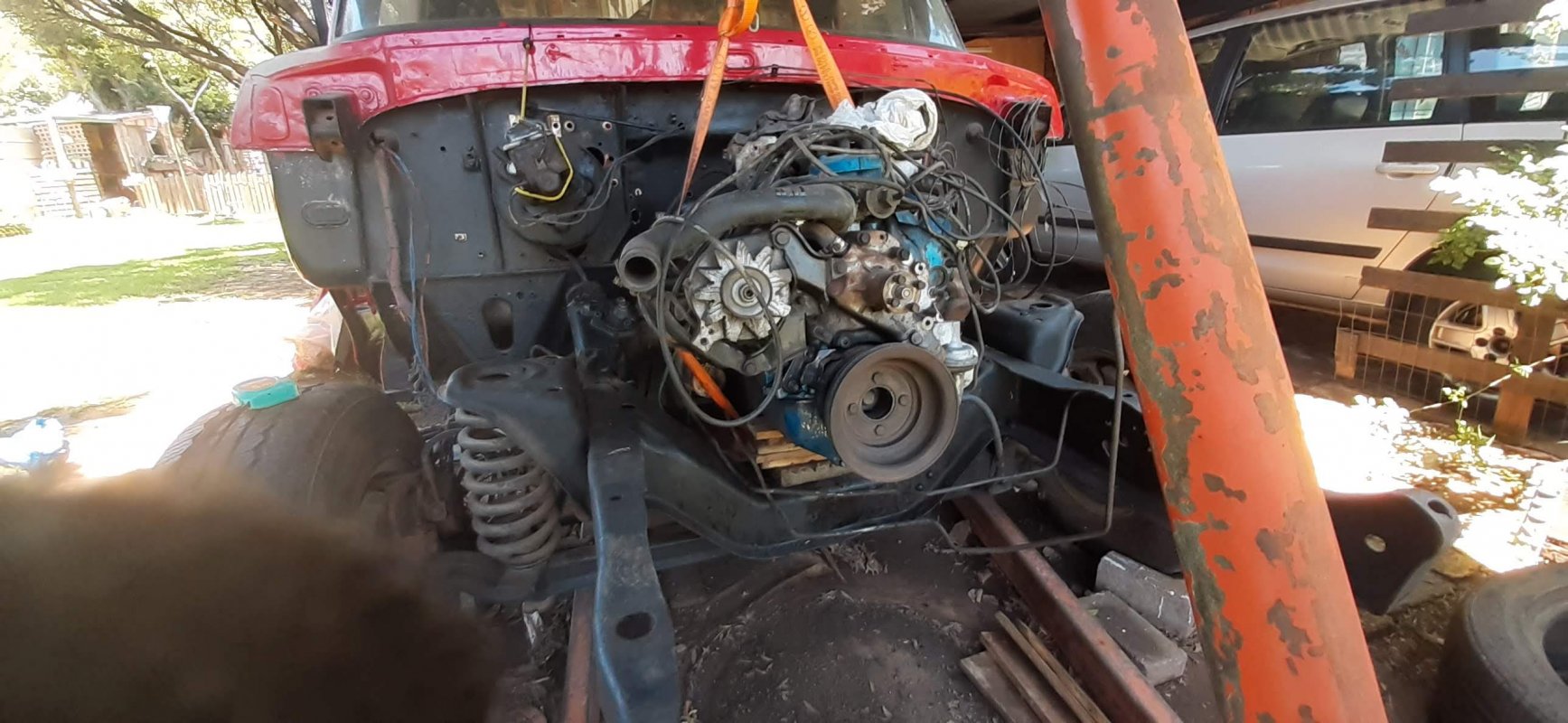

DonovanPorter

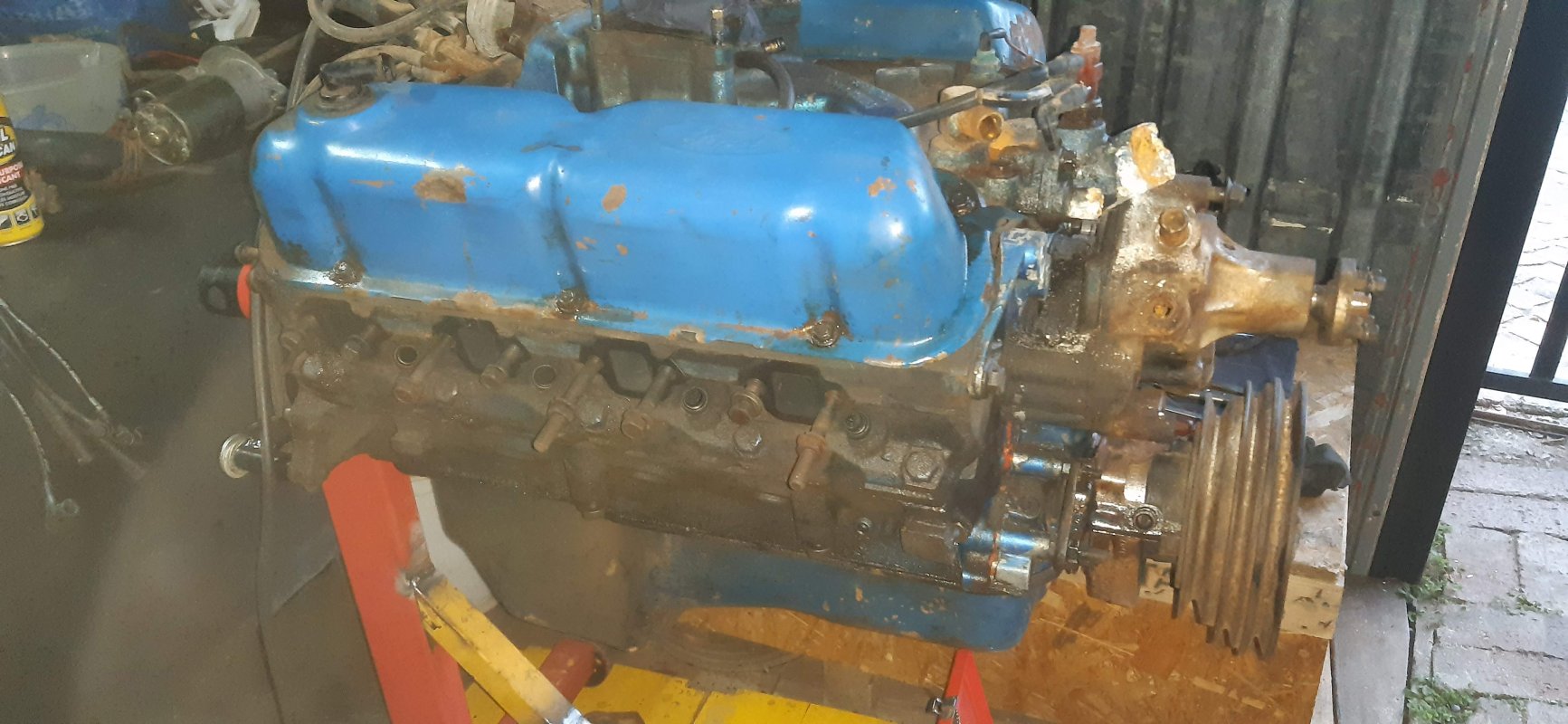

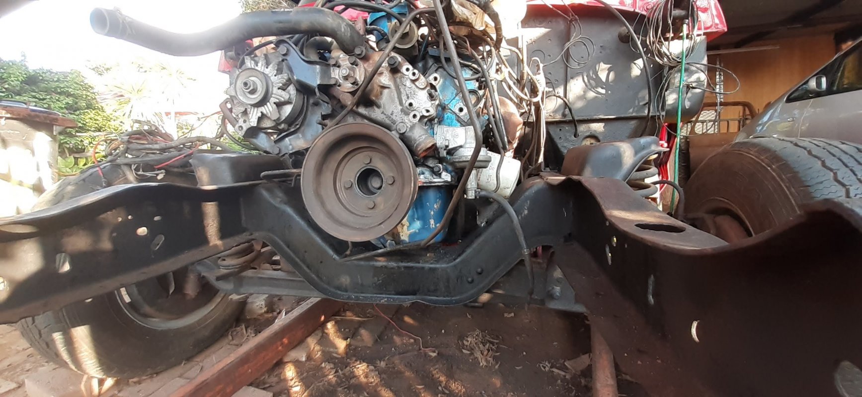

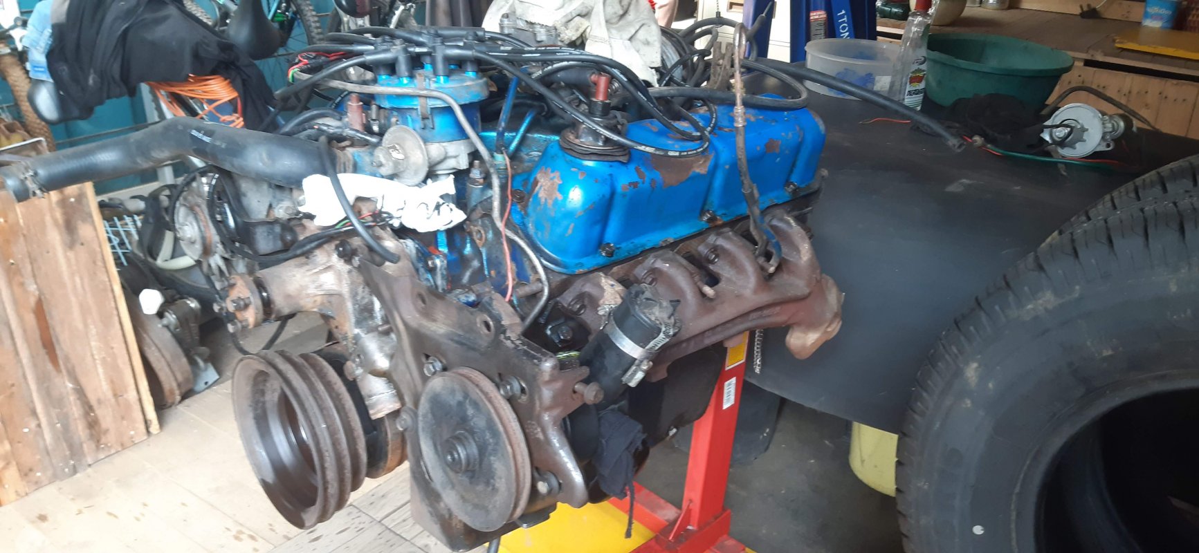

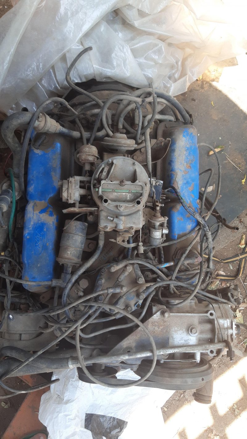

New motor and gearbox arrived (well new to me)
Windsor 302 with a 4 speed auto box, i am very glad i could source one as this was one of the motors these models came out with.
It will stand one side for now, now its time to clean up the chassis , get some new paint on there and spruce her up a bit

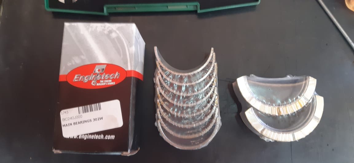

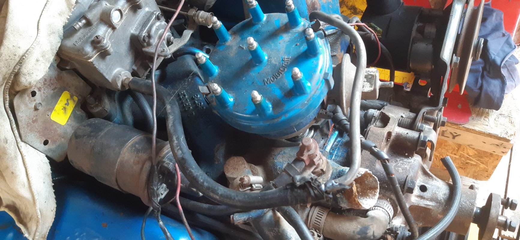

DonovanPorter

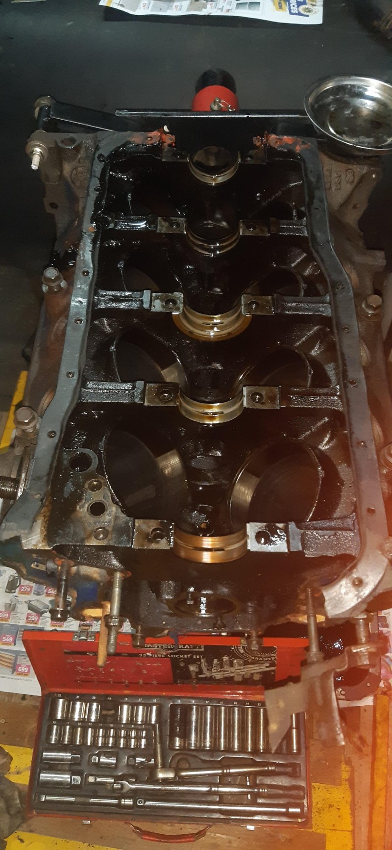

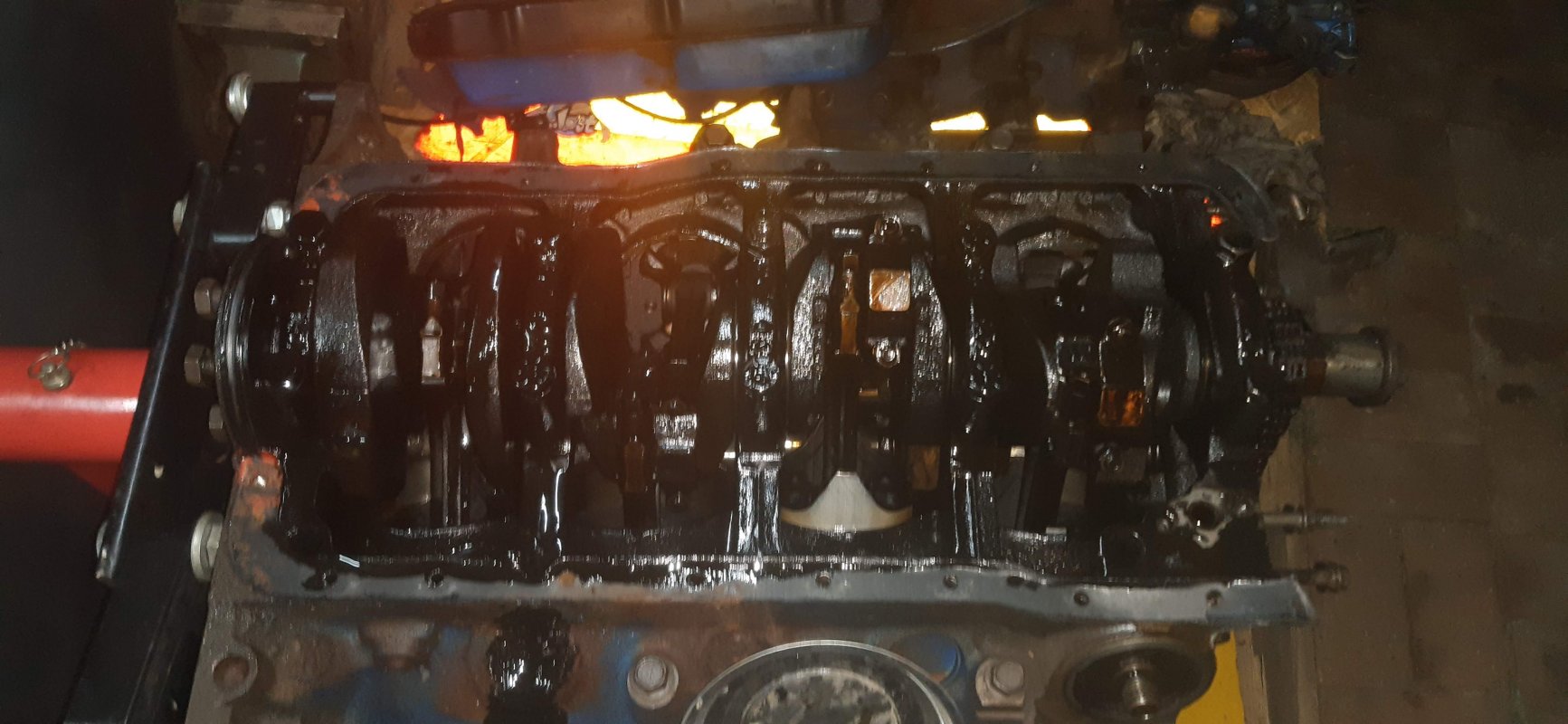

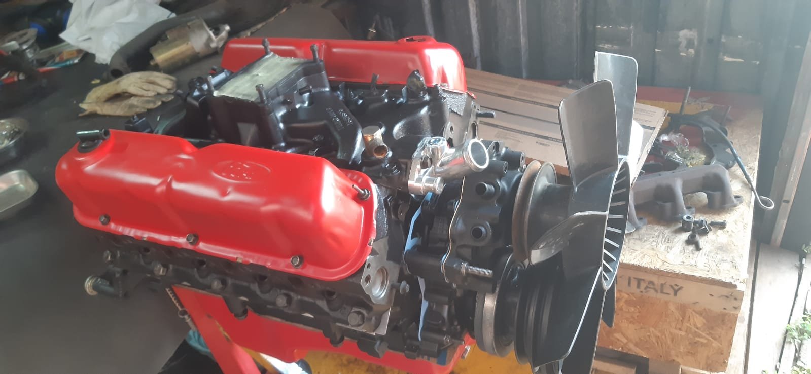

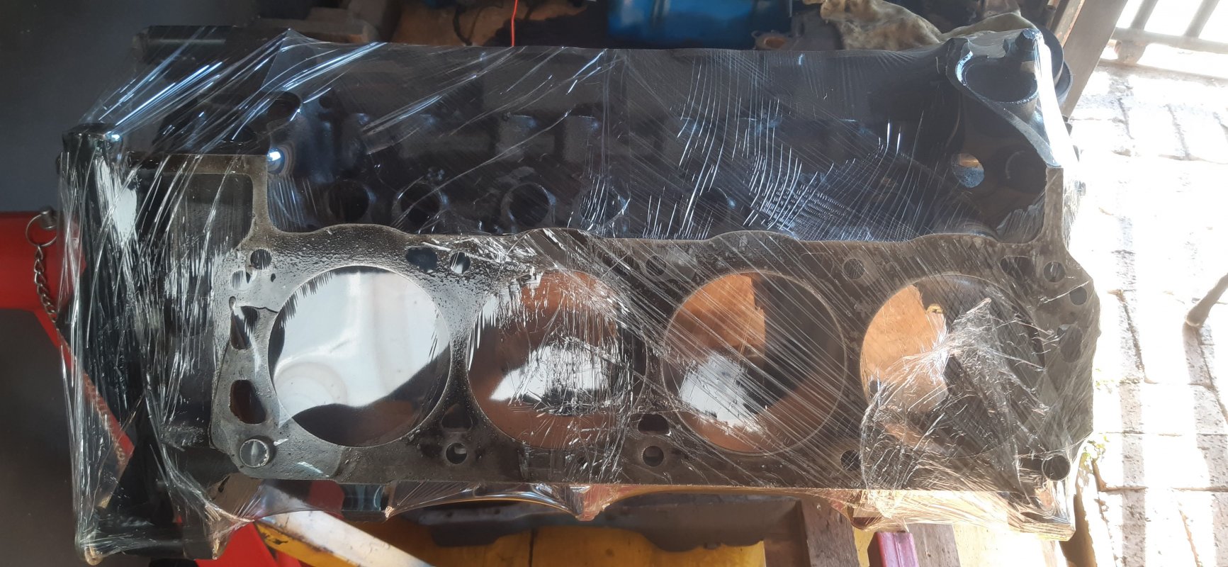

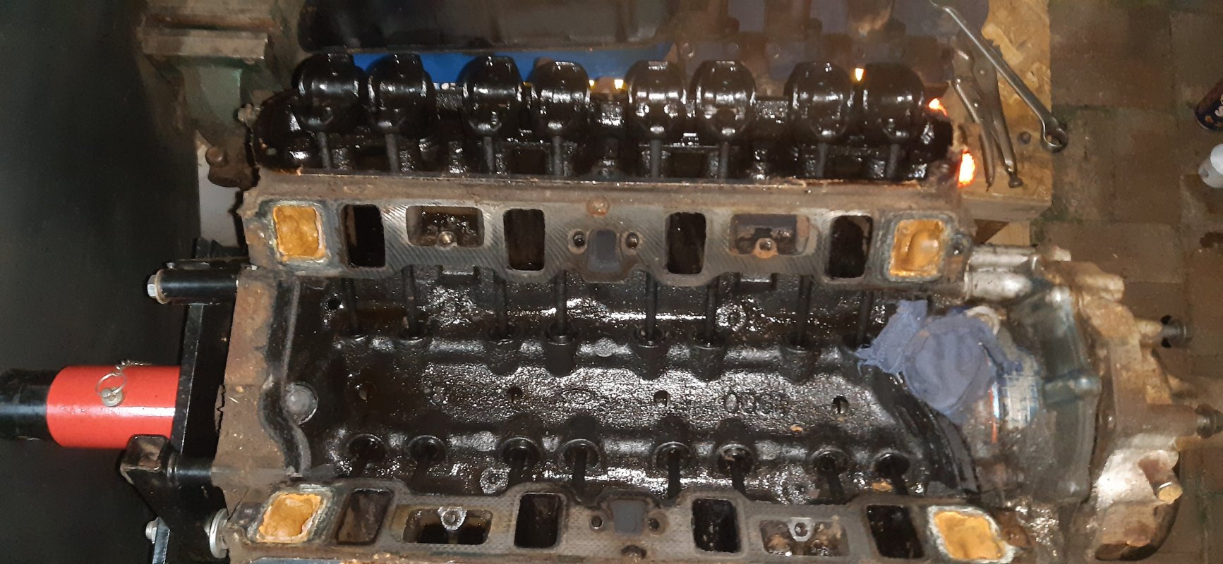

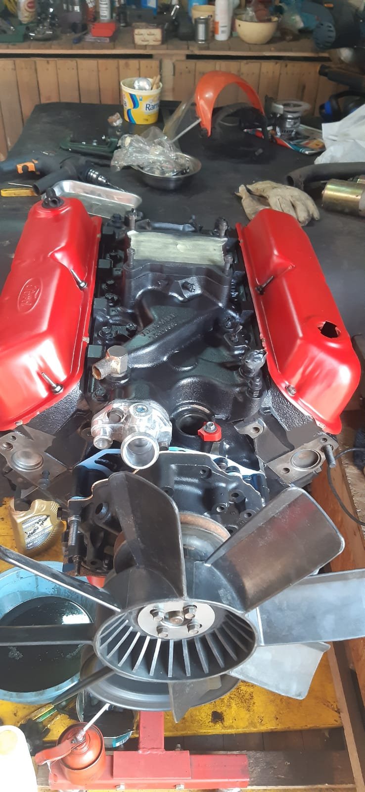

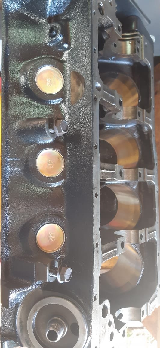

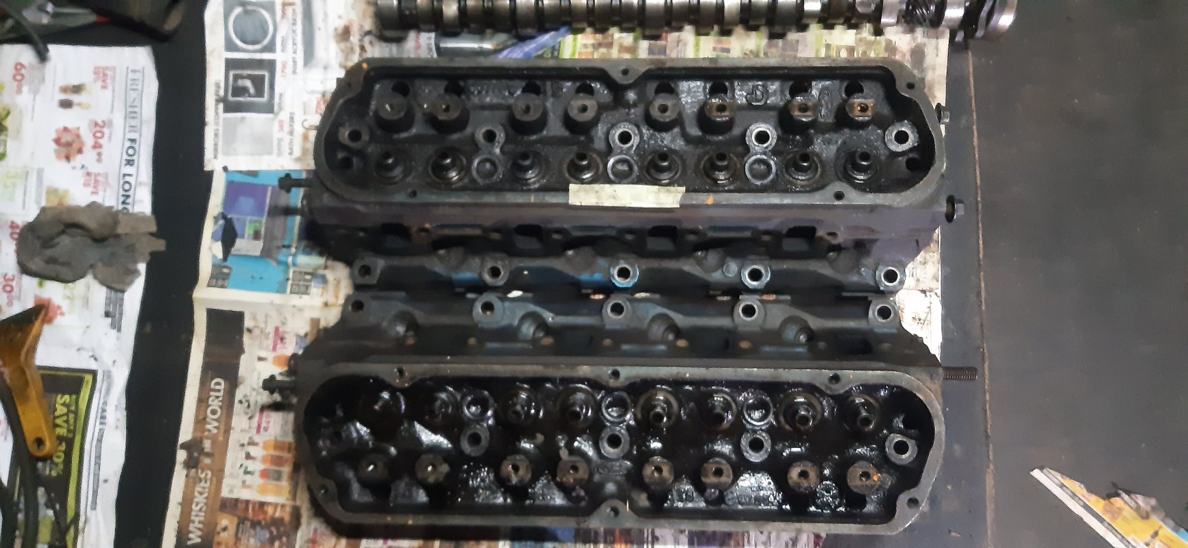

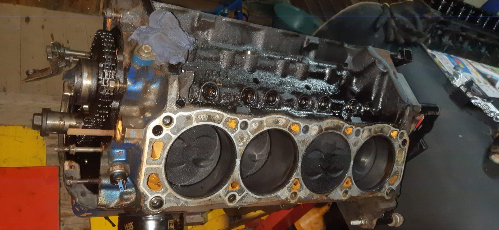

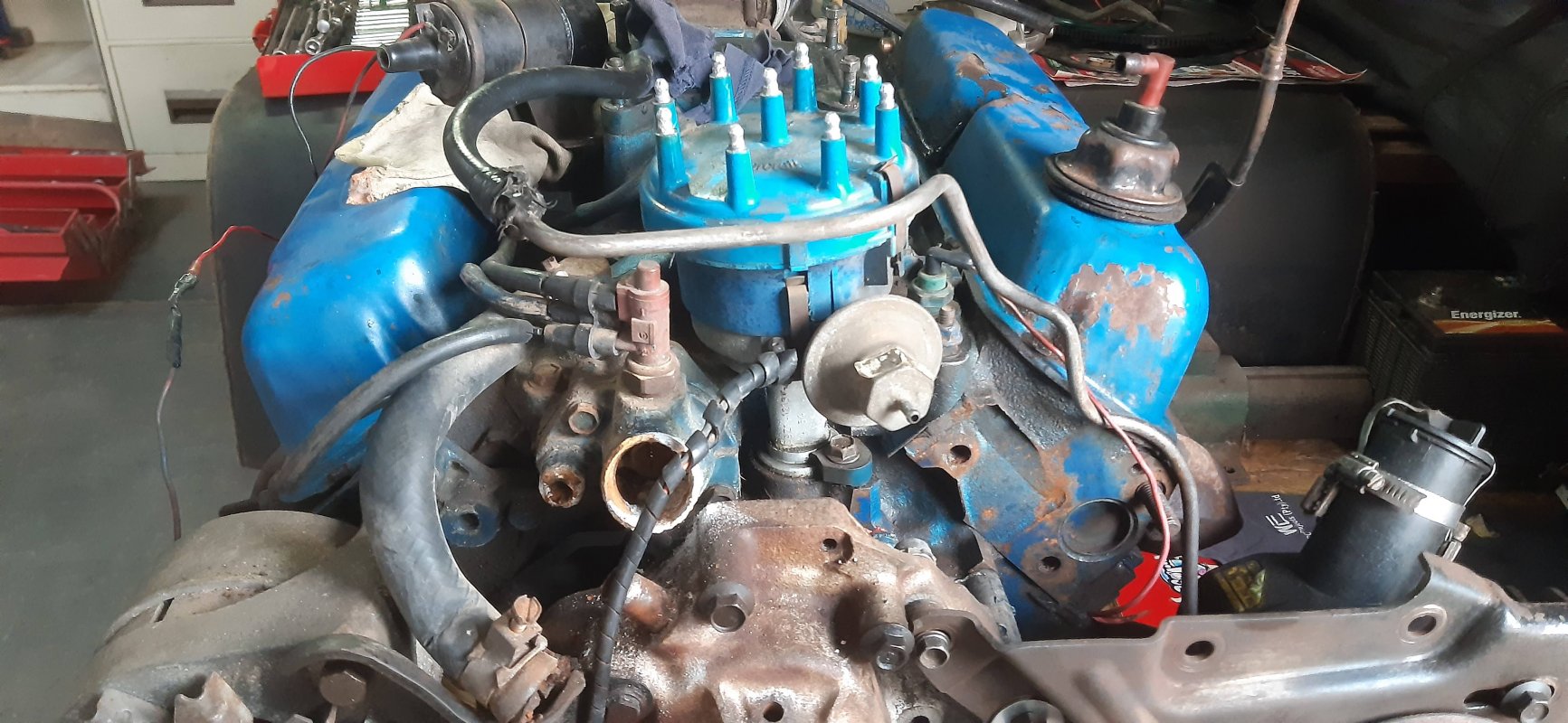

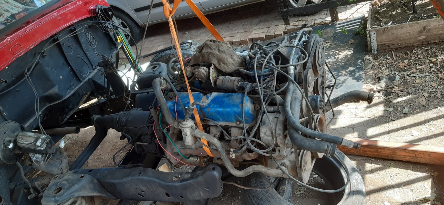

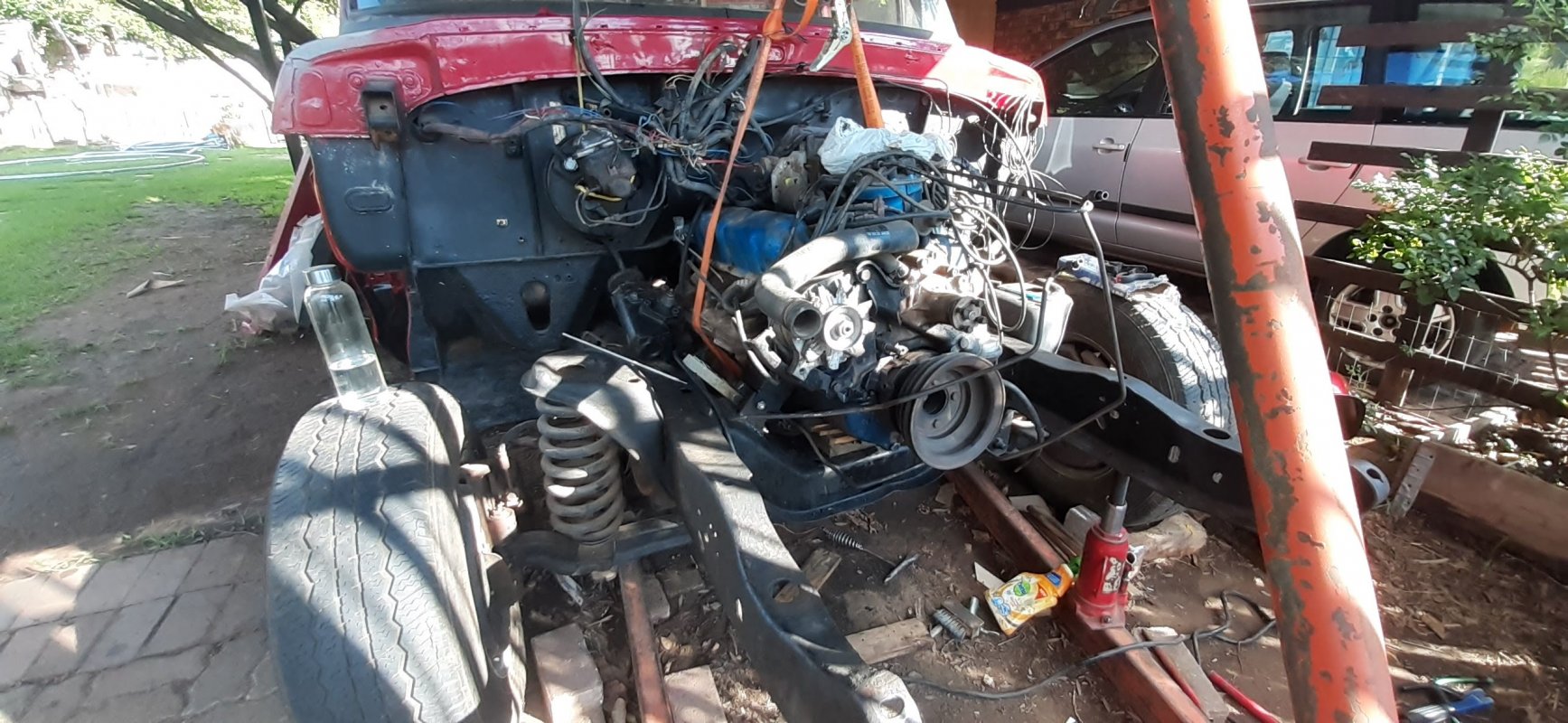

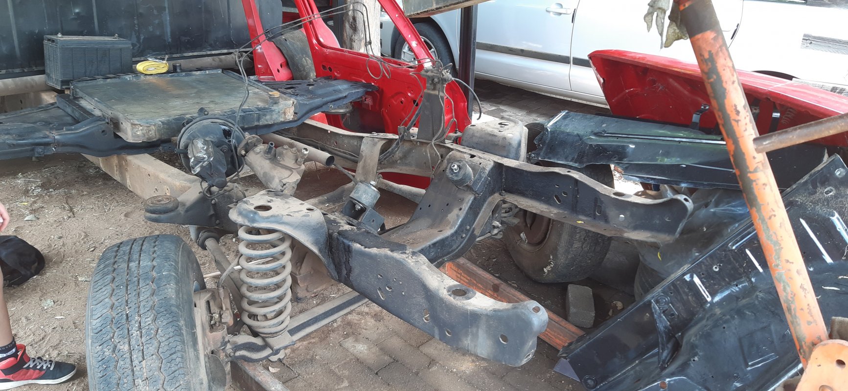

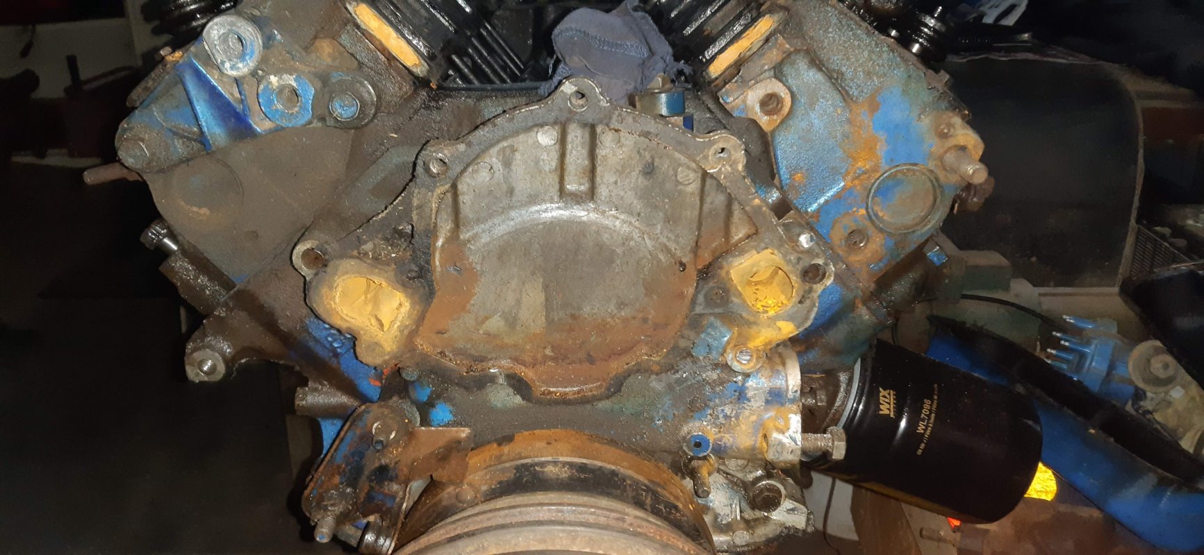

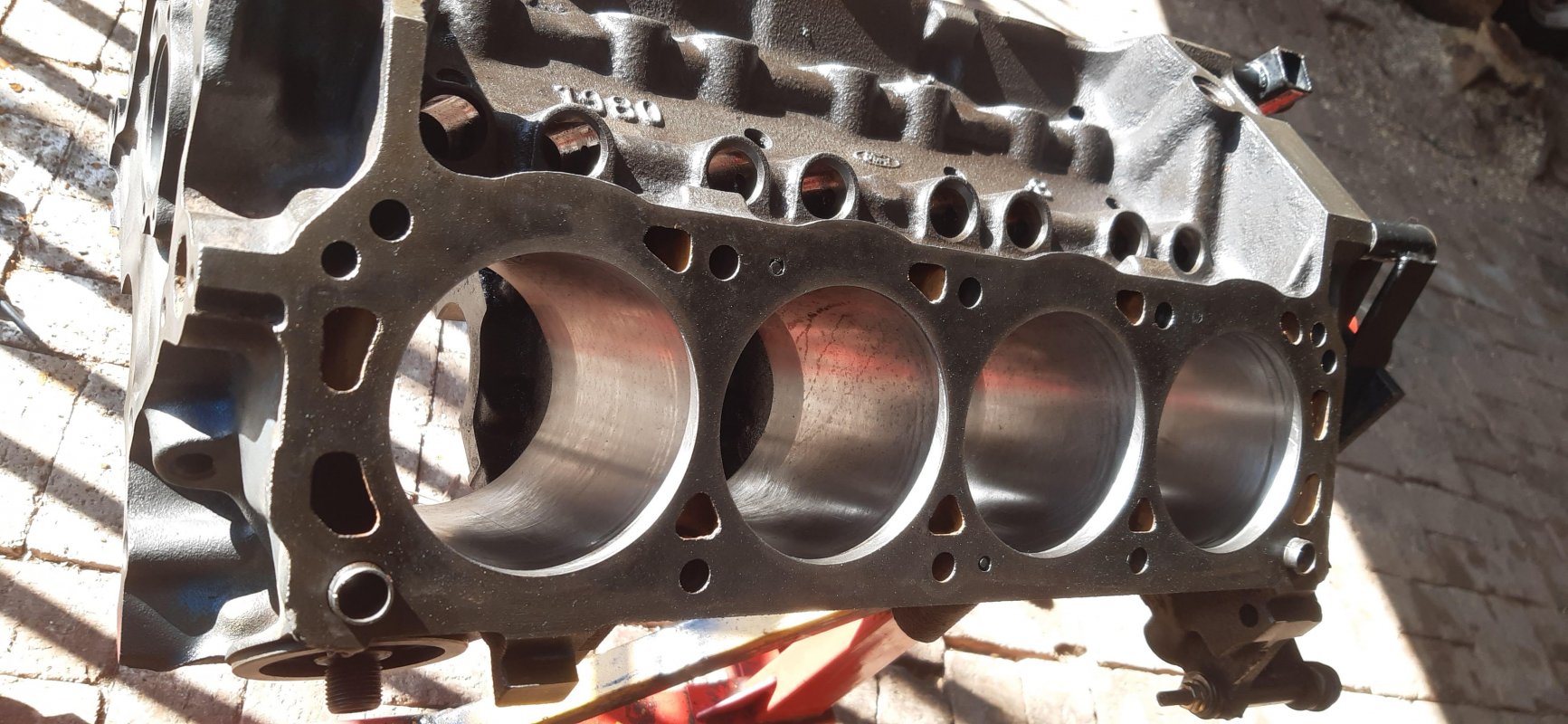

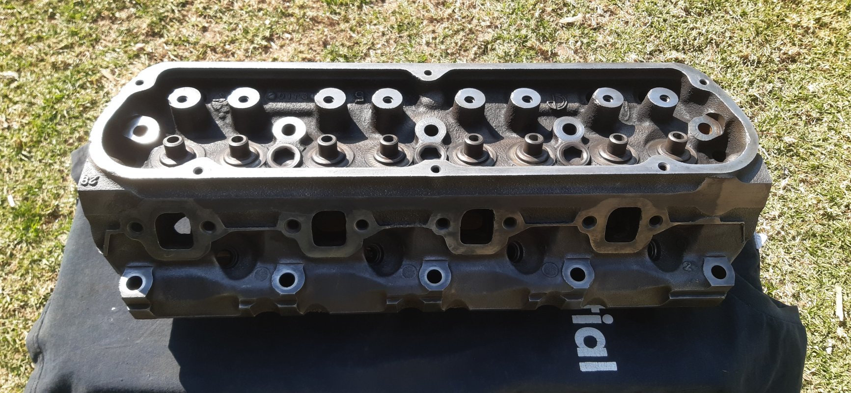

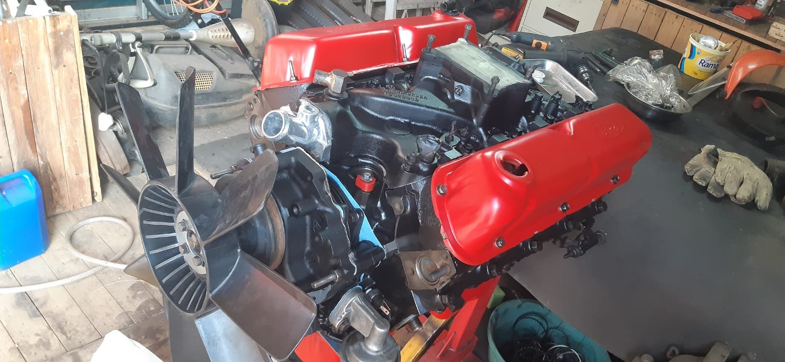

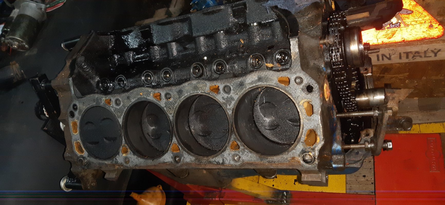

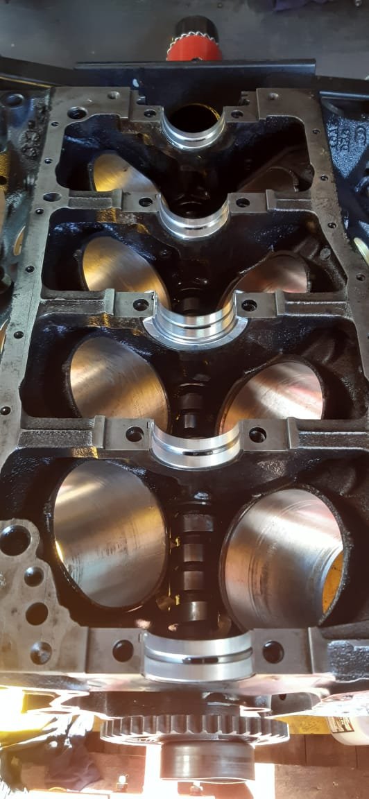

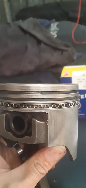

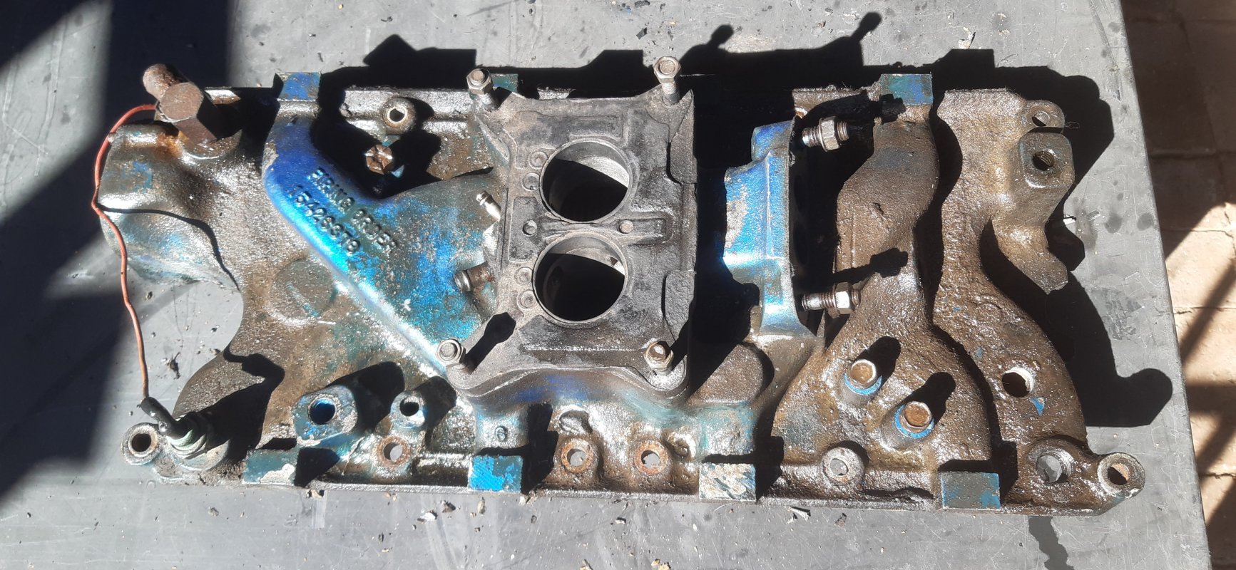

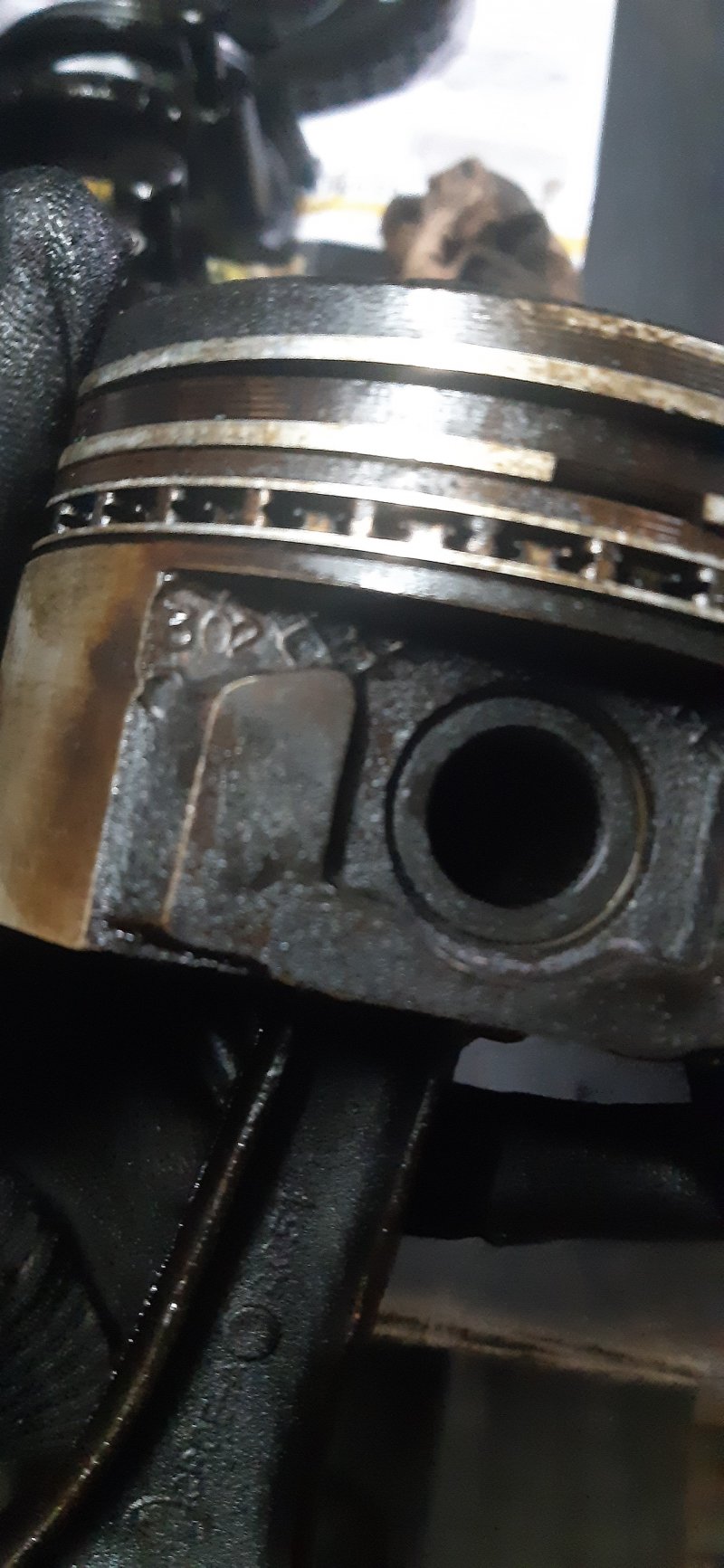

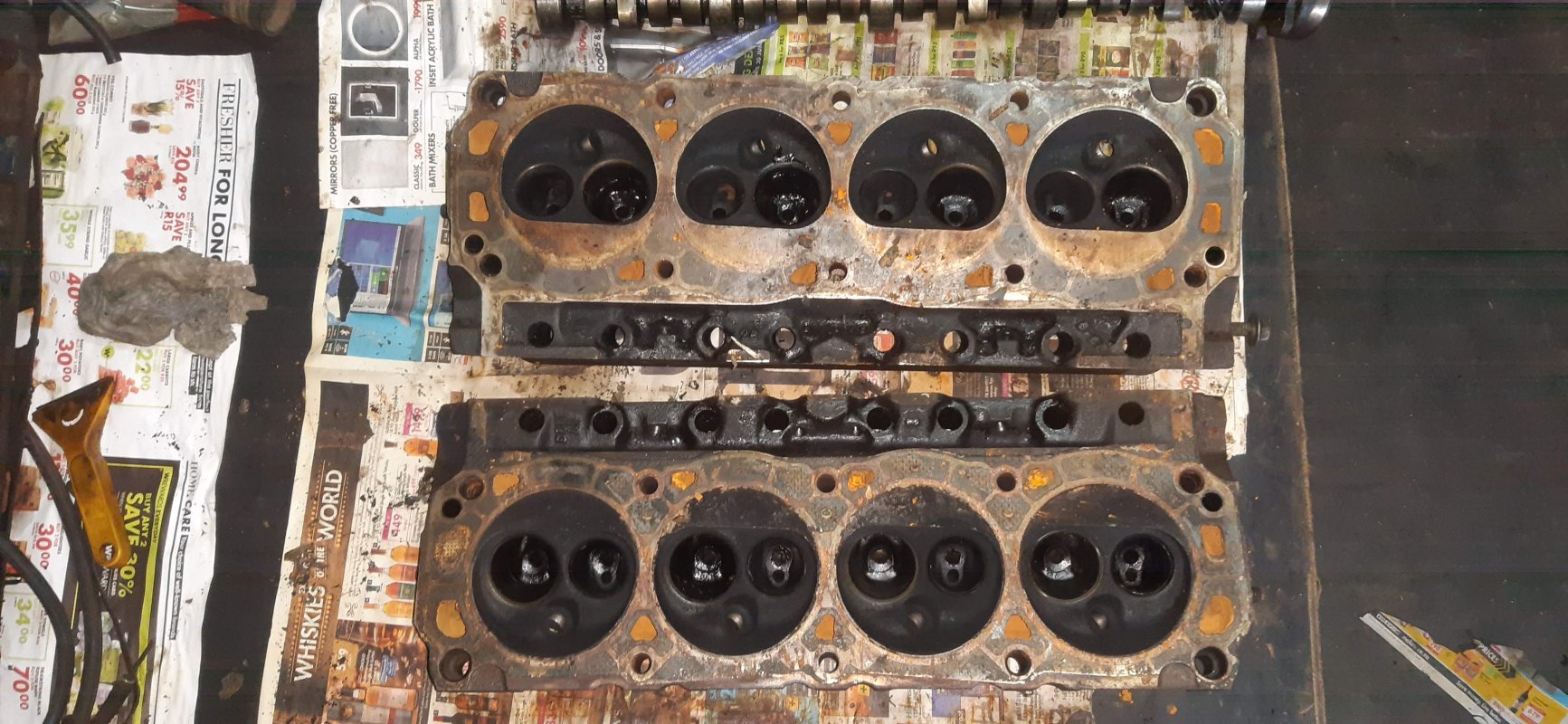

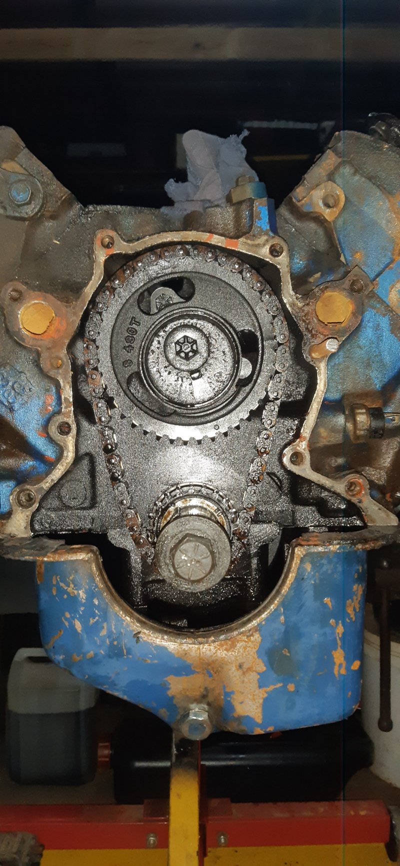

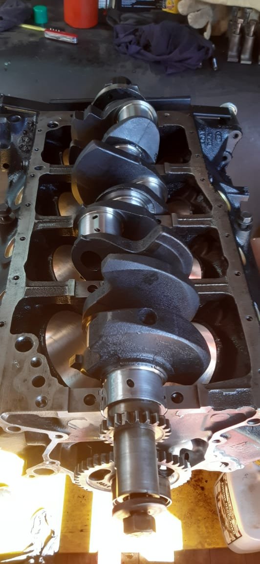

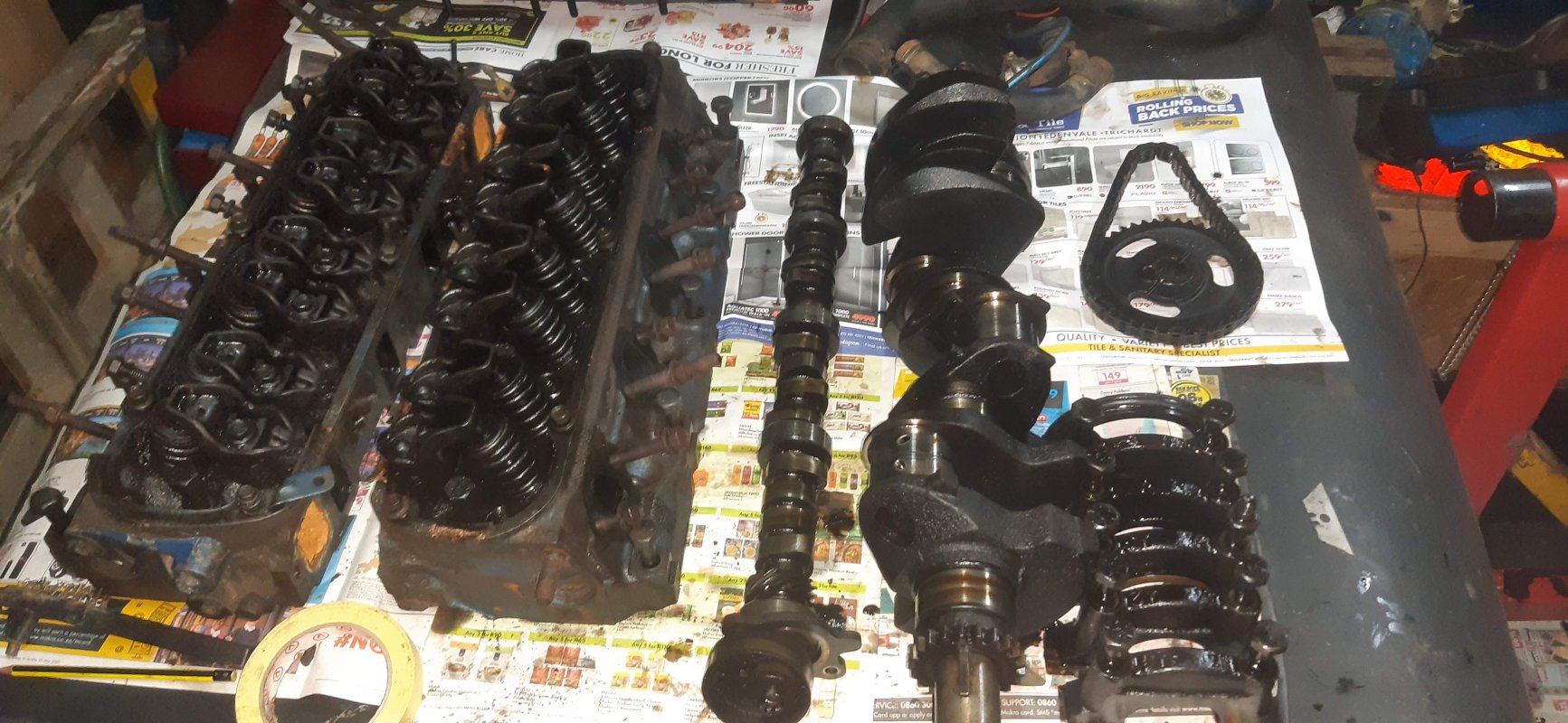

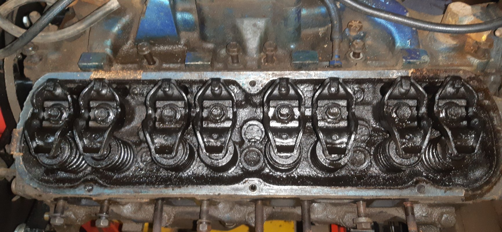

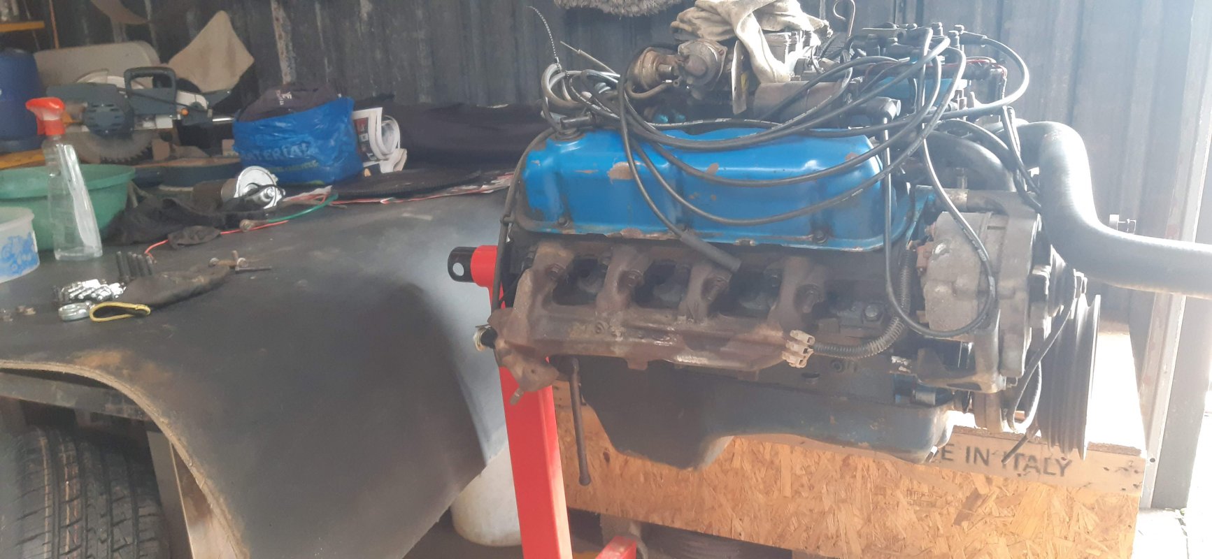

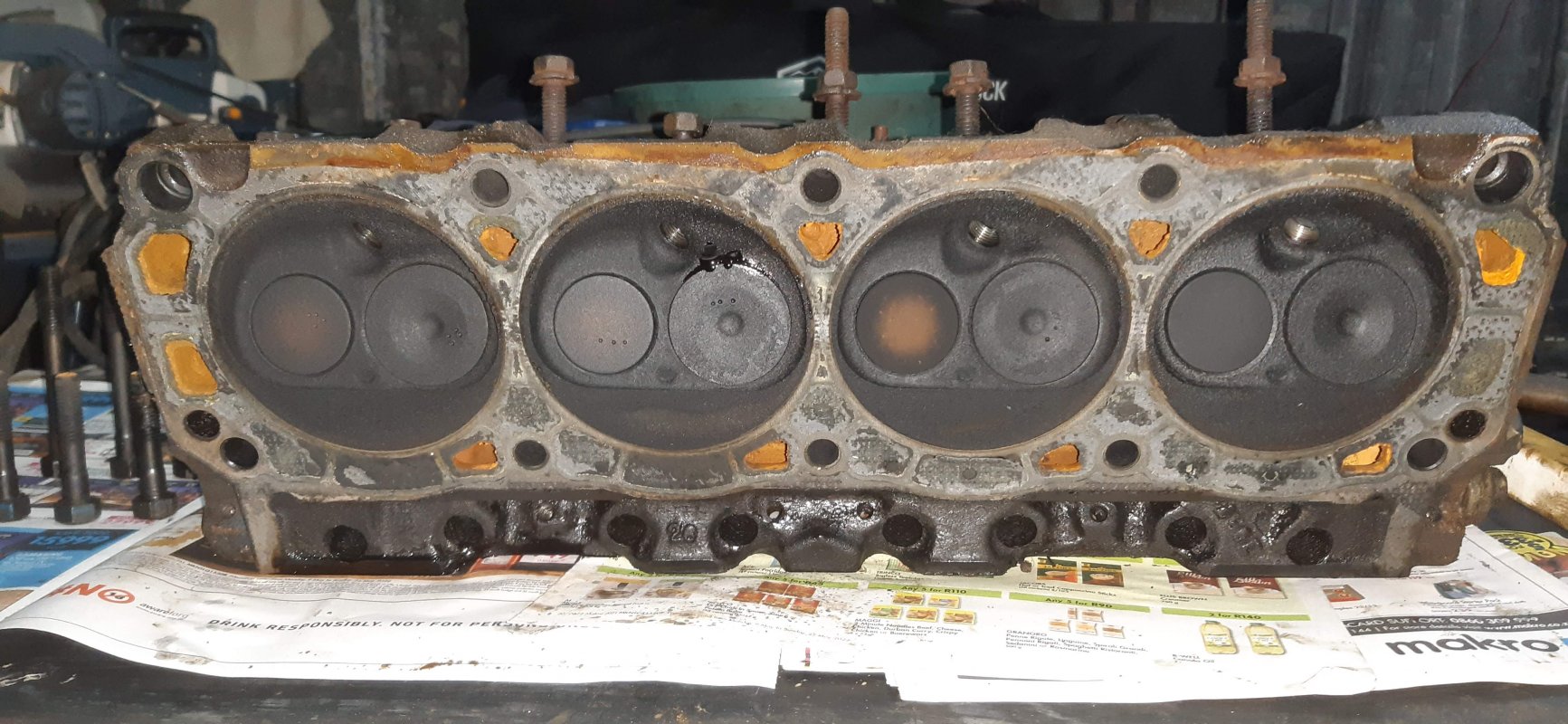

UPDATE.
Motor and gearbox arrived.
Ford Small Block 302 with C4 Auto gearbox
mocking up for engine mountings and gearbox mounting.

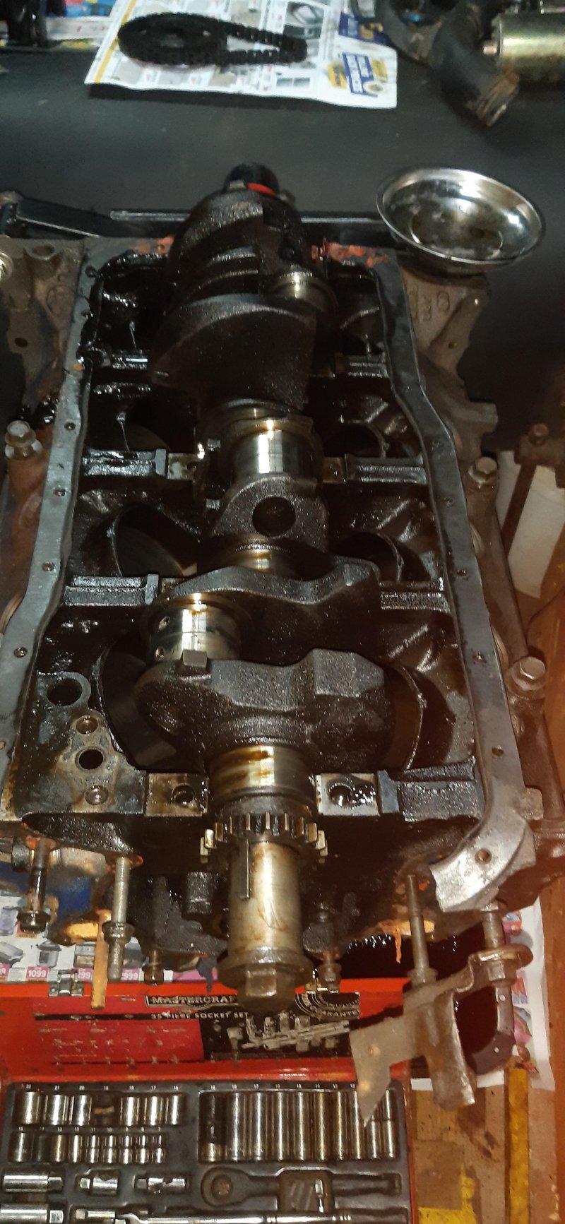

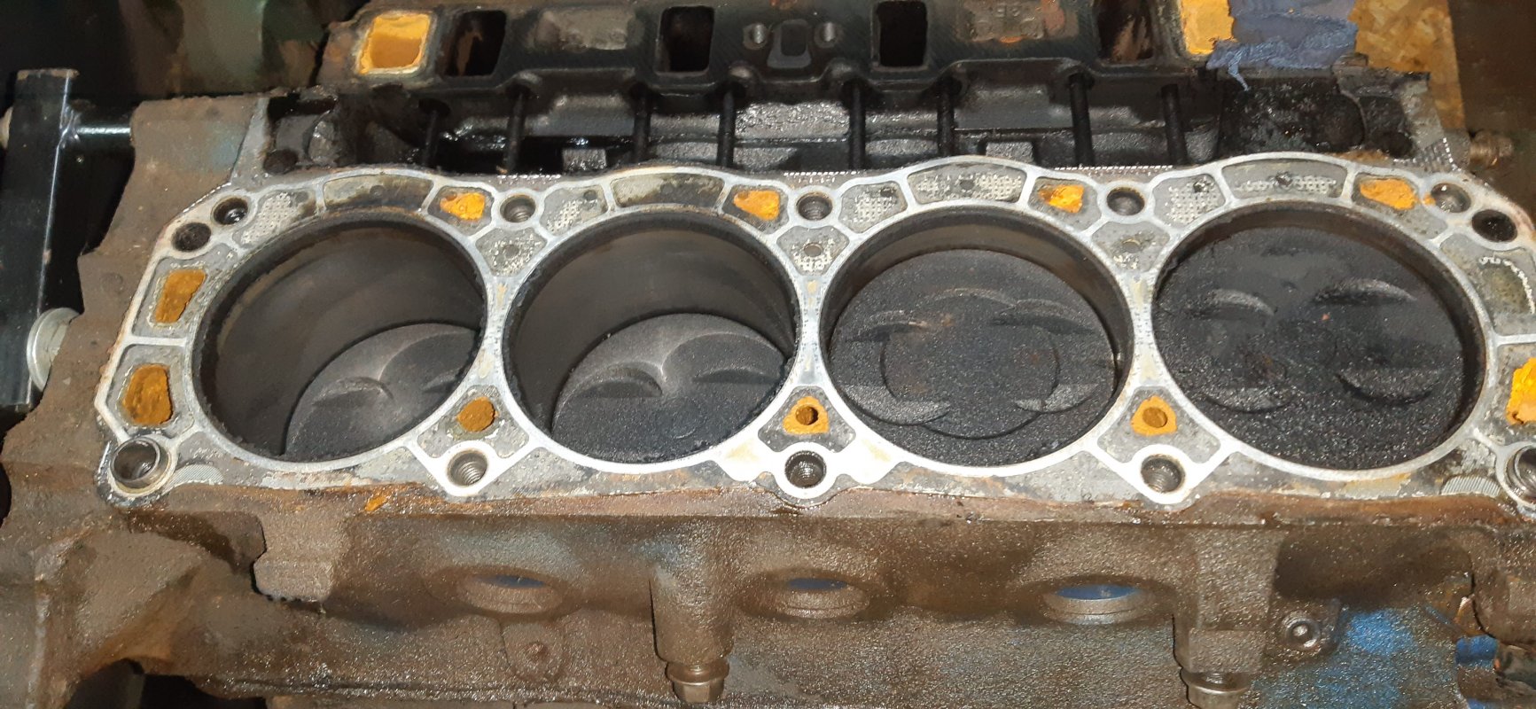

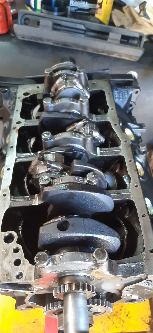

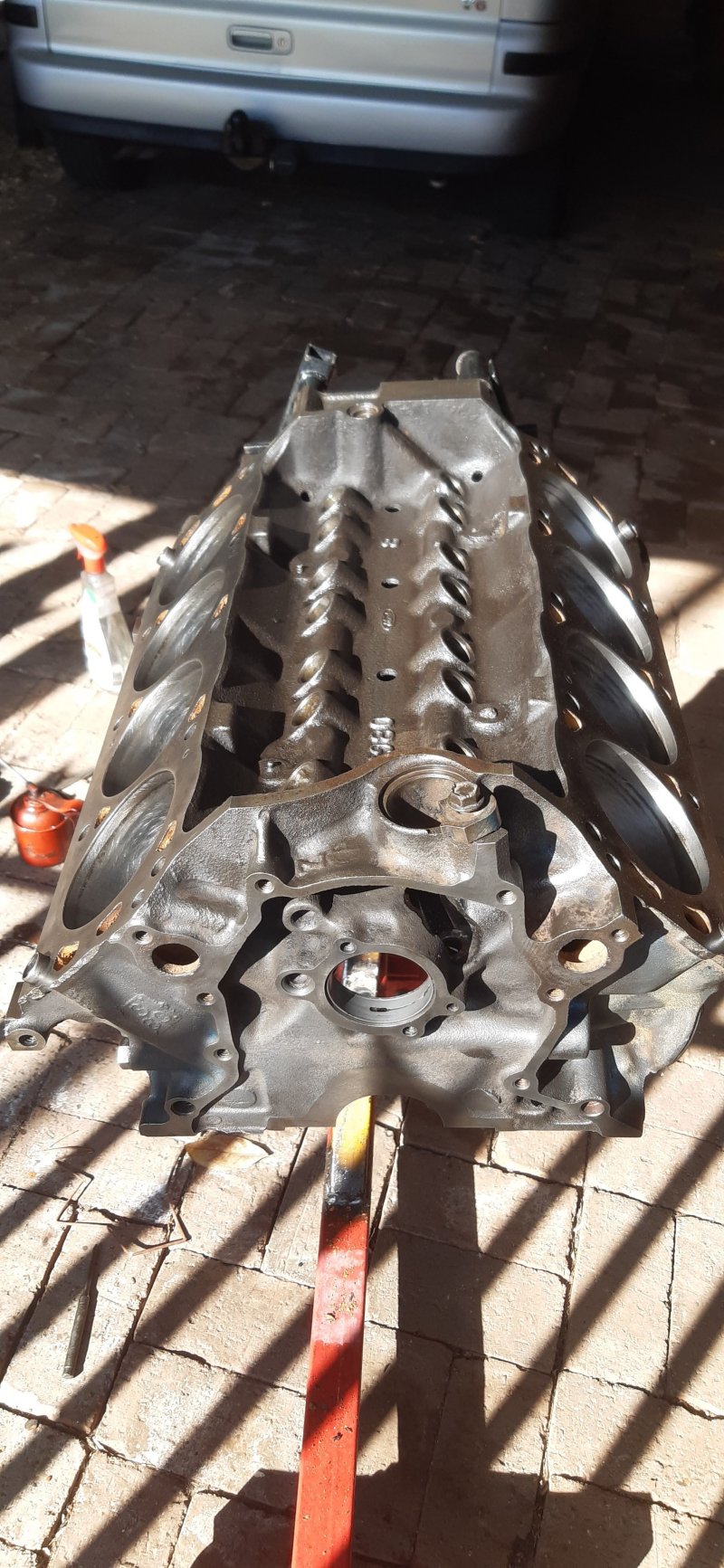

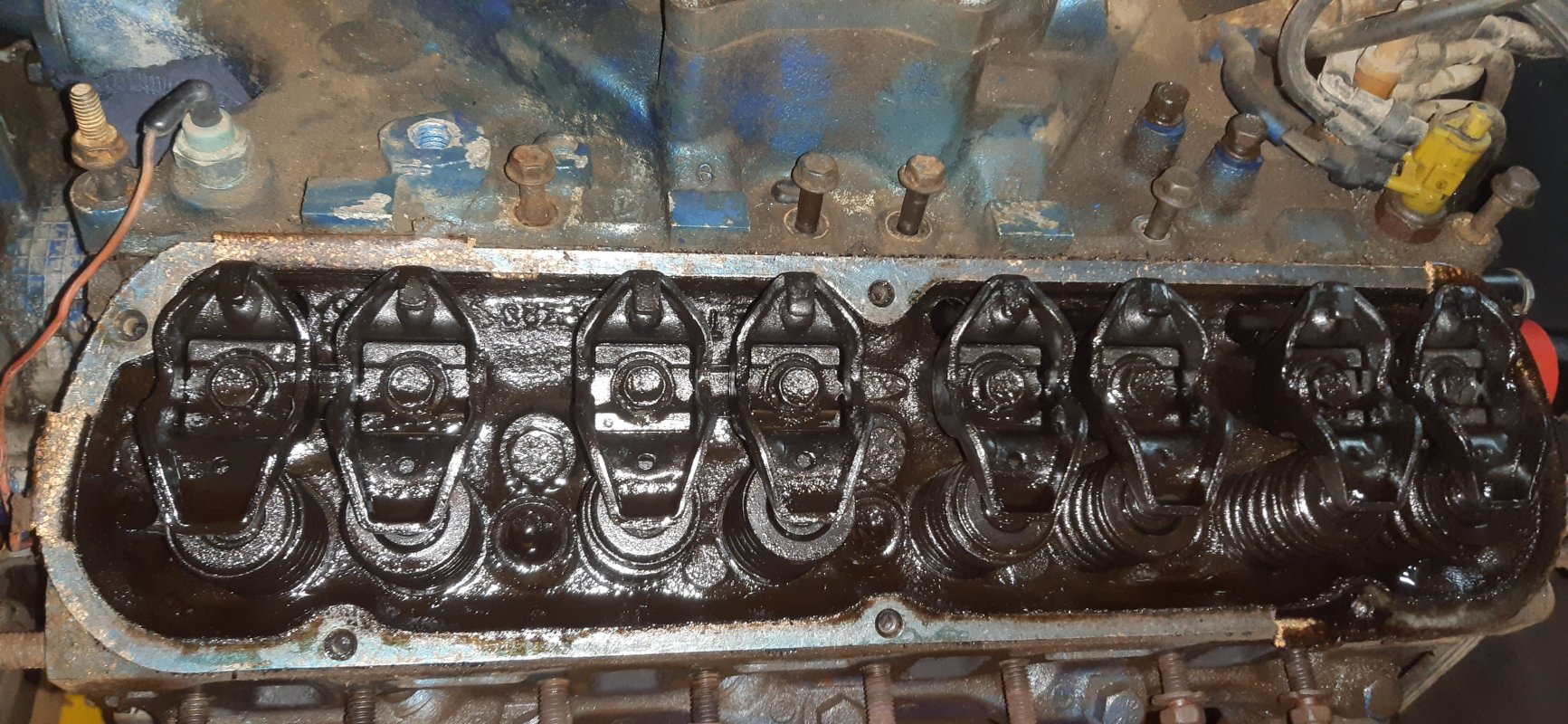

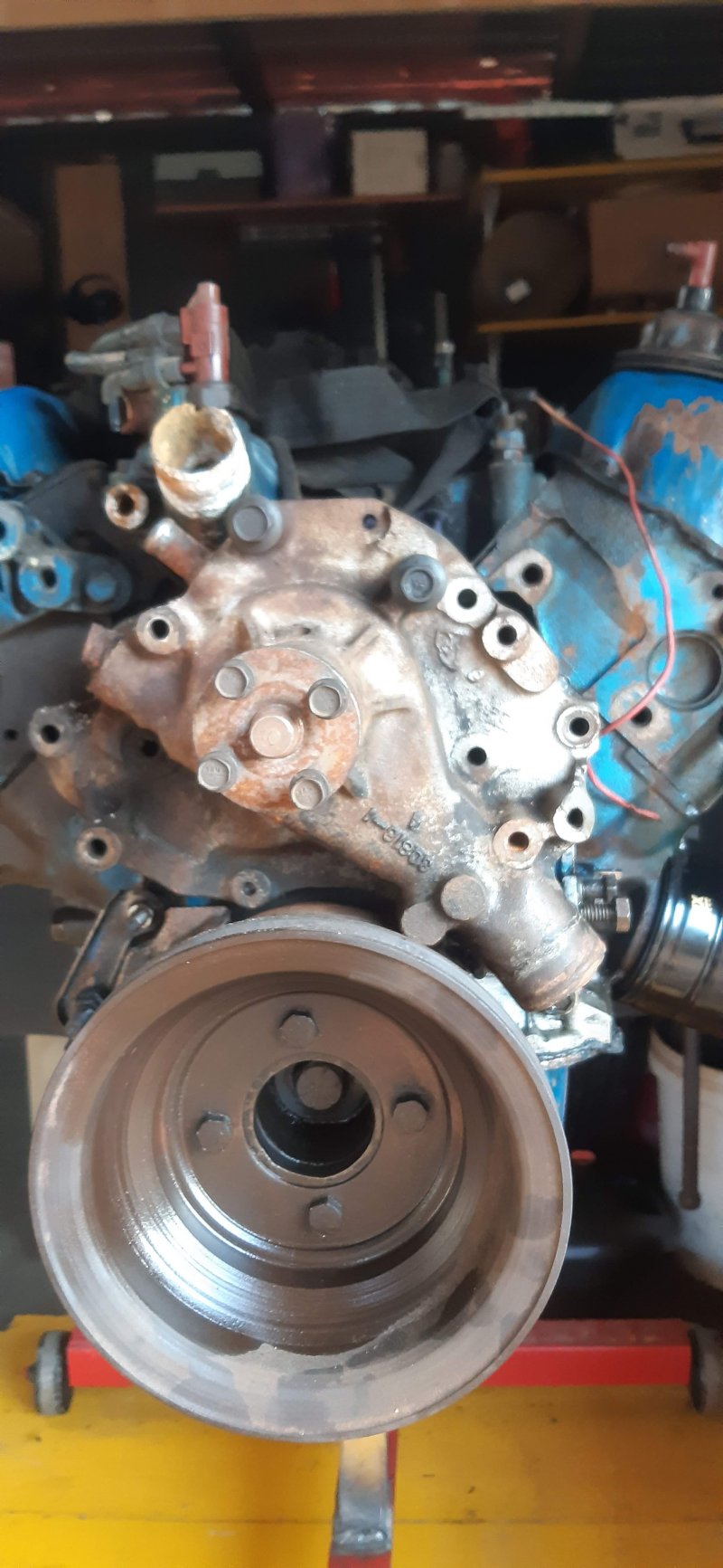

Strip and rebuild time.
i had to add a reinforcement brace to the engine stand as it was starting to flex.

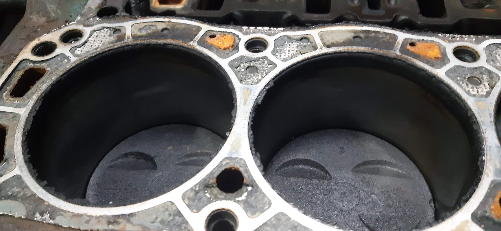

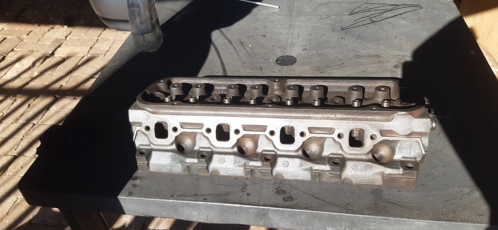

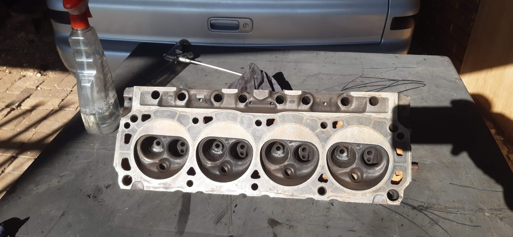

Benji

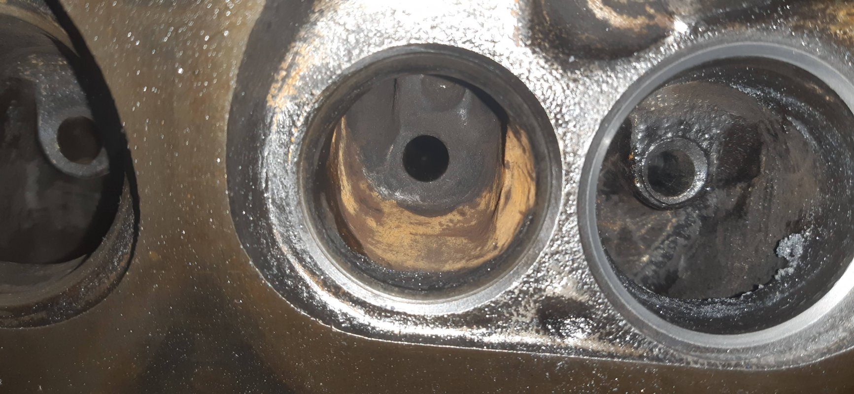

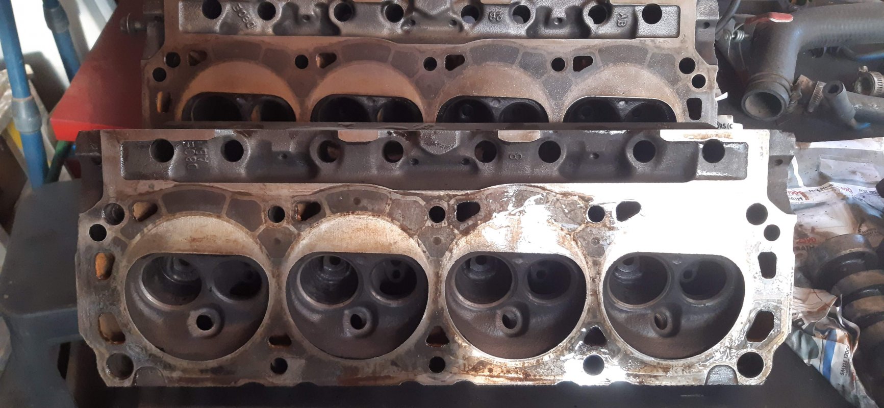

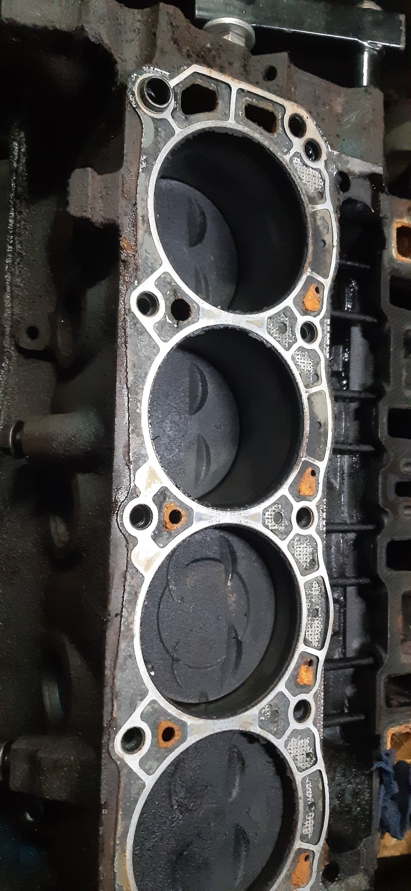

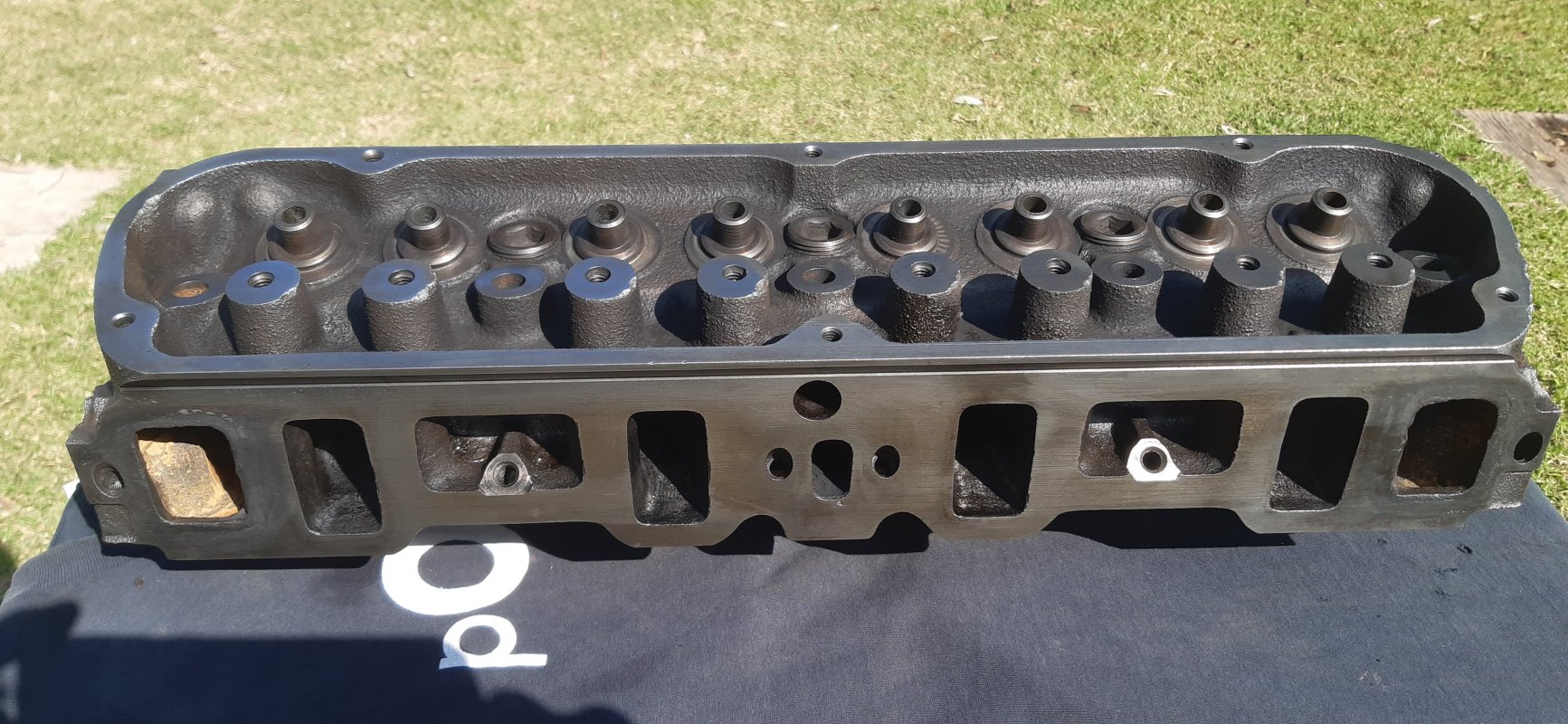

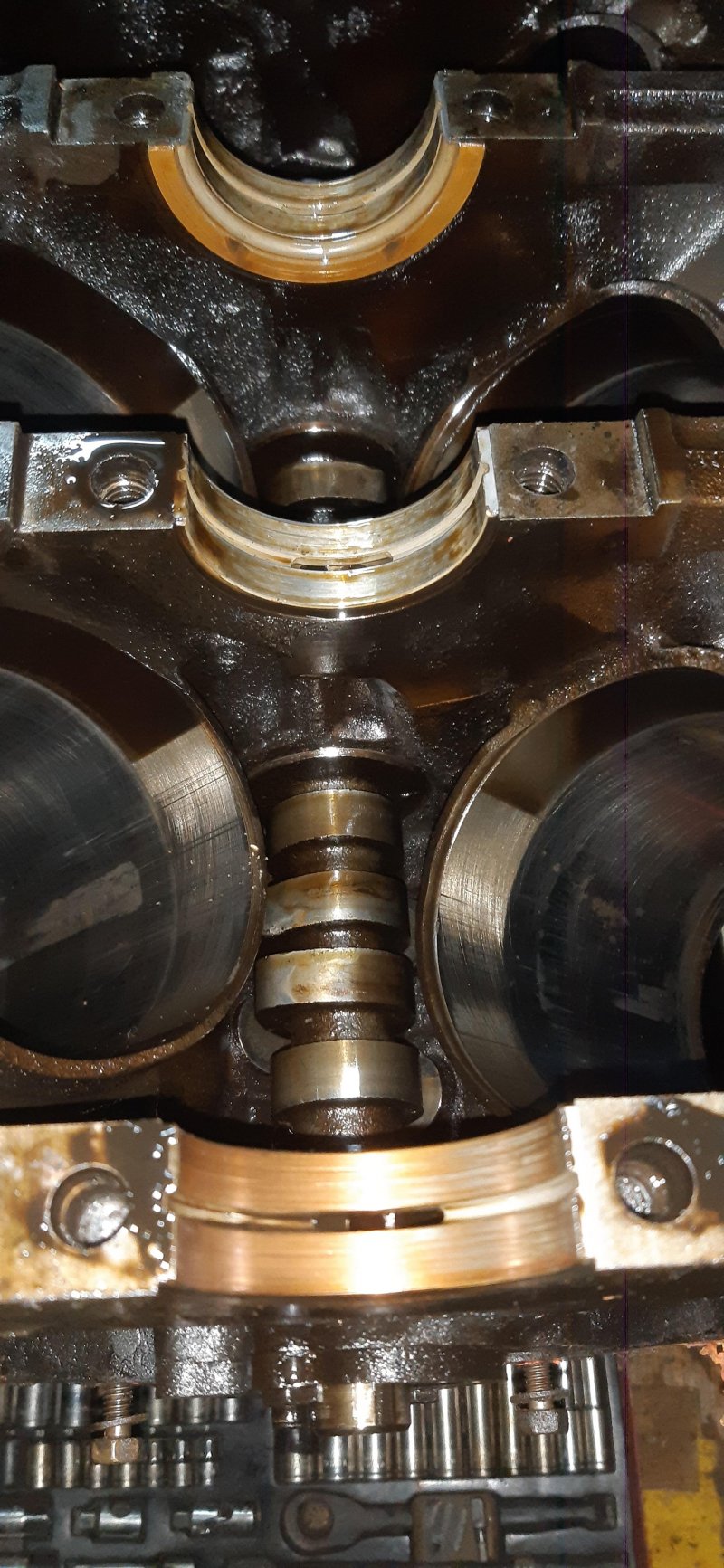

Now it is getting a proper engine, crazy how those cooling pathways were so blocked!
Coming along nicely, a lot of work has gone into that motor
DonovanPorter
madness i tell you , the amount of air my compressor has blown though every single pathway, water jacket, and oil port is astounding
