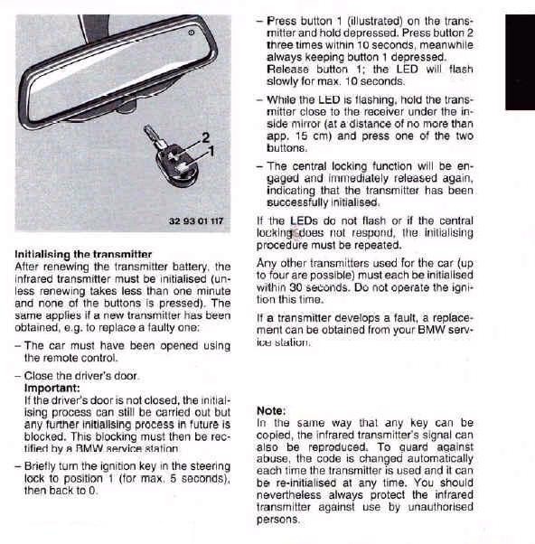

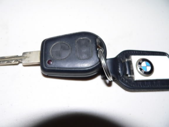

My 540 was lock via IR remote (as in the pic below) when I left it at a friends house for a couple of hours.
When I returned, the remote did not want to unlock the doors or disarm the alarm and I had to unlock the doors with the key and the alarm was screaming.
So to stop the screaming I removed the blue fuse from the DWA under the rear seat.
Seams the IR remote batteries finally died.
I've replaced the batteries but as soon is I replace the fuse ...... the alarm screams and the IR remote does nothing
Do any of you know how the reprogram the IR remote or how to reset the whole system?
