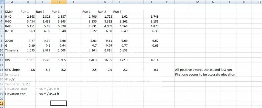

Andy1GP
Thanks Joe, yes the times are consistent considering I change gears ever so slightly at different rpms everytime.
Wrote down all the runs and comparing them on excel now.

Nice, now you need to share your findings. :)
Andy1GP
I don't want to give away my secret launch control :fencelook:
Ok here it is :)
The very last run on the one side I tried to do an aggressive launch from the line but didn't seem to work as well.

Nice to see you are using a tool with realistic figures. :thumbs:
From now on it's all about trying to see figures you have not seen before.
The best part is now trying to beat yourself. :joy:
Time to start looking for the 8speed auto box its 1/2 second faster. :idea:

Awesome stuff Andy :bravo::praise:
