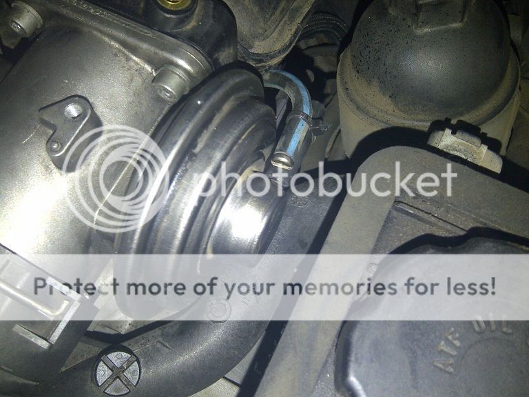

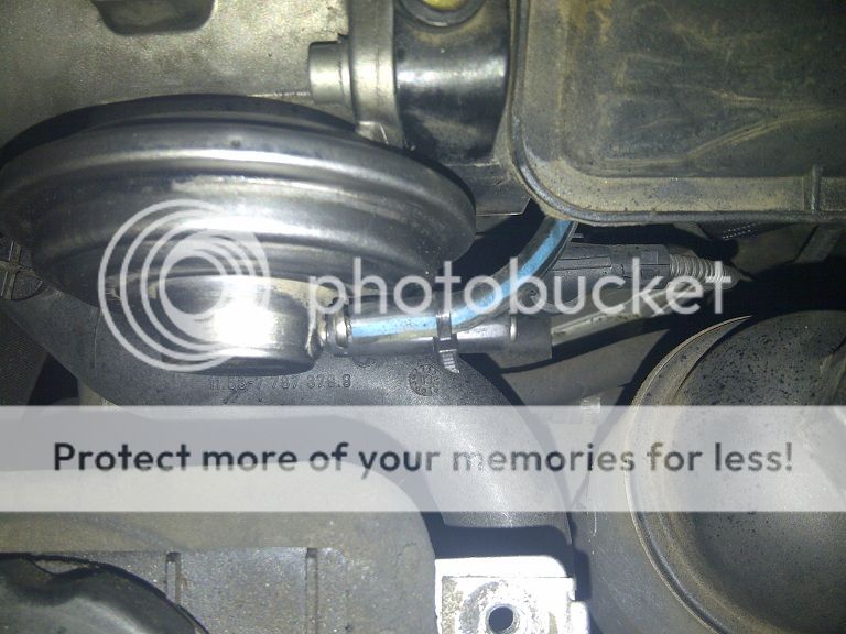

Its a very easy mod, remove engine cover, and on the right hand side there is a valve with a vacume hose attached to it that is connected to your inlet manifold, all you do is disconnect the vacume pipe and block it off( I did this with a small bolt) Then take a small piece of silicone pipe which has been blocked off too and connect that to the valve where the pipe you disconnected went, then all I did was cable tie these two pipes together to the nosel of the EGR valve itself to make it look all neat and thats it, took 2 mins to do this mod if you don't count taking your engine cover off.

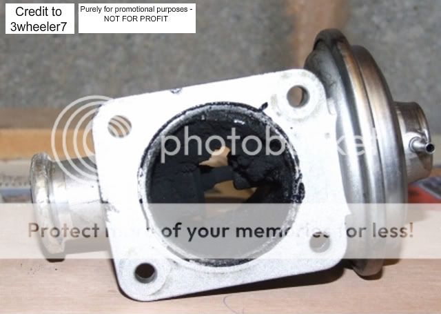

This is what a EGR valve typically looks like and it doesn't take long for it to get to this stage. (This can't be good for your engine to breath in).
