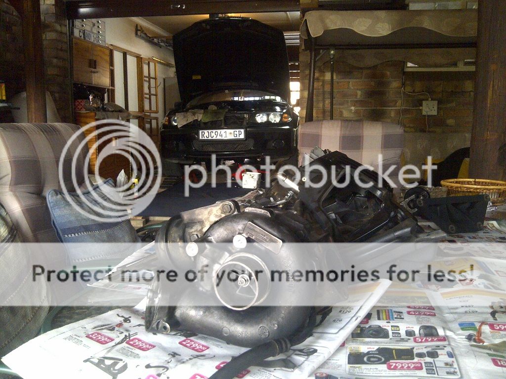

I Decided to open the motor. i started stripping the nose today and when i loosened the intake pipe off the turbo, i noticed the turbo spindle lying in pieces.
I'm going to open the motor anyway to see if there was any other damage done, even though i presume the turbo is the main culprit.

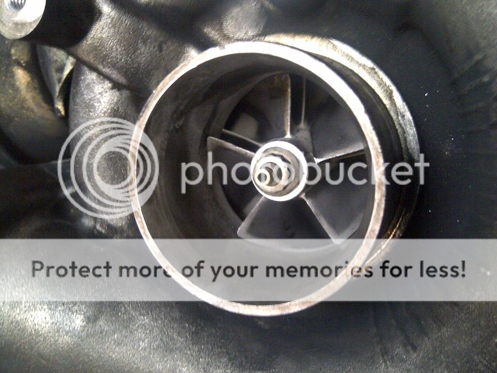

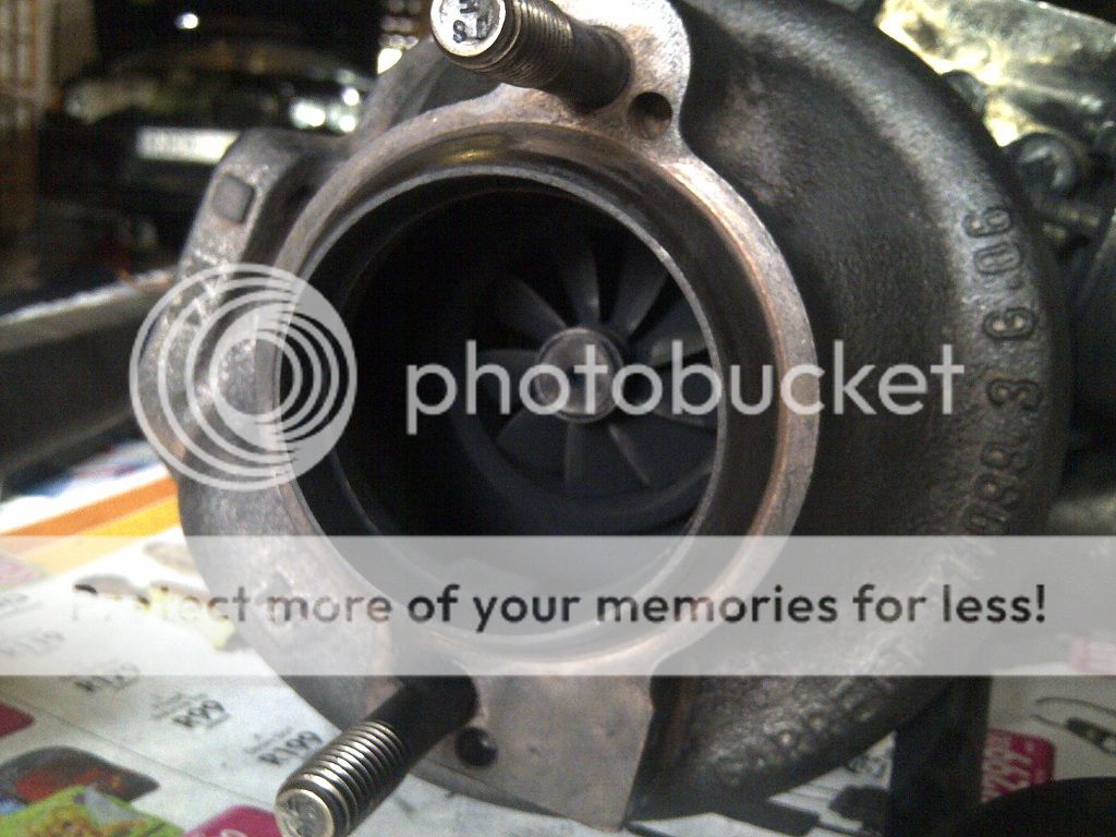

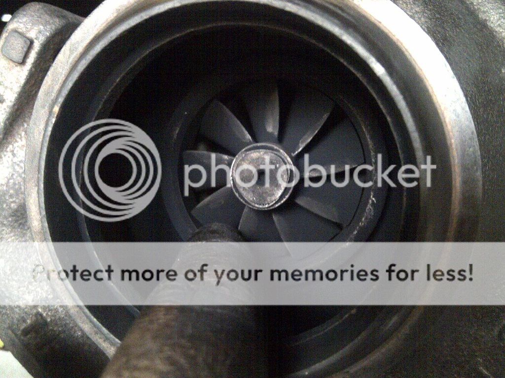

Yes it was Osiris's car. I'll post a pic of what the original turbo and internals should look like.
Vinnie your housing is original but your internals are aftermarket. That could explain the premature catastrophic failure.

From what I remember the turbo that was purchased was an original bmw unit, which developed a whine/siren like sound after it was fitted. apparently the issue was because of an unbalanced shaft in the turbo, your observation makes me think that something different happened:fencelook:

I'll post a pic to show what the compressor and turbine blades and locking nuts look like. The ones Vinnie has in his Original housing isn't original internals from what I can see.
