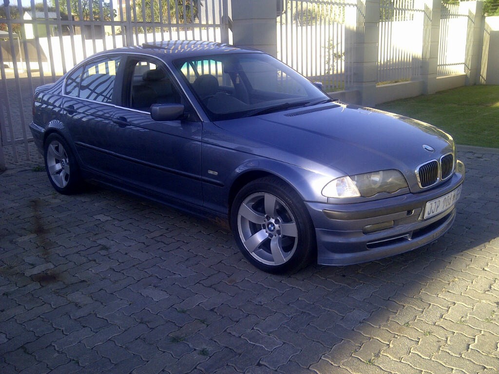

please advise, i need some coil-overs to drop my baby a little, also need a bigger tyre at the back. I am currently on 235/45/17 all round.
Can you recommend the tyre size ?
will a 255/40/17 look back on my car ?

Your current tyre size and wheel offsets are completely wrong for 3 series. Sell them and buy the correct stuff, fitting even bigger tyres and dropping the car is going to make your problems far worse.

My car is sitting on 225/45/17 (E90 OE rims), are these O.K. for the E46?
Yes, correct size for 1,3 and Z series models.
OP, check your driver's door jam sticker for the correct size tyres. Usually 225/45/17 in front and 245/40/17 on the rear with narrows and wides.
All narrows usually 225/45/17 all round.
But first change your wheels for the correct offset ones.

So I have decided to keep them 225/45/17 all round on my E46 :thumbs:
Great looking rims on Miltonian's car, pity they are the wrong ones for it :cry:

moranor@axis said:
I would not recommend wider tires it looks like they will rub...
Yes, looking at them it seems like these are as close as I can get to the outer wheel arches without causing damage or without "rolling" or widening them. I'm happy with it as is, the car looks great with them! :thumbs:

sorry was commenting on the OPs tires... you could probably go 235 or 245 without any issues with e90 wheels

I love these rims , eish thinking hard about getting rid of them !
I need a different look.
so if i go 245/40 at the back, will I not be "correcting" the mistake i made ?

245/40/17 will be the right size on the back but the wheel offset is still wrong and the front tyres are still too tall.

Gizmo, should i get lower profile tyres for fronts ?
i have 225/40.
what should i get ?
Also, what will the offset affect in the long run ?
