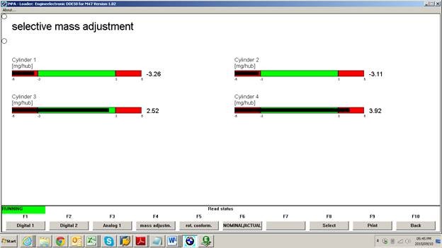

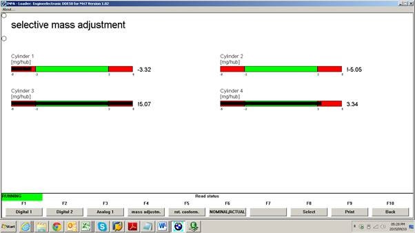

Screendumps from INPA showing the active readings. On the Selective mass adjustment screen you can see Cylinder 1 and 2 being very low and 3 and 4 very high. When this happens the car starts stuttering and stalls. Is this the injectors? Also attached, a pdf file with error messages. Please help guys........
