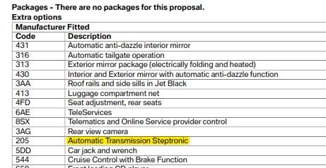

I was wondering if anyone else has had a similar issue their 2016 X1 20D with an ( ZF Friedrichshafen) 8HP Tiptronic 8 Speed Transmission.
Essentially what happens is when i start the car and then move the shifter from neutral to reverse there is a distinct delay (4 to 5 sec) before the gear engages. Then after havening reversed out of the parking and i engage drive and start to pull away the first 1 or 2 gear shifts are not smooth. It is more of a delayed and hard shit.
This is more prominent when the car is still cold. And also less prominent if i accelerate slightly more quickly.
The car is 9 years old with 93000 km on. I have had the transmission oil level checked and it is correct. As far as i know the transmission oil has never been replaced. The service manual suggests replacement on 8 years or 80000km. However, when i asked BMW whether i should bring it in for a service they asked if the computer has a transmission oil service light on. Which it does not. BMW then said it does not need a transmission oil service!!!

I thought this platform uses the Aisin Gearbox known as GA 8F 22AW, and not the ZF?
X1,X2, 2 Series Active tourer, Mini Countryman
Which are quiet sensitive to the Oil gearbox service. Lots of threads on them from overseas mention these same symptoms, that the issue is then resolved with an oil gearbox service

The ZF8HP is solely designed for AWD and RWD cars. The X1 F48 is FWD coupled with the Aisin gearbox.

@TerryX1 your car has an Aisin transmission, not ZF.
As advised get the gearbox serviced.
