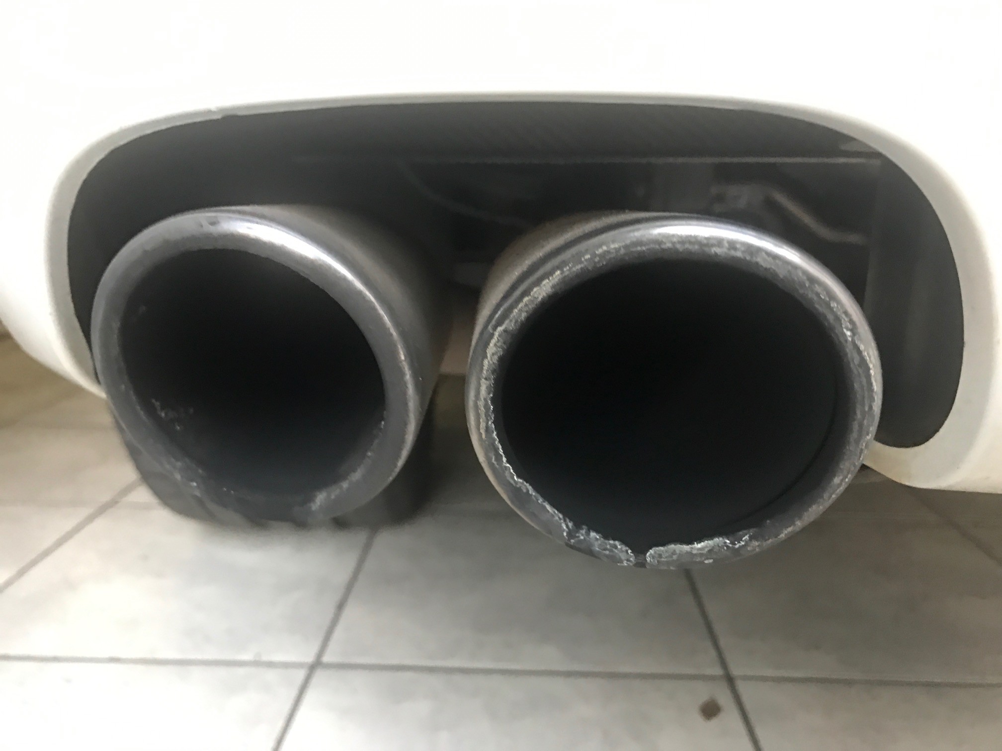

Hi Guys,
So have had my 2011 X3 3.5 petrol Xdrive for about 2 months now have noticed that the double exhausts only one is really sooted up {right one} and that the other hardly looks used, also on cold start the exhaust fumes and or condensation only emits out the right one, is this normal with the 3.5 turbo petrol aspirated versions?

My understanding is that
The other side will stay closed until it's needed (pass a certain rev range).e.g past 3.5krpm
Its part of emission and consumption saving etc...
To do the test get a mate to rev the car while you stand behind you will see the second one open if all is well...
they must rev it hard though..to 4krpm or so:rollsmile:

my 335i was the same - i removed the actuator plug located in the boot. so both exists are now always open :cartel::rollsmile:
gavsadler
As mentioned above, the rear muffler has a valve in one of the exhaust outlets, which is electronically controlled based on the vacuum (load) on the motor. From what I've read elsewhere for other models, this valve remains closed on partial throttle openings to reduce noise.
I've disabled mine, so the valve stays open and gasses escape from both tips. I can't honestly say that there is a noticeable increase in noise or drone (that back muffler is huge and does a good job of keeping things in check).

From what I have read, the function of this is to allow the exhaust to get to optimum temperature faster for reduced emissions. Therefore it implies that one exhaust outlet will have more flow than the other if we consider total engine 'on' time. Yes there is a second flap that should open up at a certain throttle value.

Here's a pic of our's. Needs a bit of a clean.
