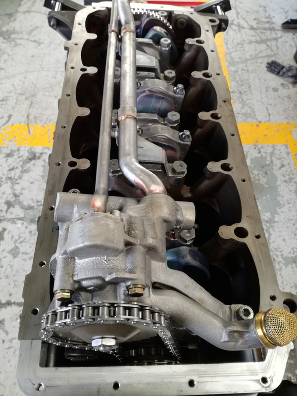

Cleaned the original oil pump which is perfect and re used it.
I know of people saying that the oil pump should be changed on a new build however BMW has pretty much built an indestructible pump on the S motors.
Only know of 1 failure with Glen but that is another story.

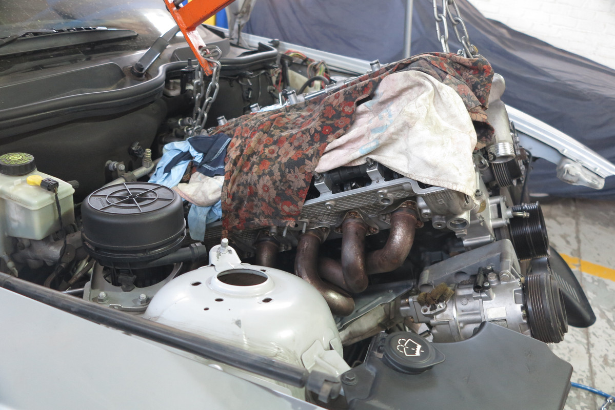

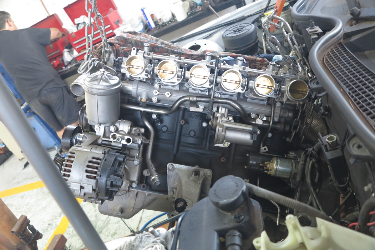

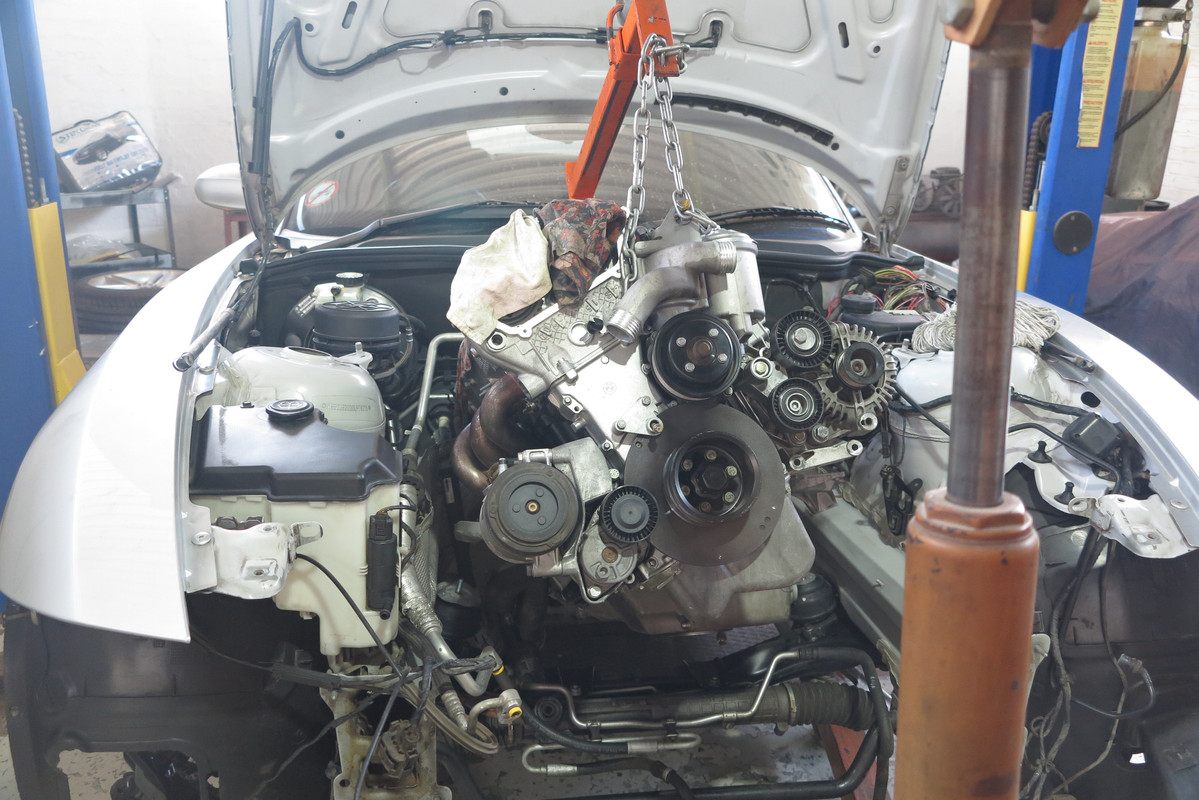

Even with the front removed the engine needs to be inserted very close to the firewall.
A slight lapse and it will tear the paper that BMW uses for soundproofing
