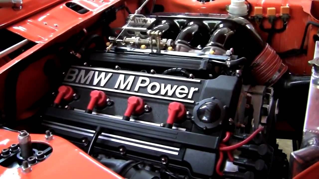

with a S14 engine
S54 please
would destroy the nimble handling
