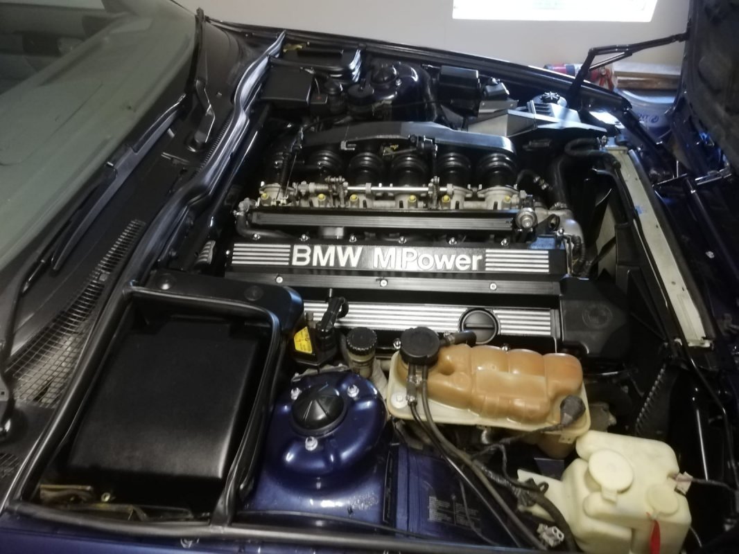

Hi Guys, I have a question to anyone that has done valve clearances on the s38b36: Do you measure the valve clearances when the engine is cold or warm? TIA
Benji
Where did you source a new pump? I searched far and wide but could not find one...
Valve clearances done when cold, but this info should be in the workshop manual that you are hopefully following. I took mine in to a reputable shop for the valve clearances as they had spare shims in stock - if you dont have the correct shims, it is a 2 week waiting period for BMW to bring them in which can make it a lengthy process...
Alex/M5
Hi Benji, where can you find this Workshop manual? We have a mechanic that specializes in race engines to help us do the clearances. Unfortunately we don't have shims on hand so will probably have to measure...order the right shims...wait... replace shims, not ideal but it is what it is.

Regarding valve clearances, you should be able to find a workshop manual online or at least a DIY forum thread.

Thanks, will check with the local dealership. Had the valve clearances checked. Surprisingly none were out of spec after 210 000kms.
