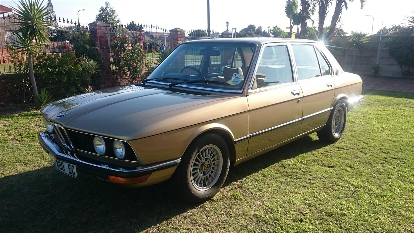

1980 BMW E12 518 - Gold

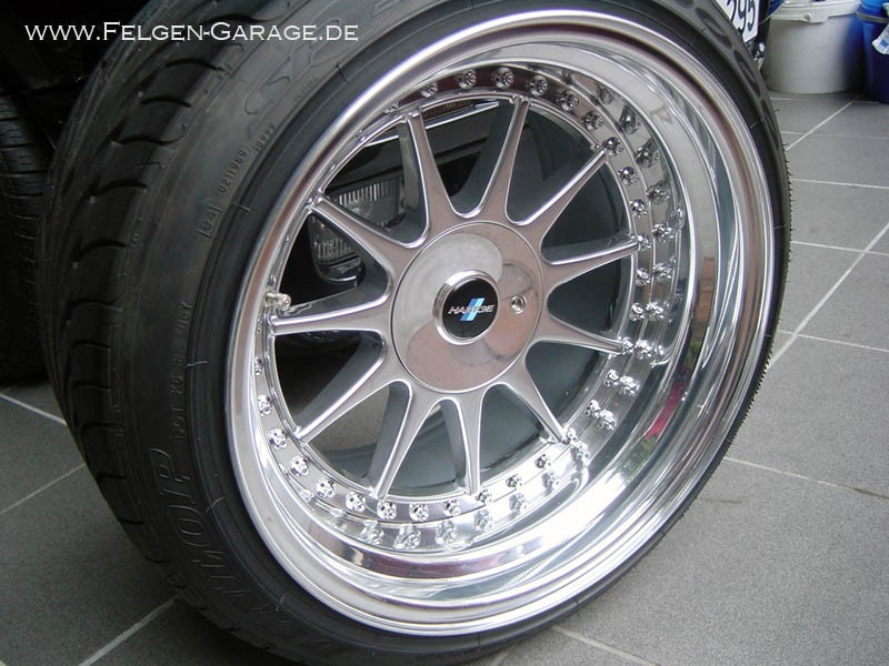

a 17" Hartge split on there...mmmmmmmmmmmm

I'm still looking for the right wheel, I try to stay away from reps as I've had my fair share of mishaps with them..

The 518 2 litre! What a beauty! This was the first BMW my dad bought in the '80s!
We had a metallic green that had twin Stromberg carbs and drove like a dream! The car was handed down to me in 1992 when I started college and stayed with us until 2003!
My dad serviced the car and even those Stromberg carbs himself and even though it was heavy on fuel around town, it was quite economical on the open road.
Man, what a beautiful example you have! The drive is way ahead of it's time! Can be slippery in the wet! At least with our twin Stromberg model, very responsive on the throttle.
Solid as a rock and way above many cars even after its time! :coolShake:
Thank you, this car had the twin Stromberg carbs on it, the bracket for the airbox is still on the passenger side inner fender.
To me it feels like the carb was just thrown onto the car without ever taking time to set it up. On flat out acceleration it feels like it's smothering the car.
With my daily having gone in for some suspension work yesterday I drove the 518 around.. On my way home the car started to lose power climbing a hill, heat gauge was just over the middle so proceeded to carry on to a friends place that was about a kilometer away..
Popped the bonnet and as I got out of the car I could immediately smell the heat.. On opening the bonnet I went straight for the radiator hoses...
Top hot and bottom still cold.. Thermostat was stuck.. I removed it, jammed it open and refitted it. Left it standing for about an hour before I added water again and made my way home.. Felt normal but I'm weary of that guage.
I want to run a temporary VDO guage to compare it to the original one in the cluster.

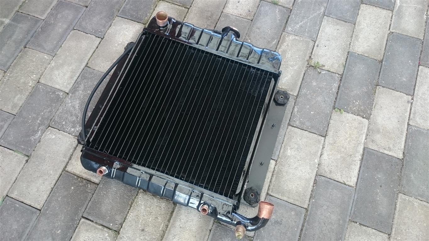

Before replacing the thermostat and temperature sender unit I pulled the radiator out to have it flushed. The flush turned into a new core.
While waiting for the radiator I removed the waterpump to inspect it, flushed the engine out a good couple of times, replaced some blown globes in the cluster and did all the small niggly things the previous owner neglected to do..

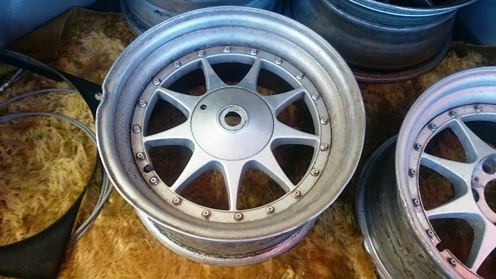

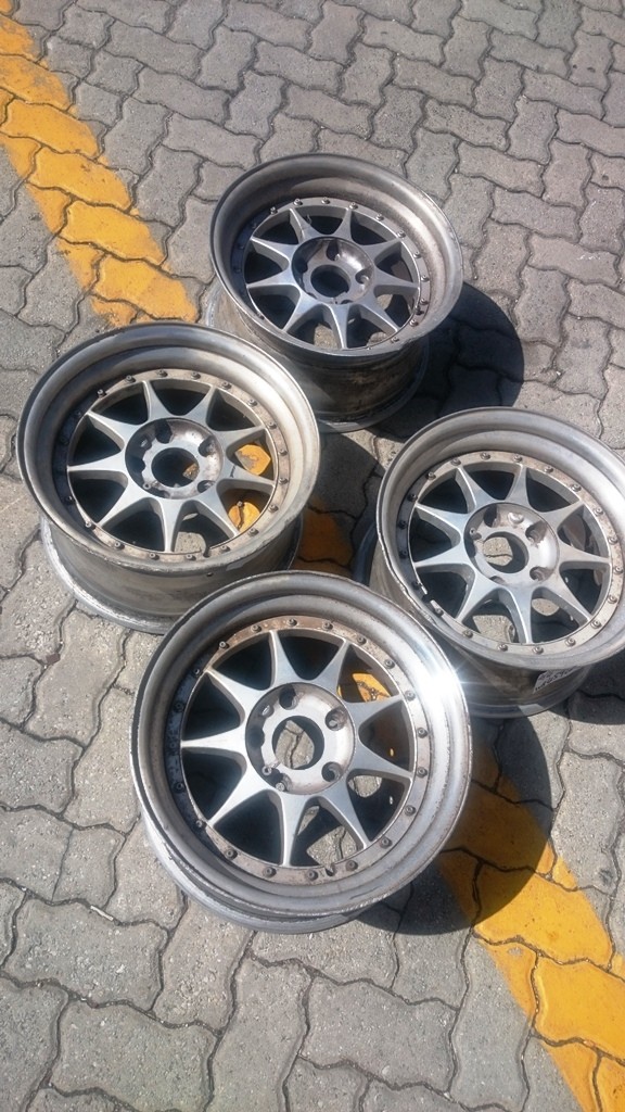

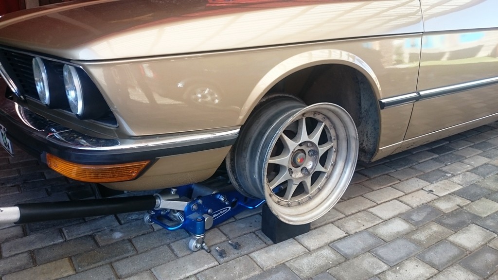

I did a deal on the wheels with individj a while ago..
Sparco 9's in 16" 8J, unsure of the offset but it's perfect.
I split the wheels today as I will be taking them in to be stripped of all the paint and brake dust build up before reassembling them and sending them in to be straightened and polished up.
I managed to borrow one center cap from a friend that has a 4x100 set (that's how I knew what they were).
