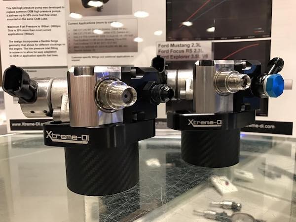

theres a company that has brought out hpfp for the n55 cars tuningtechfs/xdi
to my knowledge this is the only company on the market offering a hpfp upgrade
TTFS/XDI -35 HPFP Upgrade For N55
TTFS N55 Dual HPFP Factory Upgrade
but they between 2000-5000 dollars depending on which one you want they very expensive
http://tuningtechfs.com/ttfs-n55-dual-hpfp-factory-upgrade/
https://f30.bimmerpost.com/forums/showthread.php?t=1559938

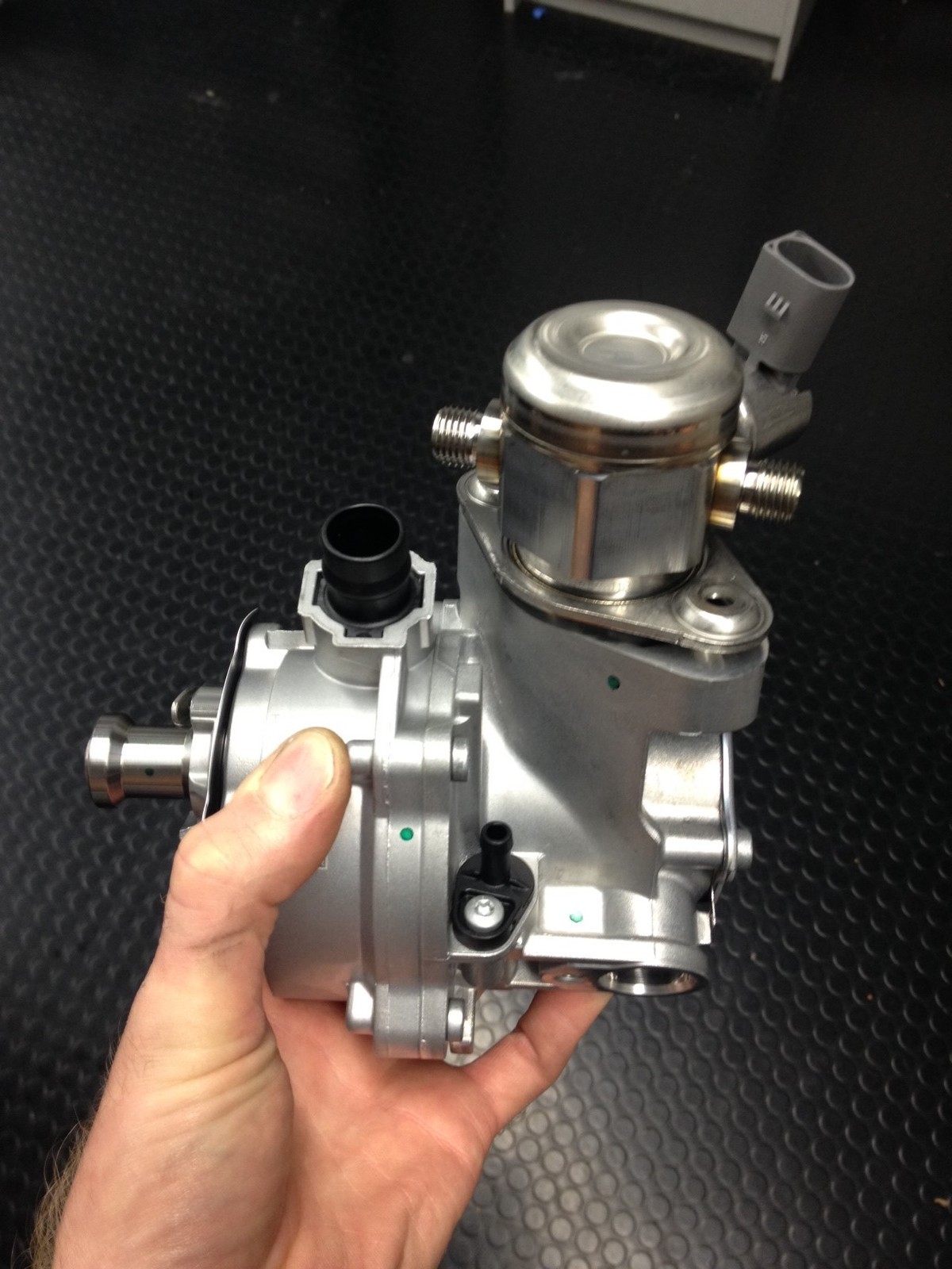

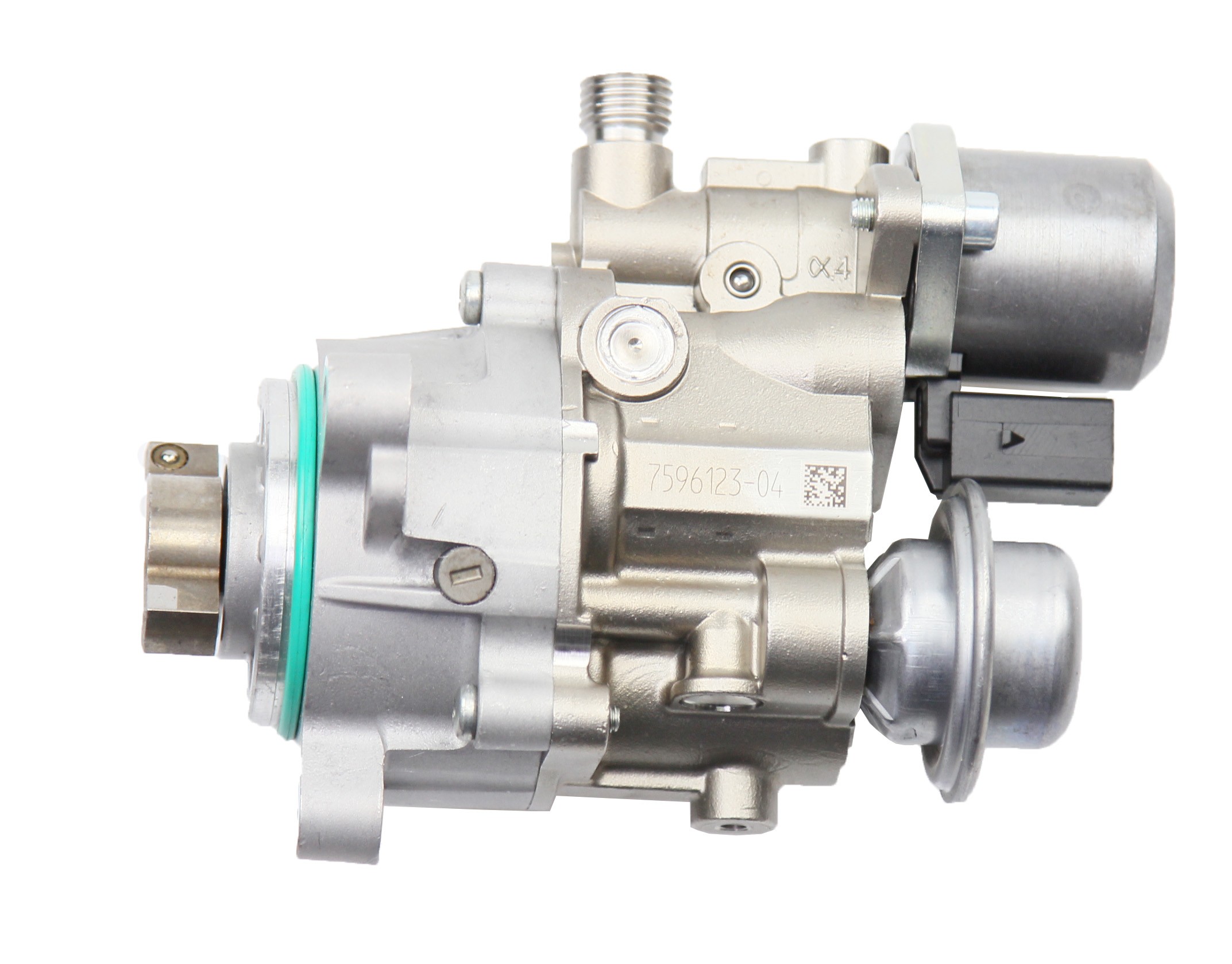

Hi, that figure seems plenty for that boost but how does your air fuel ratio look at that reading? The xdi pump upgrade is for the newer style hpfp, I think till 2012 135i had the n54 style pump. Old style
New style
The old style flows a bit more than new style btw.
