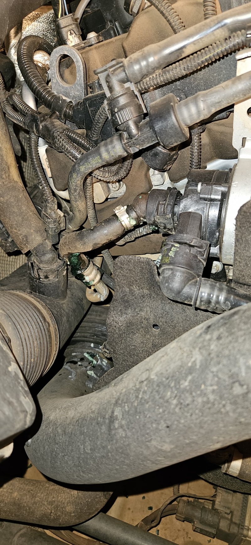

I have a 2017 F20 120i with the B48 engine. I keep getting coolant level low warning but then it goes away.
I lifter the engine cover to find a leaking coolant pipe. See pictures.

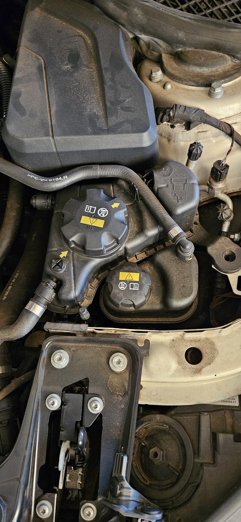

Is the black tank on the right of the engine bay for the coolant? I just need to fill it up with coolant to get it to BMW.
What exactly is the problem? I think it's the auxiliary pump for cooling the turbo.
Thankx in advance

Hi there
There's definitely a leak on what seems to be your coolant flange pipe. Look at the coolant residue. You can refill, but this will be a temporary solution. Let BMW run a pressure test to ascertain the source.

Hi,
Thankx. I see there is another leak and that this is a known fault of the B48 engine. I topped it up but the car is now running its coolant at 111°C which is a bit high I belive. Going graph the temperature when I drive and see whats going on.
Cant take it to BMW. They will charge me a small fortune to fix it. Going to have to get it fixed somewhere else.
