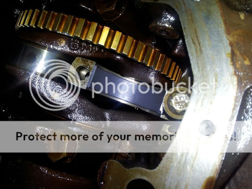

Car is an 03 with 165000Km.
Needed a suspension,brakes,vanos,clearances,bearings overhaul.
A few pics follow:

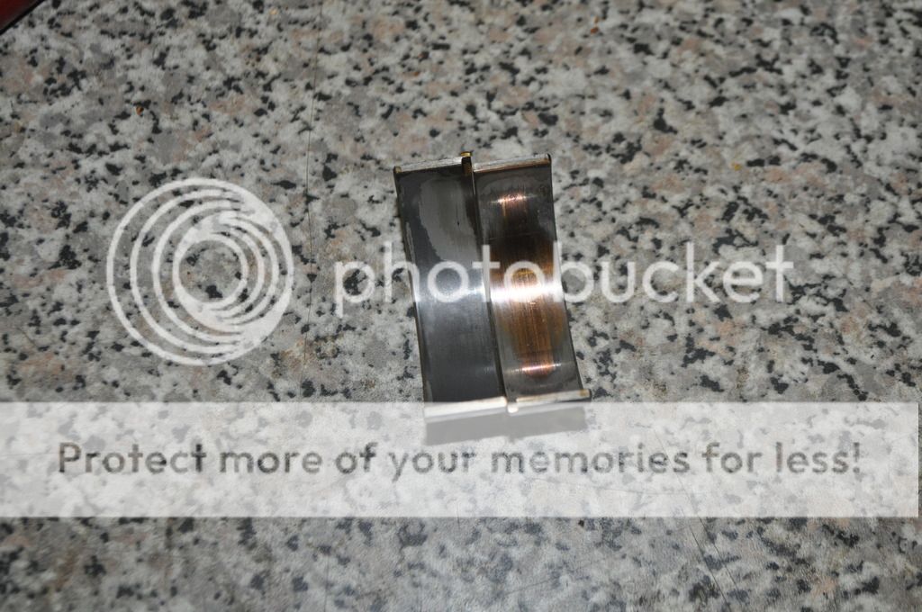

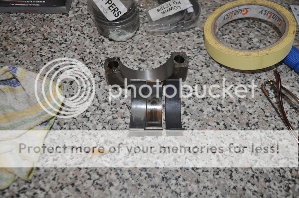

VAC bearings

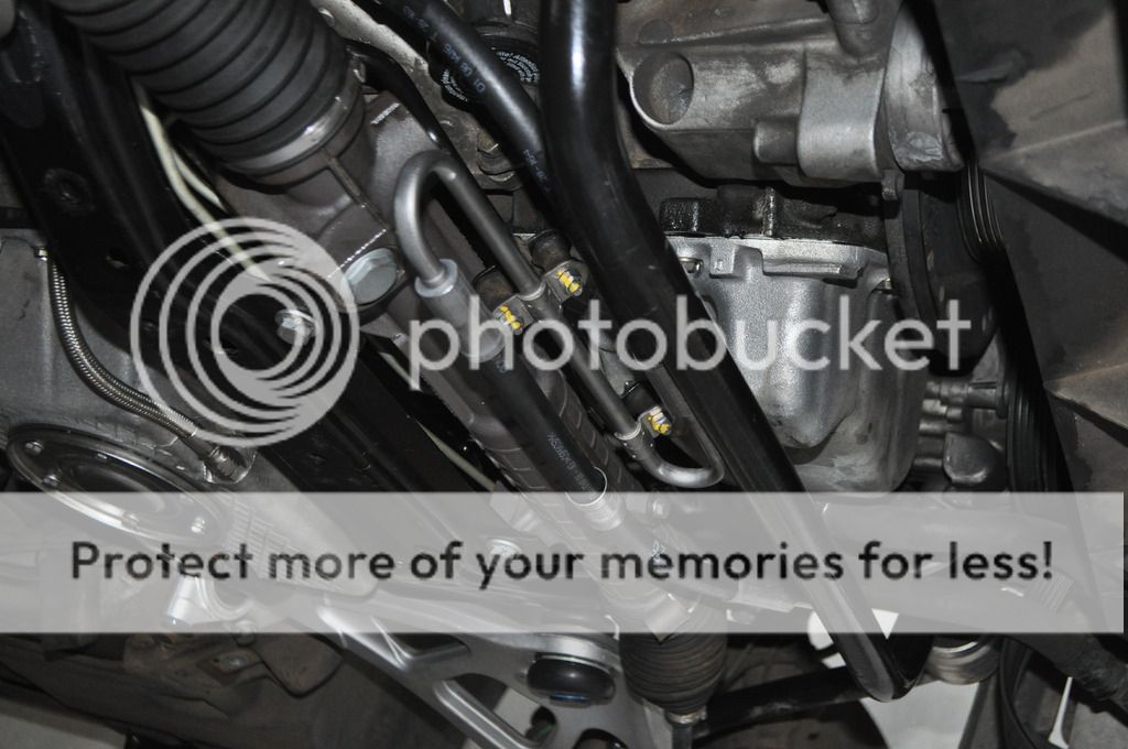

New power steering hose is now even more expensive compliments of a weaker rand

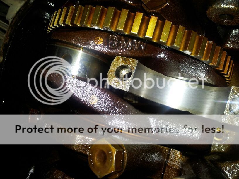

Is that normal wear on those bearings, or from any kind of abuse? And with that said, this being a 2003 model, facelift or pre-facelift?
Peter@AEW
Pre facelift and the bearing wear seems to be consistent with distance covered.
As to whether it was abused by previous owners...I have no answer.
Nikhil
They actually pretty decent condition for that mileage, many other S54's have gone knock knock at alot lower mileage. I would imagine that this car was shown mechanical sympathy.
Xack
I've seen between 90 and 100k on prefaclifts hey:blueCry:
Nikhil
Exactly! Is this your time bomb Xack :fencelook:
