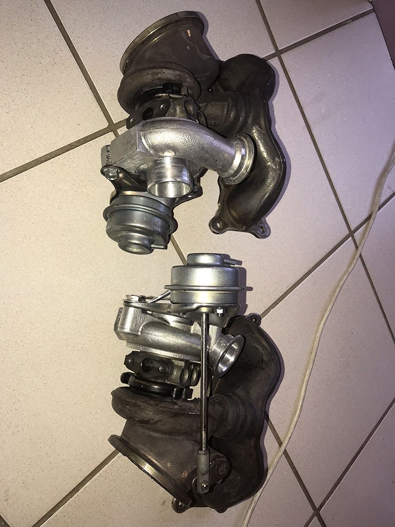

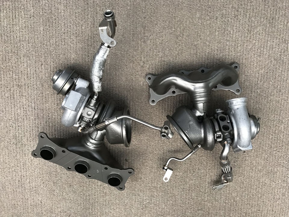

Here are the set of old turbos I bought from Justin
Mamba kit

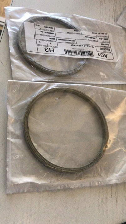

Gaskets for downpipes

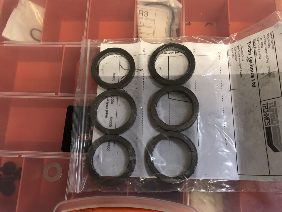

Turbo gaskets

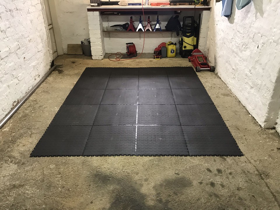

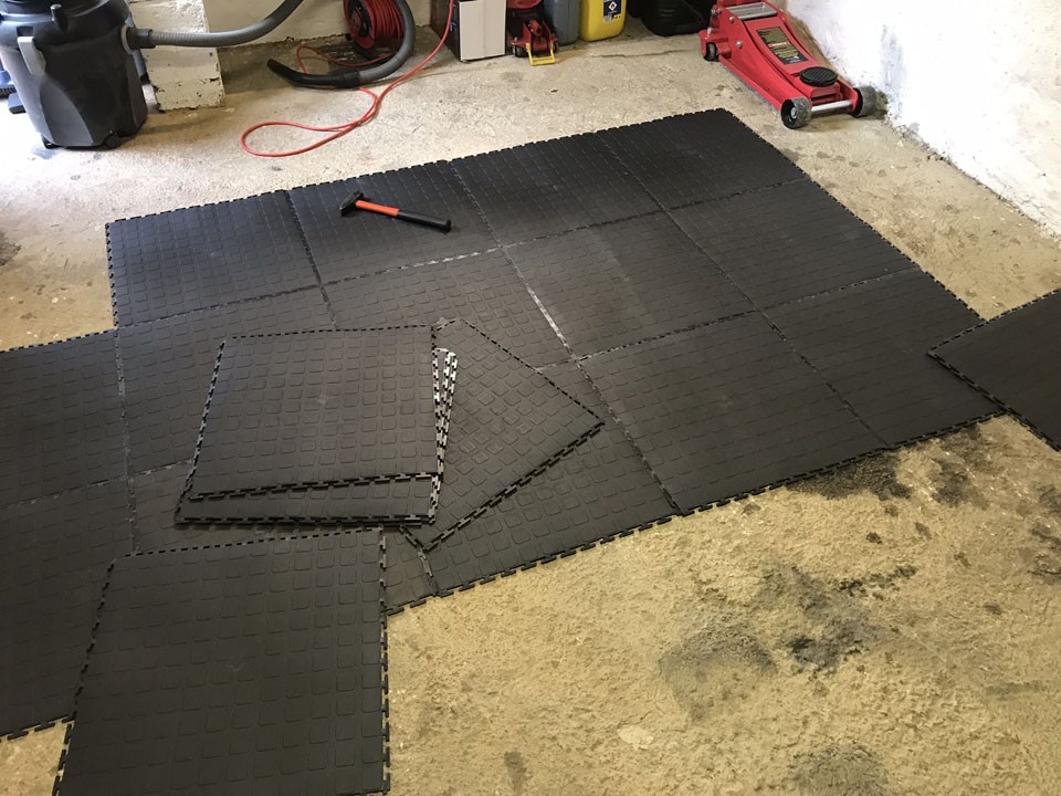

Right time to get the garage workable as I only have a single garage with a shitty rough concrete floor and I wasn't about to take on a job like this under these conditions! :roflol:
And done, this will do! Yes I will add more at a later stage.

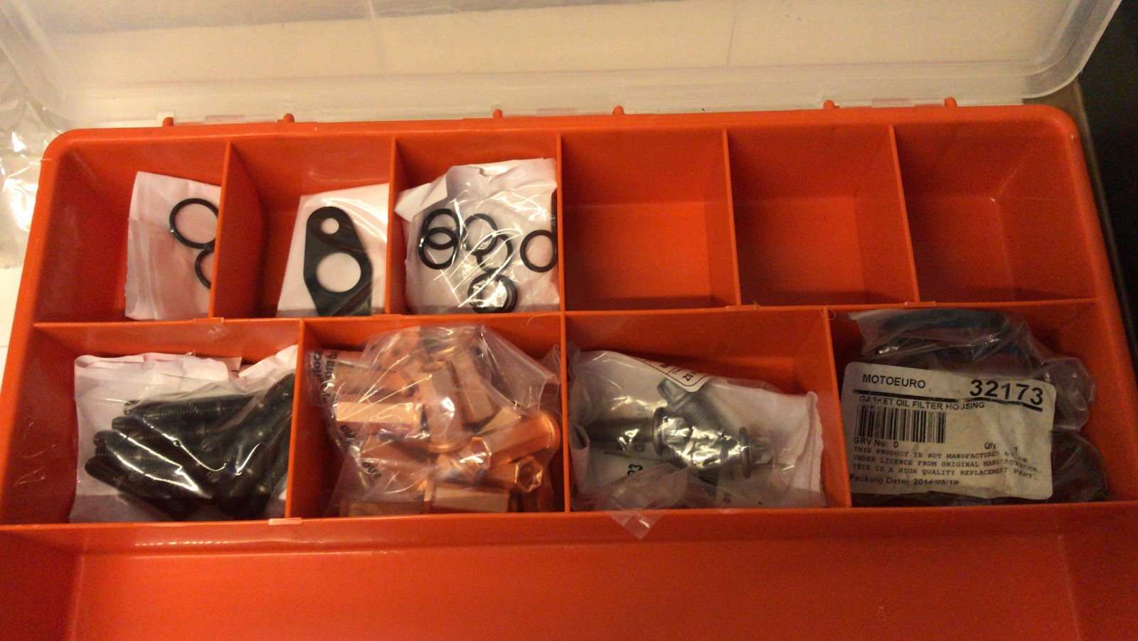

and onto all the bits and pieces for the install:

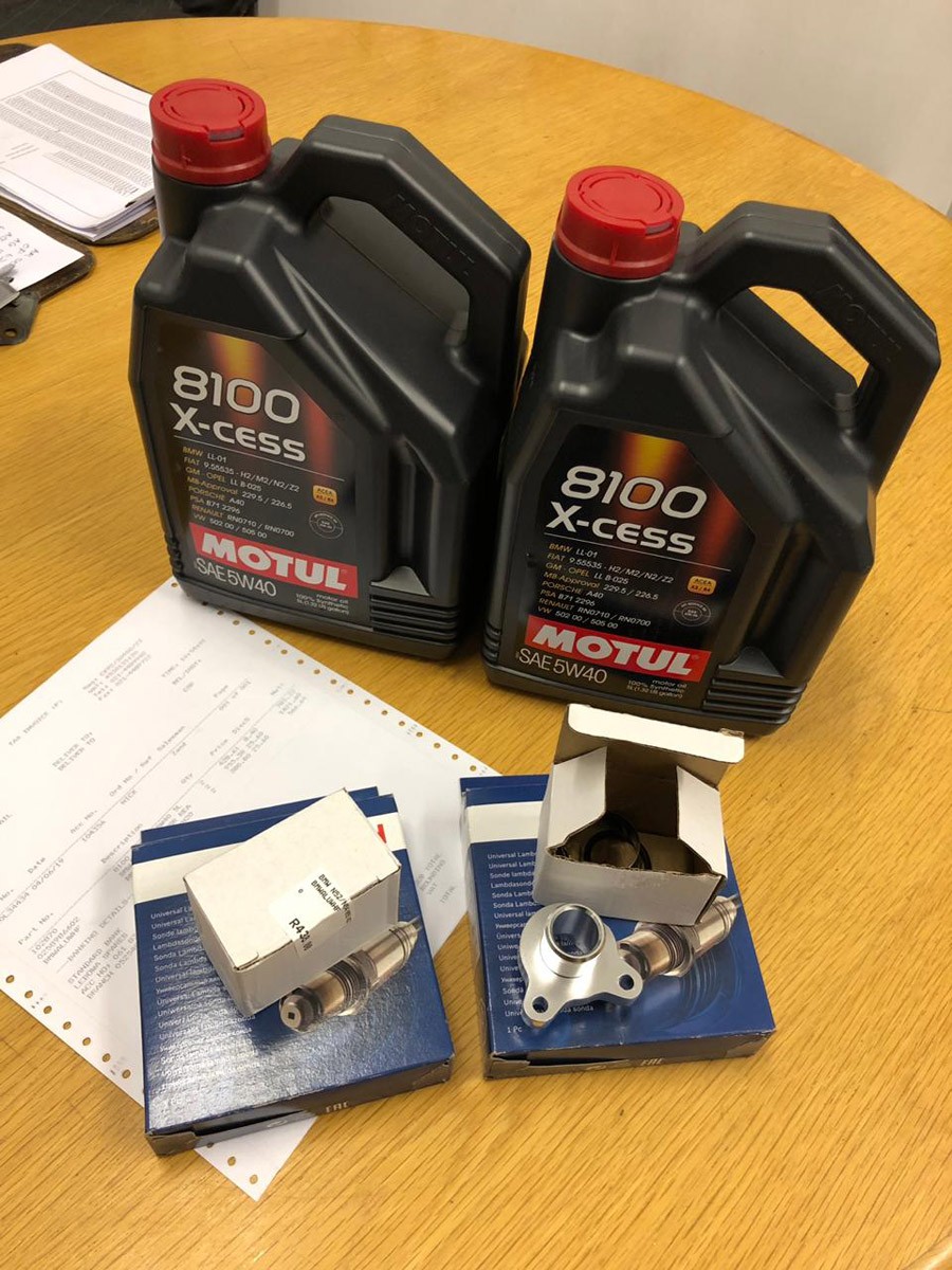

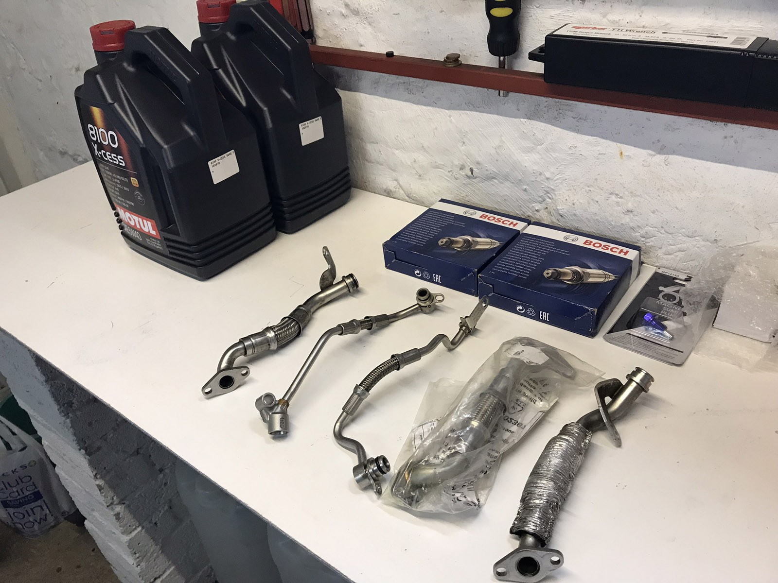

Oil and oil feed and return lines and upgraded coolant hose connector to engine block all supplied by Zander, very cool guy to deal with, great quick service! Thanks man.

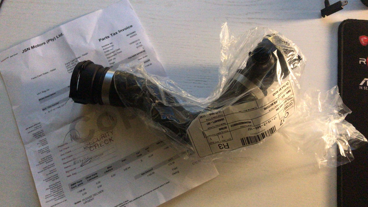

This was the last item I bought as when installing the new inlets we disconnected this top radiator hose and when we fitted it back the bladdy thing started leaking, turns out orings say howzit after ten years :fencelook:

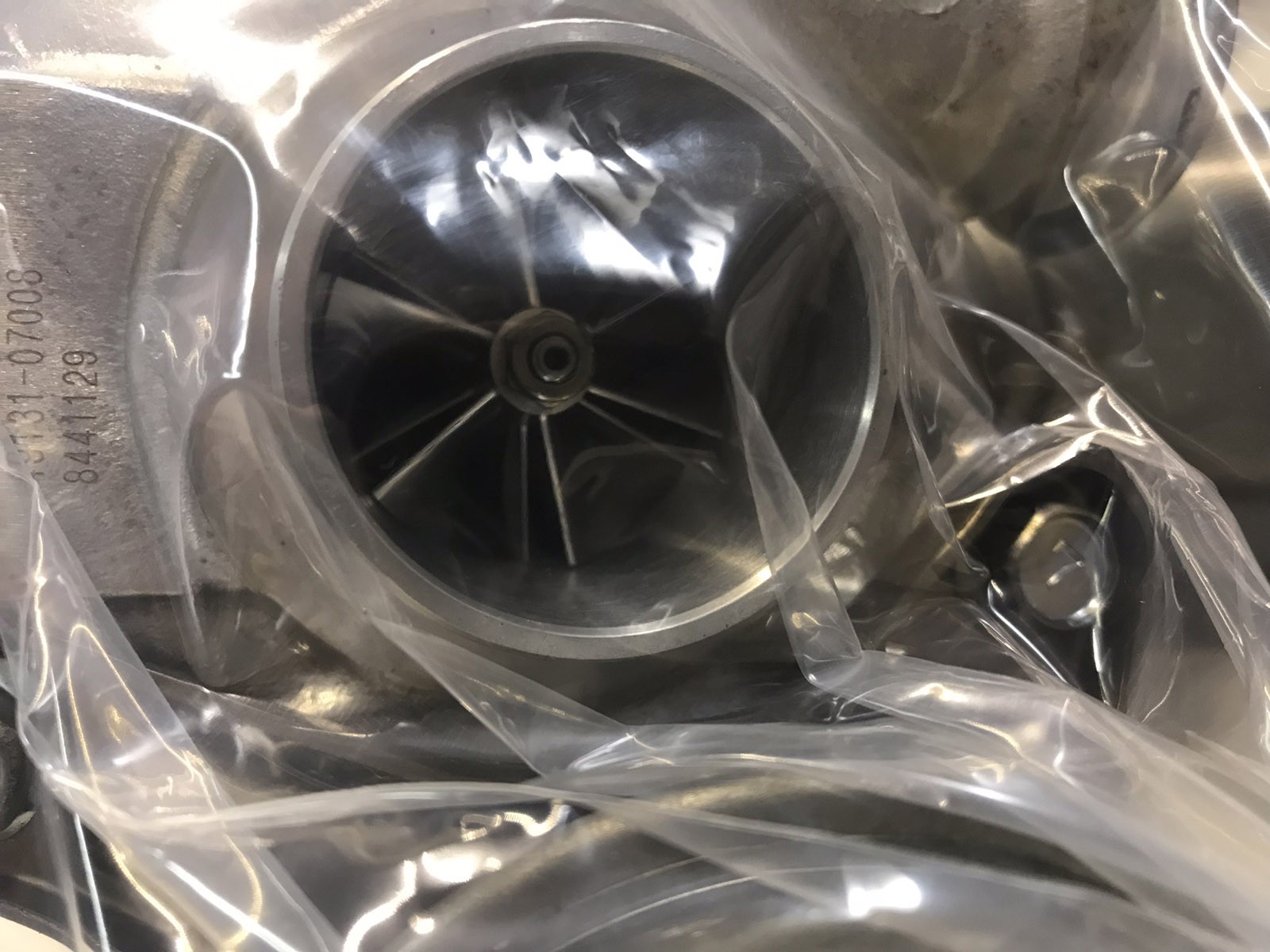

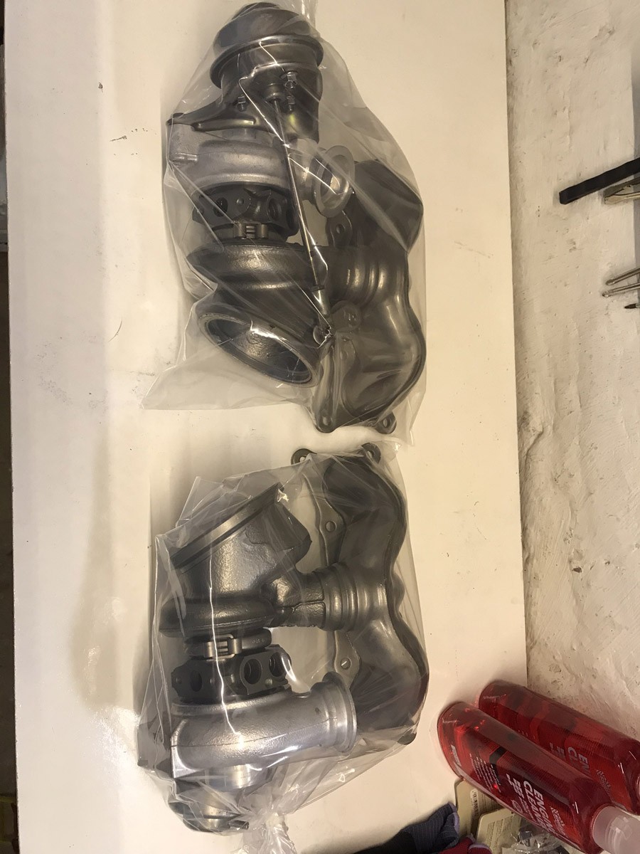

Sent the turbos I got from Justin to Gabby at Fastec for assembly of the Mamba kit and balancing! He did an outstanding job so big ups to him for such awesome work!

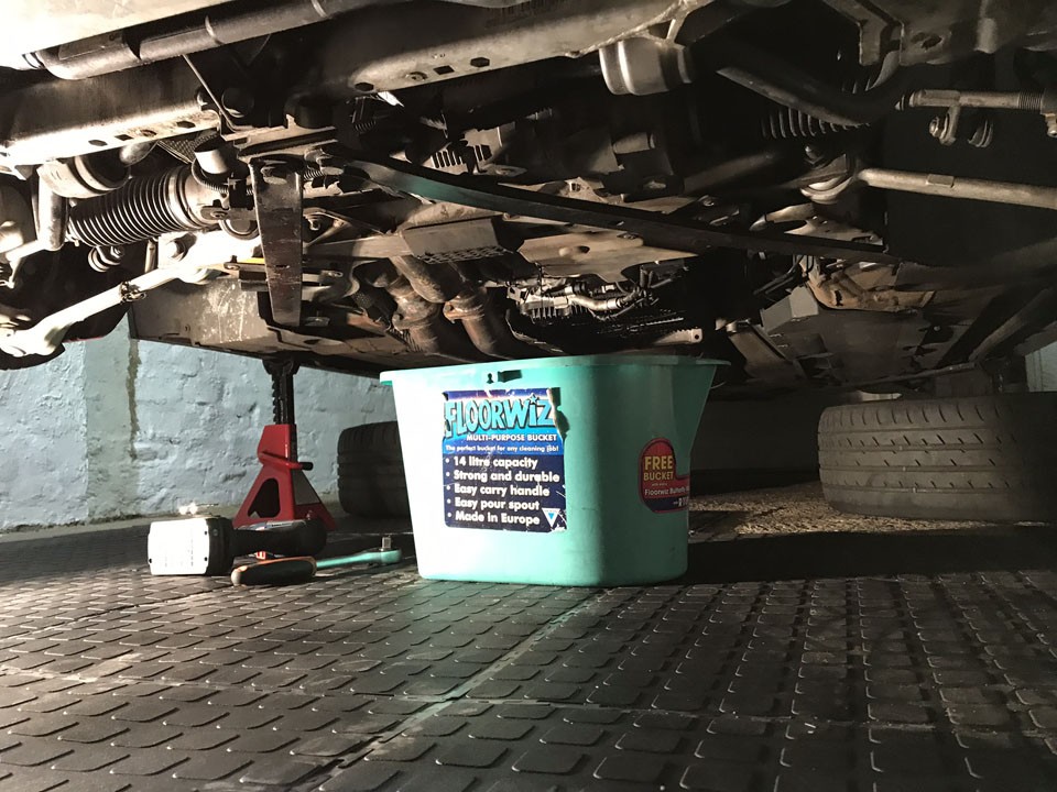

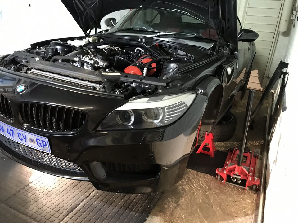

Car properly jacked up onto 4 jack stands as high as they can go for good clearance!
A view of the clearance I was able to achieve!
Draining of oil

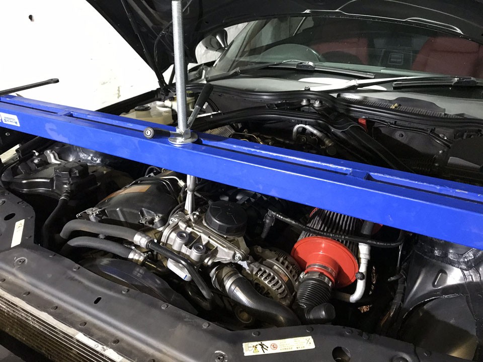

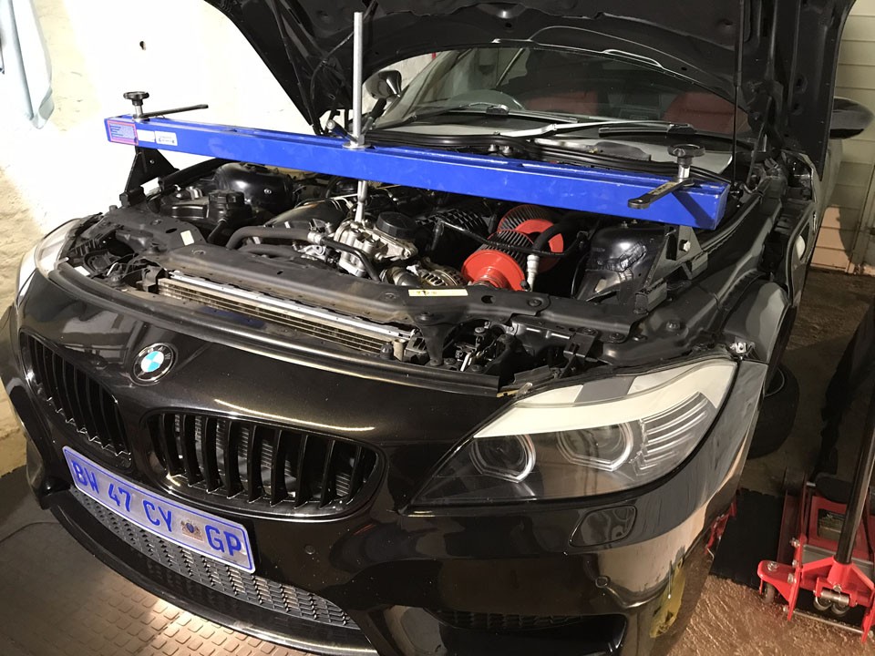

Went out and bought myself an engine Brace/hoist thingamajig and Thanks to Justin for helping me get it on the car, we struggled with this as the brace isn't high enough for this engine so it was a bit of a balancing act but we got it right in the end.
Then I got to work with stripping the hell out of the car to get at the turbos:

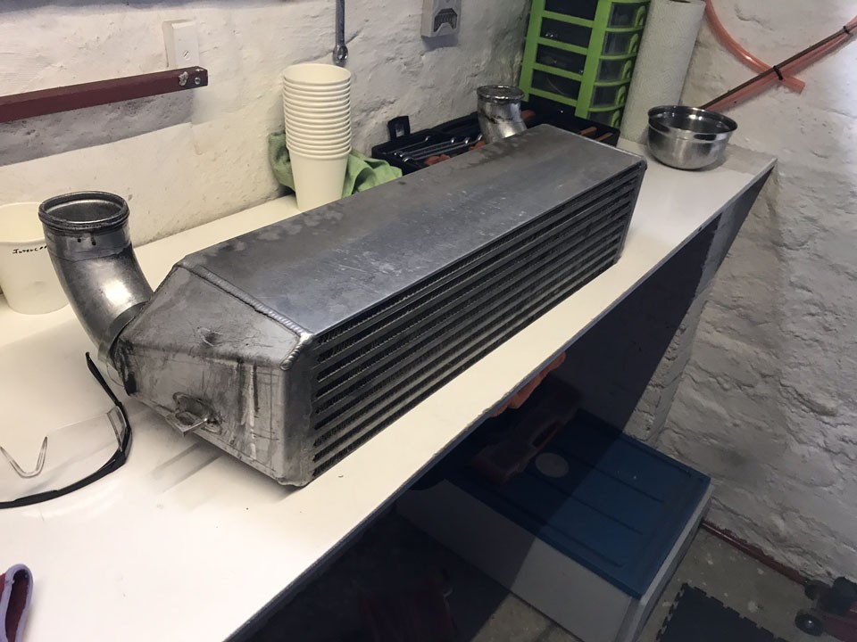

First thing to come off is the intercooler so that I could drain the coolant from the radiator!

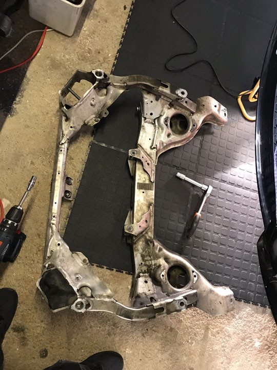

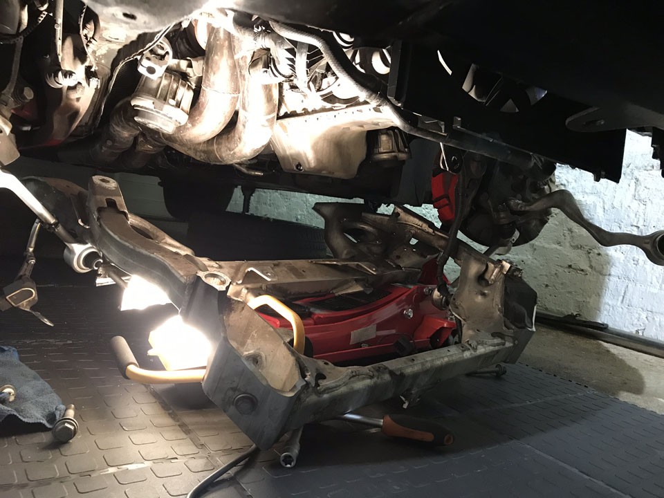

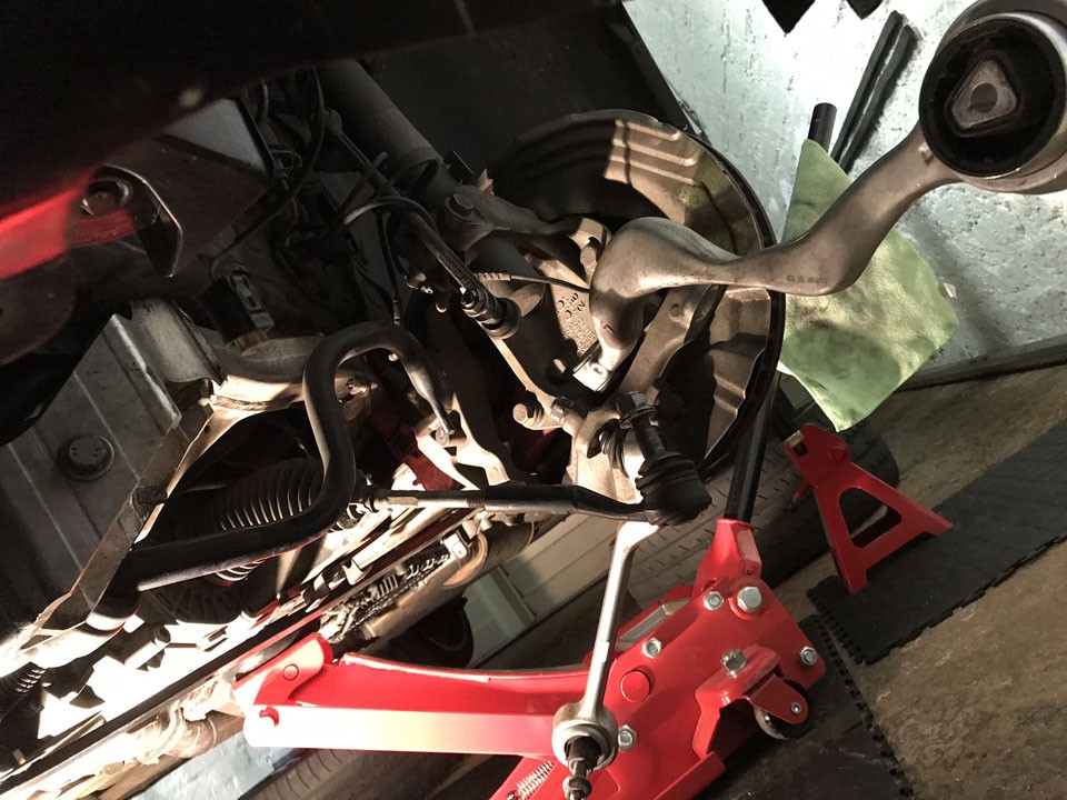

Next up control arms and all that suspension bits to try free the subframe.

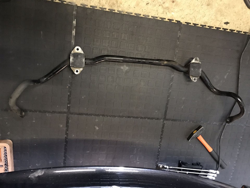

Sway bar off!

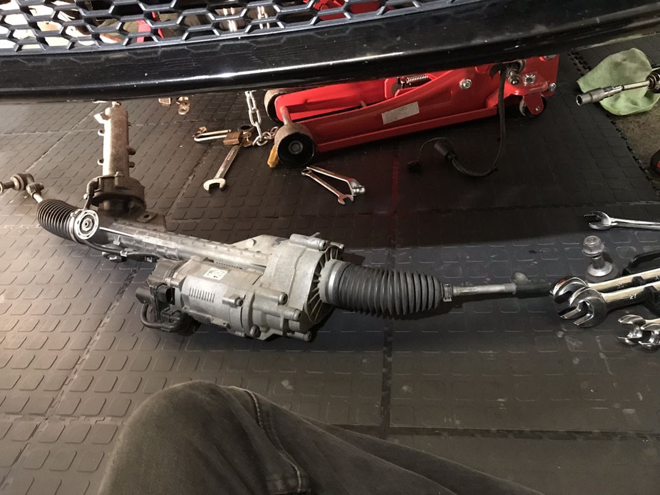

Steering rack off! This took me a good 2 hours to get off as it wouldn't free itself from the spline U-join! was a proper PITA! But alas it came off.

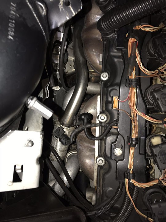

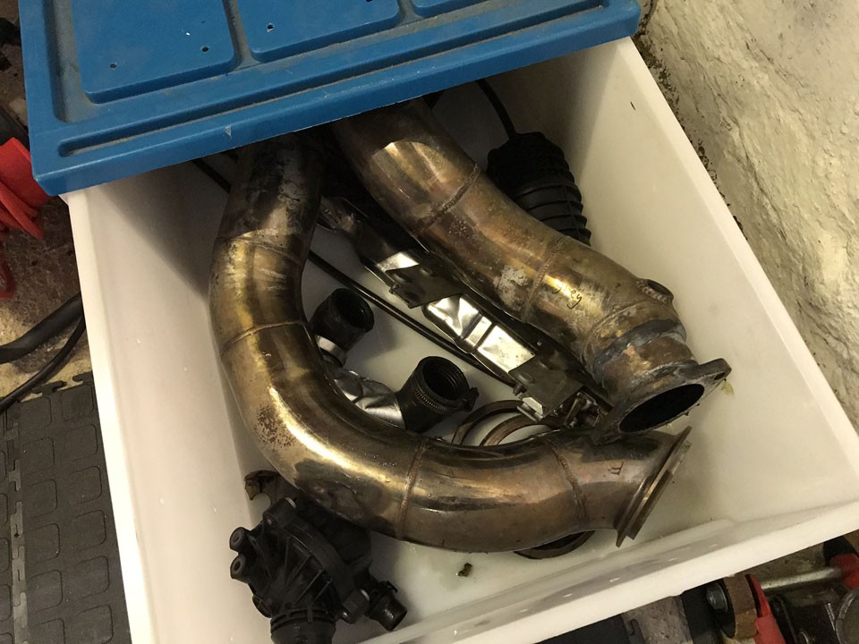

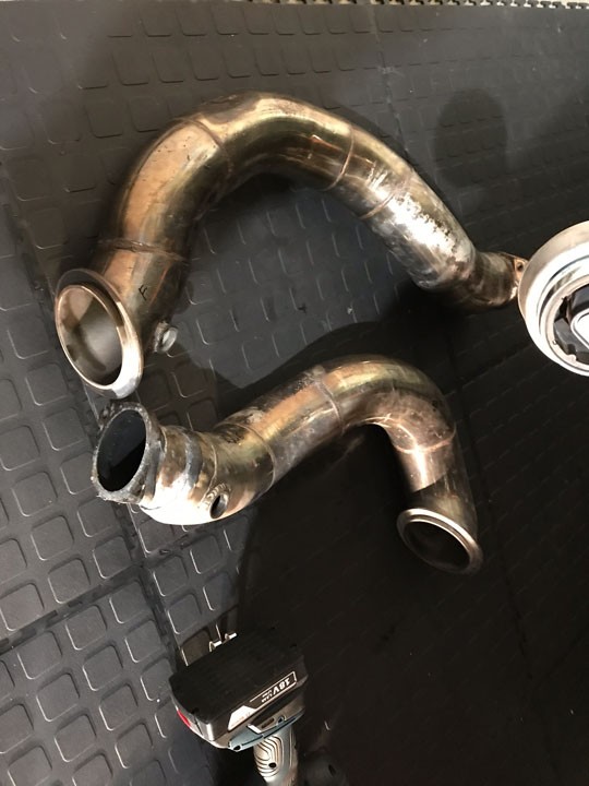

Down pipes off! This was next level PITA cause of the bolts on the exhaust being very difficult to get to and one of them was stripped!

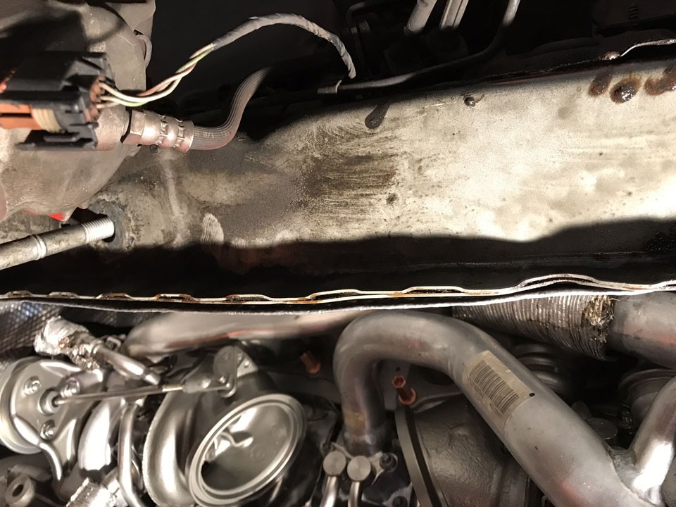

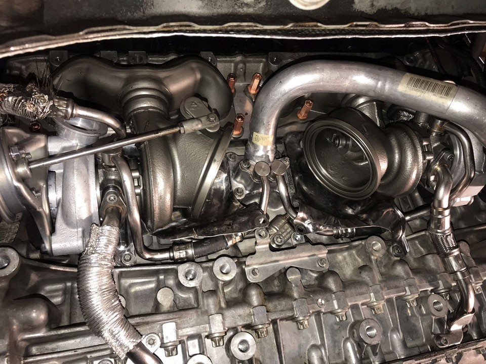

First view of the turbos, water pump still on and engine mount!

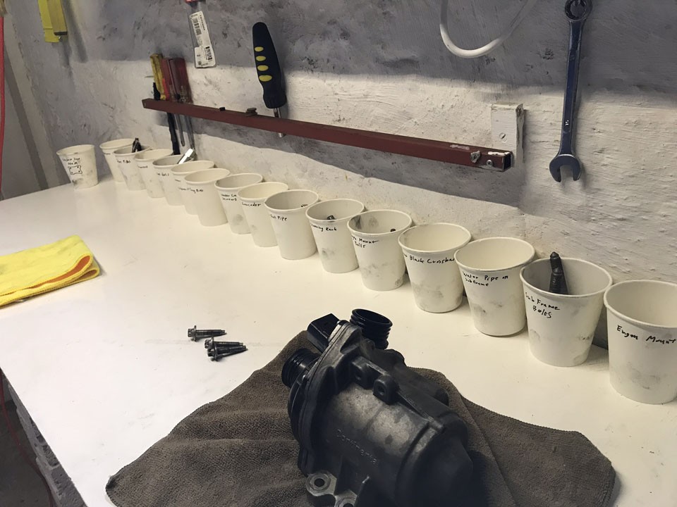

Water pump out and a nice view of my sorting cups :smilebounce: (yes there will be no unaccounted nuts, bolts or screws upon reinstall!)
Bam! We at them Turbos!!! :thumbs:

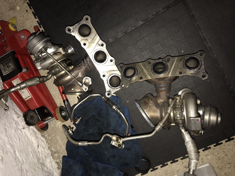

Right Next day and my buddy Justin rocked up again with his T50 torx bit and helped me strip the turbos off the car and start removing the engine exhaust studs and what ever else needed to be stripped from the motor!

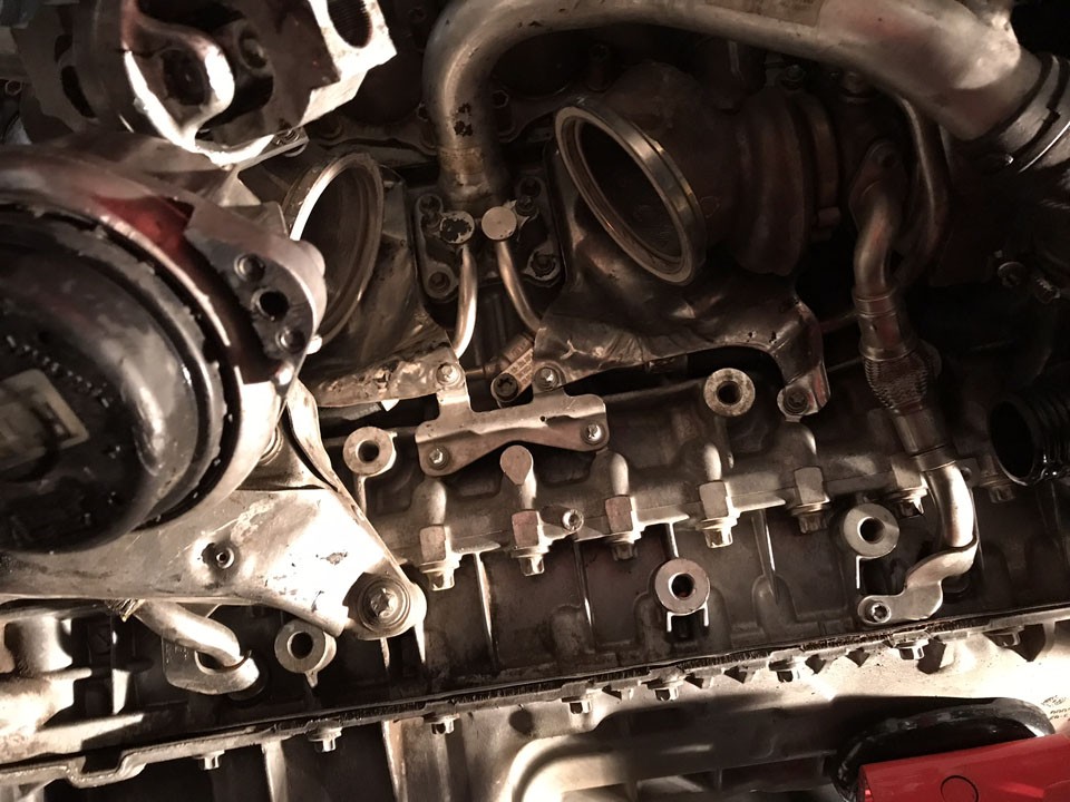

Turbos removed! Finally

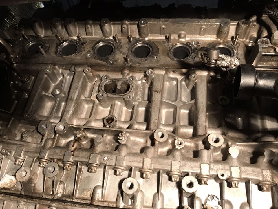

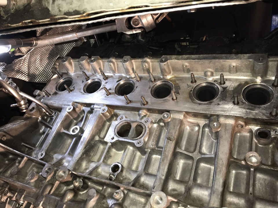

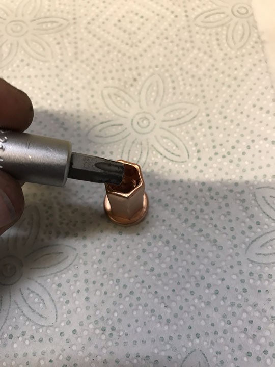

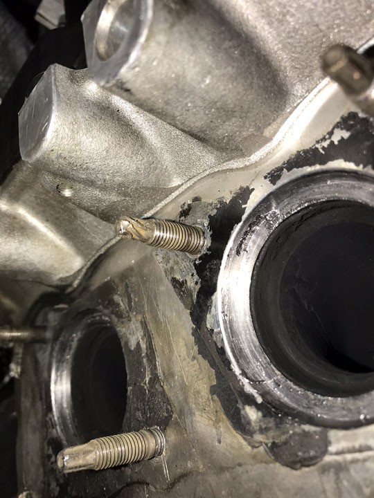

Now onto the studs! Now this is where things go pear shaped as dear old BMW over tightened these guys massively! They are only supposed to be torqued to 10nm! I think they managed to torque the one stud to 100nm :rage:
The state of some of these studs!
So at this point we tried the two nut method which worked for all the studs except one which was so tight that even my vice grip didn't work so I had to call in the pros. The thread king rocked up at my house the following morning and tried to remove the stud, he almost had to resort to drilling it out but tried one last trick and managed to remove it! Thank goodness as this kept me up with stress the night before!

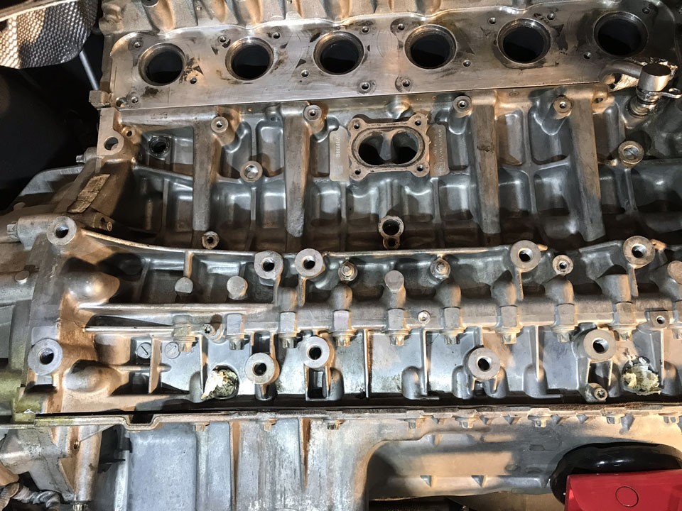

Studs removed and I scraped all the sealant that bmw used for some reason! I then got very smooth grit sand paper with a sanding block and lightly sanded the surface to clean it nicely.
New studs fitted with copper paste at 10nm. The correct way!

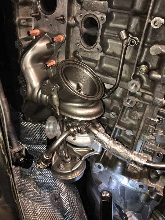

First turbo is on! :thumbs:
At this point Justin rocked up and helped me with the rest of the build that day, so we got the next turbo on together which made life so much simpler as its a bit of a balancing act doing this on your own on your back especially with the top bolts.
Second turbo on and all lines fitted!

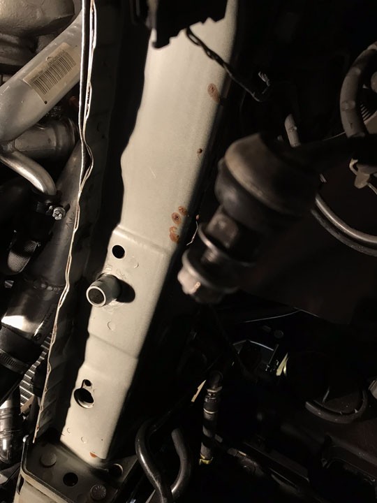

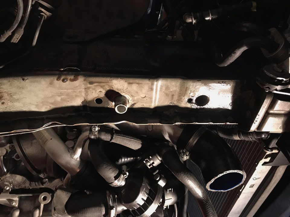

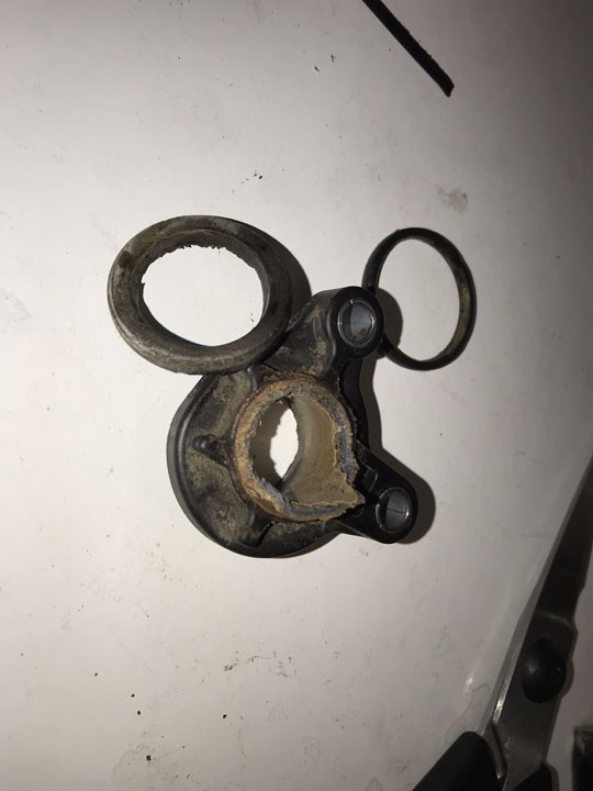

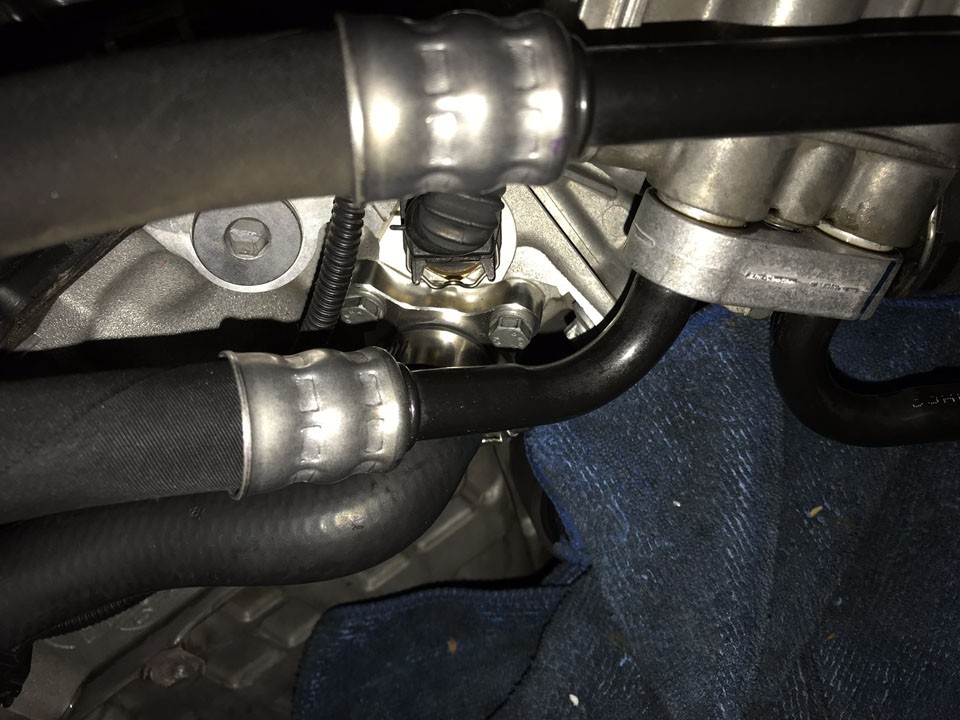

As expected this water hose connector broke when we disconnected it to fit my upgraded billet replacement part supplied by Zander!
Here it is installed! I would like to just add that this was a very difficult part to install due to the angle, it took Justin and I a good 2 - 3 hours of struggling to get this part to go in as the oring is so thick! But it was worth it as this part is prone to breaking always

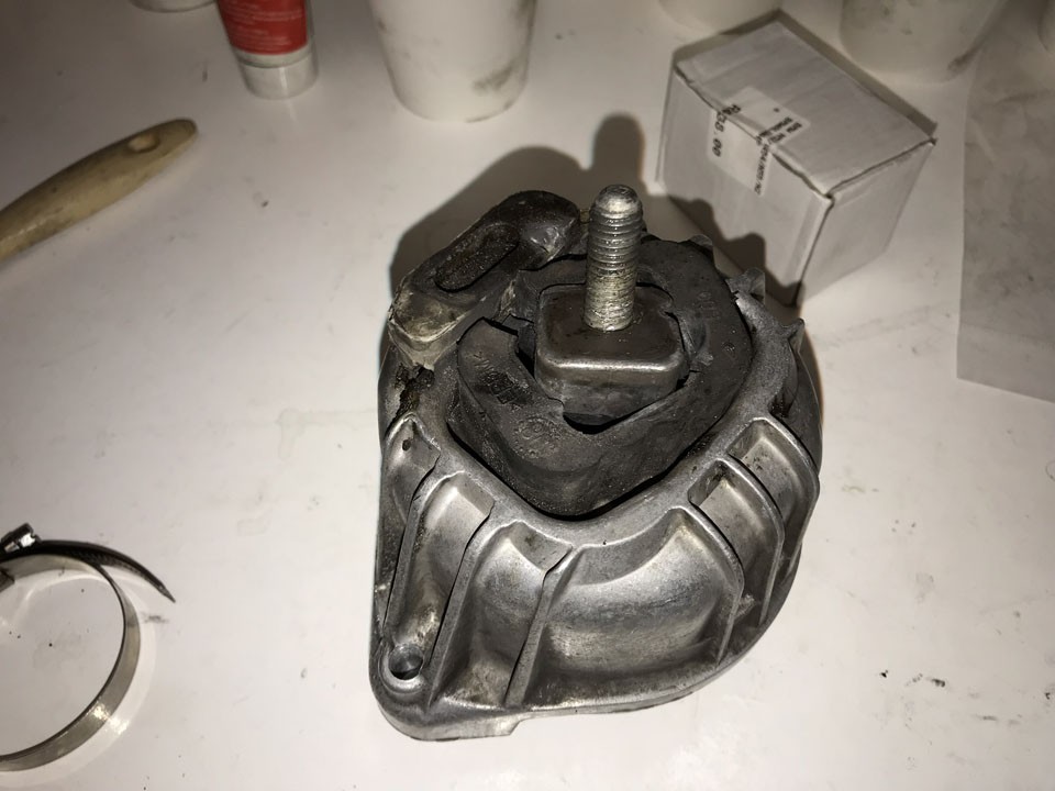

Always wandered why my car had this annoying knocking sound when driving over uneven ground or going over speed bumps! Check the state of this engine mount!
Well I ordered both left and right engine mounts and replaced them. two months ago I replaced upper and lower control arms too as well as rear discs, So this should tighten things up even more!

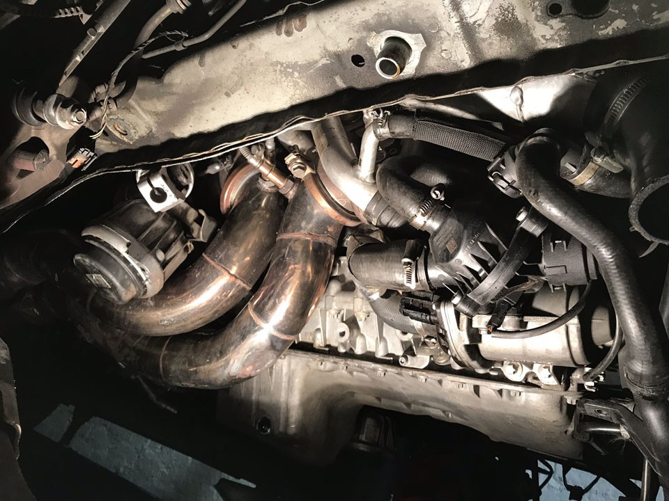

Downpipes on and new engine mounts:

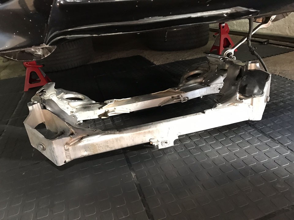

Cleaned subframe ready to go up!
The rest was videos which ill upload as soon as I have put it all together. We finished putting the subframe back and steering rack and all the suspension bits with inlets and all that jazz and filled with new coolant and bled the system to make sure of no leaks. We had non after fitting the new Radiator hose.

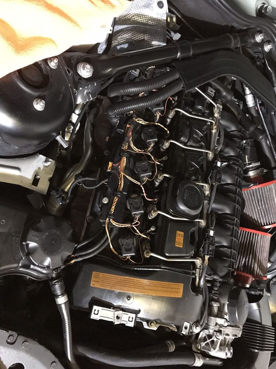

Then I put new Motul oil in the car with a new oil filter and we then disconnected the coils and injectors and gave the car a couple cranks to prime the turbos with oil.
We then connected it all up, double checked everything and then started the car for the first time and it was a great success :smilebounce:

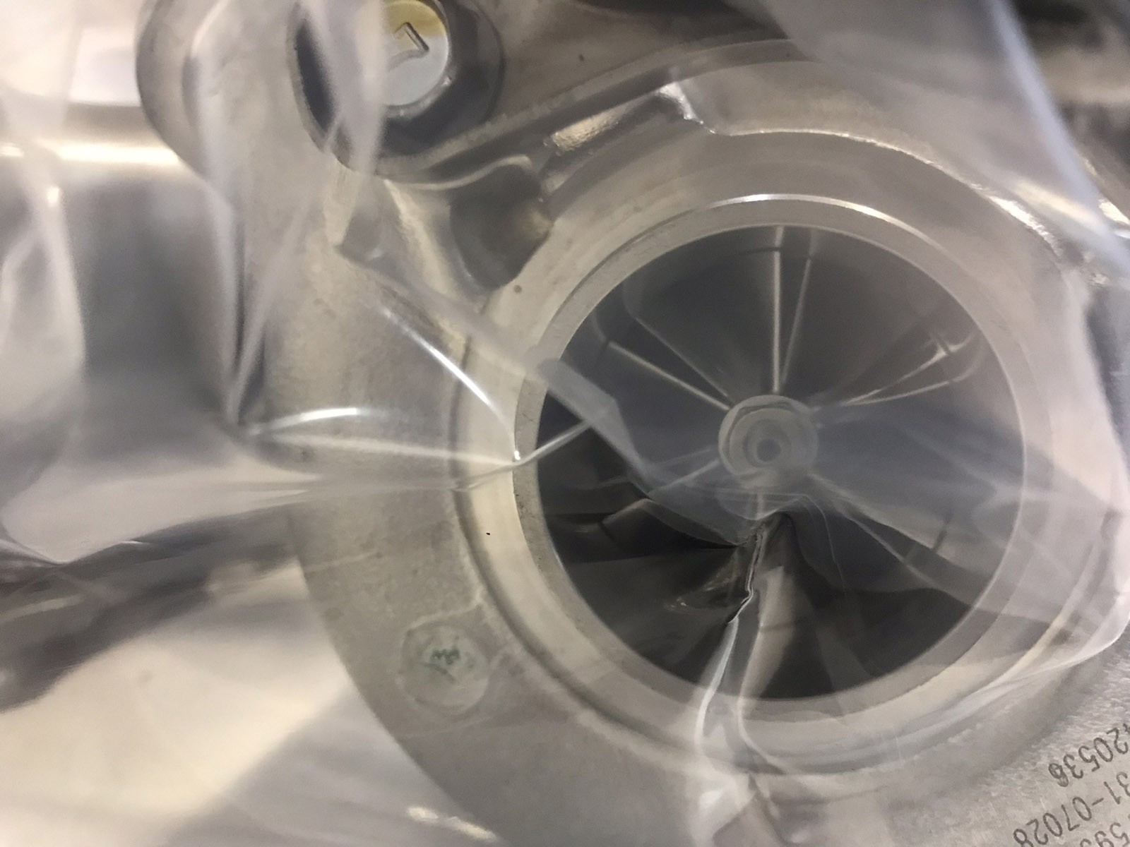

Mamba kit

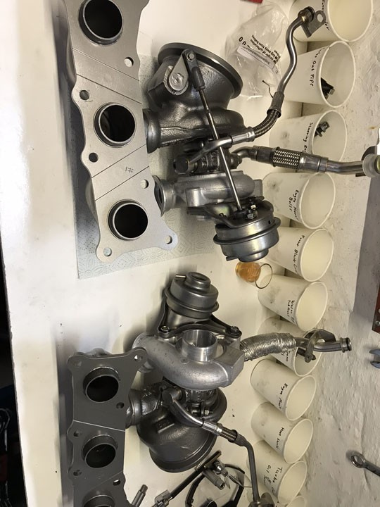

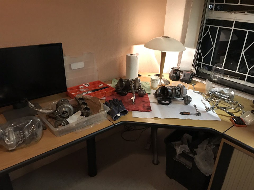

Getting ready for the install, cleaning and organizing!

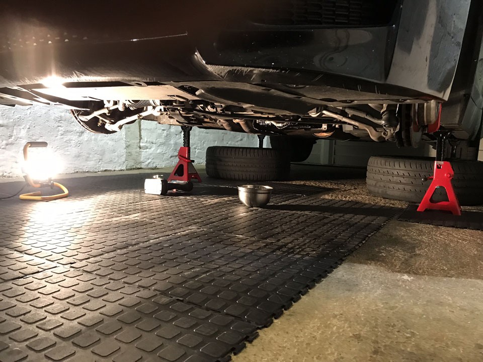

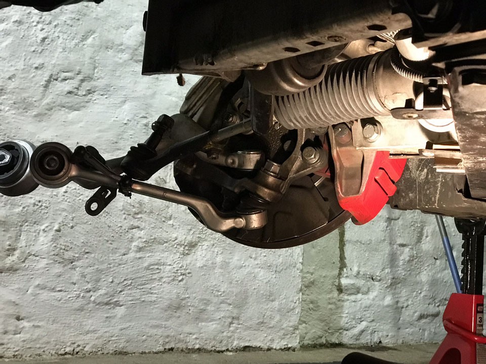

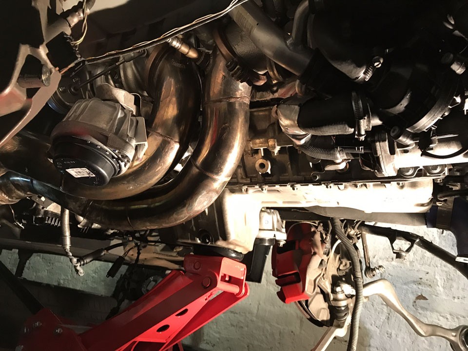

Sway bar off!
