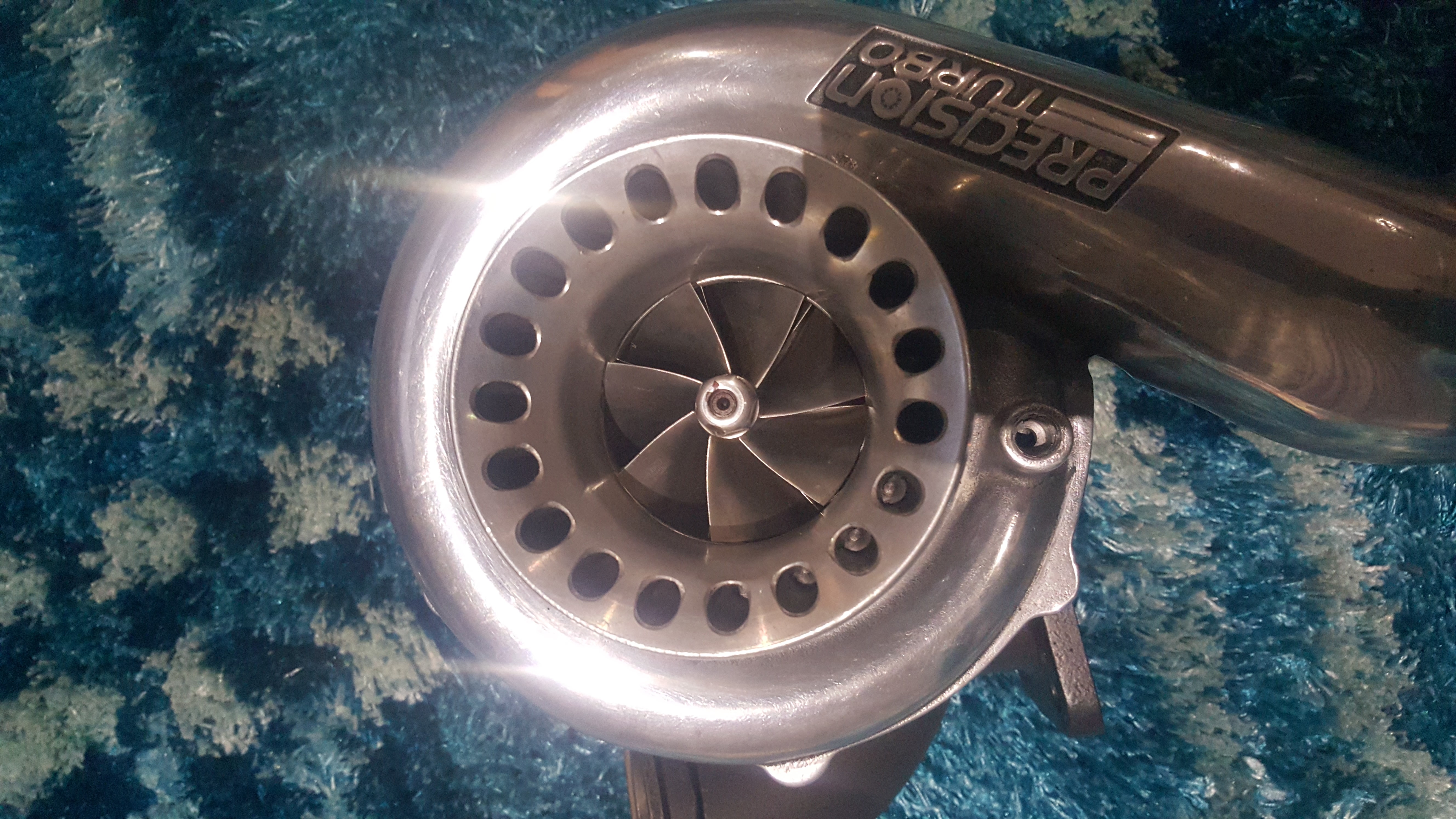

It started with me acquiring a PTE 6262 and Precison 46mm wastegate. A good point to note is that prior to this point I was already FBO.

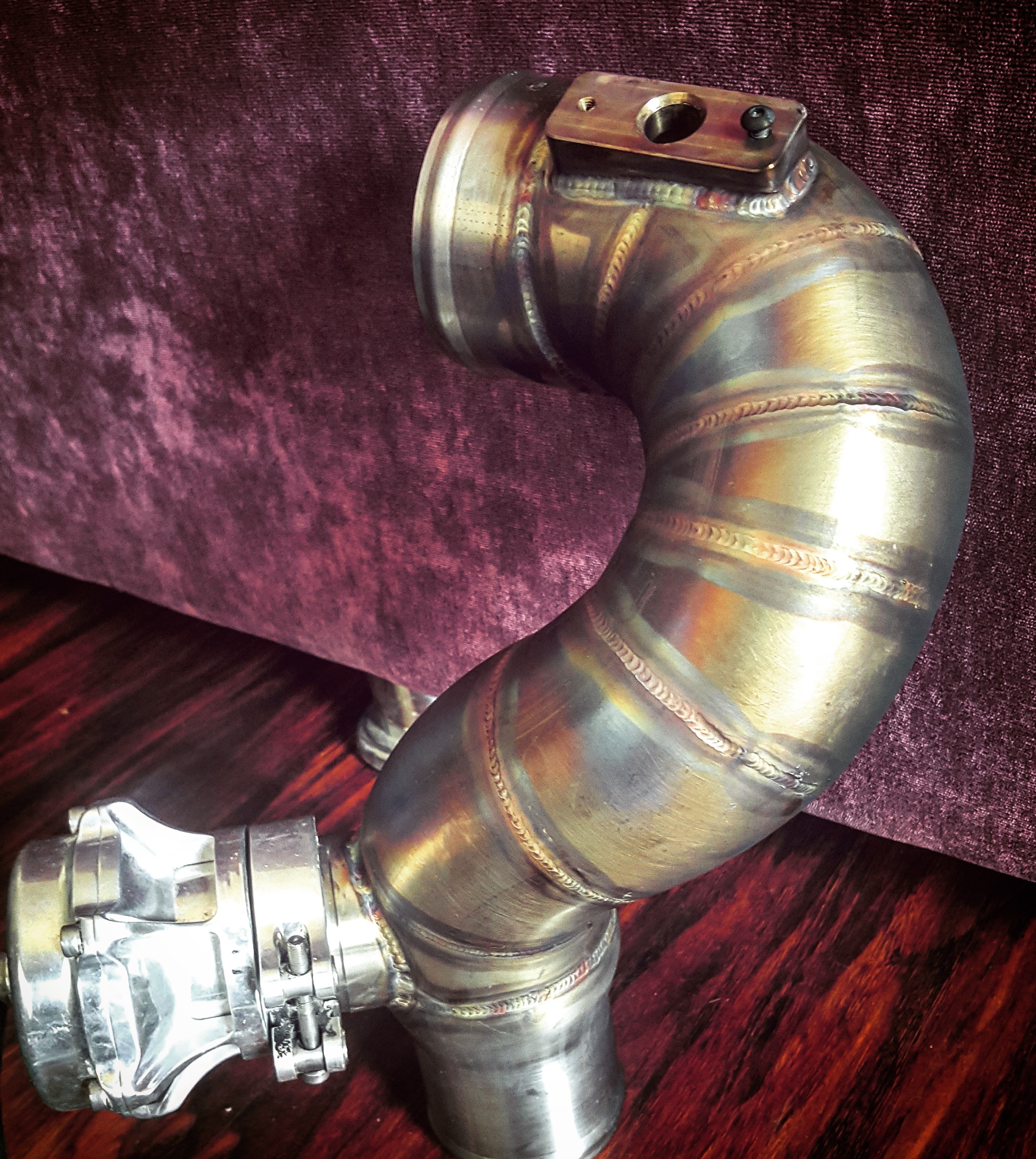

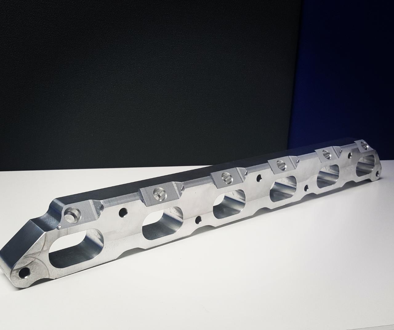

Together with a very good friend of mines we built the very first top mount manifold this country has seen for the N54 platform.
the challenge was not only the steering column but positioning of the wastegate and inclusion of the downpipes.
with the manifold requiring some slight modifications as it was built remotely we eventually managed to get it into the car:smilebounce: and start the process of assembling the car

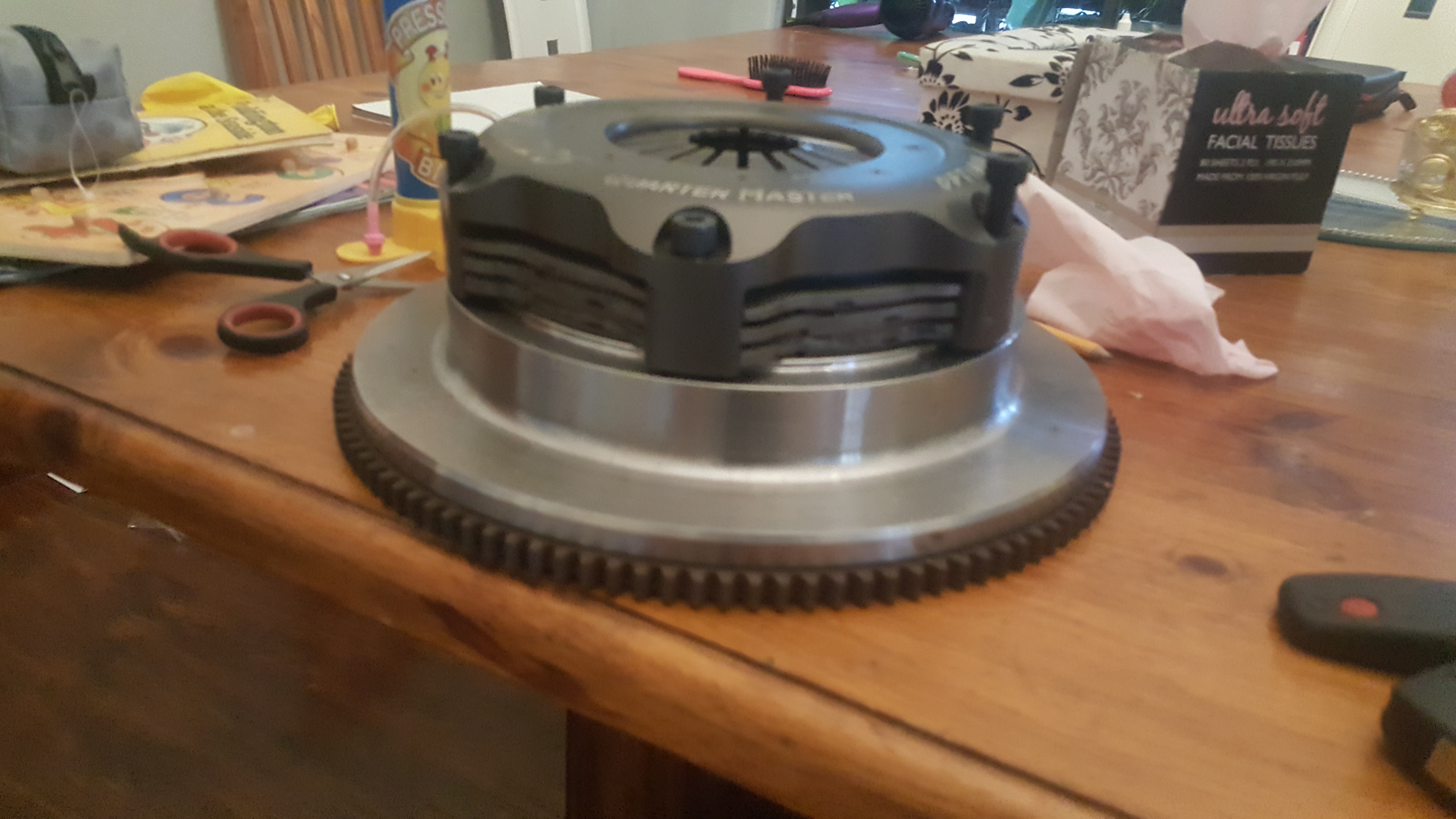

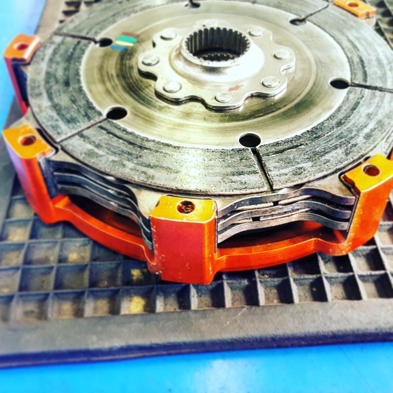

with the ultimate goal of chasing down horse power I need a solution for the clutch and quickly..so I fabricated my own flywheel as well as purchased a tipple pack clutch...this was now the ultimate in street car clutches. for some reason my gears felt so much more direct and together with a short shifter kit, I could finally put the power down smoothly

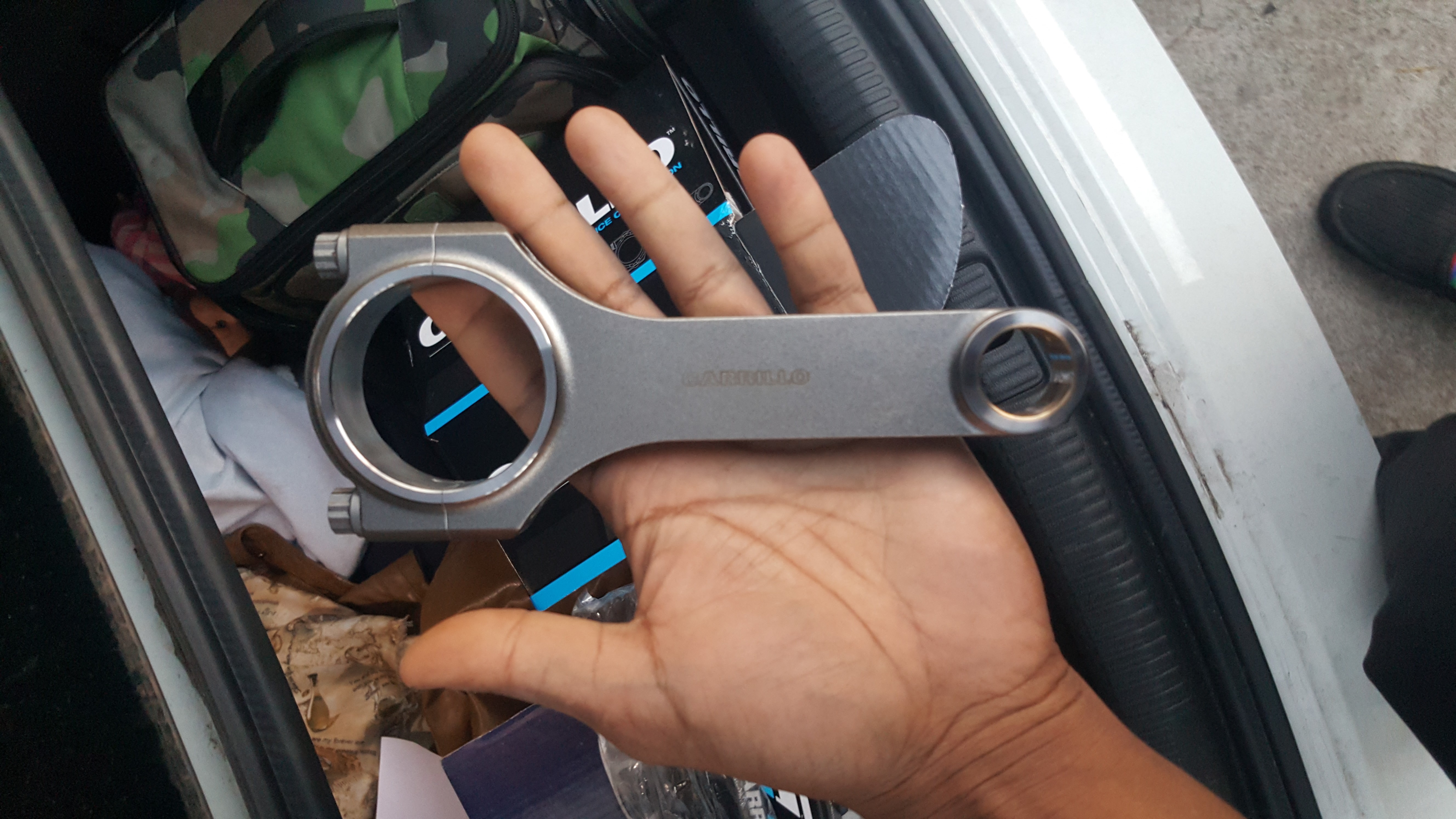

So all of this what i mentioned took place over the last 2 years. Having pushed the boundaries of what i thought was possible and what wasn't i have so many people to thank but that i will leave for last. For now a decision needed to made, do i forge the motor? and the answer to that was a simple YES.
So the parts list for 2017 was as follows:

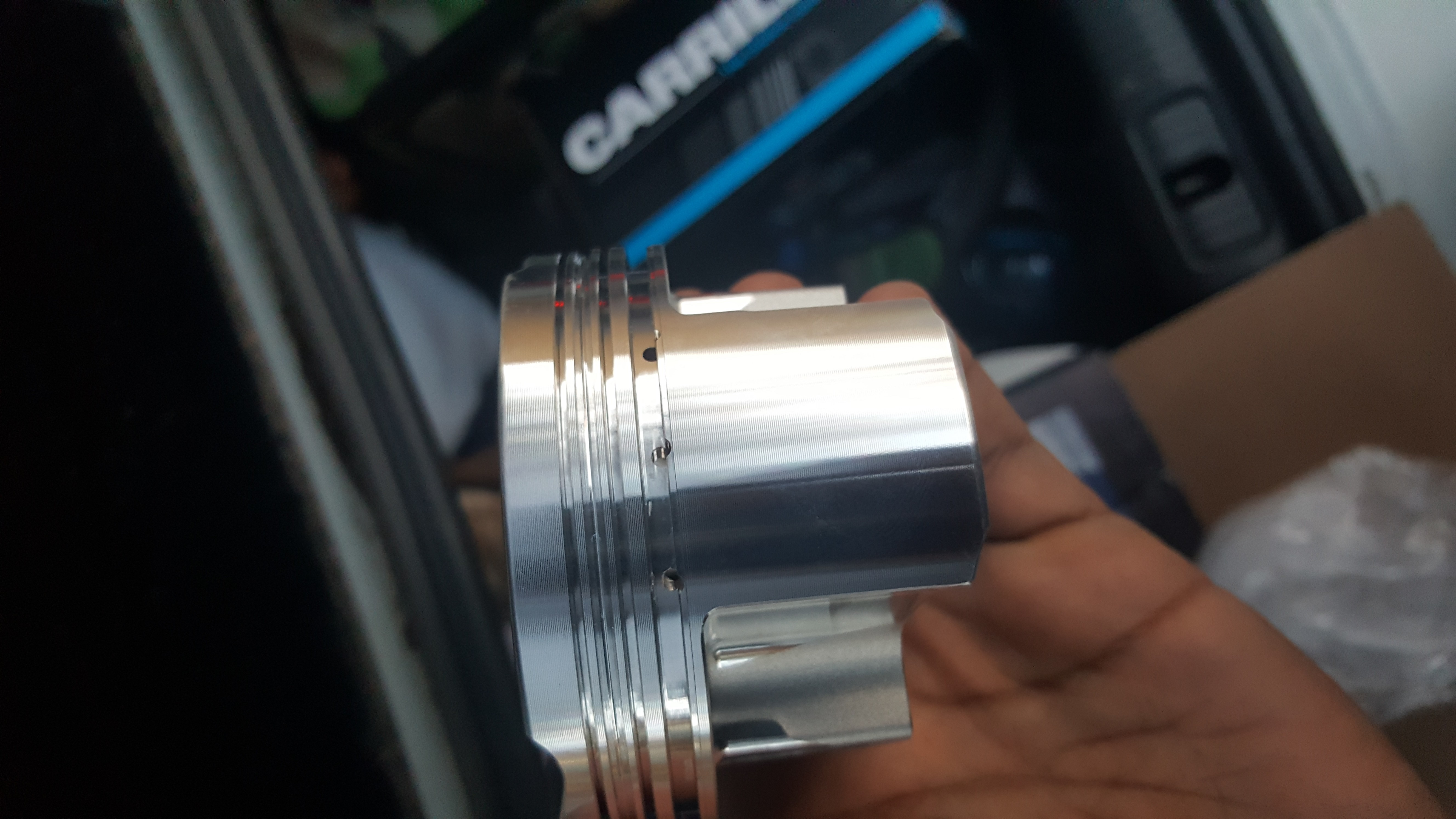

1. Corrello rods
2. JE pistons
3. Precision race coils
4. TFT charge pipe

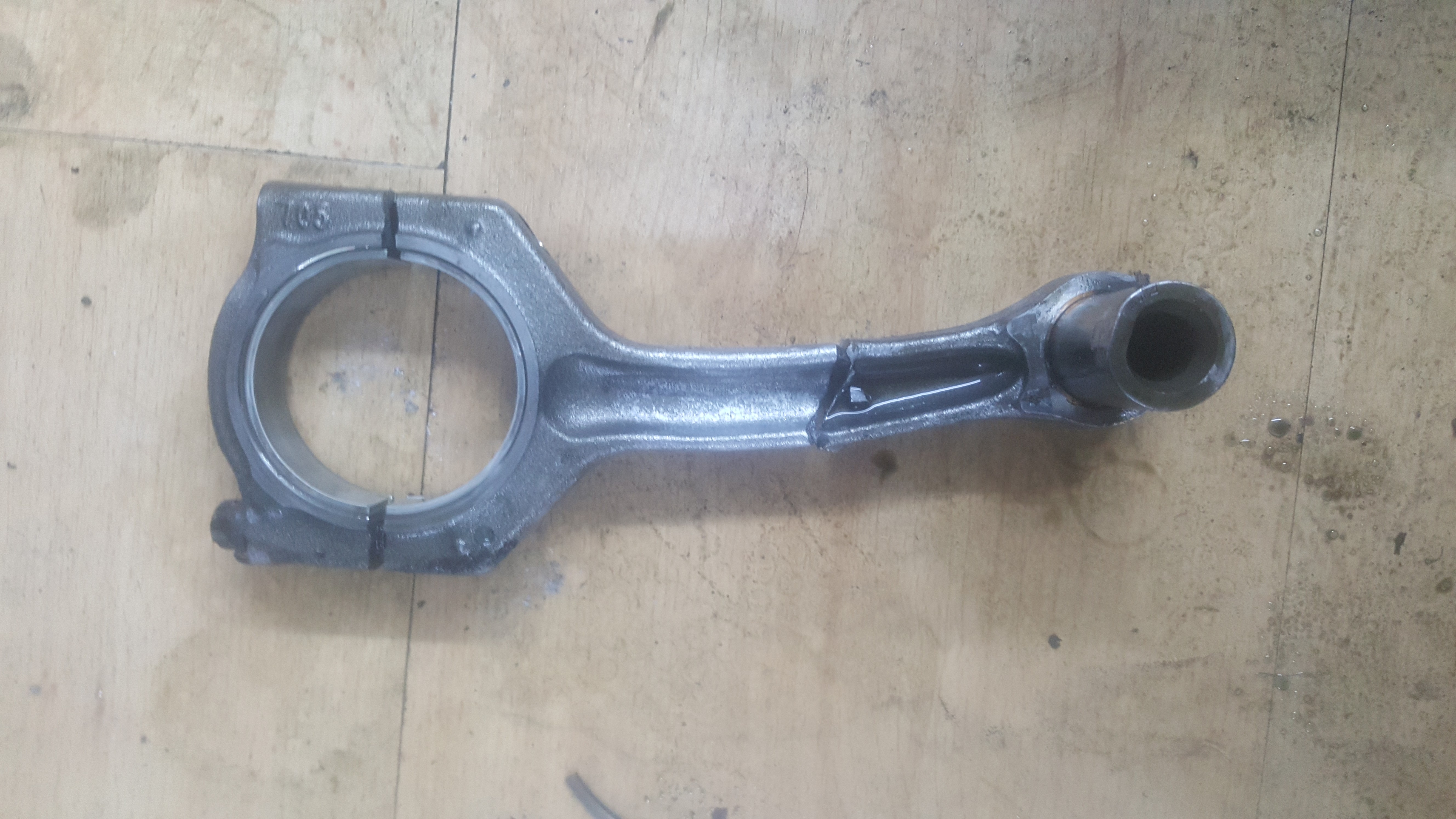

During 2017, #3 rod decided to take the journey into the world and leave the confinements of its environment :dunnoanymore:
So this meant that the build now entered into the more technical world of engine building and boy oh boy did i enjoy it.

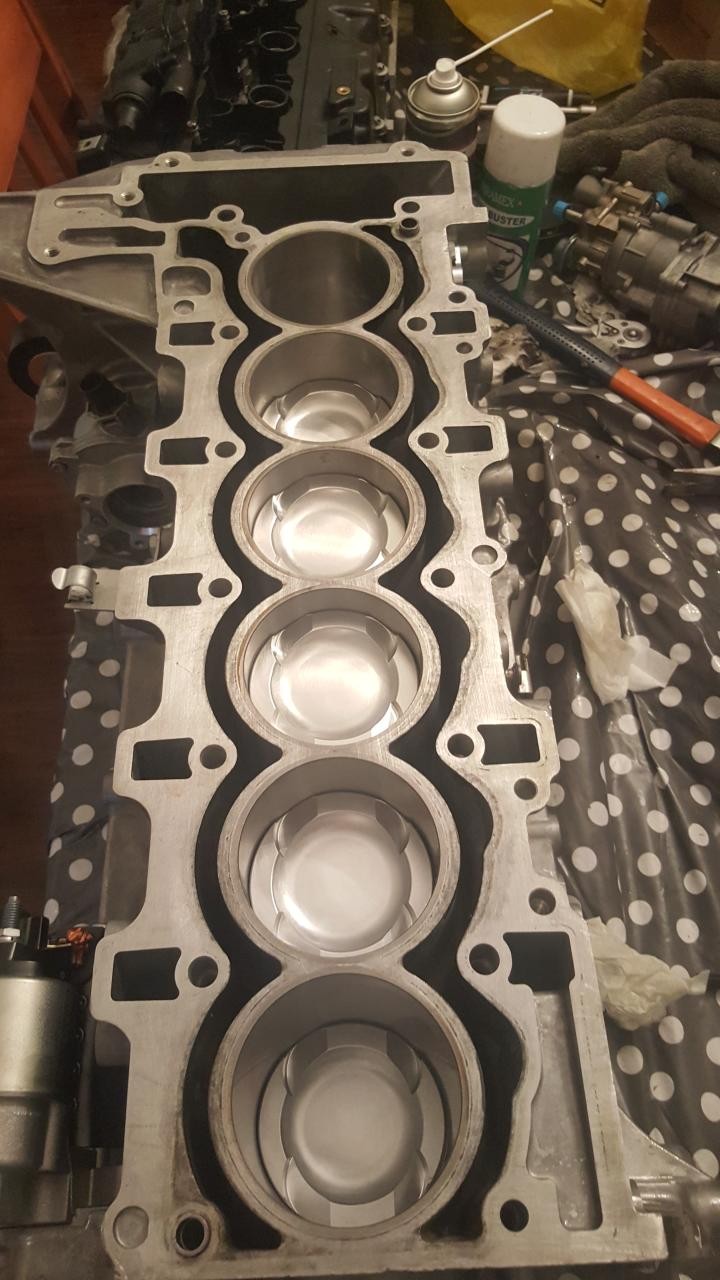

first up was the block..got it all cleaned up and insert3d these bad boys into the motor..what a learning curve for me this was..understanding the fundamentals of the motor really made everything worth while.

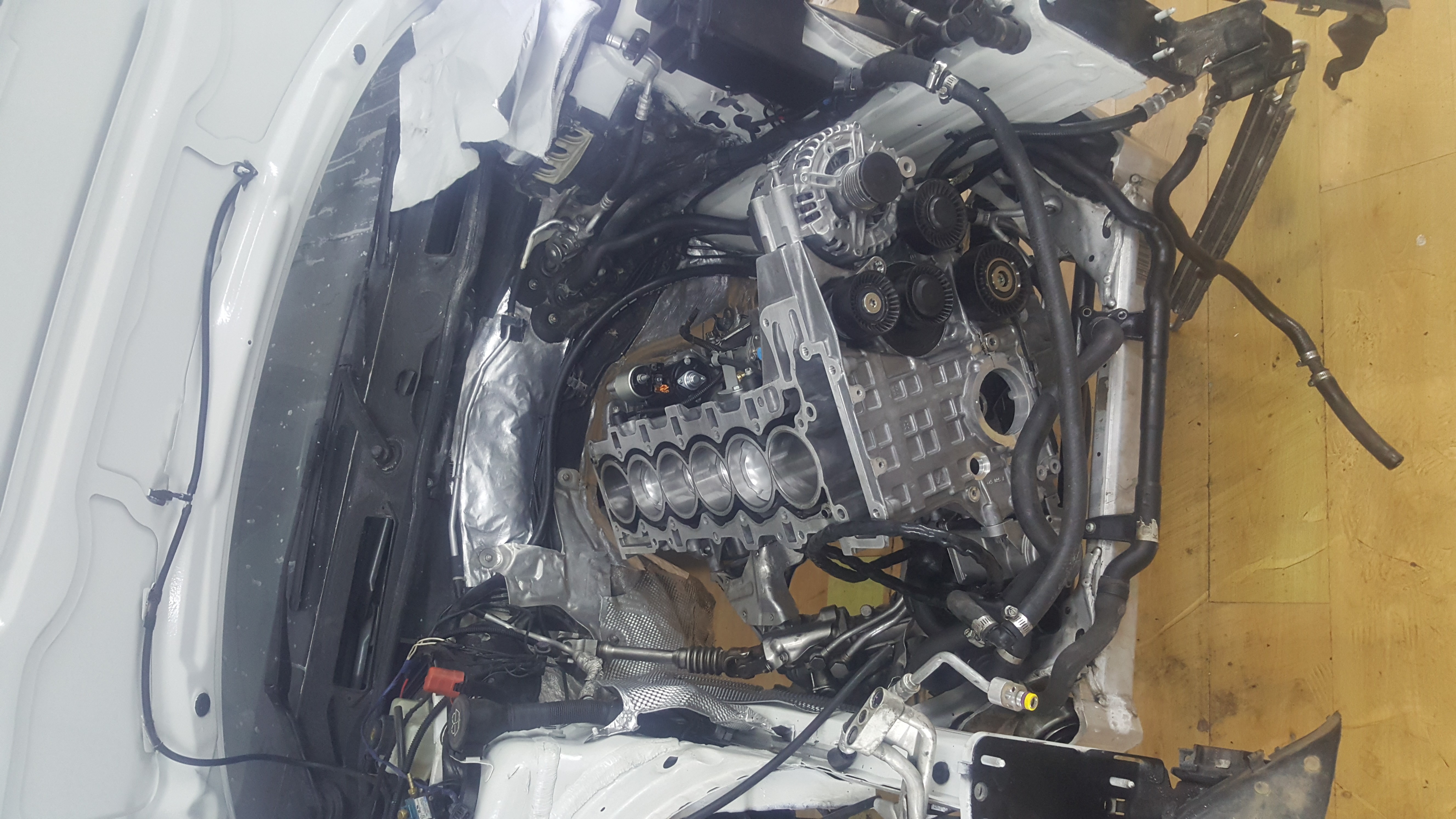

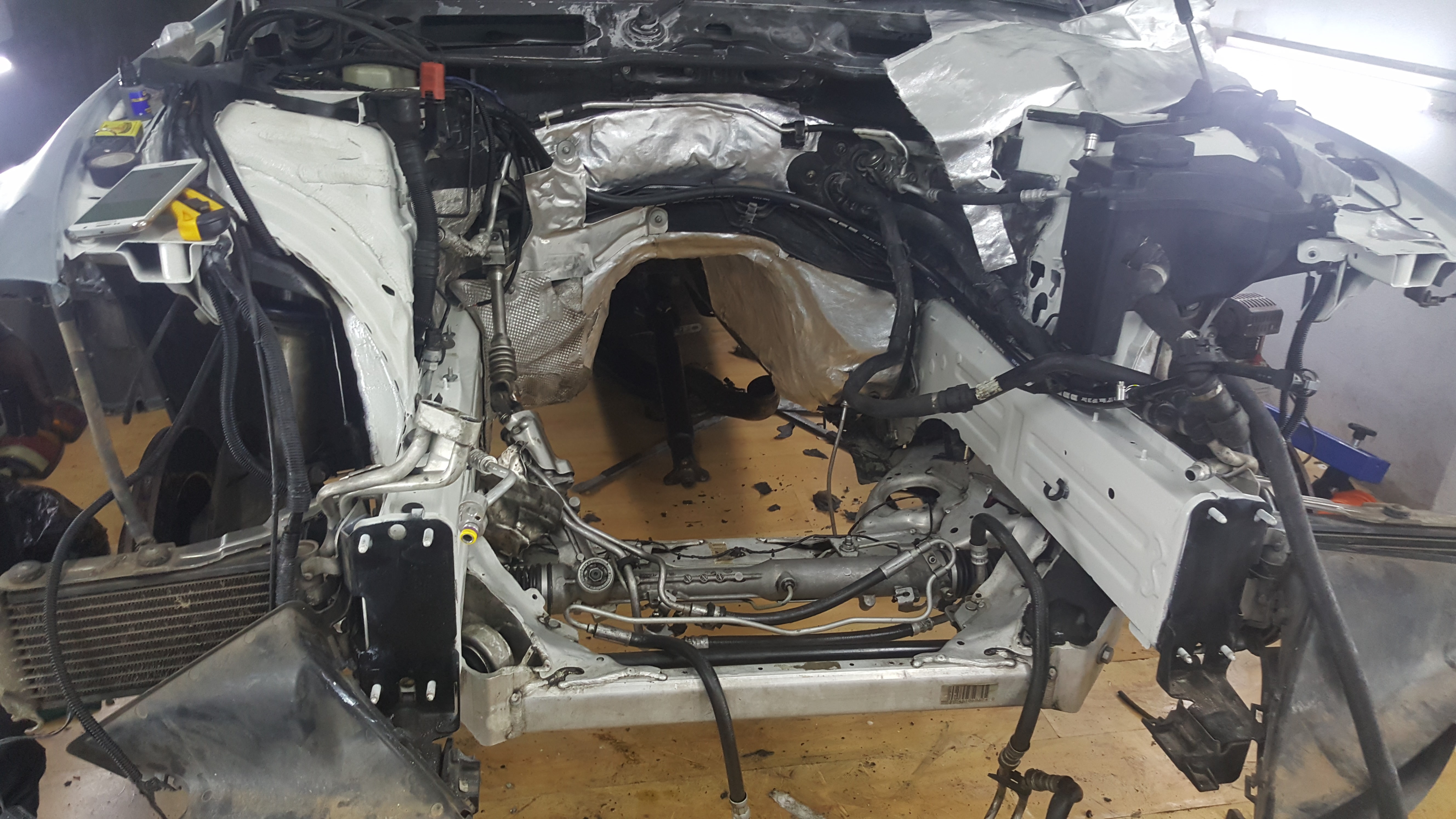

so while the motor was out of the car I decided to clean up the engine bay and do some tucking of all the unwanted wires as well

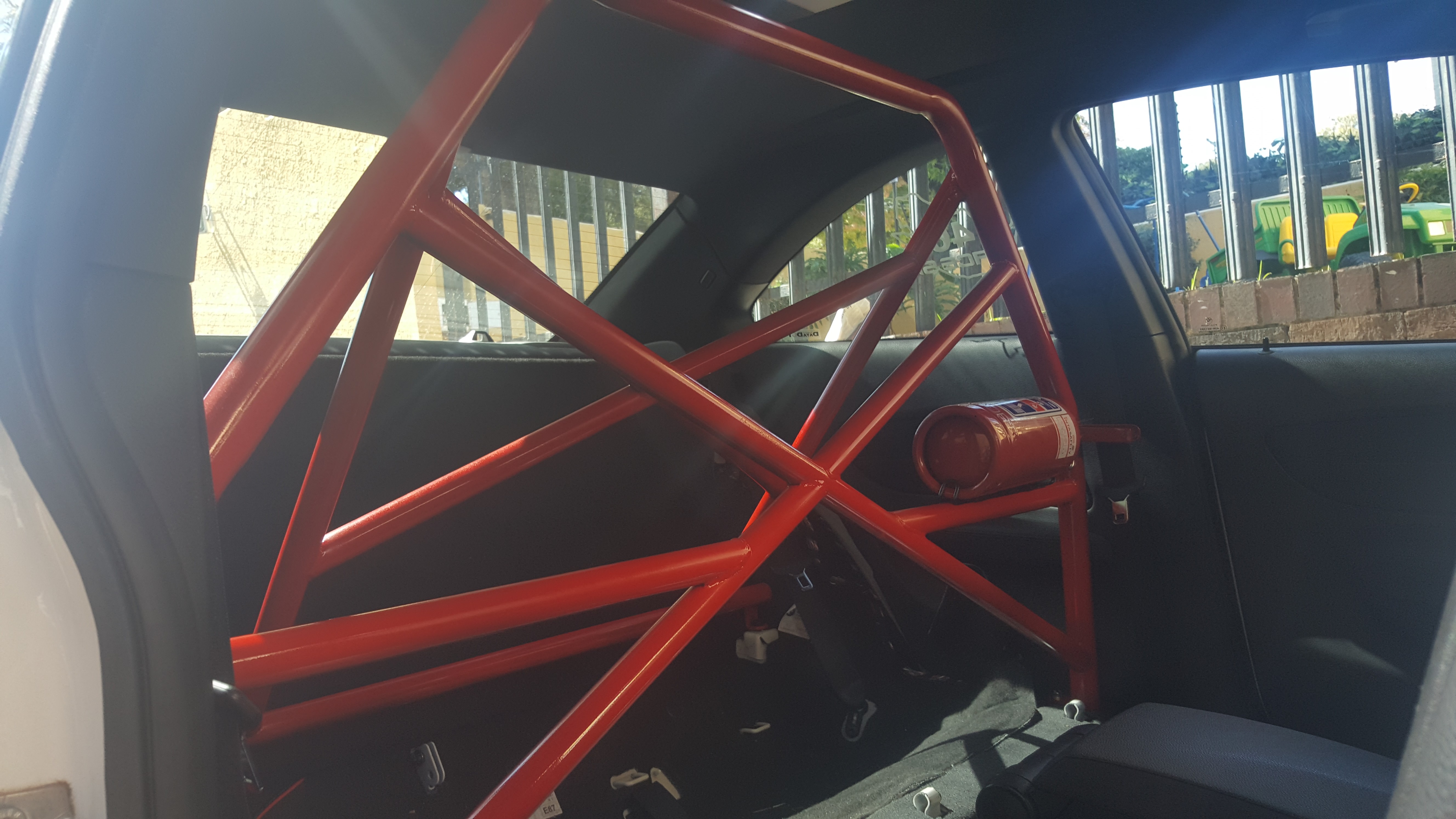

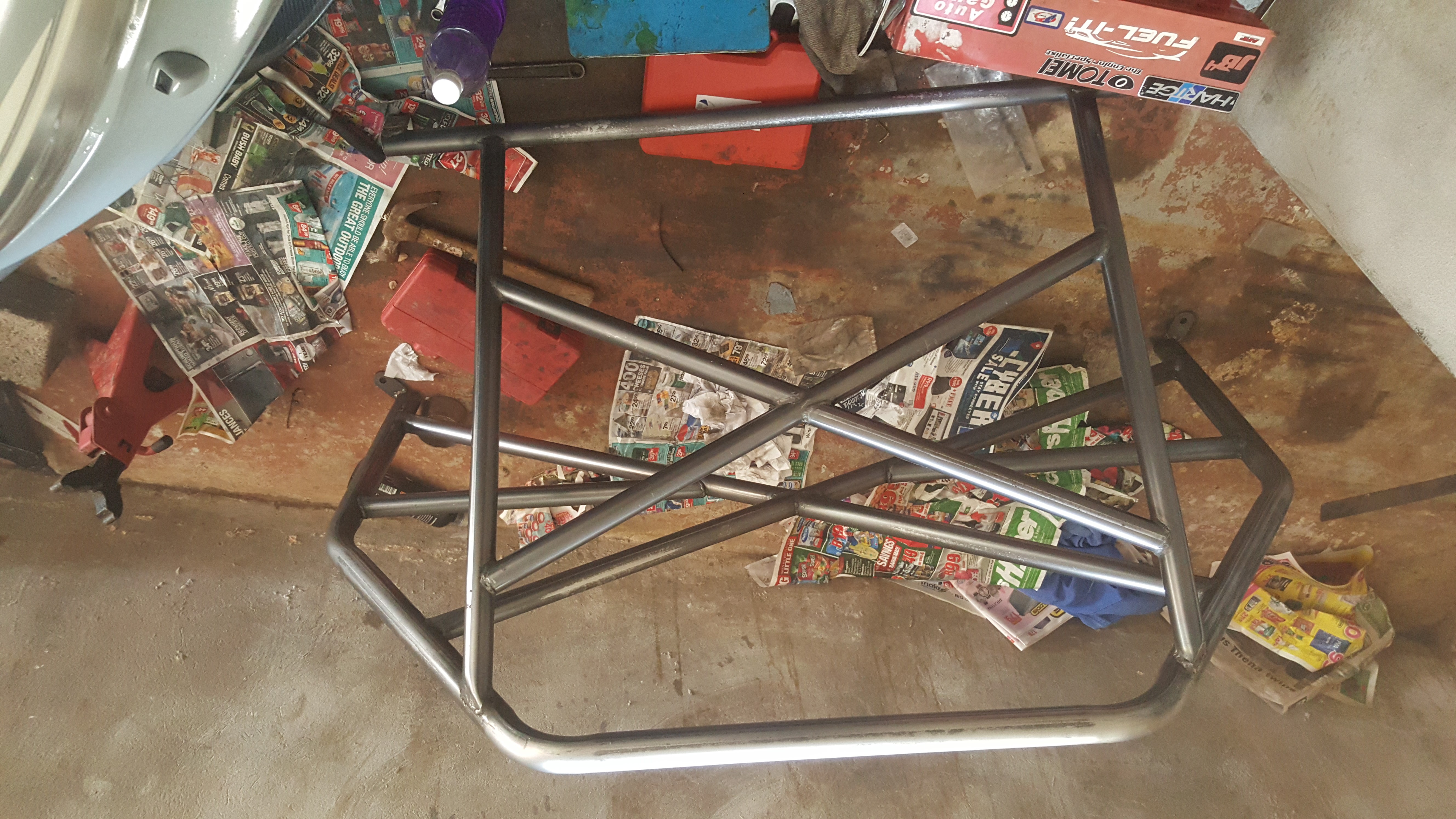

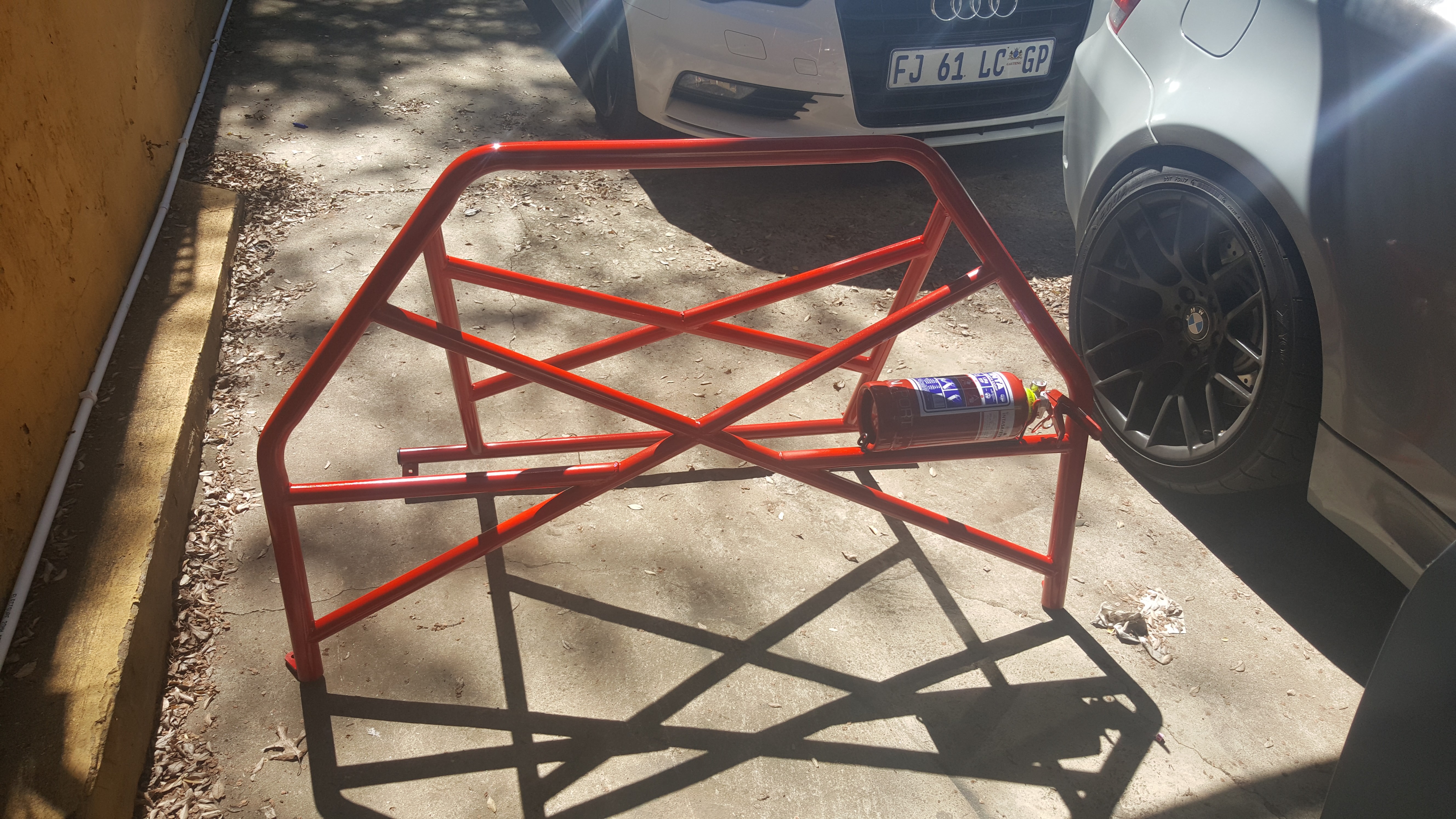

that been said waiting for parts to arrive is sometime a stress so while i was waiting for parts to arrive i decided to wrap the car and build a roll cage at the same time

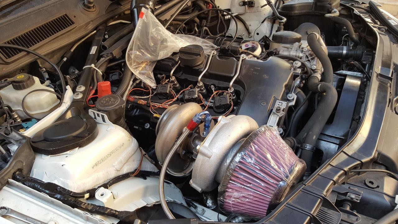

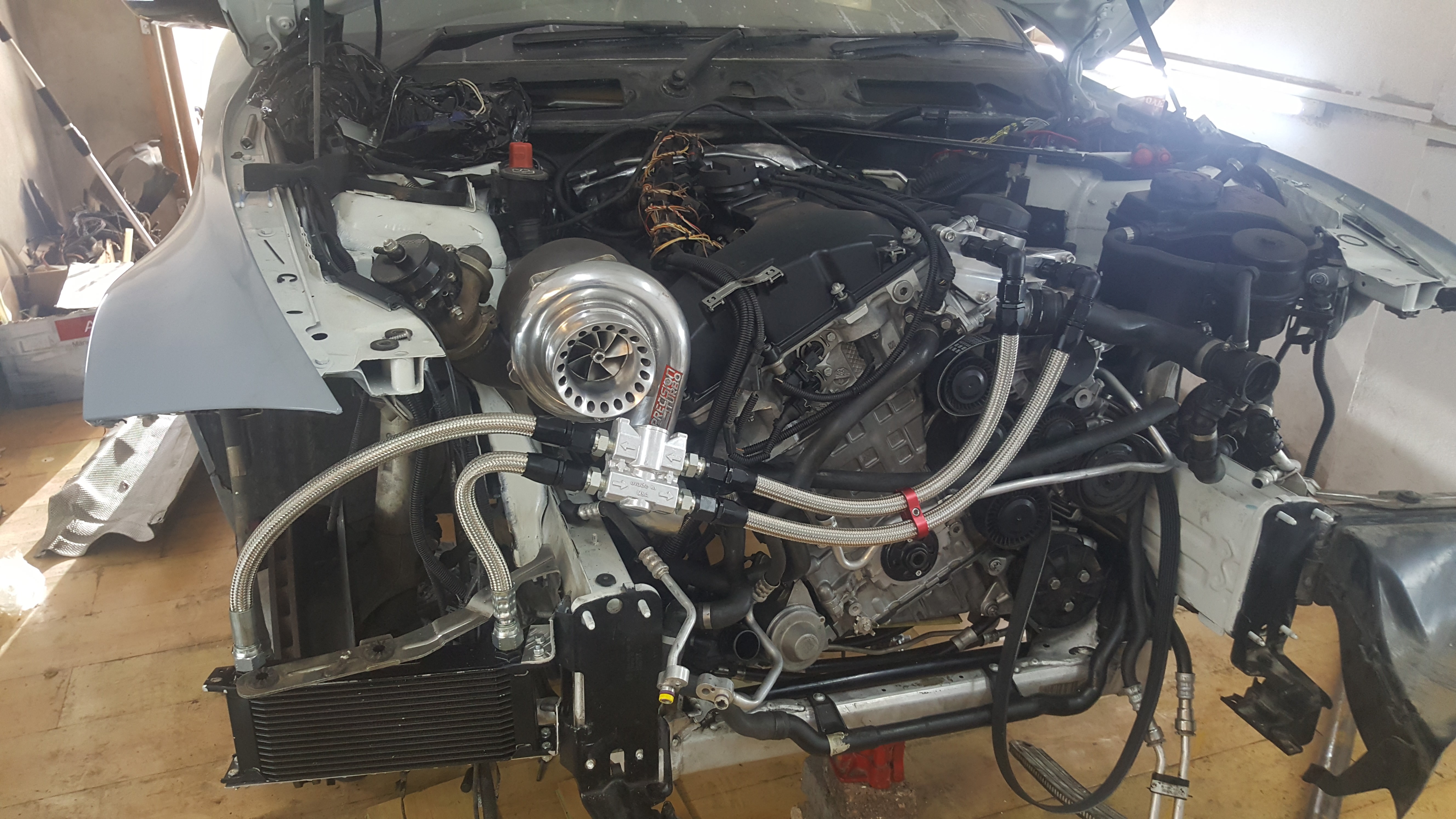

the time came to install the motor and couples with that a new PTE 6466.

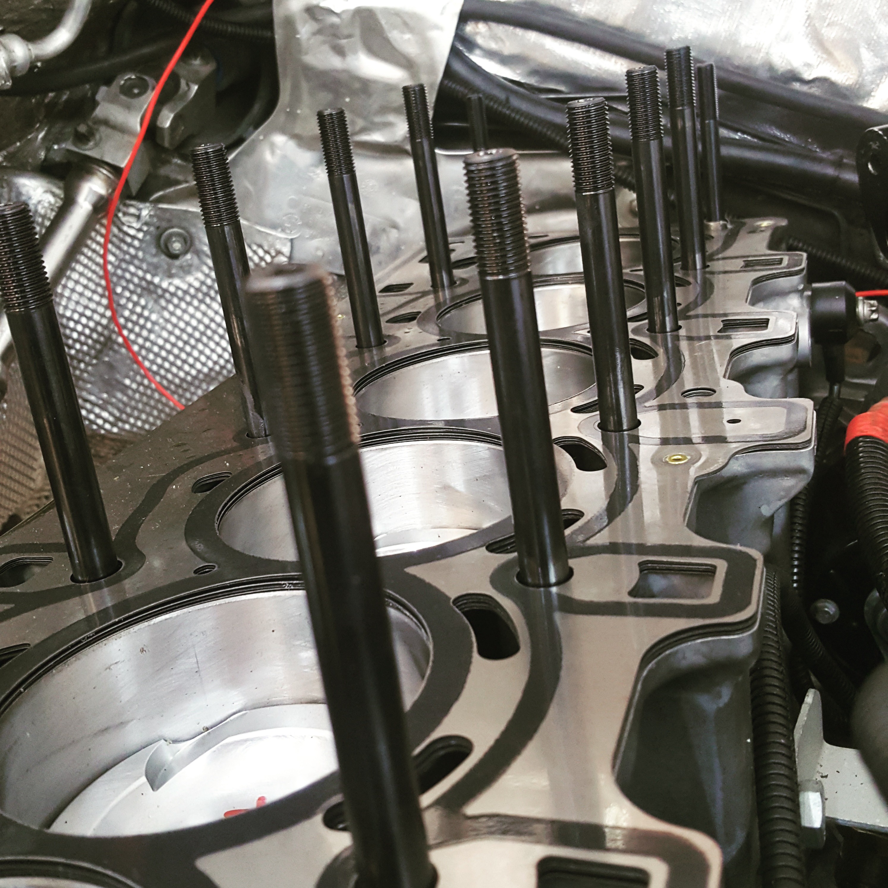

arp head studs followed suit together with oem head gasket

The build on the engine was no joke. Because BMW uses aluminium bolts on everything they become one time use only and every bolt needed to be replaced. The rod failure on these motors are very common however guys just don't speak about them. This is an example of the rod that went on my car

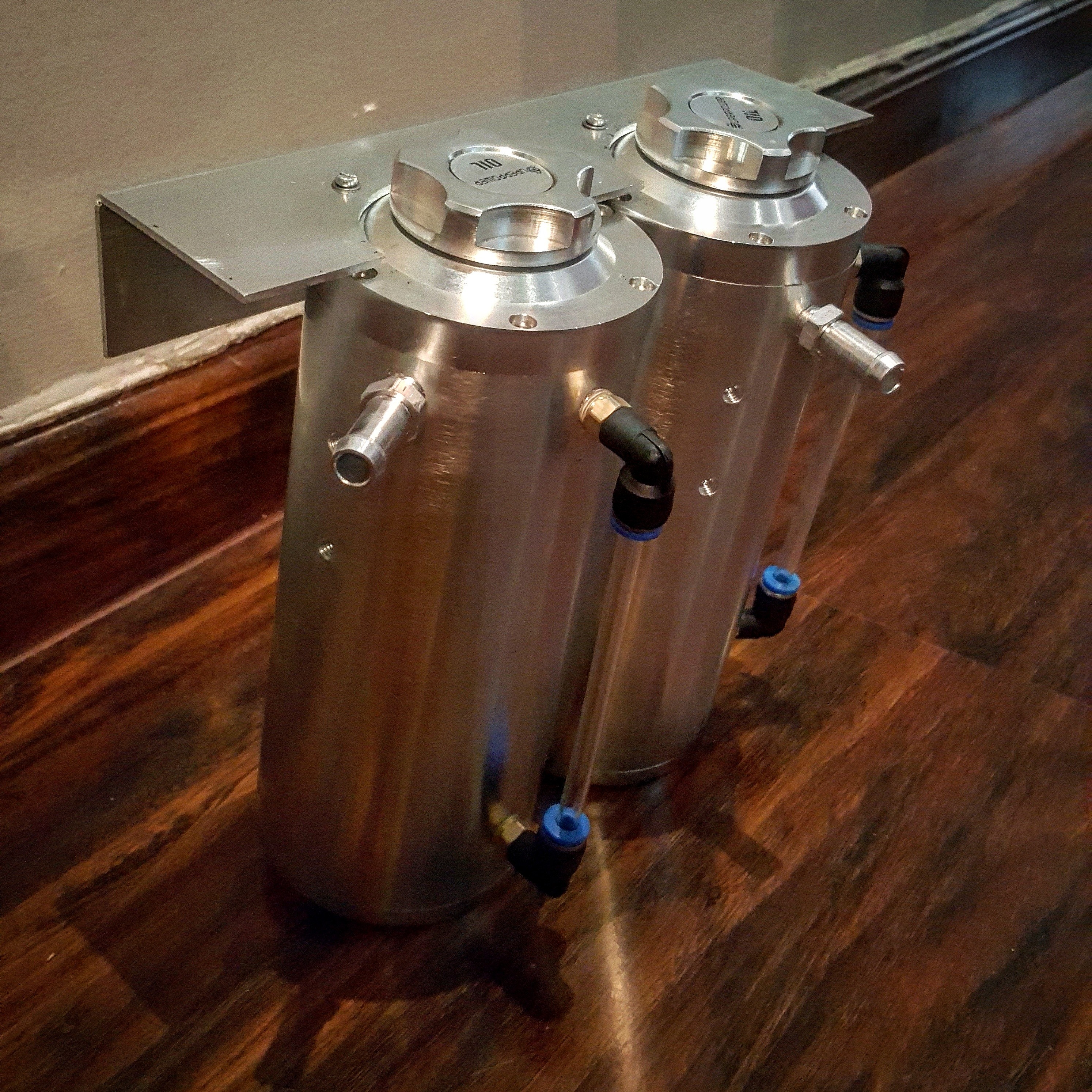

As a precautionary measure i decided to add an additional oil catch can to the car. This meant that i no longer required the internal PCV valve that is known to fail rather my new setup will contain an external system. This system is very similar to what is ran on the 2jz motors.

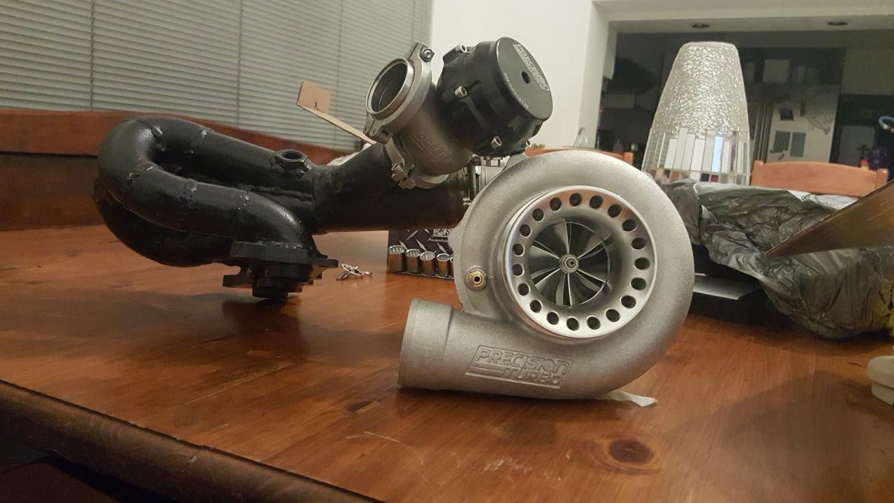

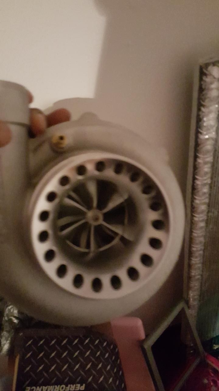

With majority of the motor almost complete my attention than focused on the new plumbing that i acquired as well as the new turbo setup that was going onto the car

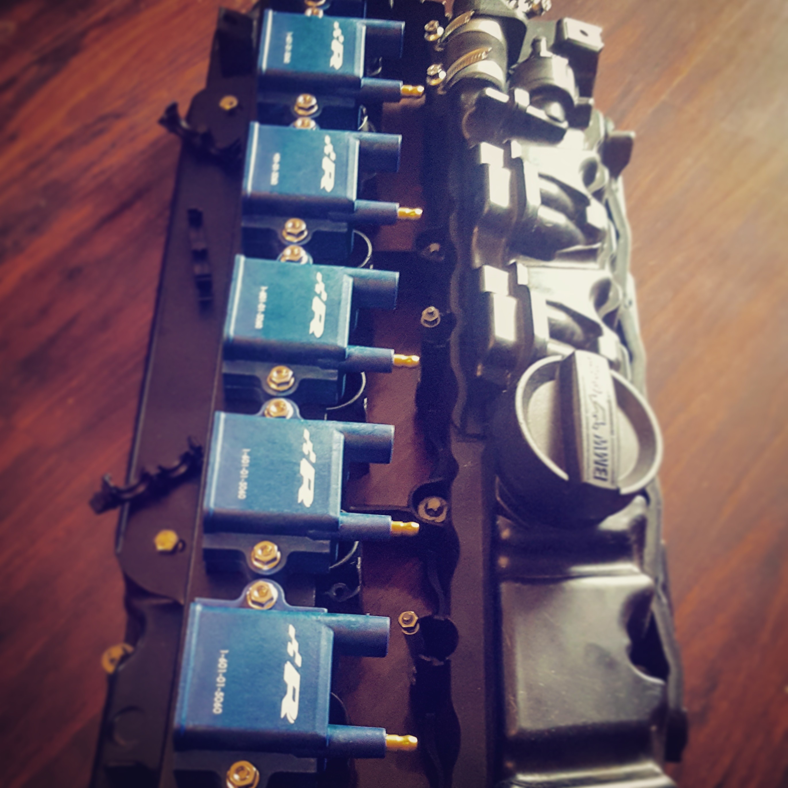

As you will notice there is no coil packs on the car, the reason being is that these bad boys where up next.
