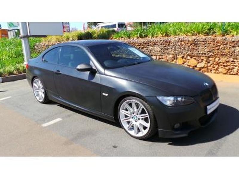

As you can see the wrap was faded - so wise move on my side by requesting wrap be removed.
Delivery day - All Excited like a child on Christmas waiting for his presents.

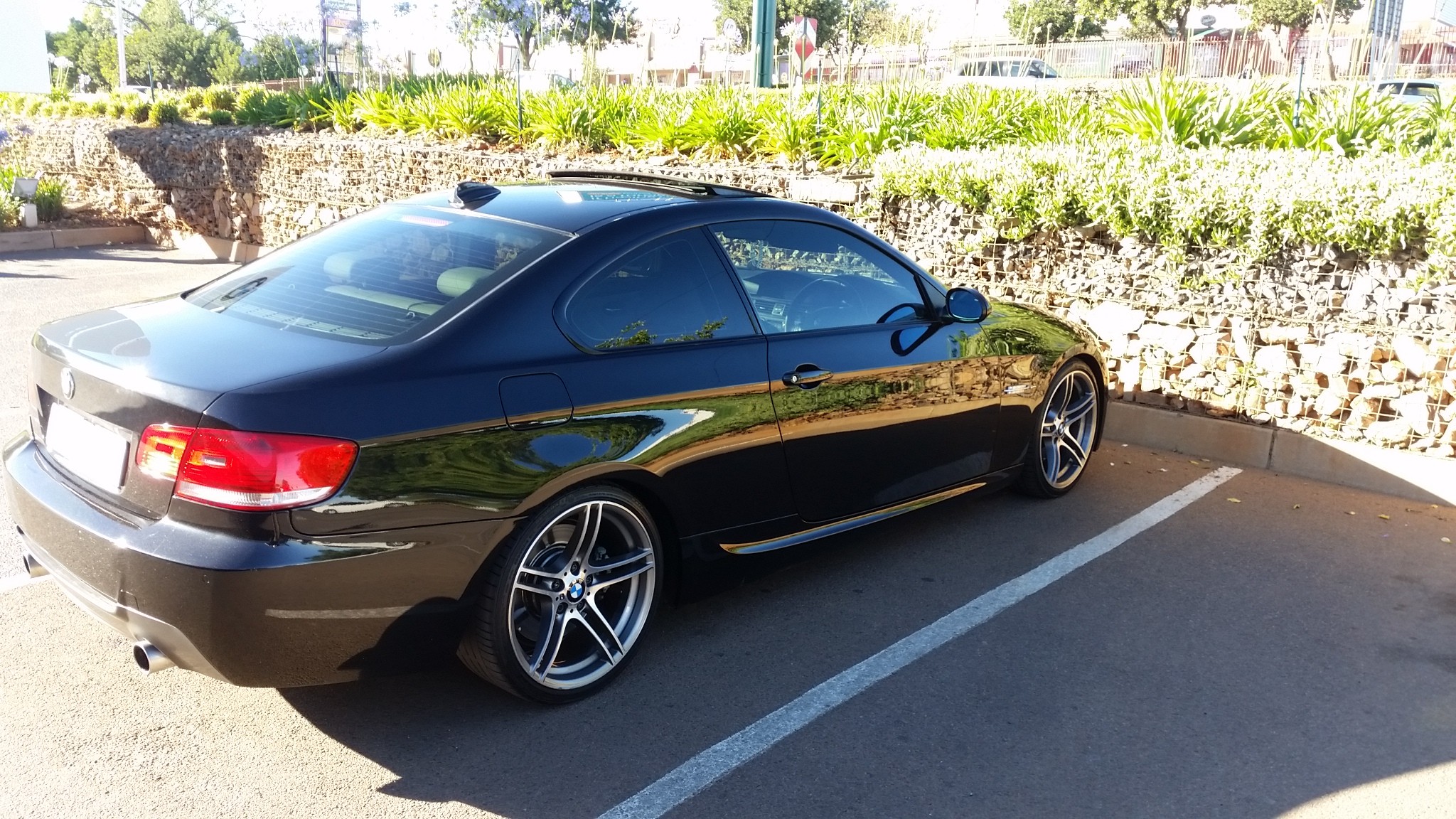

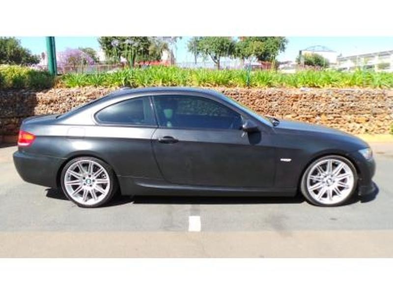

I finally get to the Dealership to see the end product of my purchase - and to NO dismay - a beauty parked in front of me...you can only imagine the smile on my face.
My 'new' BMW 335i e92 n54 7 Speed DCT MSport
* Full house
* 19" sports mags which i swopped out with my OEM 313's
* Cream interior with Wood grain Finishes
* SATNav with Logic 7 Sound system
* Sun Roof
* etc......i'm sure we get the picture

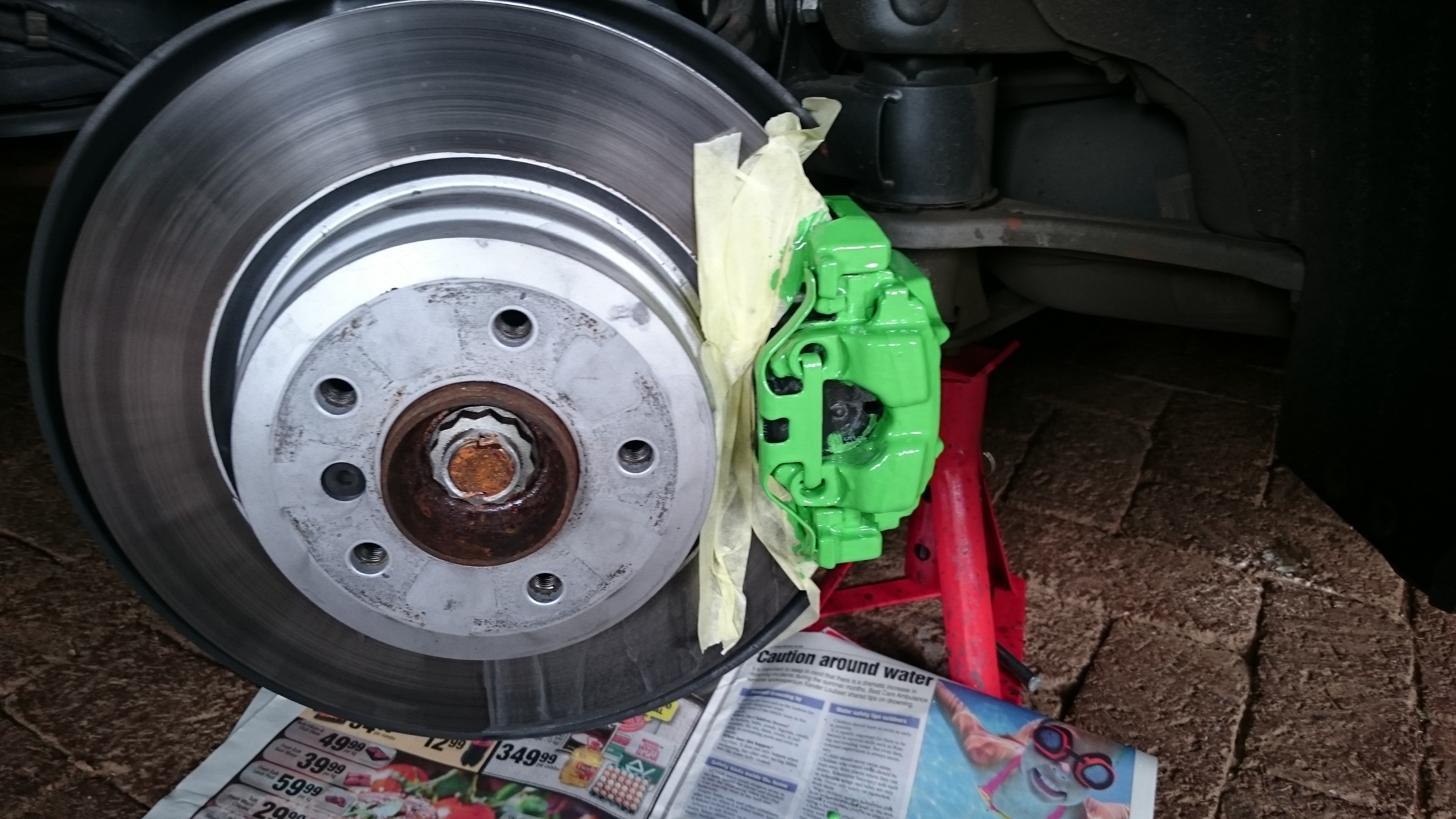

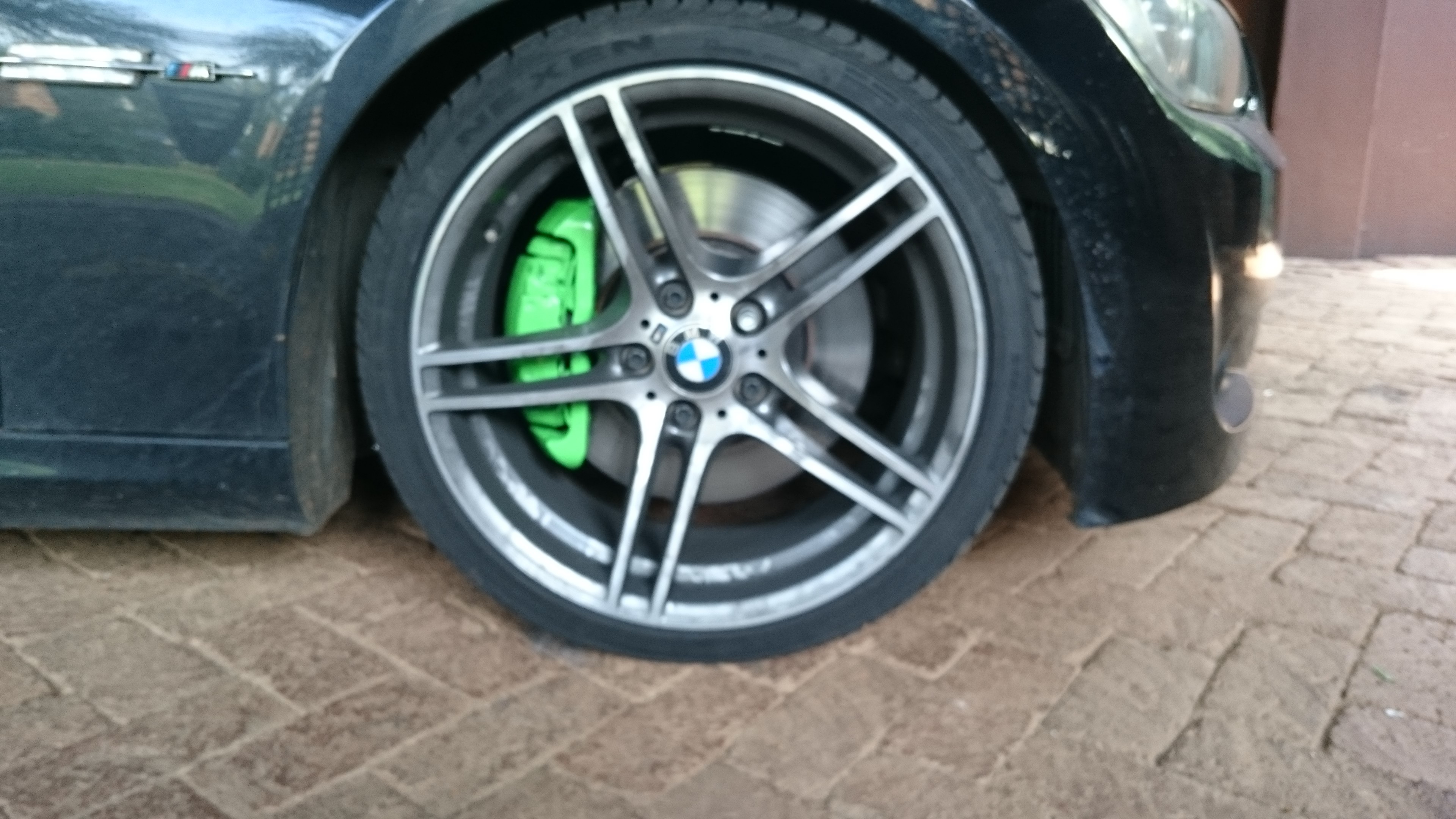

* Custom Caliper Colour change - For some reason i liked the Green (eish)

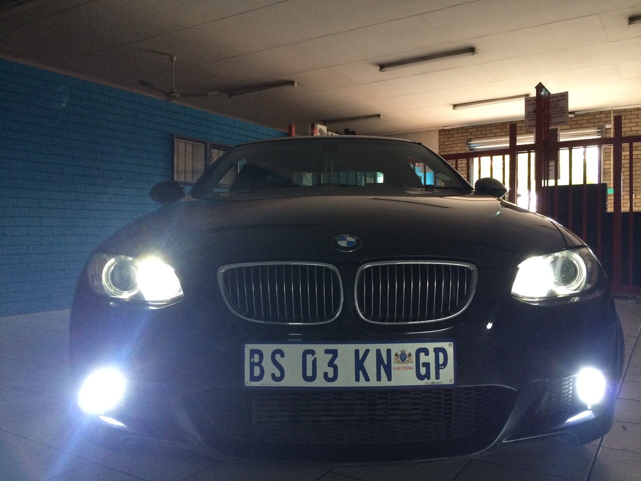

* Fitted an HID Kit's kits to head lights, Fog lights and Angel eye rings

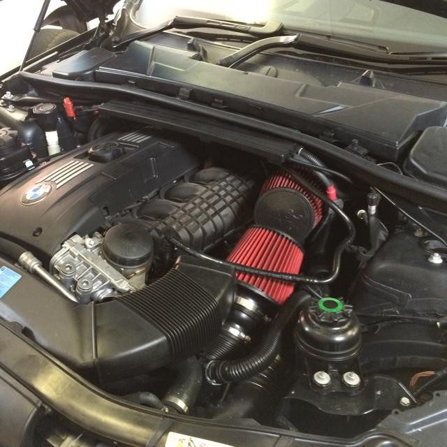

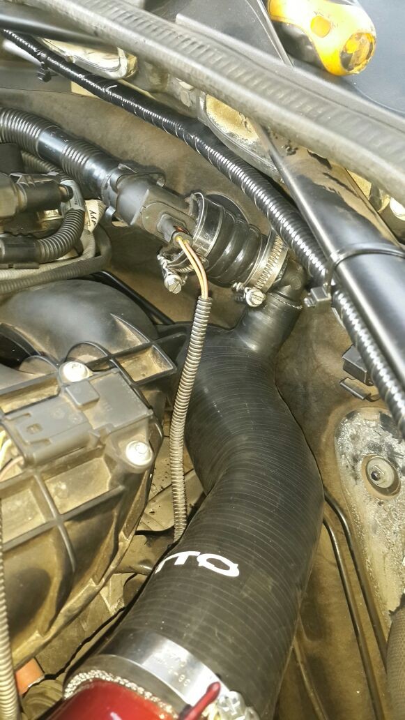

* Fitted K&N DCI
- Supplied by Exclusive mods again
* Fitted 3" 304 Stainless Steel Downpipes
- Supplied by Mr Turbo
- Removed 2ndary Cats as well
* Fitted BMS JB4
- Supplied and Fitted & Tuned by SRSpeedworx
* Fitted CPE Chargepipe
- Supplied by SRSpeedworx

Some pictures after to do list

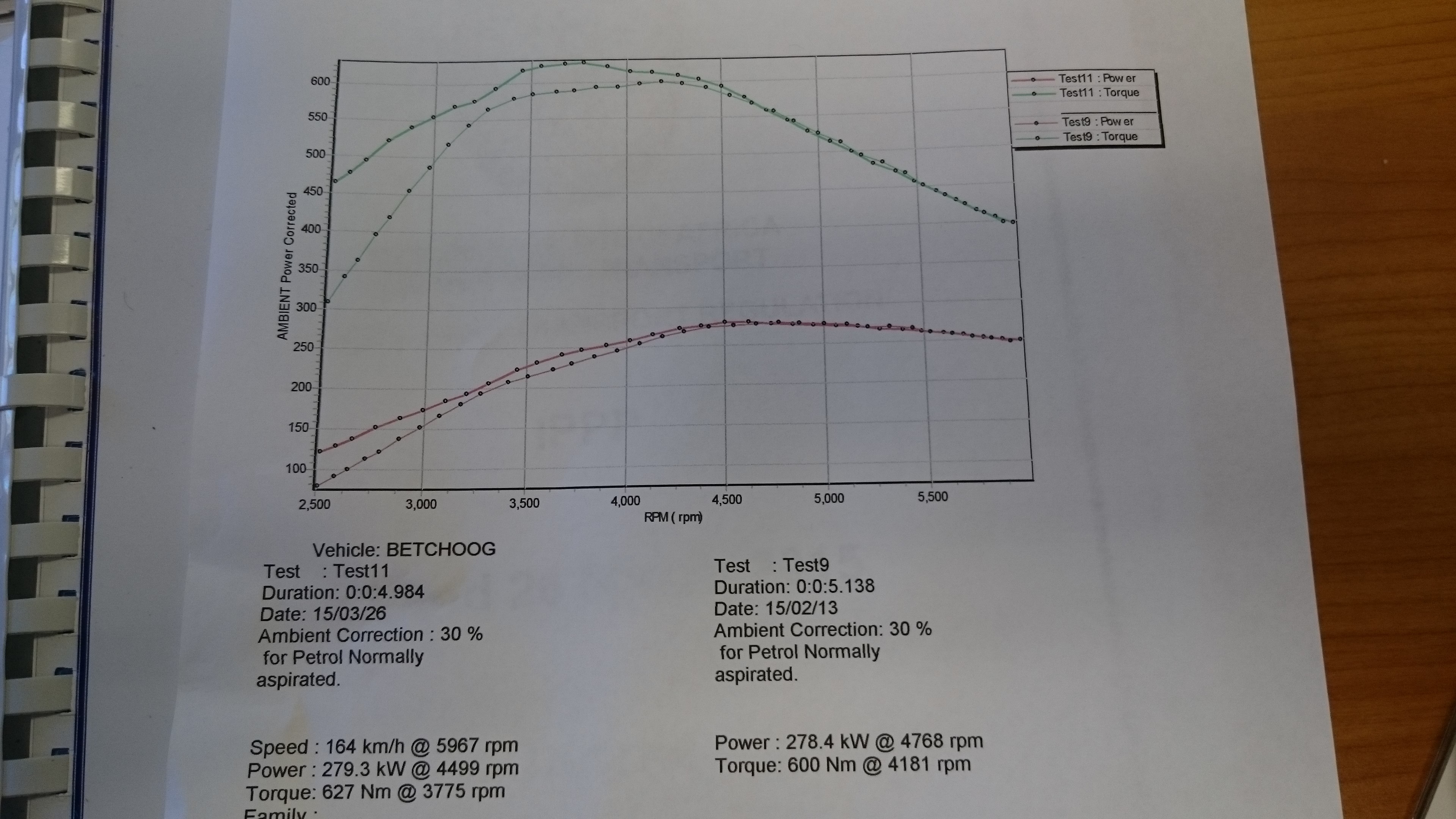

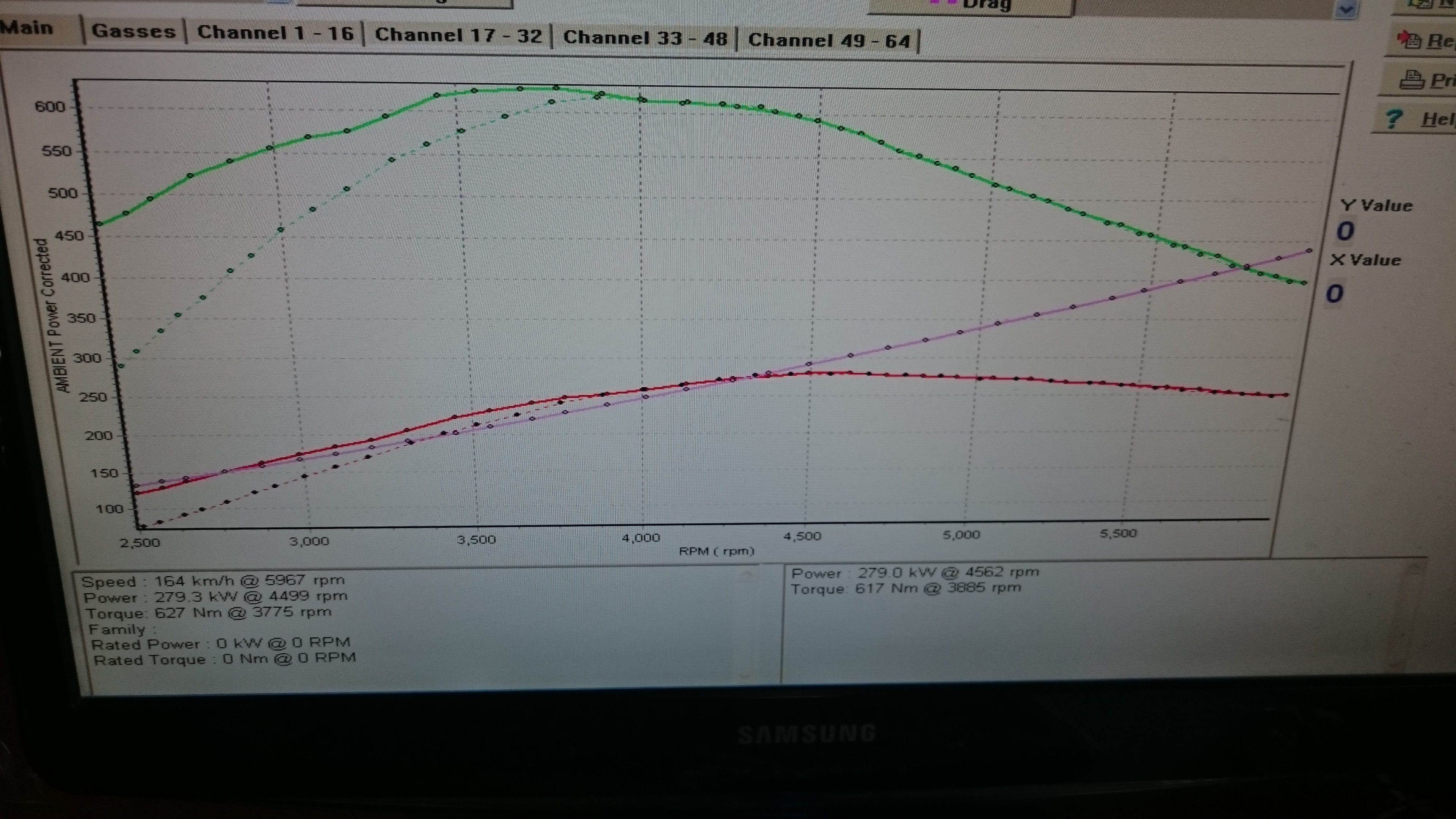

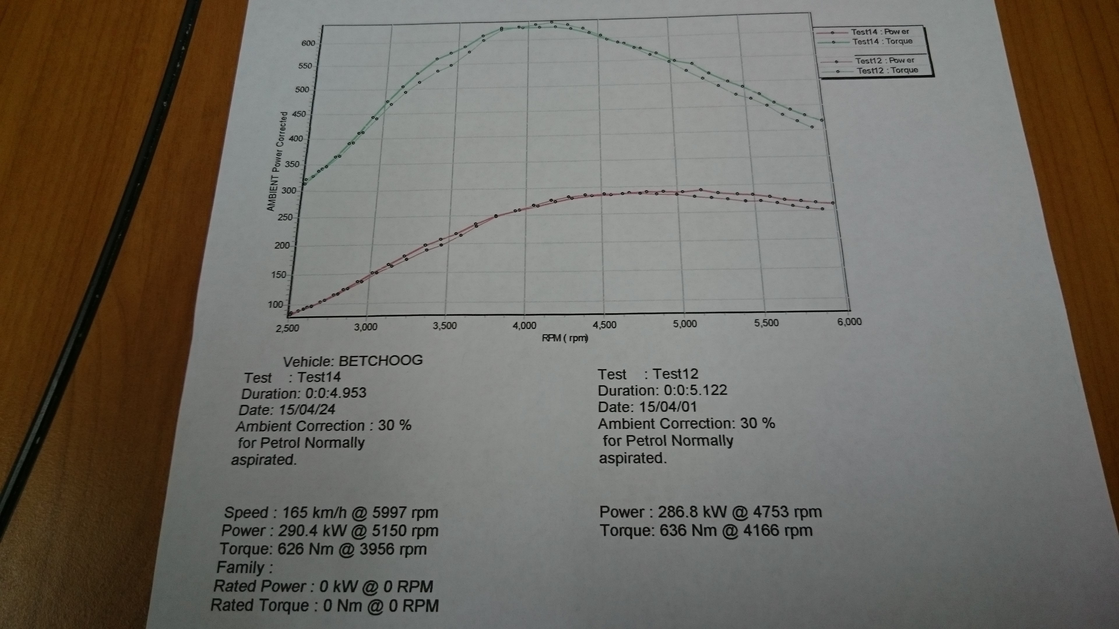

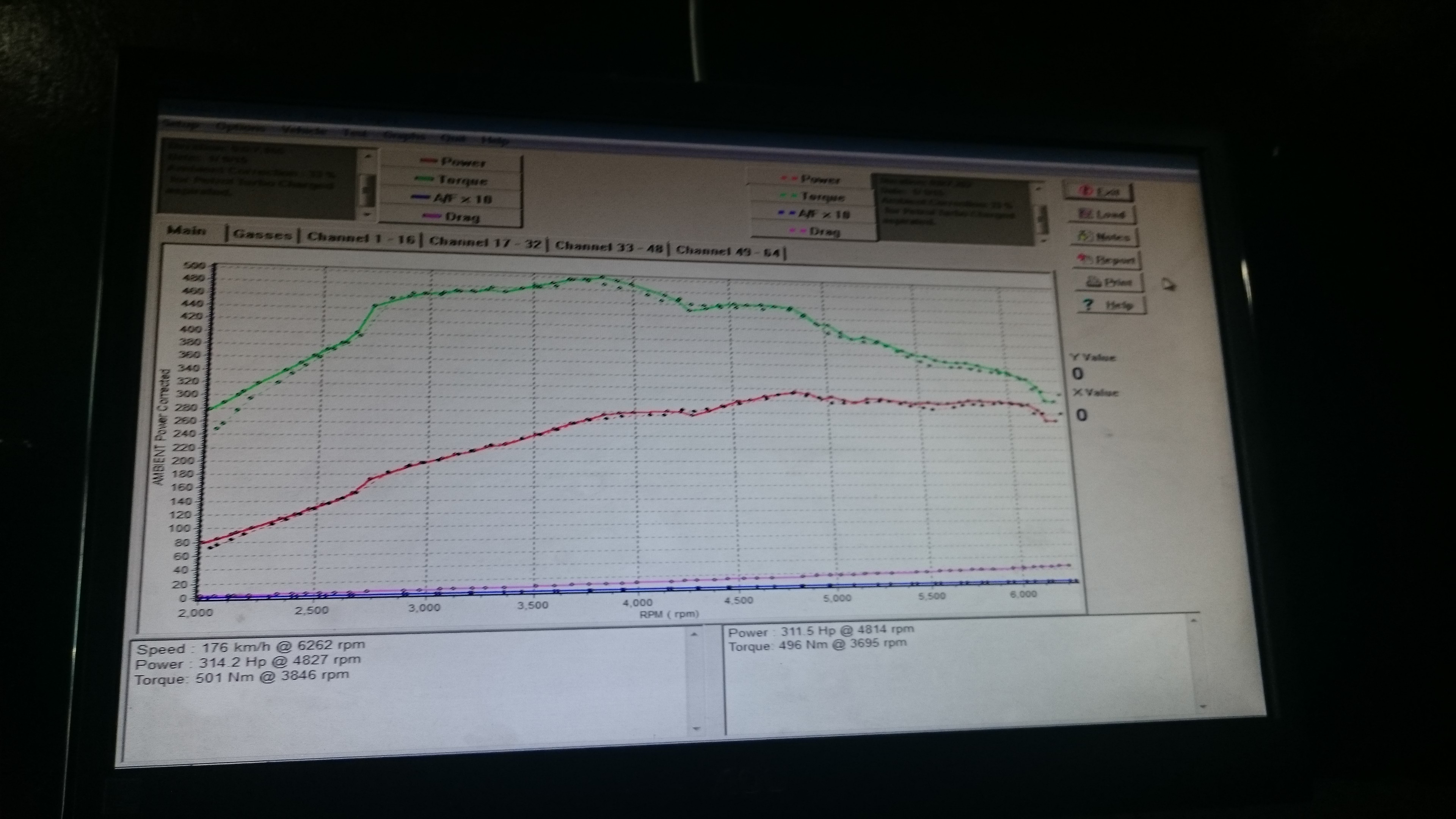

After All of this was done - i just had to take car to a Dyno to just to see what this beast is capable of.
So off to KAR performance as well as FR&R we went and the End result
was .......
Figures with just DCI + DP -> 234wkw & 501 nm
Figures with DCI + DP + JB4 -> 279wkw & 627nm
over the moon i was with that stupid grin one would have :skit:

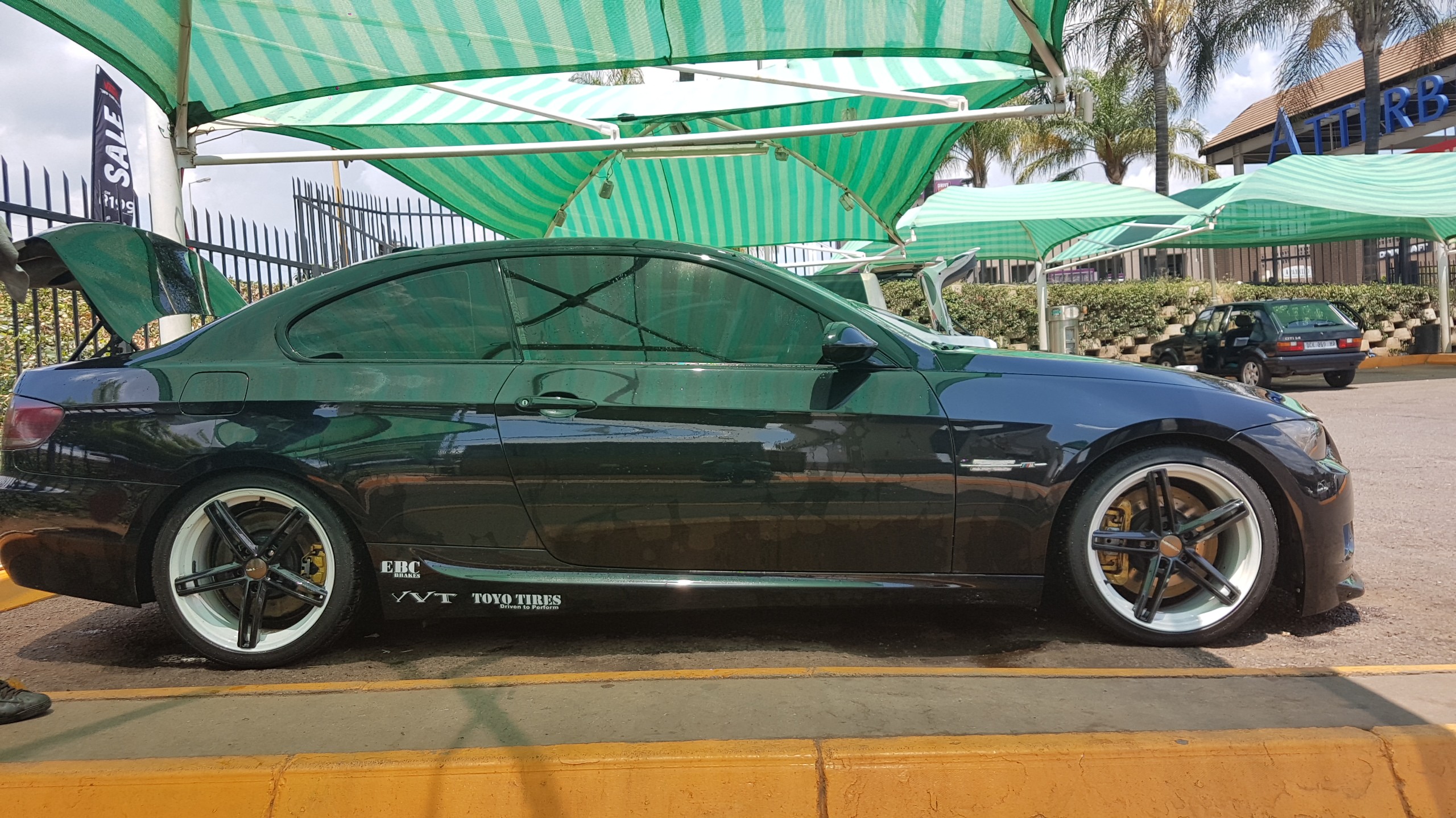

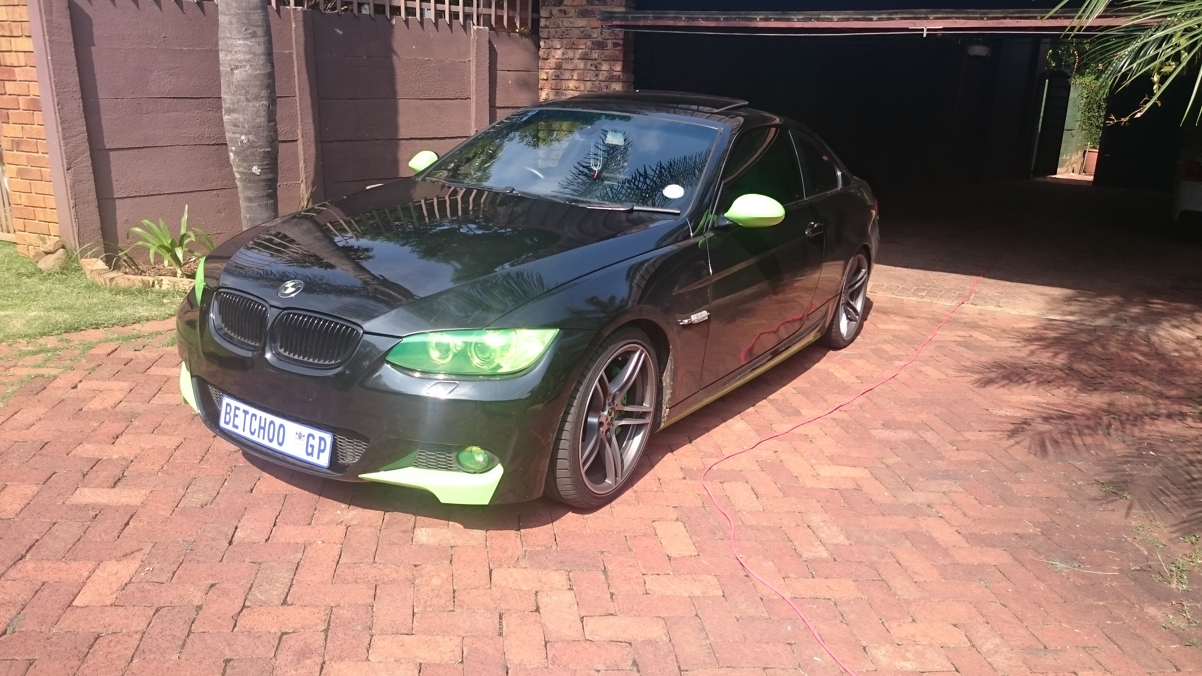

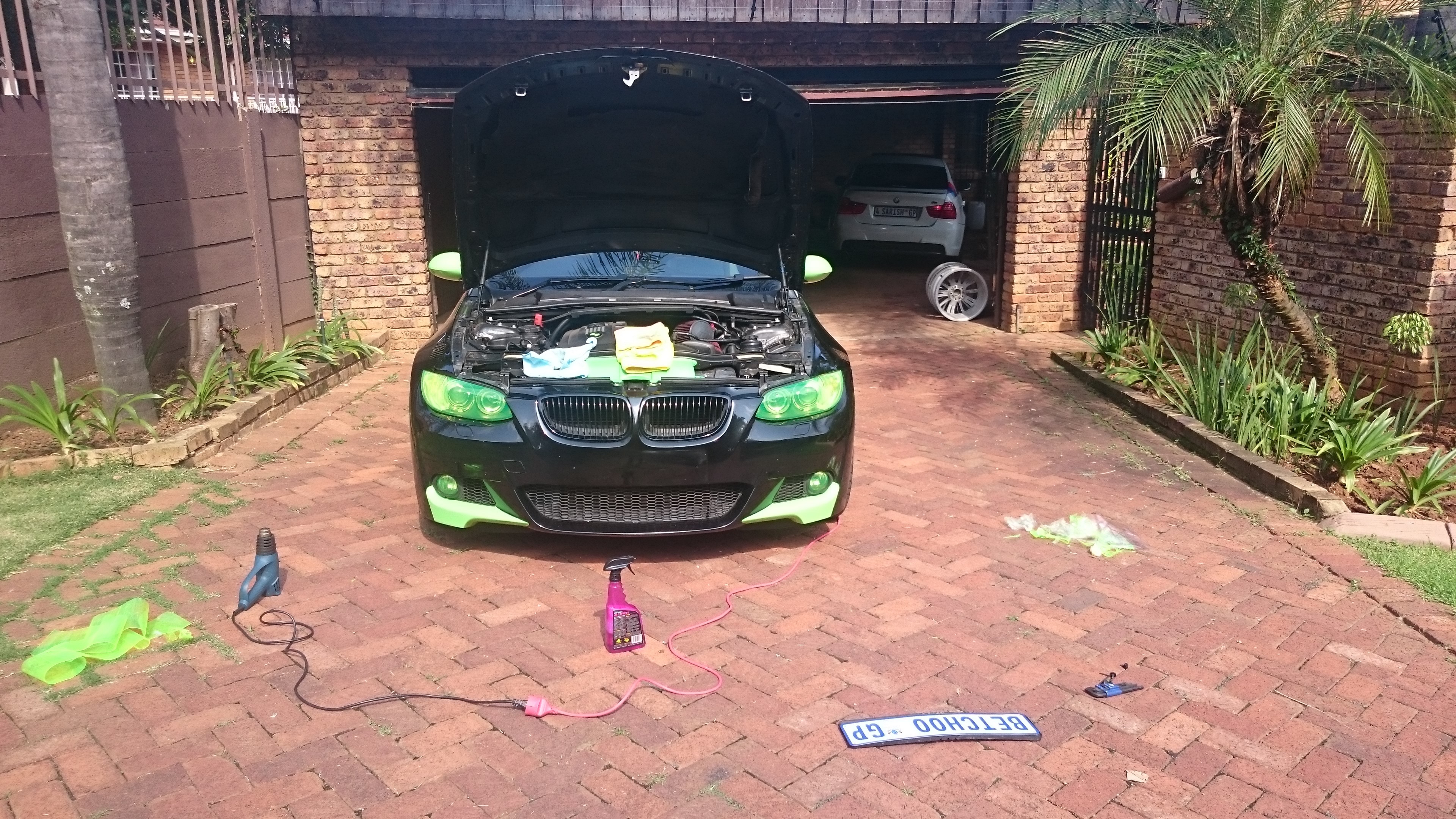

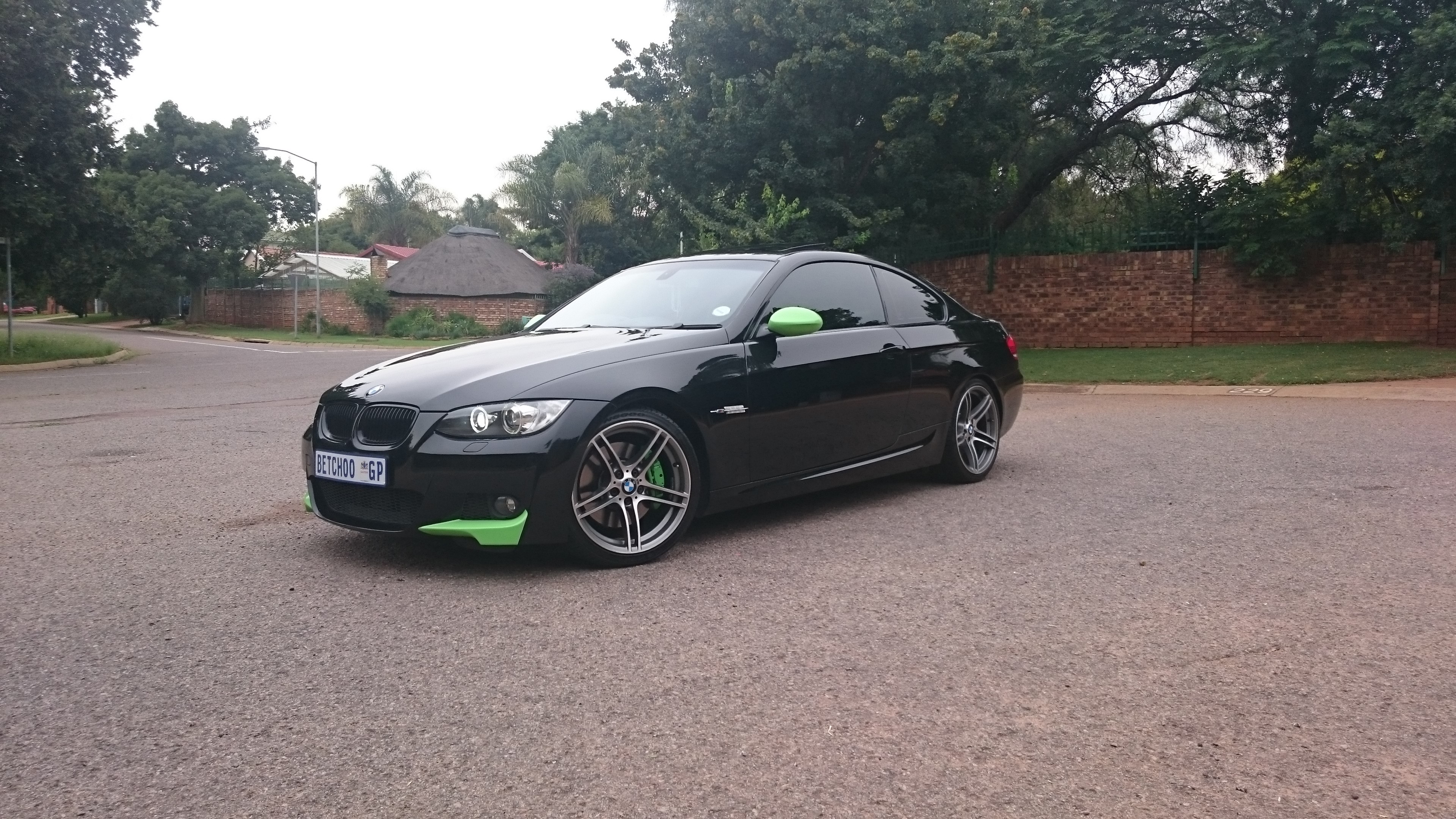

With the never ending lust that i have to make my cars look like Christmas trees, i then set out to do few more custom changes and further performance mods
to do list included

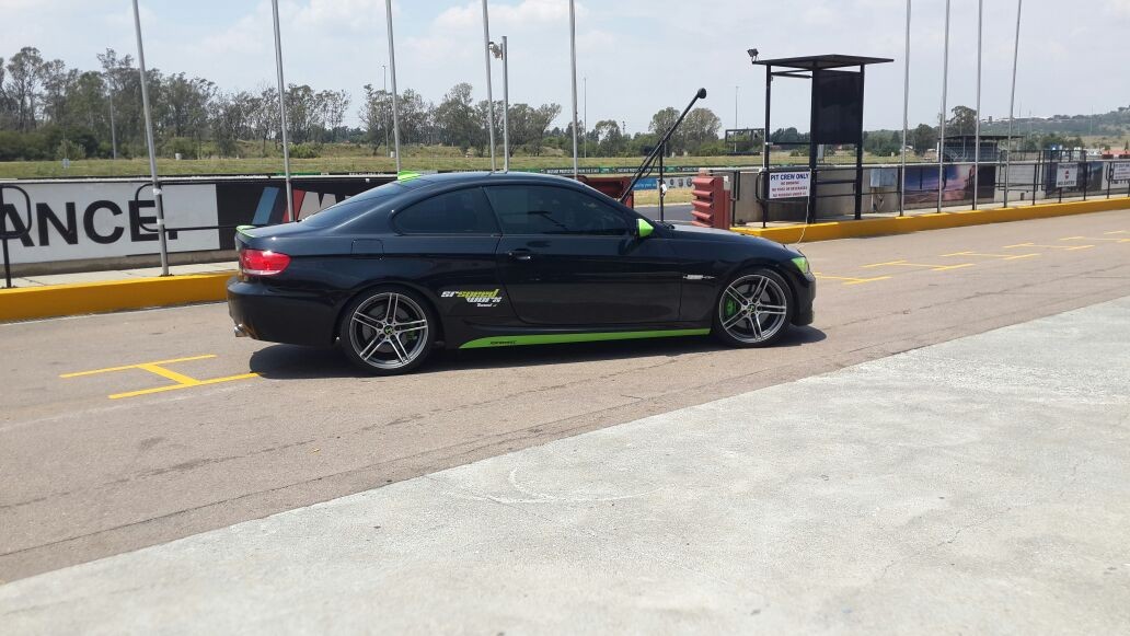

* Some Green Custom vinyl around the car
- Included, front spliters, side skirts, boot spoiler and Mirror covers
- Lime green Laminex head lights
- Smoke Laminex Taillights
- Green Badges all round
- Green interior engine bay parts
- Gloss Black Grills
* added Forge DVs

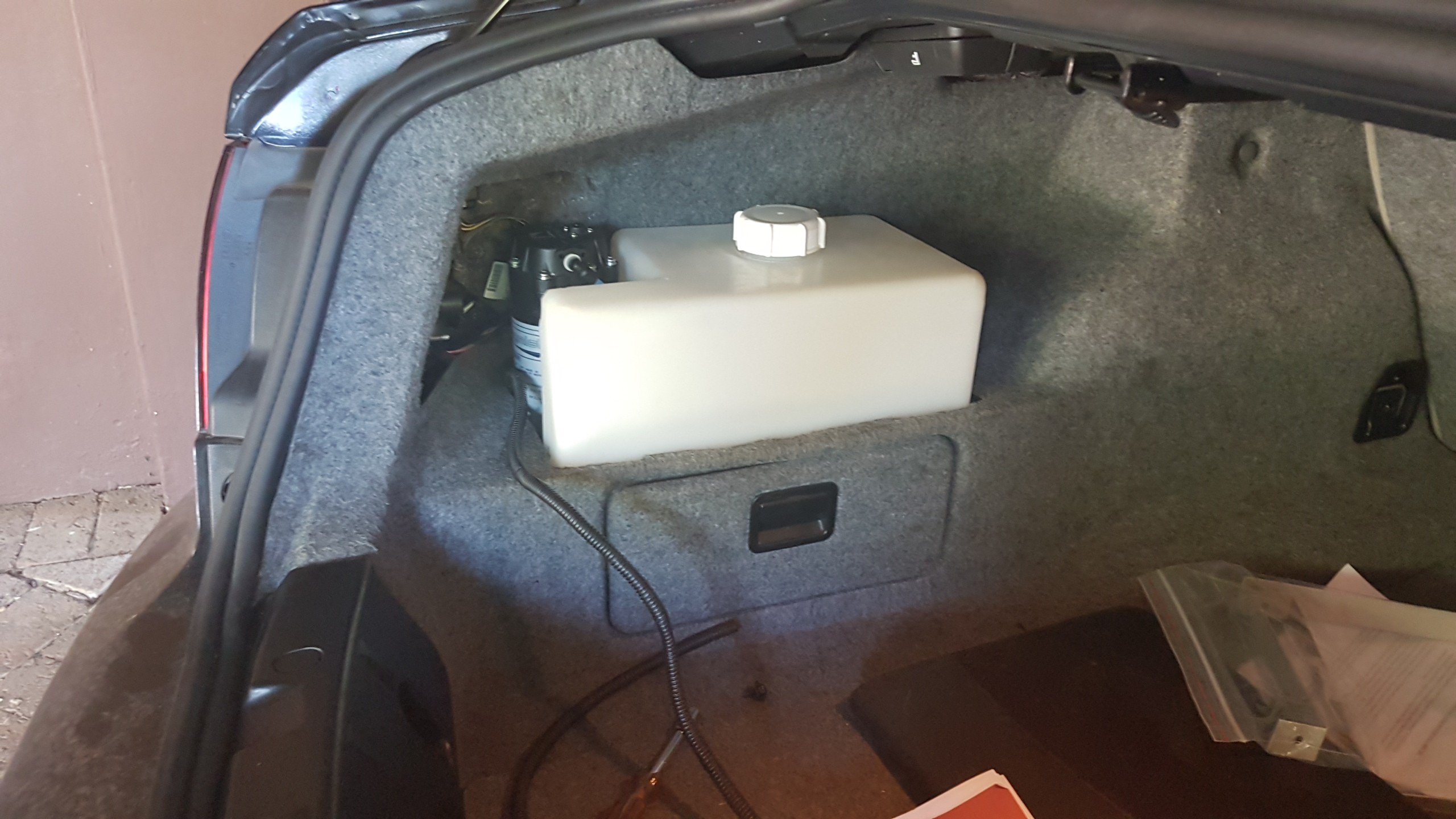

* BMS water methanol
- Supplied & Installed by SRSpeedworx
* Custom Exhaust
- Supplied and Fitted by Tom from TMS
After mods - again we hit Dyno ..... 290.4wkw & 626nm
Here re some pix of the car at this stage and short vid of the Exhaust

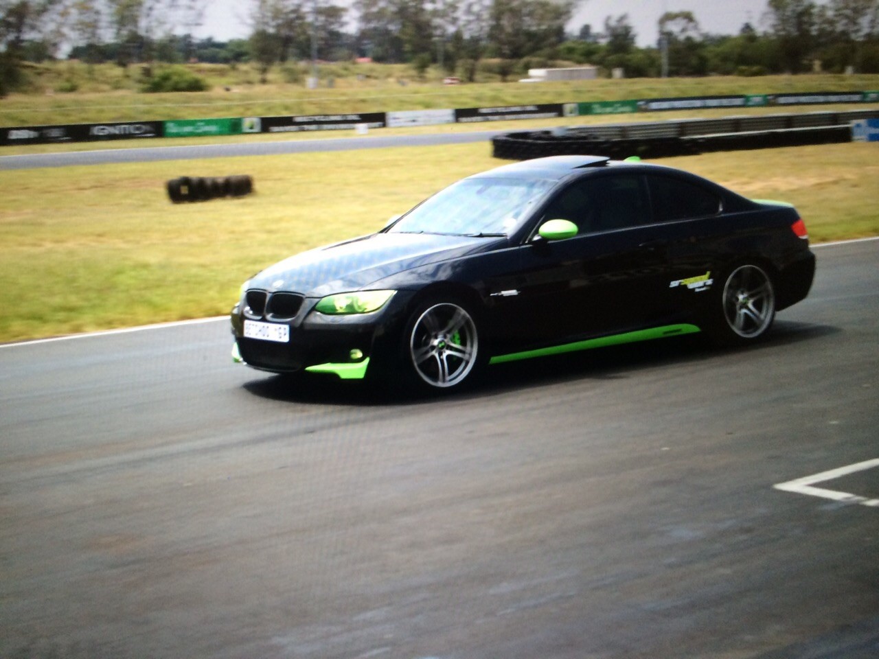

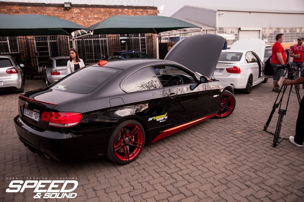

I was asked to represent SRSpeedworx on a show called Tuned in SA where the car featured on TV.
This took place at Swartzkorp Race Track - a day of fun whereby we were allowed to track the car for while before it was featured on the show.
A Couple Short vids on YouTub of the Airing & Some pictures

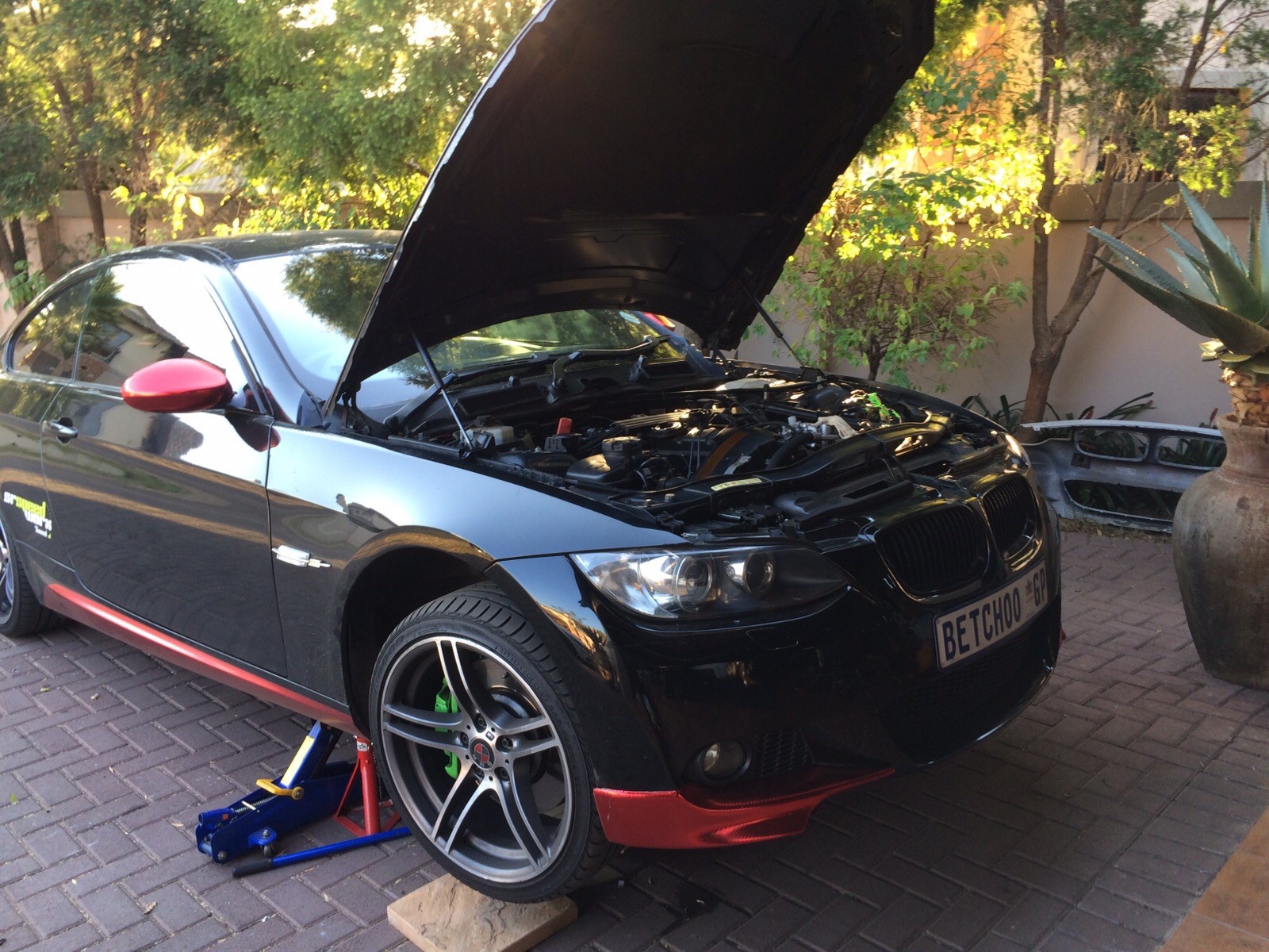

A Mate Anton and myself decided that we want to do the colour change to vinyl and some minor servicing on the car ...lol i say minor
to do list

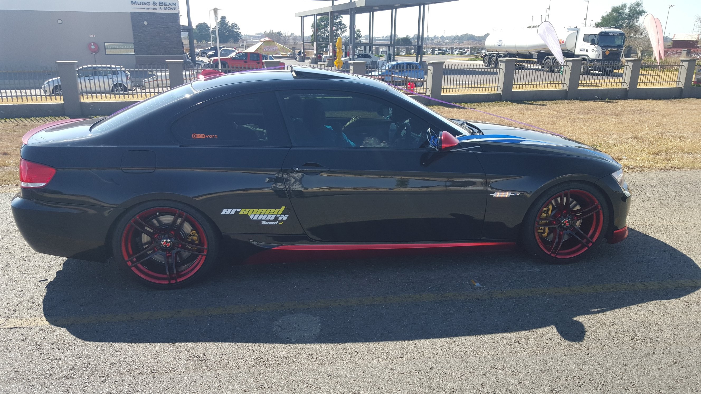

*Custom Colour change to Red
- Red Spliters, Skirts, Mirror covers, and bootspoiler

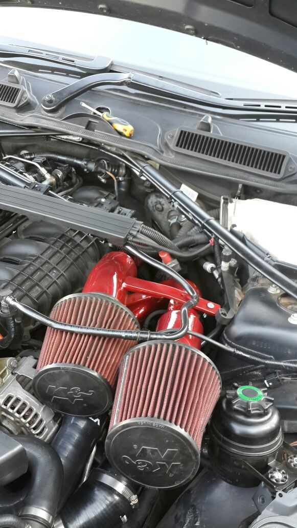

* Added custom coated set of Injen Intakes
* Added Red LED Headlights - Colour changing
* Clean Injectors
* Check coil packs
* Change spark plugs - NGK 1 Step
* Change Tappet Cover Gasket
* Change Oil Housing Gasket
* Change Oil and Coolant

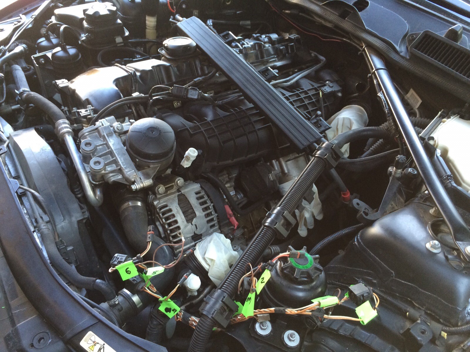

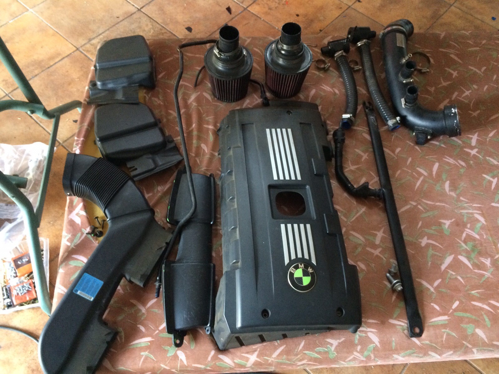

Man - this was a mission as we did all of this at home, we had to strip all parts from the engine bay, labeling each part so we would remember what went where when we reassembled. this whole process took us an entire weekend and a solid night included... but we came out on top at the end of the weekend with the car all fresh and purring again.
A Big Thanx to Anton - a true mate for sure.

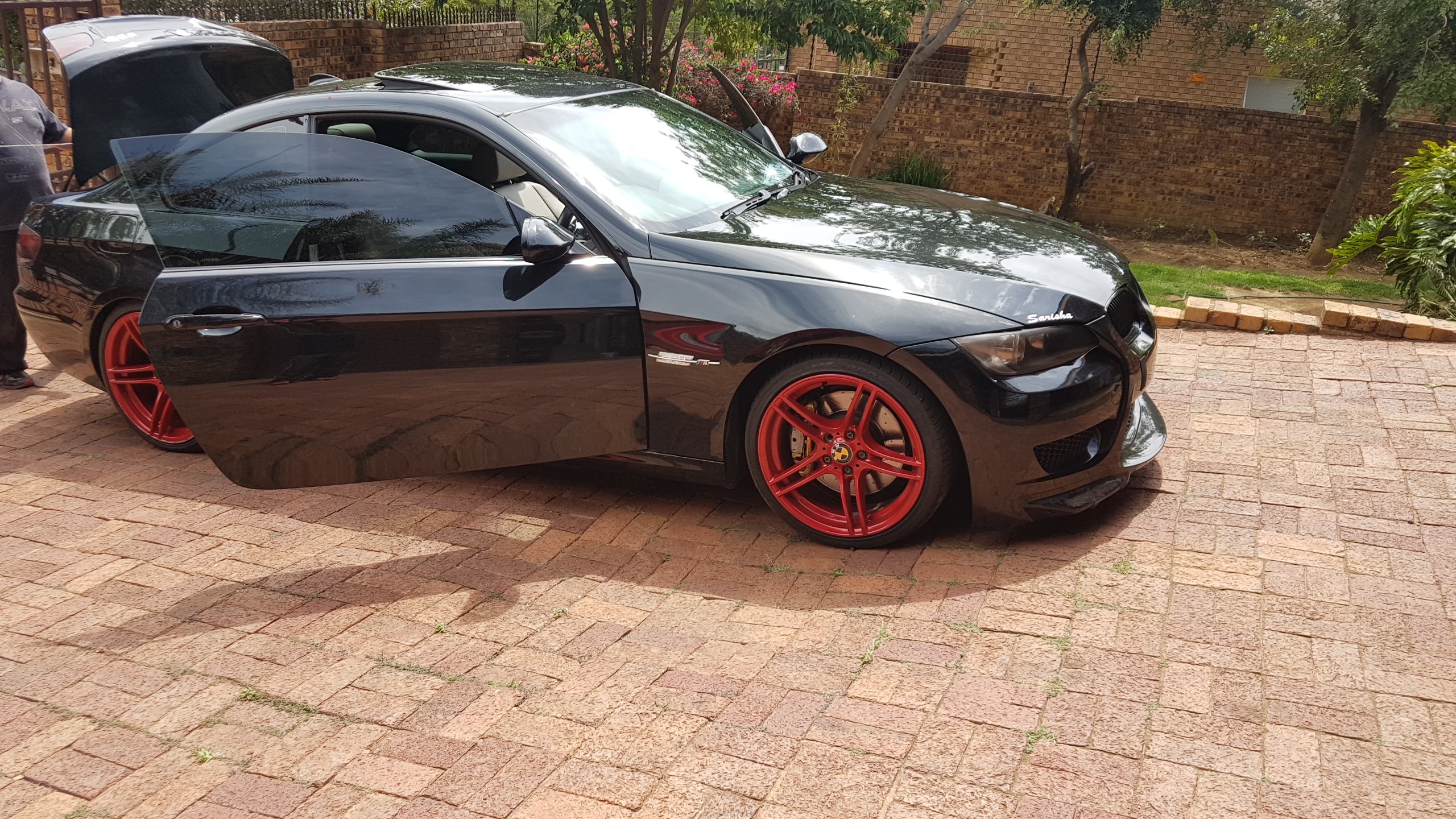

here are some of the pix of my baby striped/Naked and the all dressed in red
I know - i know
Not that tasteful for sure :skit:
But was enough to start the next step of this crazy journey that i always put myself on - it never stops

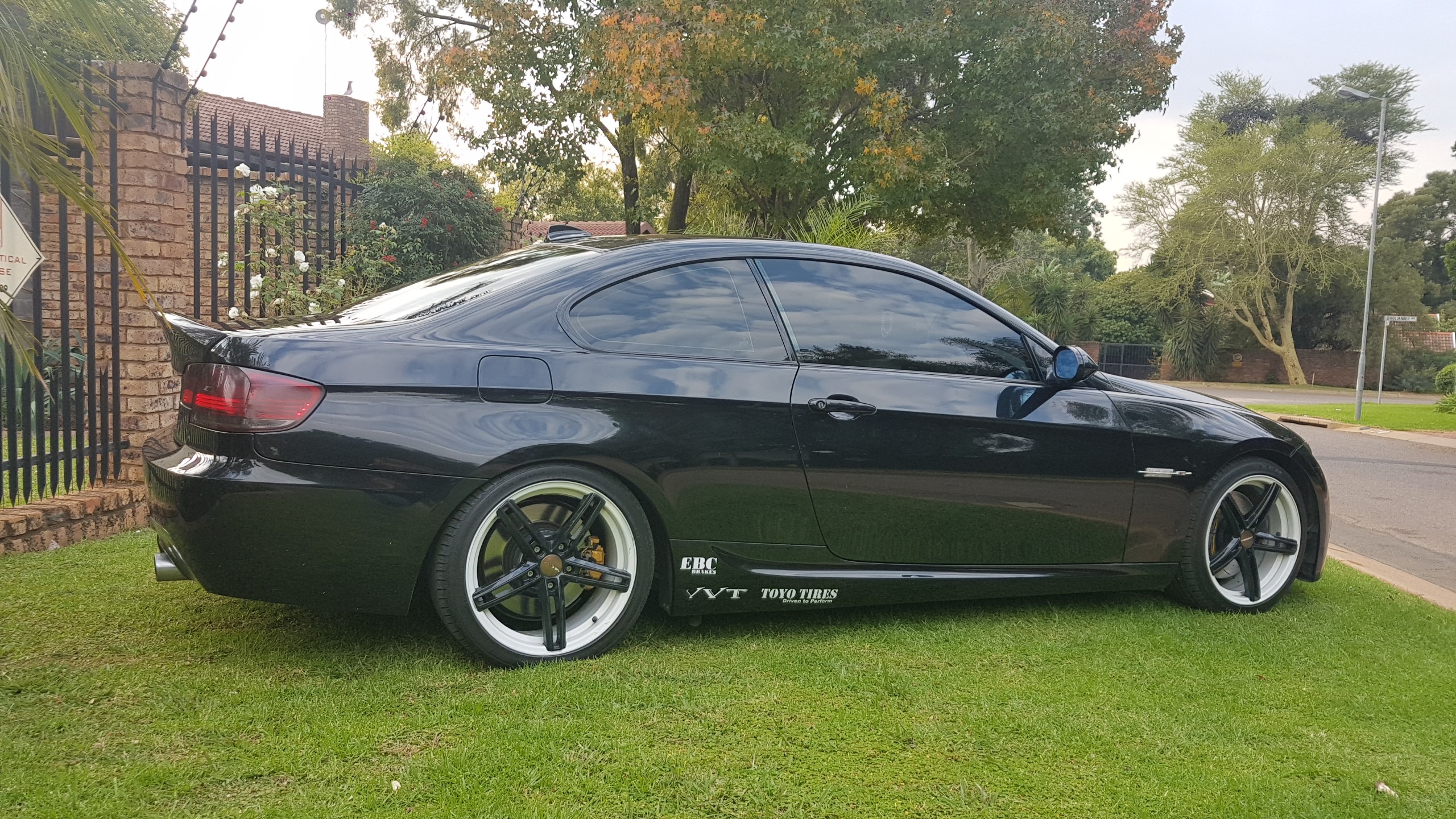

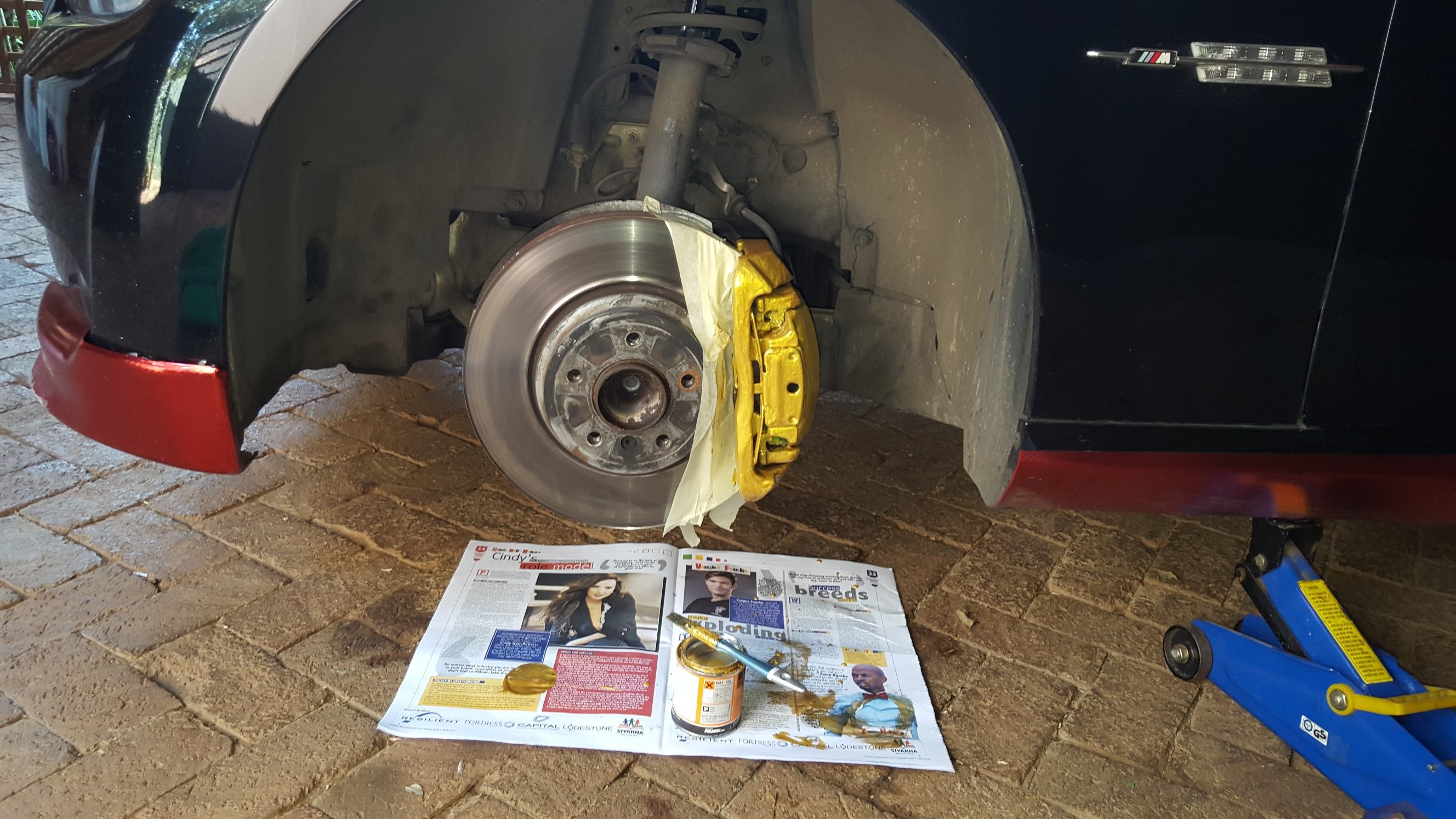

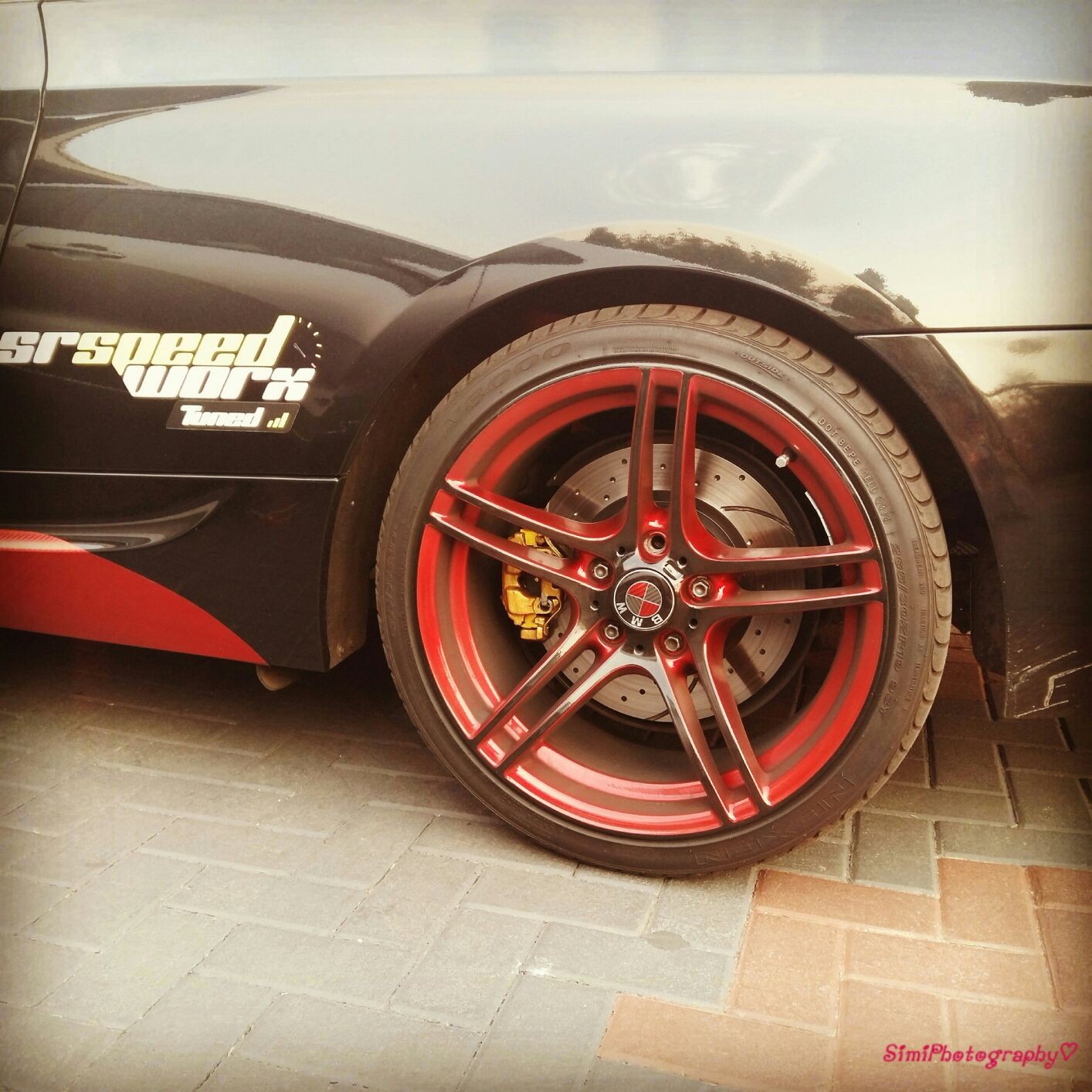

After this TLC session - i decided to go even further with the red on the car as well as add a few more Performance Mods
To do List

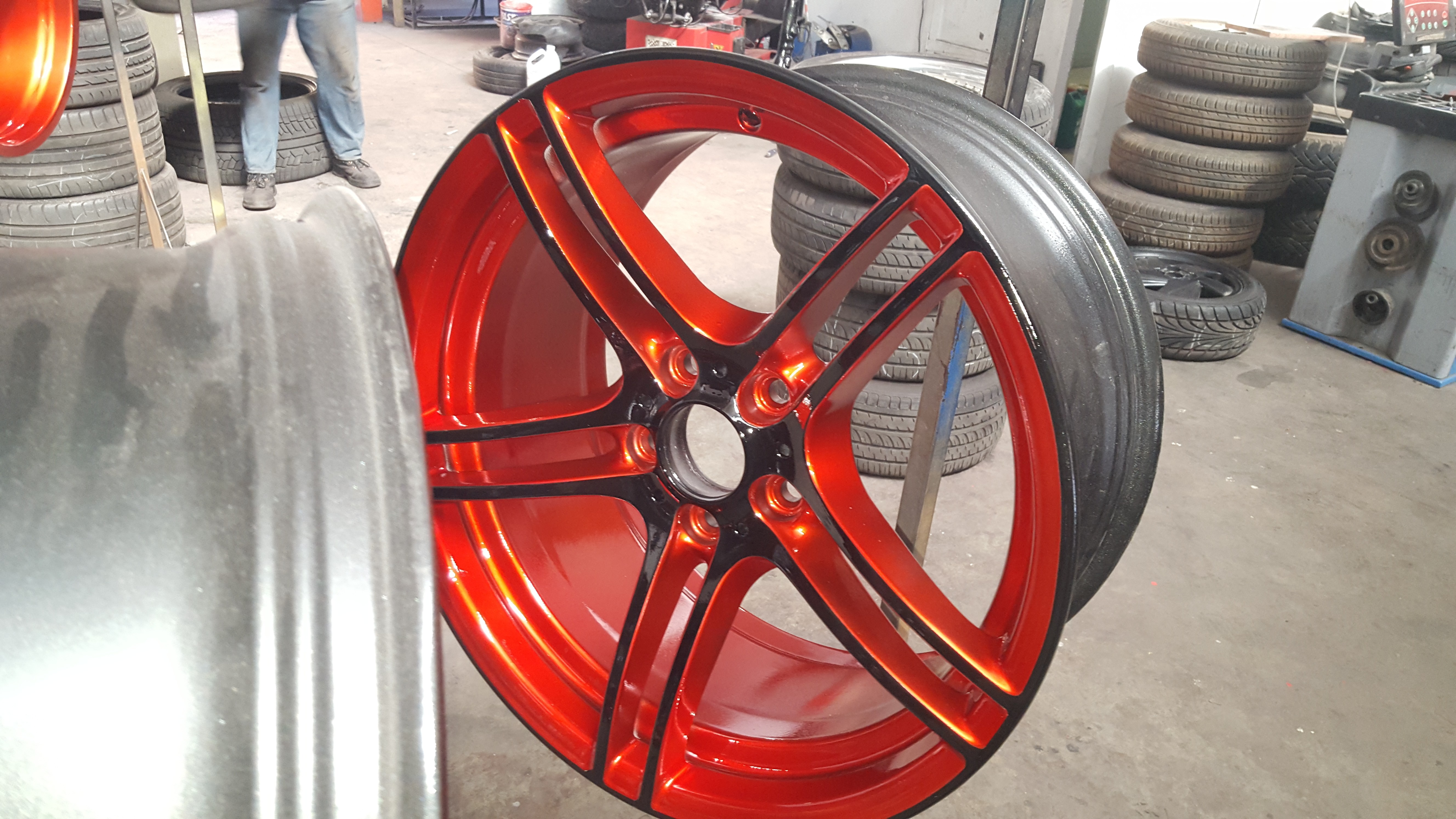

* Customs Colour change of Mags to Red+Black
* Change of Caliper colour to gold

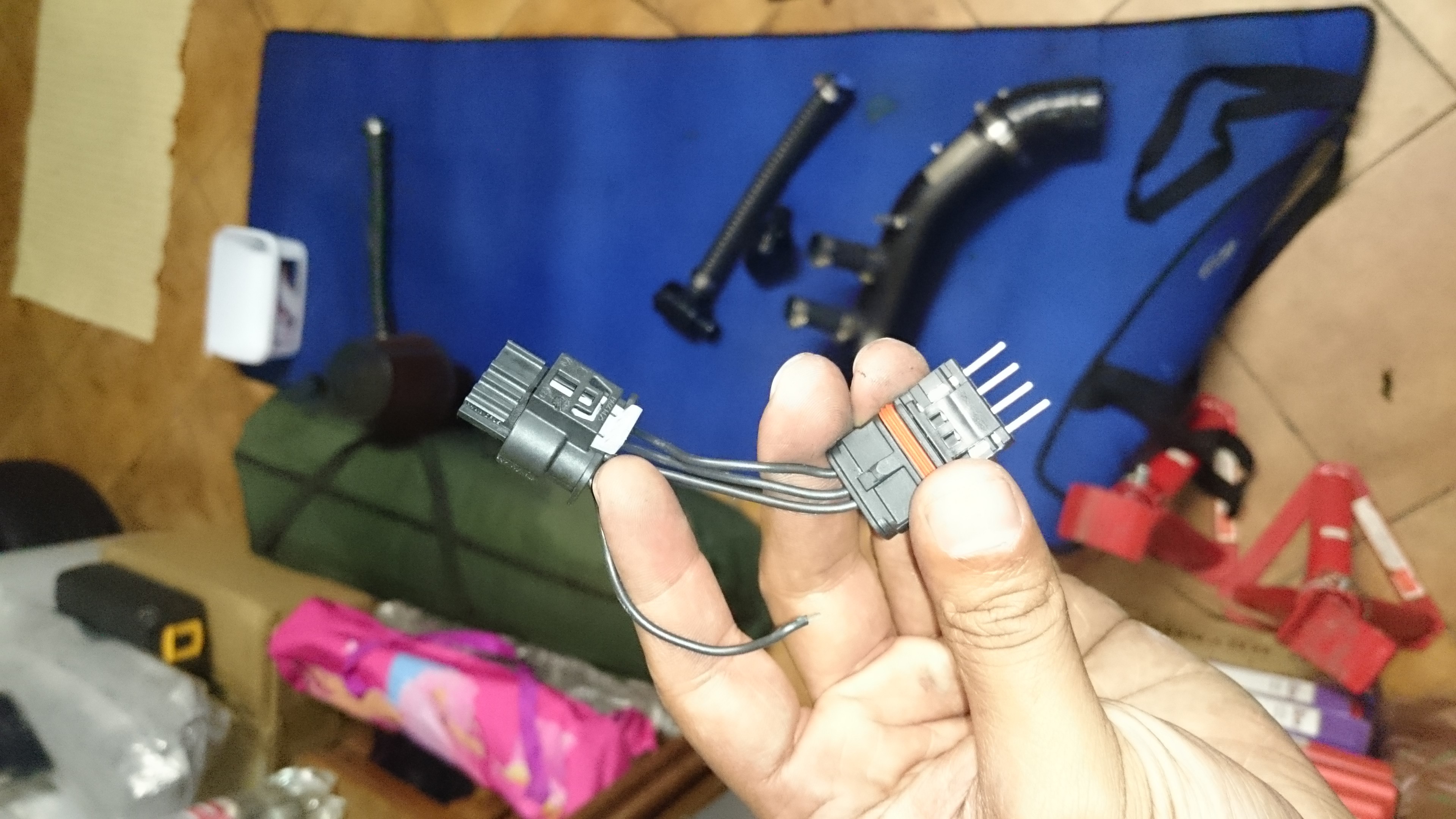

* Add n20 3.5 bar Sensor
* Add BMS Oil Catch Can
* Add VTT Inlets

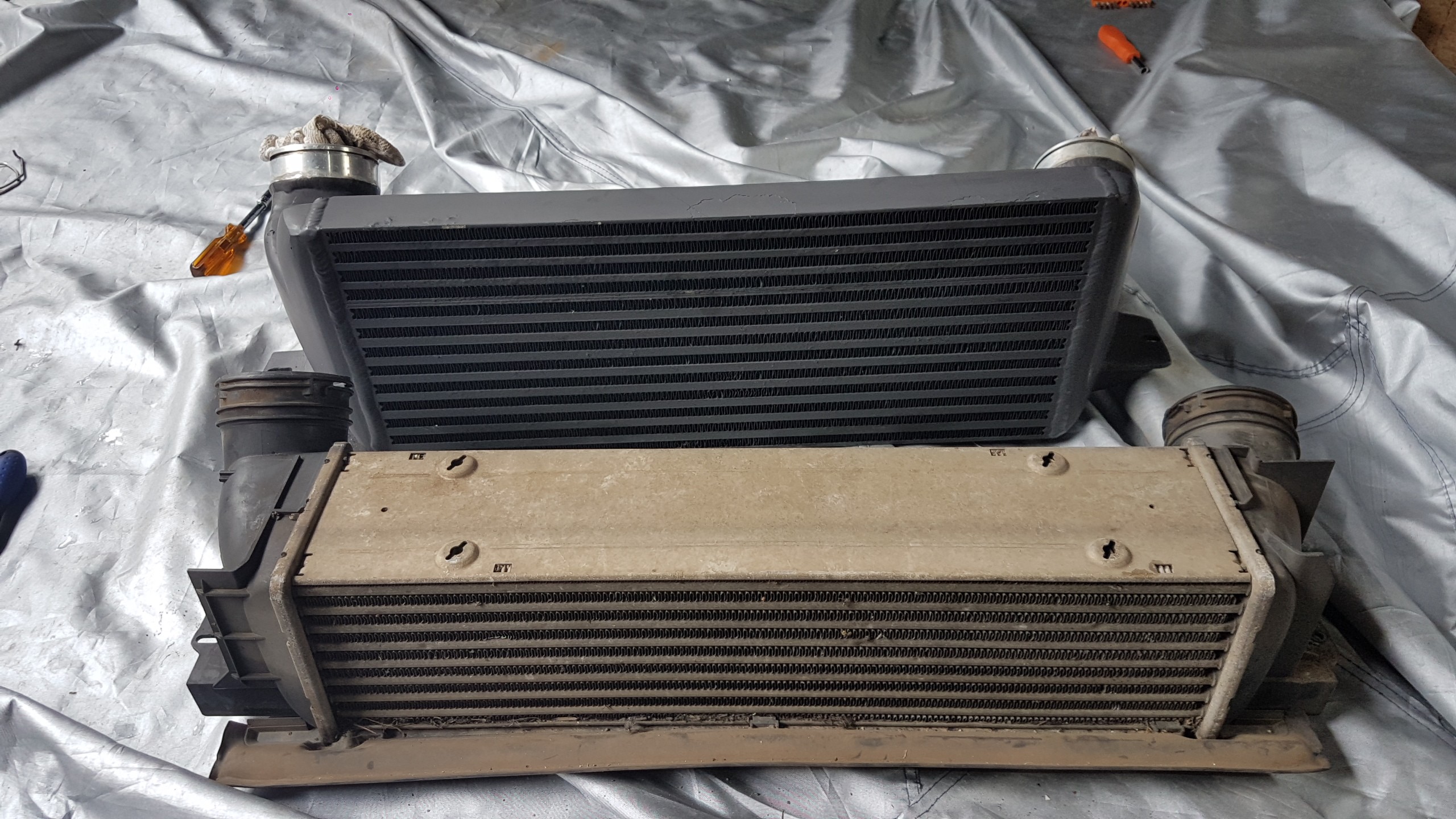

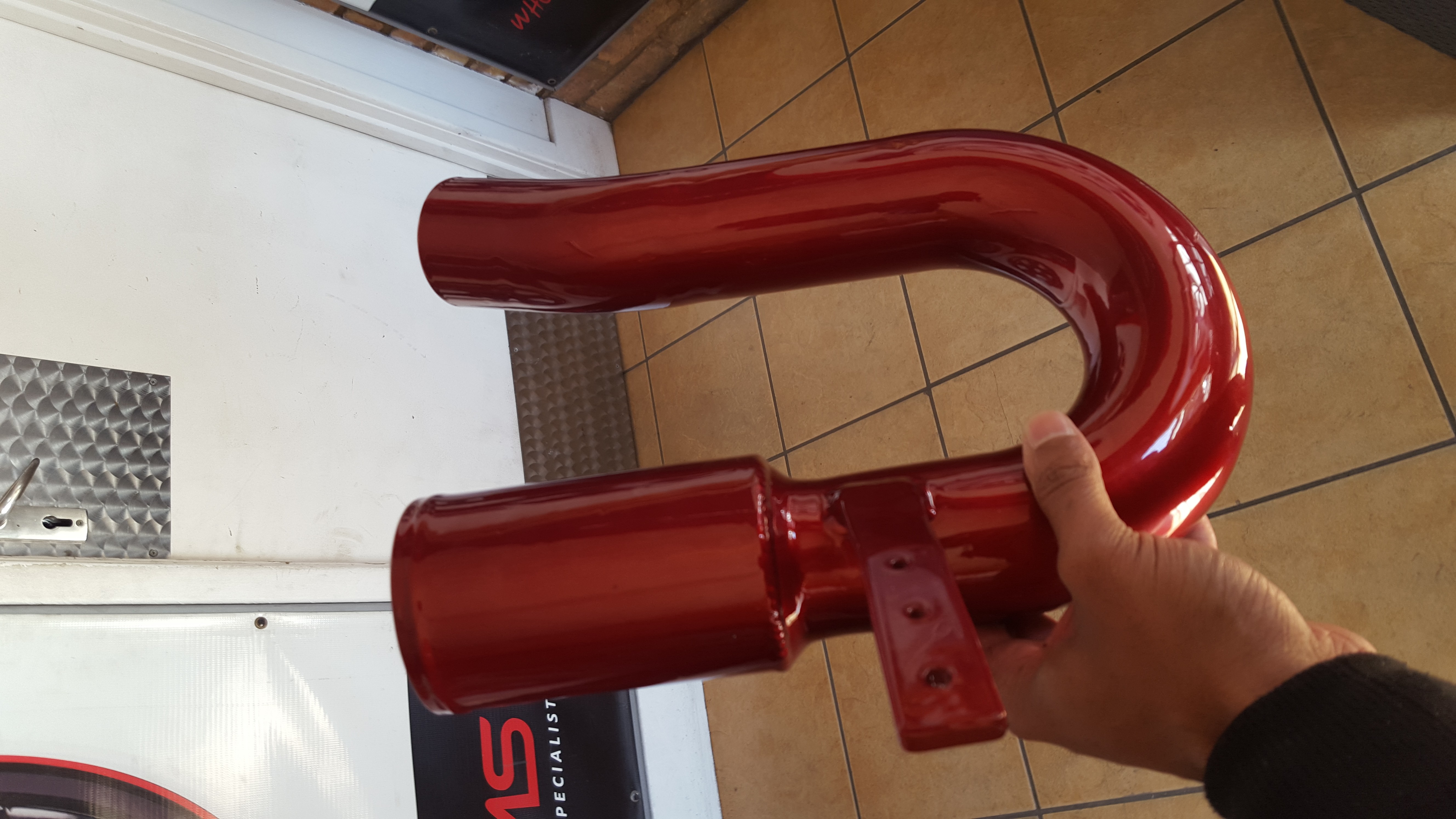

* Added AA FMIC
- Got this of off Chris BT 335i
* Added walbro 450 stage 2 LPFP
- Supplied and fitted by FR&R
* Add Custom Back End Flash
- Supplied and Tuned by SRSpeedworx

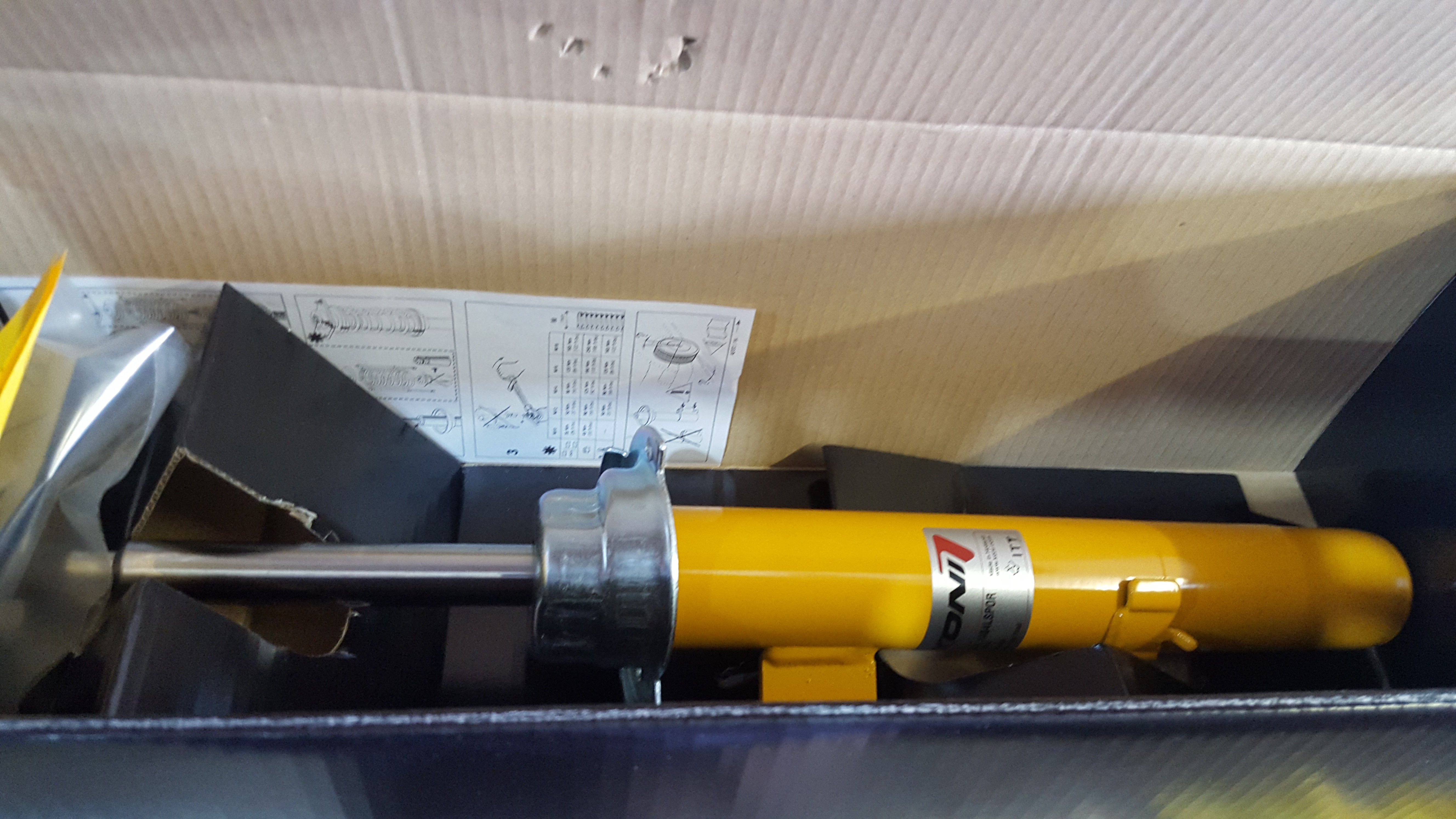

* Added a set of Koni Sport Dampers
- Supplied by Sean - Axix

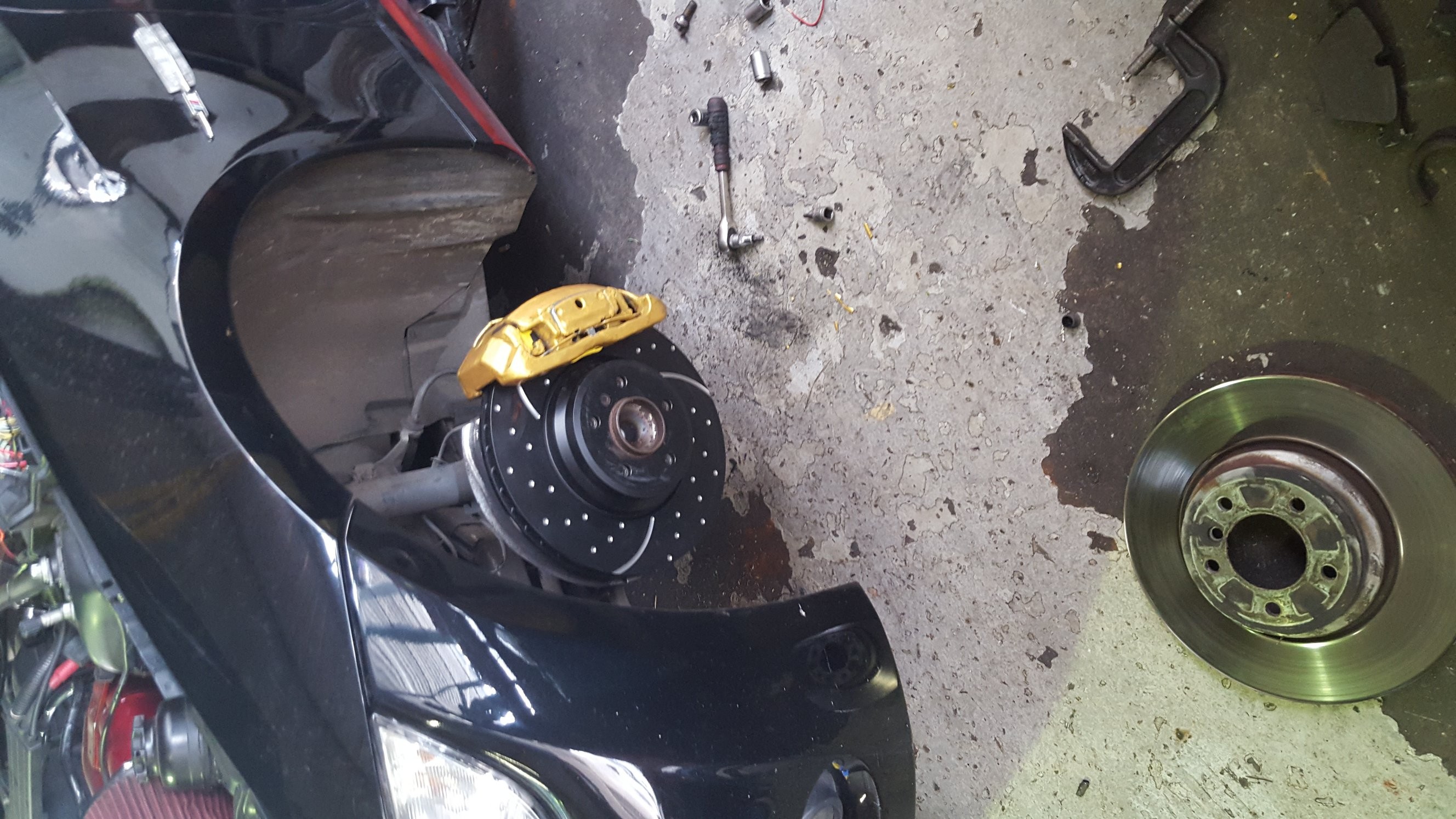

* Added EBC Brake Upgrade with Yellow Pads

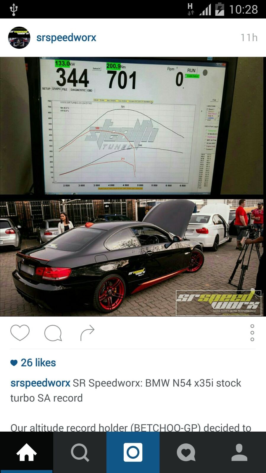

Yet again after this round of Spending cash and getting things right
We hit the Dyno in GP as well as in KZN - wanted to see figures in both regions
As always car did not stop amazing us with the capabilities.

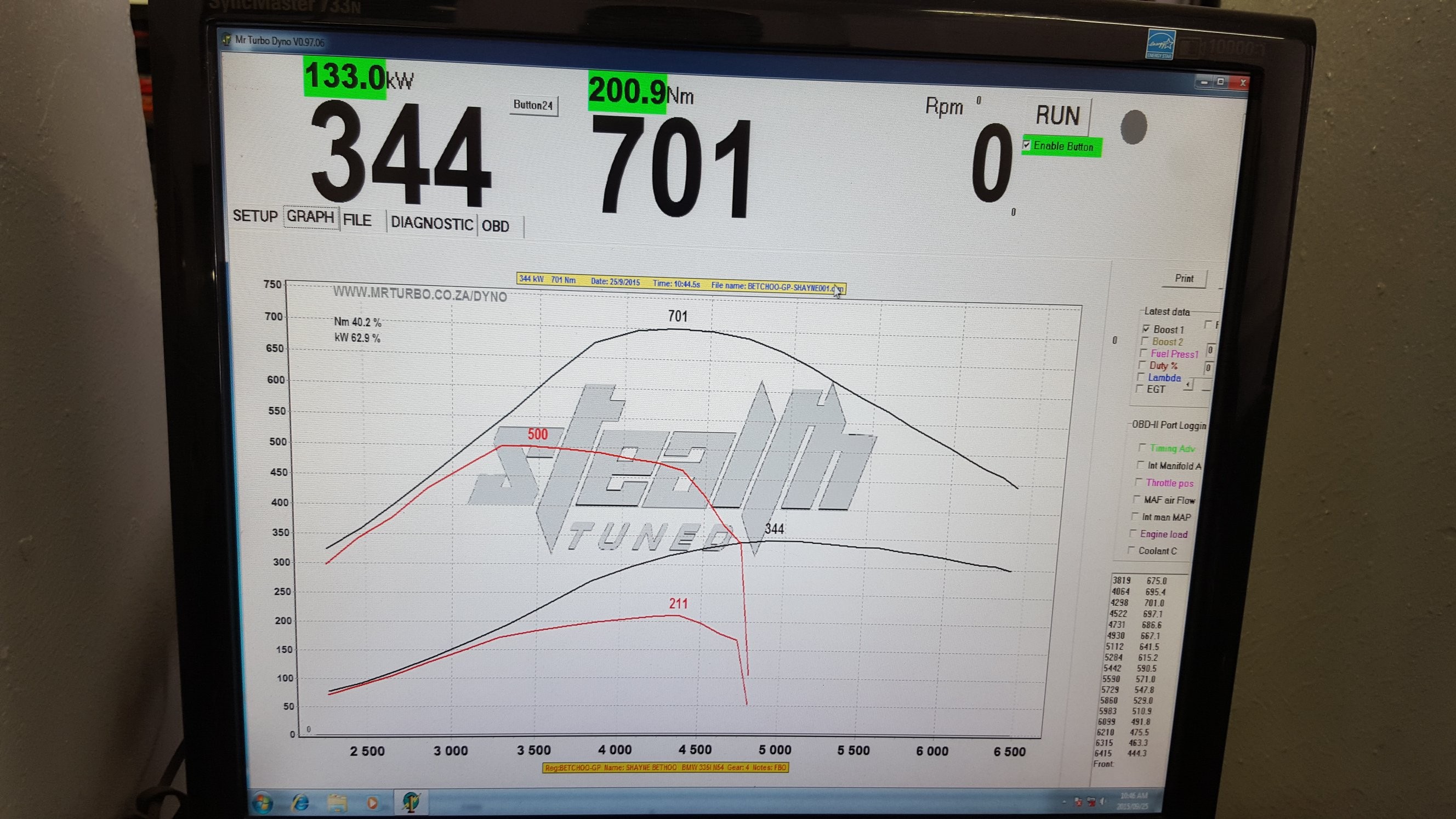

Figures in GP .....302wkw & 630nm
Figures in KZN ..... 344wkw & 701nm - Strongest 335i on Stock Turbos
(at the time - not sure if it still is)
We also ventured to Drag Wars 15 where the car ran a good 12.6 over the quarter mile on stock turbos in GP - Sadly i never took it to the coast to see what it could do.
Here are some Short Vids of Power runs for Stock Turbo Figures in KZN as well as some Drag Wars Runs
Along with some Pictures of the car at the time

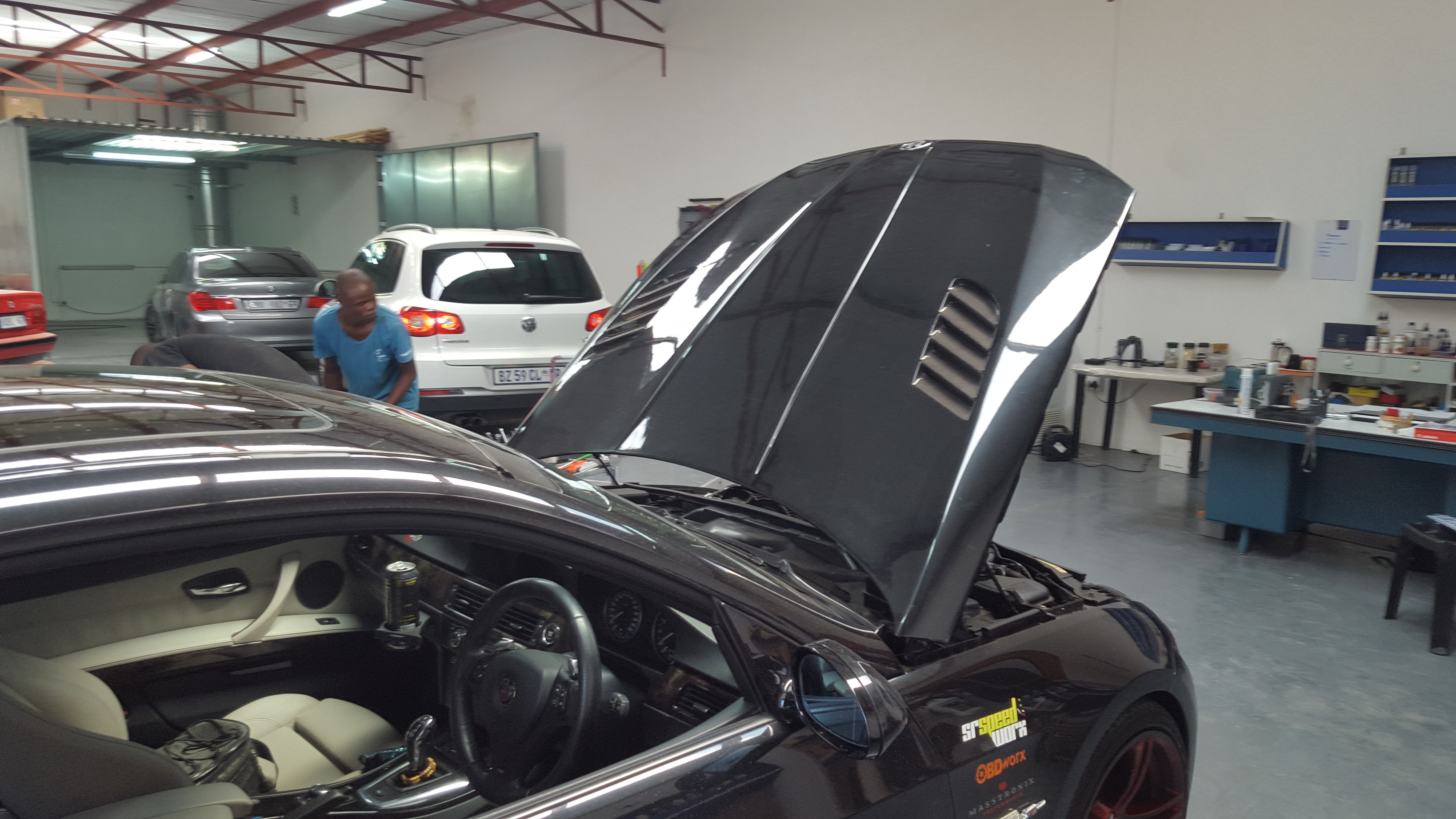

- Vented Carbon Bonnet
- Supplied by Fir/Rennzsport

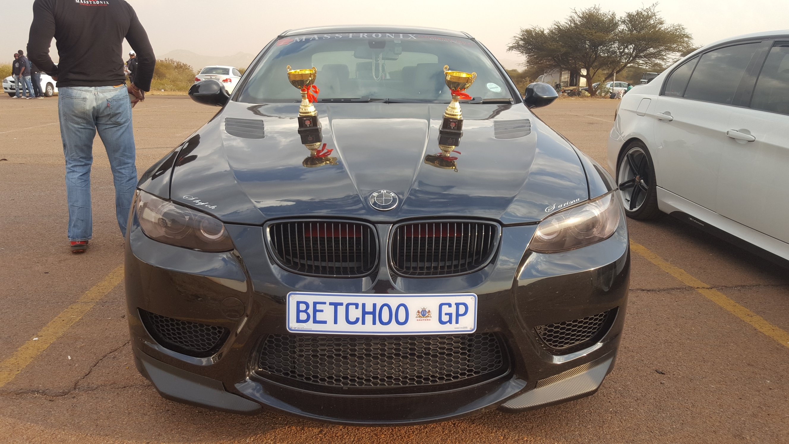

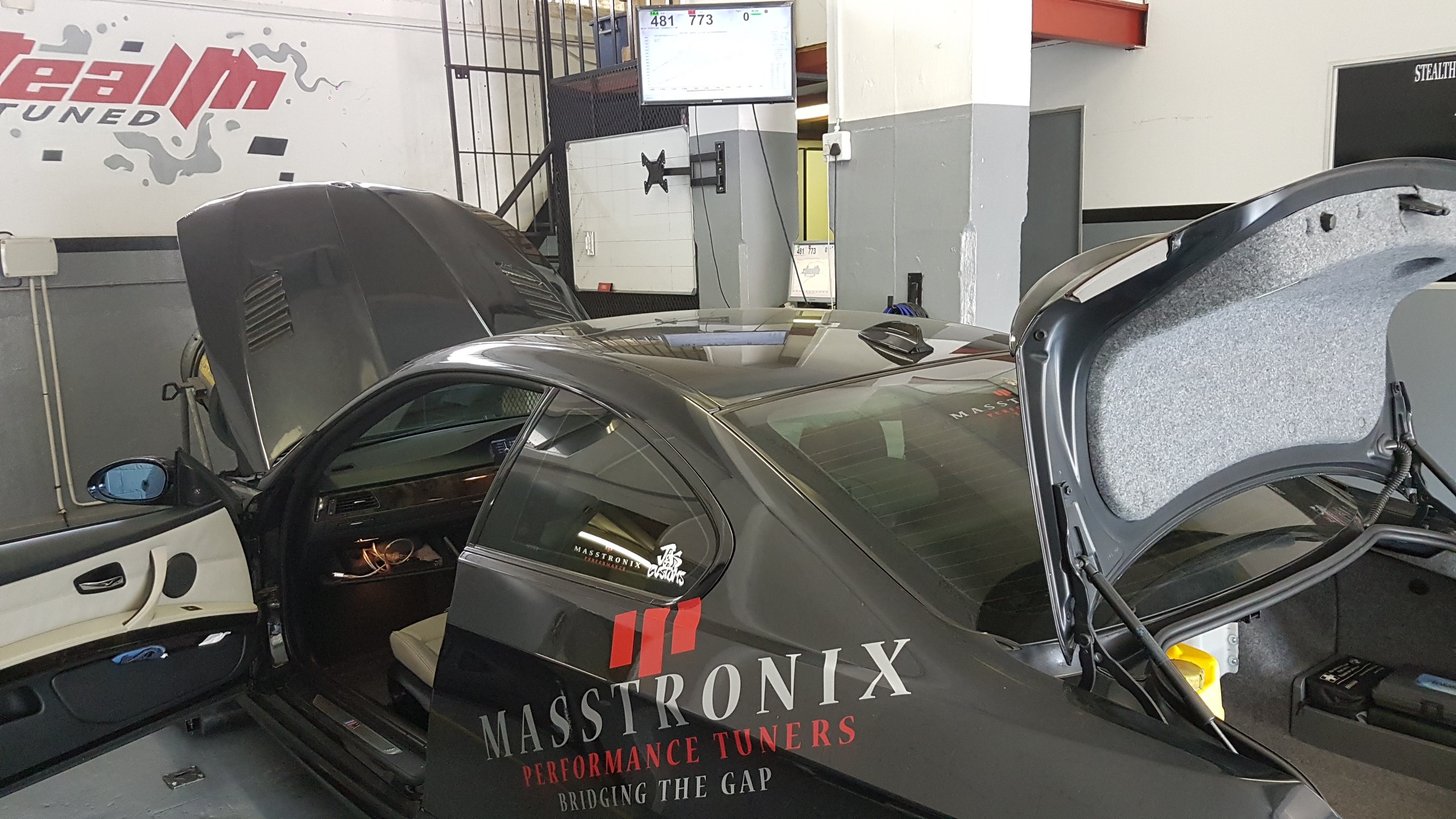

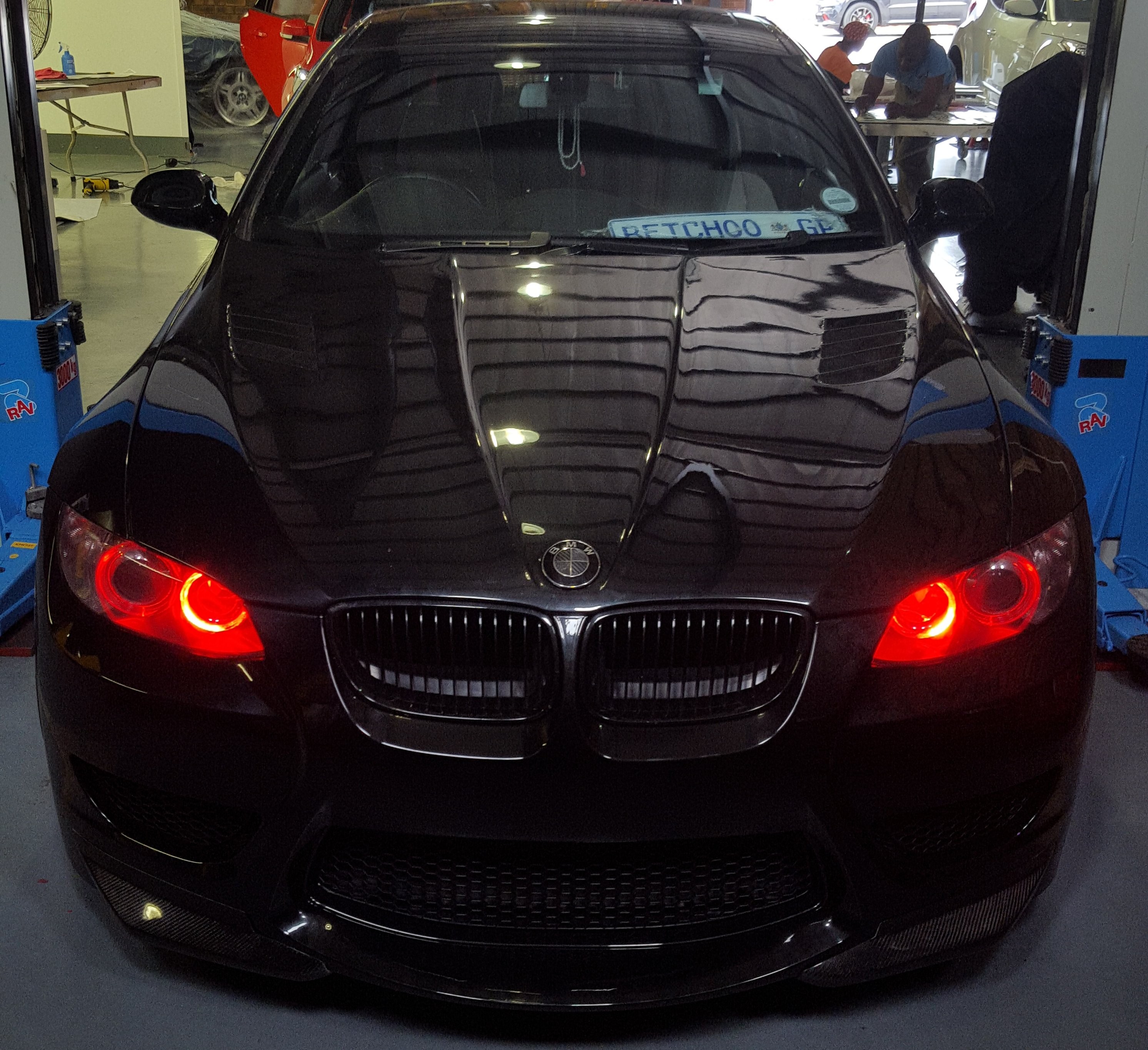

Once all additions where done, i tested the beast on the R21 doing some strong pulls and fine tweaking the file i was working on. The backend was created to run JB4 map 3 daily with Pump fuel (95) and as much octane that i felt like using when i wanted to. The aim was to get a reliable daily file that would not take too much out of the cars use. I managed to achieve this eventually after a good few nights of playing around. _ a thank you to the wife for putting up with me during this time...:blowheart:

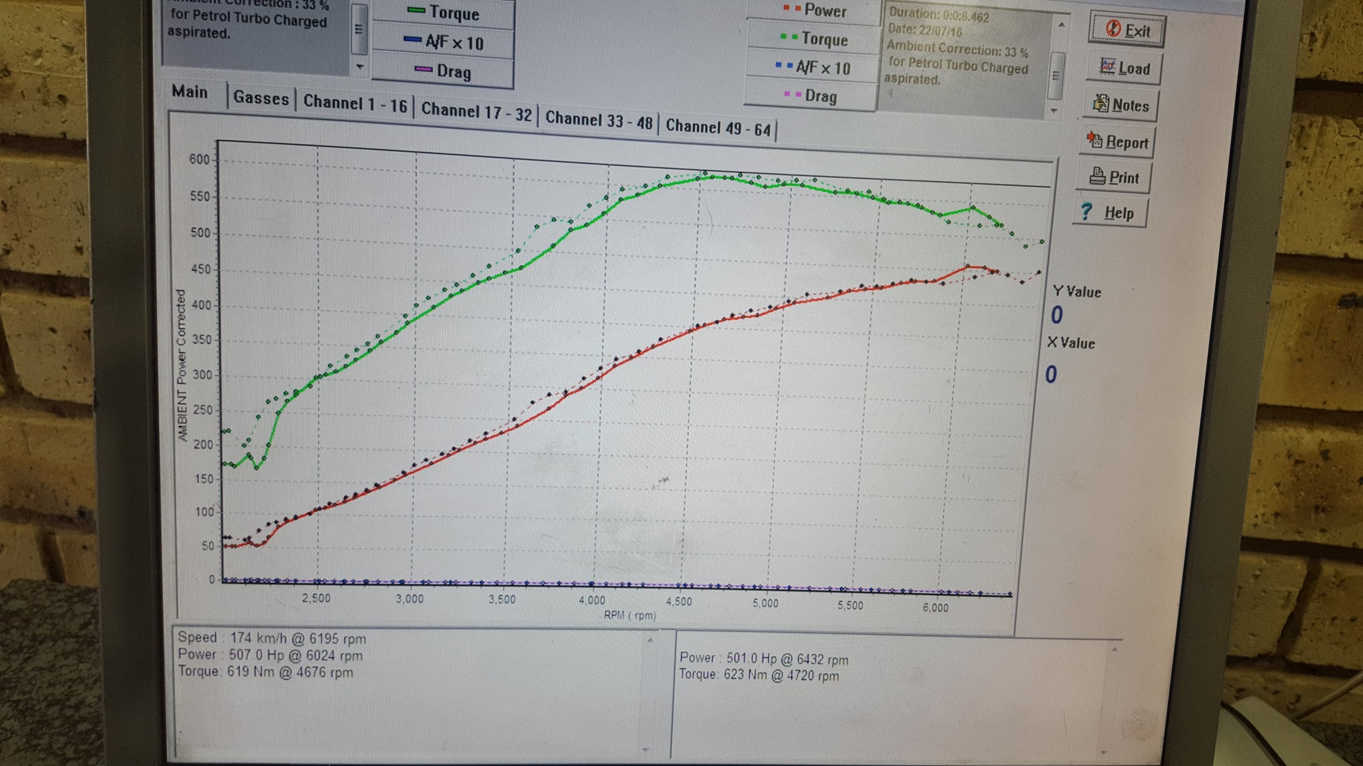

Once i had completed all that i could in the time that i had, i took the beast to FR&R to dyno the car the day before Fanatics Race Day (Chris Happened to be there at the time and welcomed me in to the 500+hp club)
Figures the day before Race......378wkw (507hp) & 619nm
This was on Map 3, Meth + 40% Eth
Sadly i did not get a chance to Tune a Map 6 - Race file before Race Day.
Again - To No Dismay - the Car Performed the way i expected it to...like a beauty

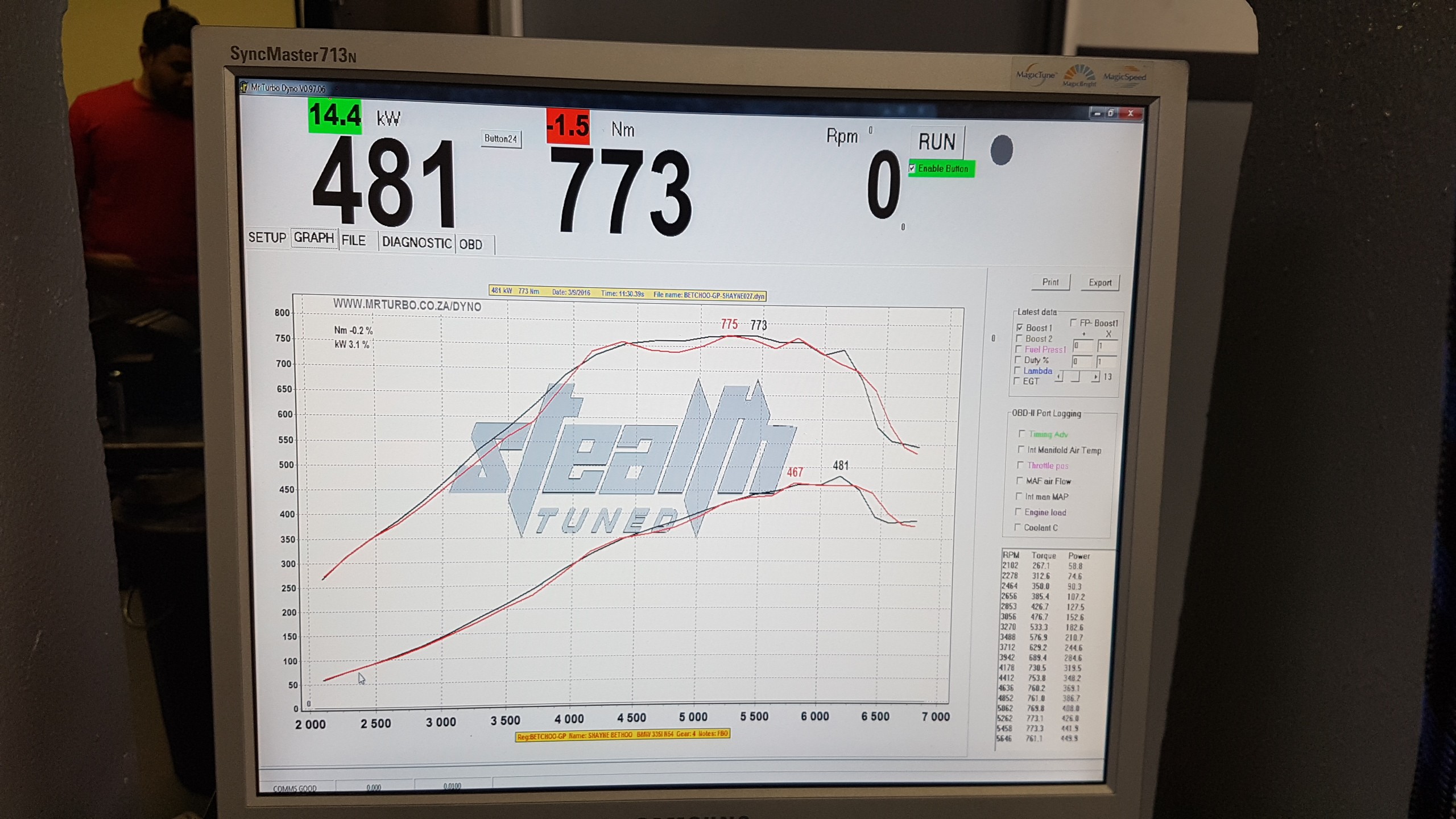

After race day - the wife and i made our way down to KZN for a weekend, where i took the car to Stealth to play around on the Dyno. With Some Help From Ashen at Stealth We managed to achieve some good figures of
....481wkw & 773nm (with 40% Eth - Map 6 JB4)
(I believe Hamza Akoo was there with us from Global Tuning)
before i had to run off to a wedding..tuning was placed on hold and stopped for a while as i did not get a chance to head back to stealth to finish up
Here are some vids of Race Day and Some runs when i was tuning car as well as some pictures of how she looked at the time.

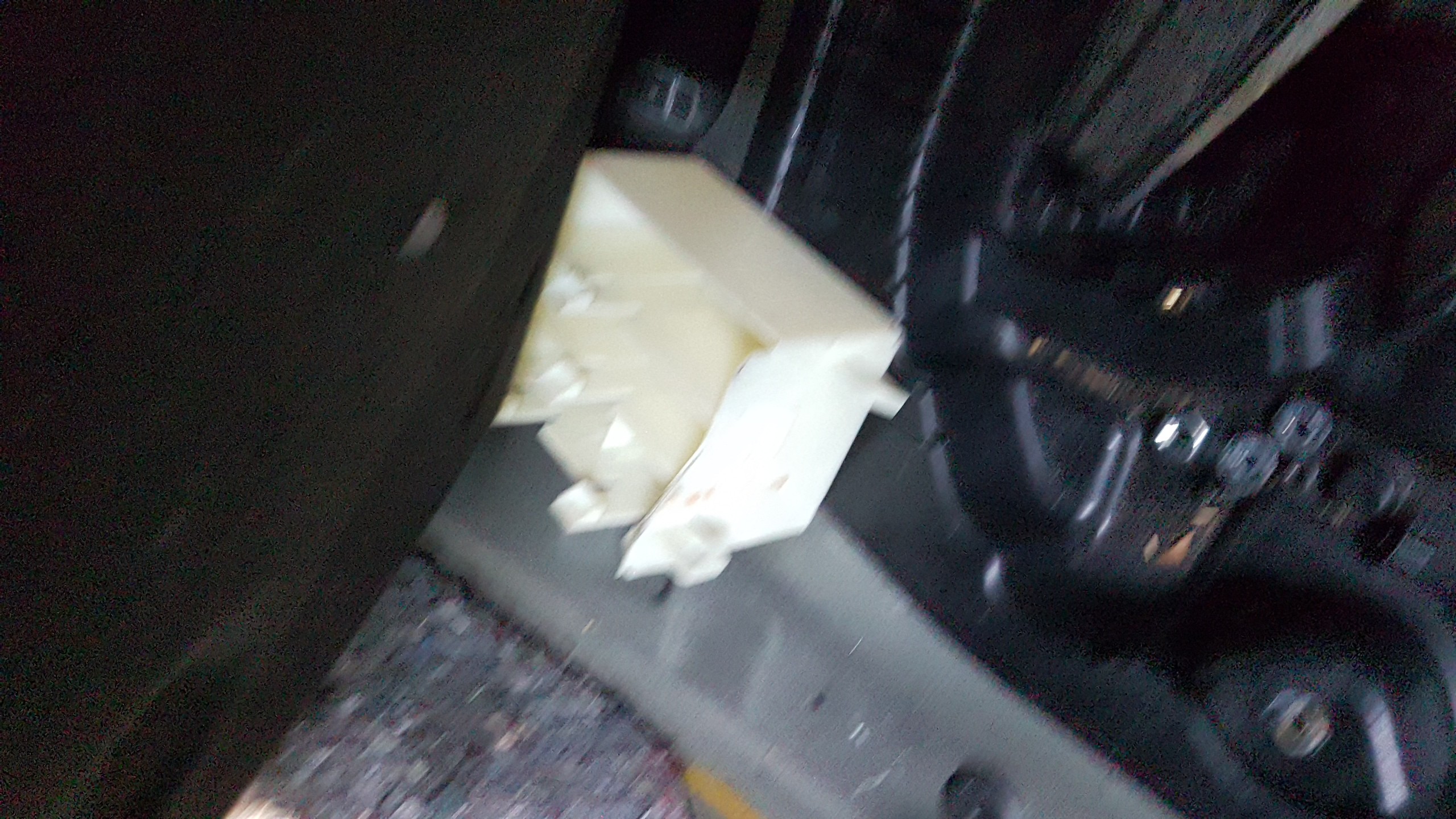

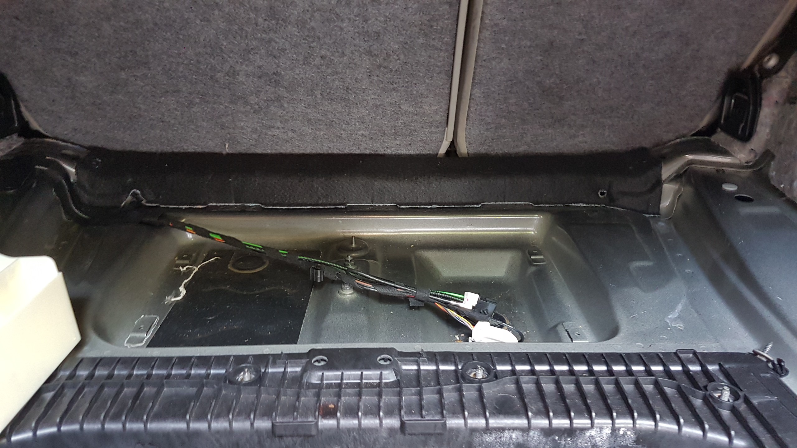

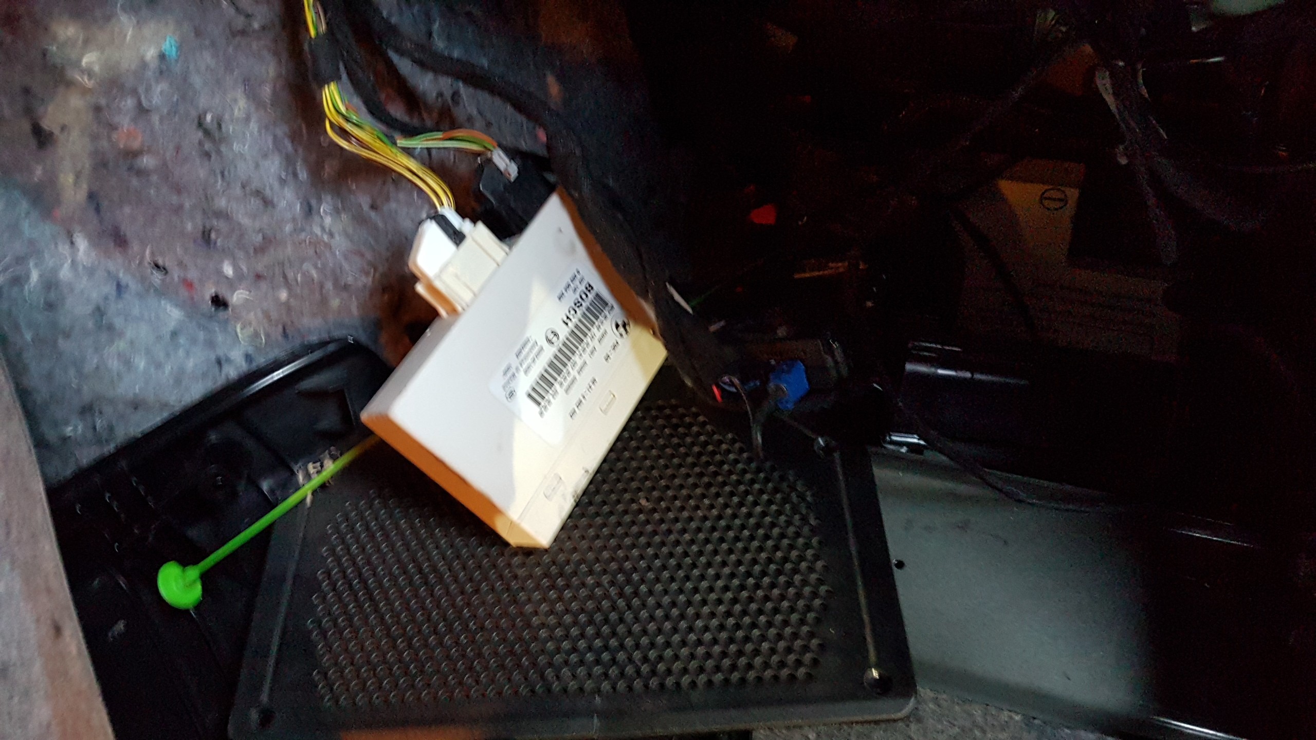

With all of this said - here is were it just got worse for me, I get a call from eBoost Tuners to say that the car does not want start. i was shocked as it was a 200% error free car. I rushed over had a look, reloaded a stock fiile and bobs your uncle she started first time, no issues at all, Let her idle for 30min, switched her off, waited 10min, started her up again first time, took her for a drive. All Good, so i gave the go ahead to sell as planned. 2 days later i get a call again, the car cannot start and buyer was on his way to view and collect if happy. I said i left the car in working order i expect it to be the same when buyer get there, sadly this was not the case, the car was simply fk'd up (Excuse the language - um sure you can feel my Anger and Pain) Eventually i had the car put on a Flat Bed to be brought to my House. On upon arrival i had a look to see what the issues could be, and to a stunned, shocked, disgusted look on my face, my car was literally striped bare, panels were off the car, the boot was stripped solid, Modules where missing, Under seat Subs removed..it was truly a sad sight to see such a pristine car come back looking like a piece of trash.
I later after calming myself down sent to a BMW Specialist down the road from me (Craig from BMW Menlyn) he went over the car with a fine tooth comb and sorted out the issues, which was the wiring in the car which had been damaged, ONLY god knows why this was the case, But at least she was running again at an extreme Cost. After that i then sent her to a Panel beater to get all the interior and Boot Sorted out - Again More cost - eish
(Cost to flat bed, Cost to assess and fix - we all know BMW is not cheap toy)

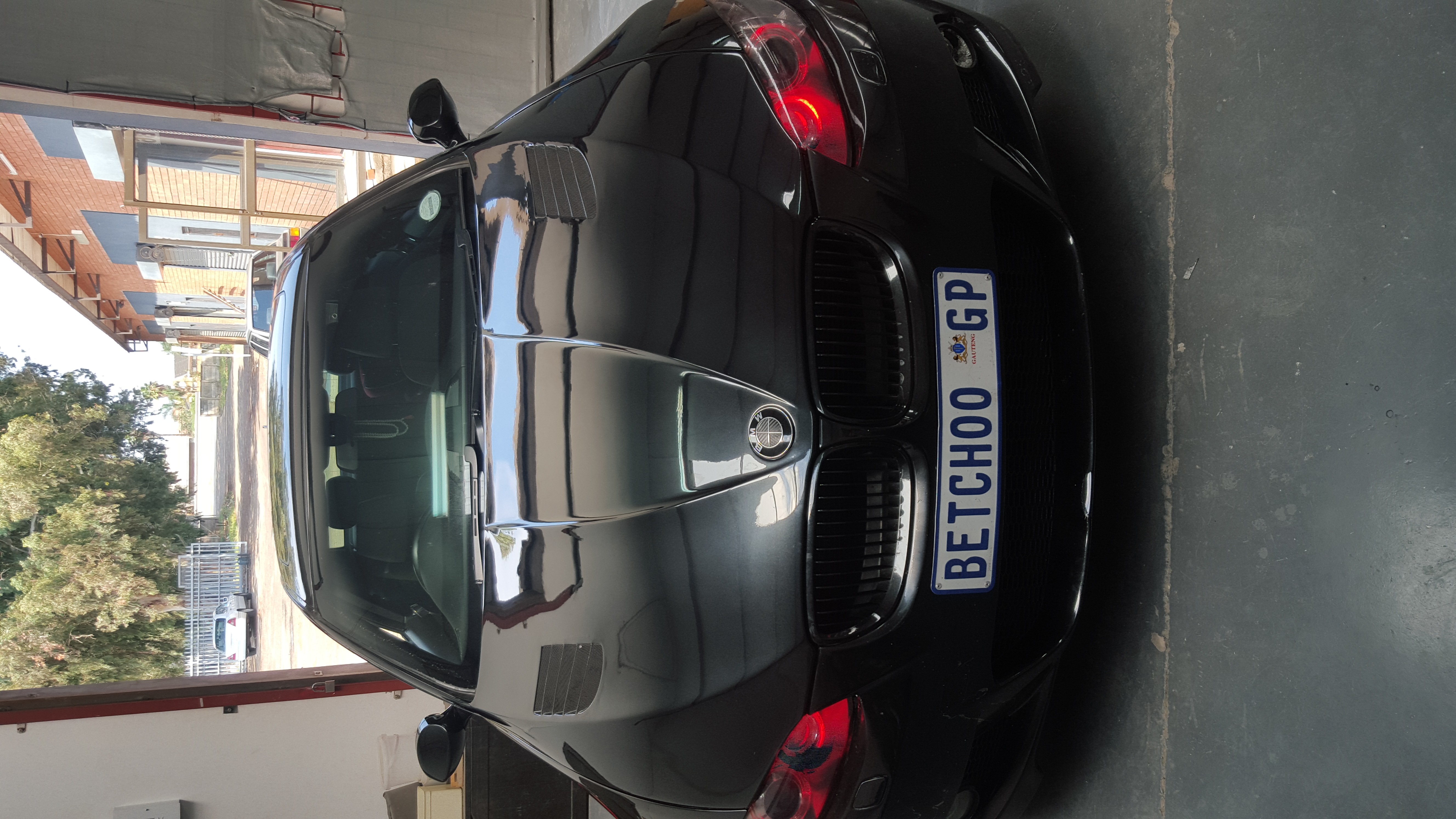

After all of this, she was put back together and in running order, not the best running order but running order needless to say.
Here are some pictures of the whole debacle :cry:

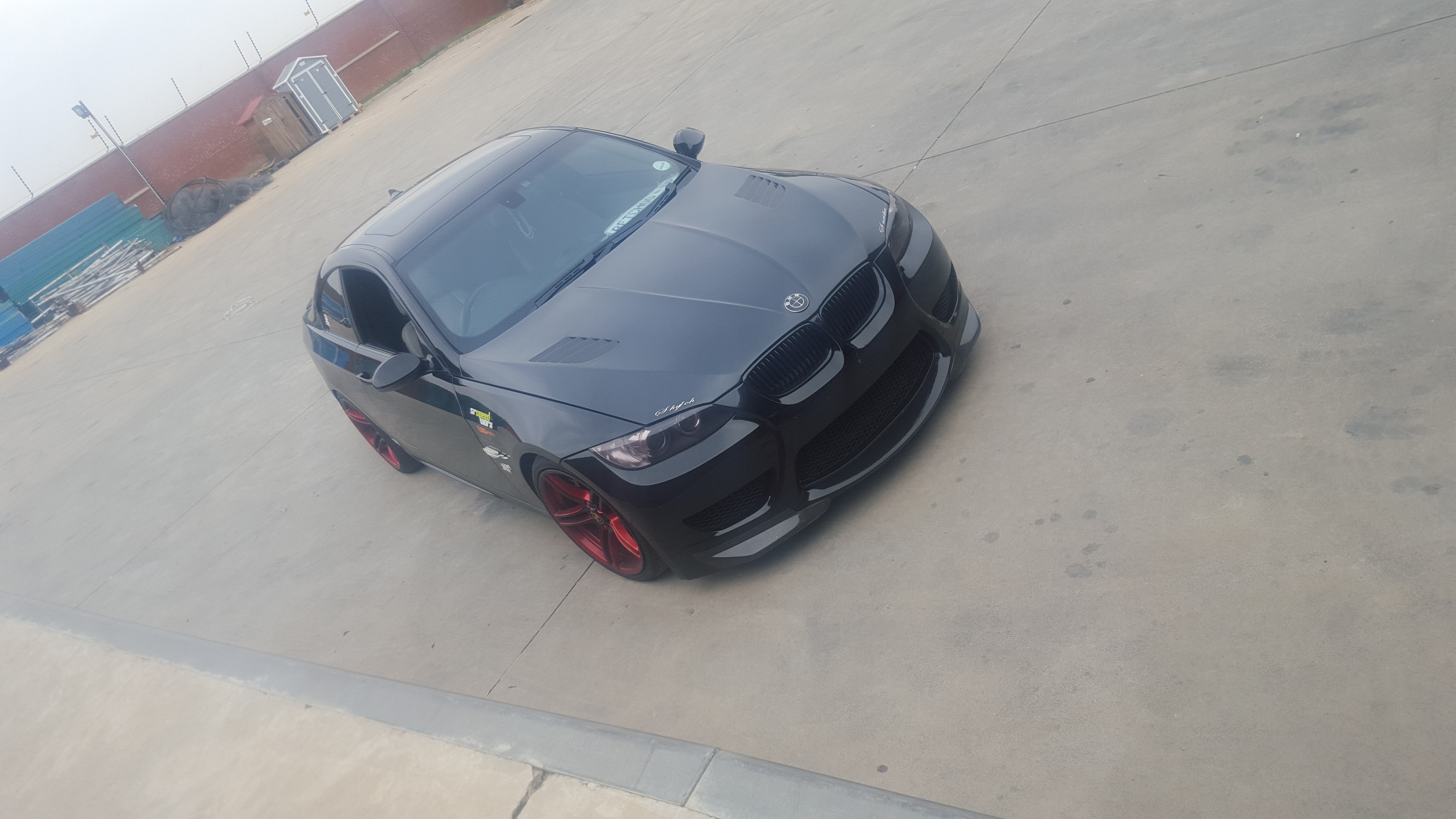

After all of this headache, sweat and effort put in to getting the car running again, the wife said we spent way too much money on it to let it just go. SO I got the BOSSES go ahead to keep the car, but this put me back to square one - NO Customs Looks, NO Performance Modifications.....:thumbdo:

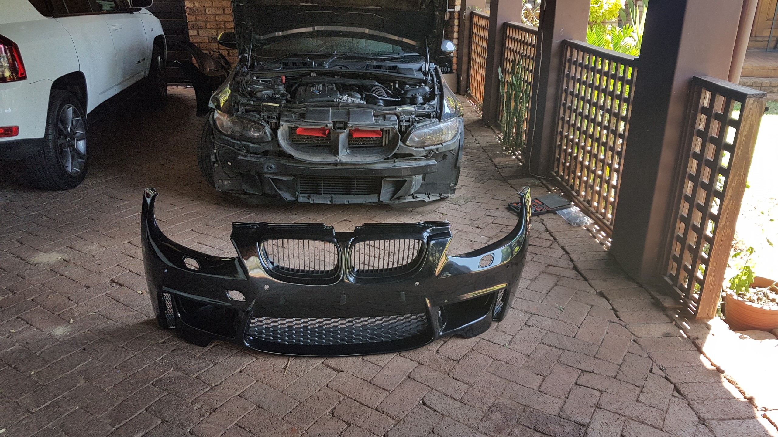

So here we go again....:skit:
To Do List

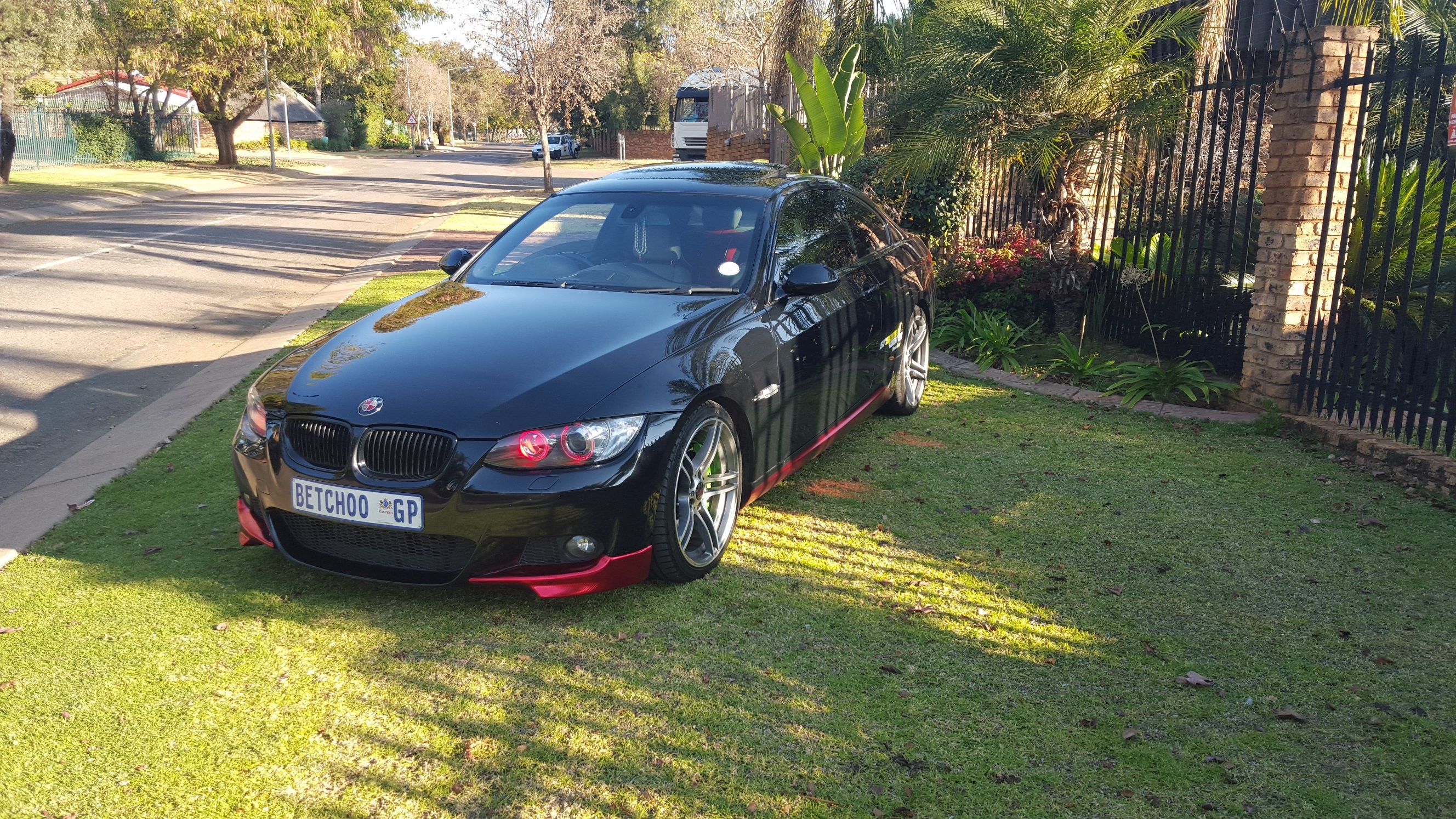

Styling/Customs
* Carbon rear apron to be replaced
* Air scoops to be replaced
* CSL bootspolier to be replaced

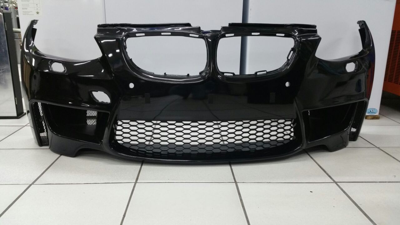

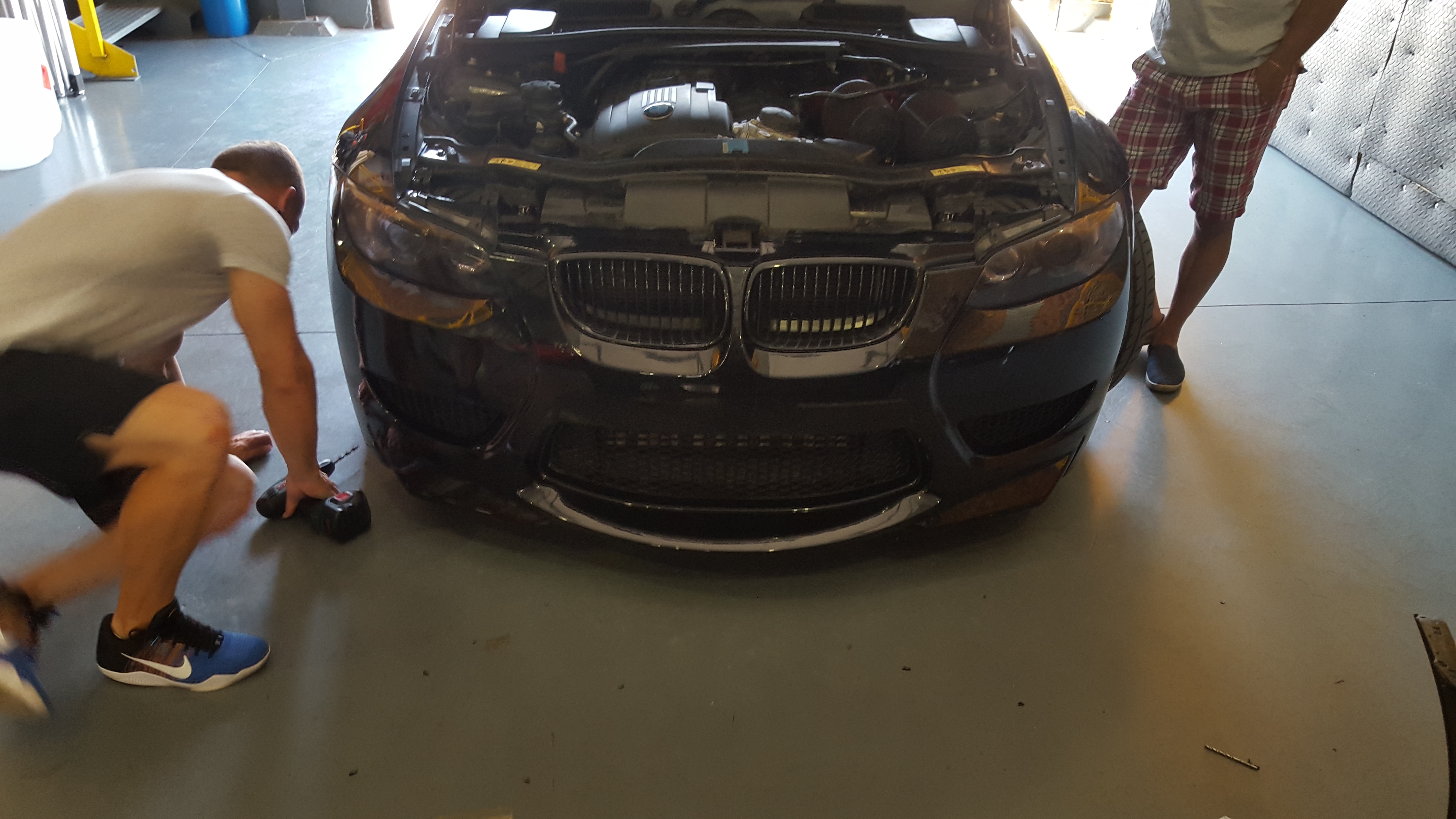

* 1M front bumper to Be Added (replacing the Ericsson Amuse Front bumper)
* OEM bonnet to be fitted (For Now) - Custom later on
* Colour Changing angel eye to be replaced
* OEM subs fitted to be replaced (upgrade of sound system to be later)

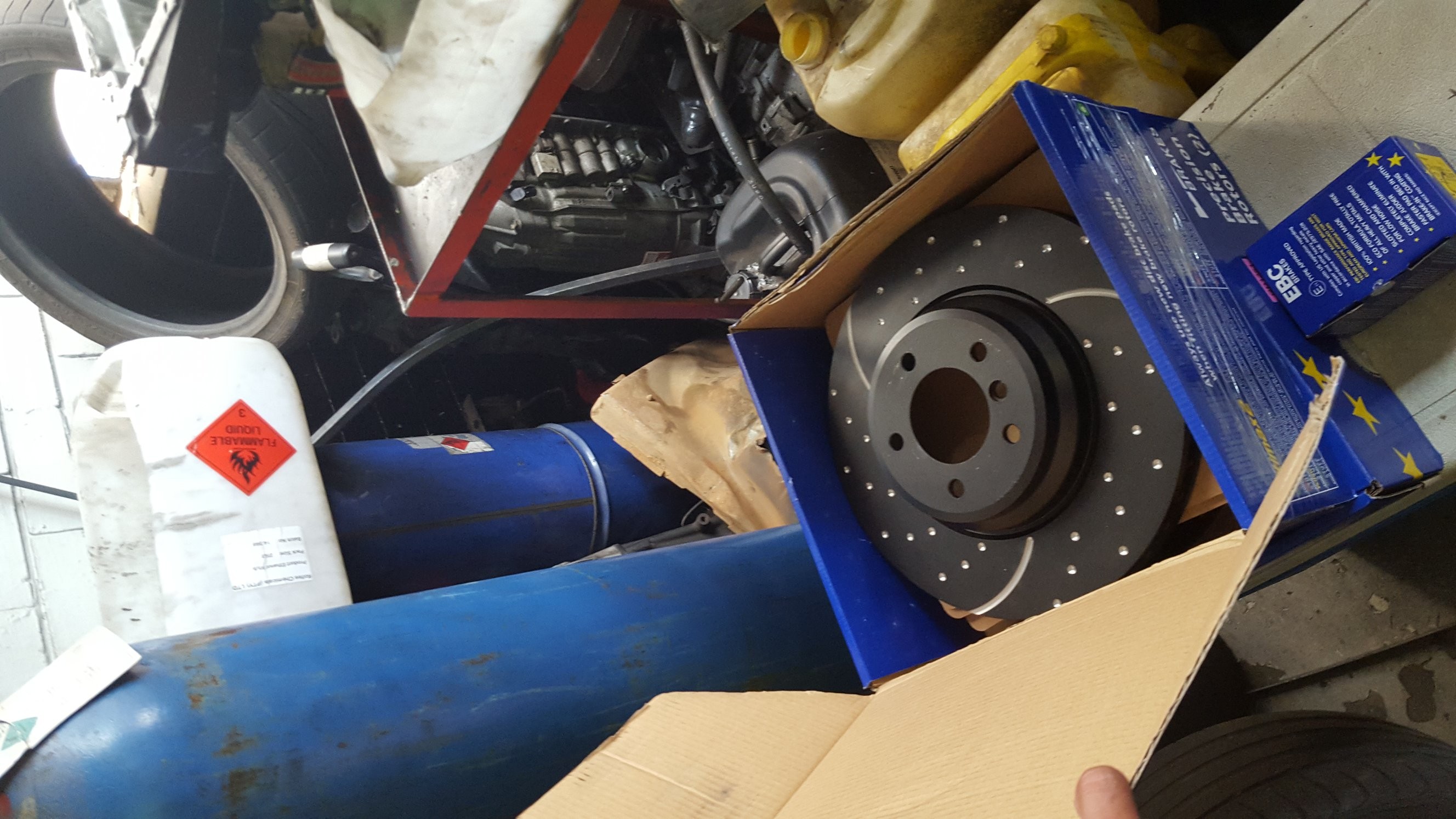

* Brake disc + pads to be replaced
* Coilover shocks to be replaced
* Radiator to be Replaced
* Oil cooler upgrade to be Added
* New set rimz - dpe 20" to be Added
* Full Paint Correction to be done over time, then Colour Change entirely of Car
- Still undecided on Colour for now
* Vargas 2+ to be reinstalled
* CPE chargepipe + bov to be Replaced
* n20 3.5 bar sensor + adapter to be Replaced
* BMS intakes to be Replaced & later upgraded to ether Injen/AFE
* Downpipes to be Replaced
* stage1 lpfp to be installed & later upgraded to Stage 2 LPFP
* JB4 + usb to be Replaced
* BMS occ to be Replaced
* BMSwater meth to be Replaced
* Intercooler Upgrade to be Replaced
* JB4 Bluetooth to be reinstalled
* Custom Backend Flash to be Installed
* Cowel filters to be Replaced
* Custom exhaust to be Replaced
* DCT Dodson clutch to be Added
* MMP port injection + BMS controller to be Added
* M3 or Quaife diff to be Added

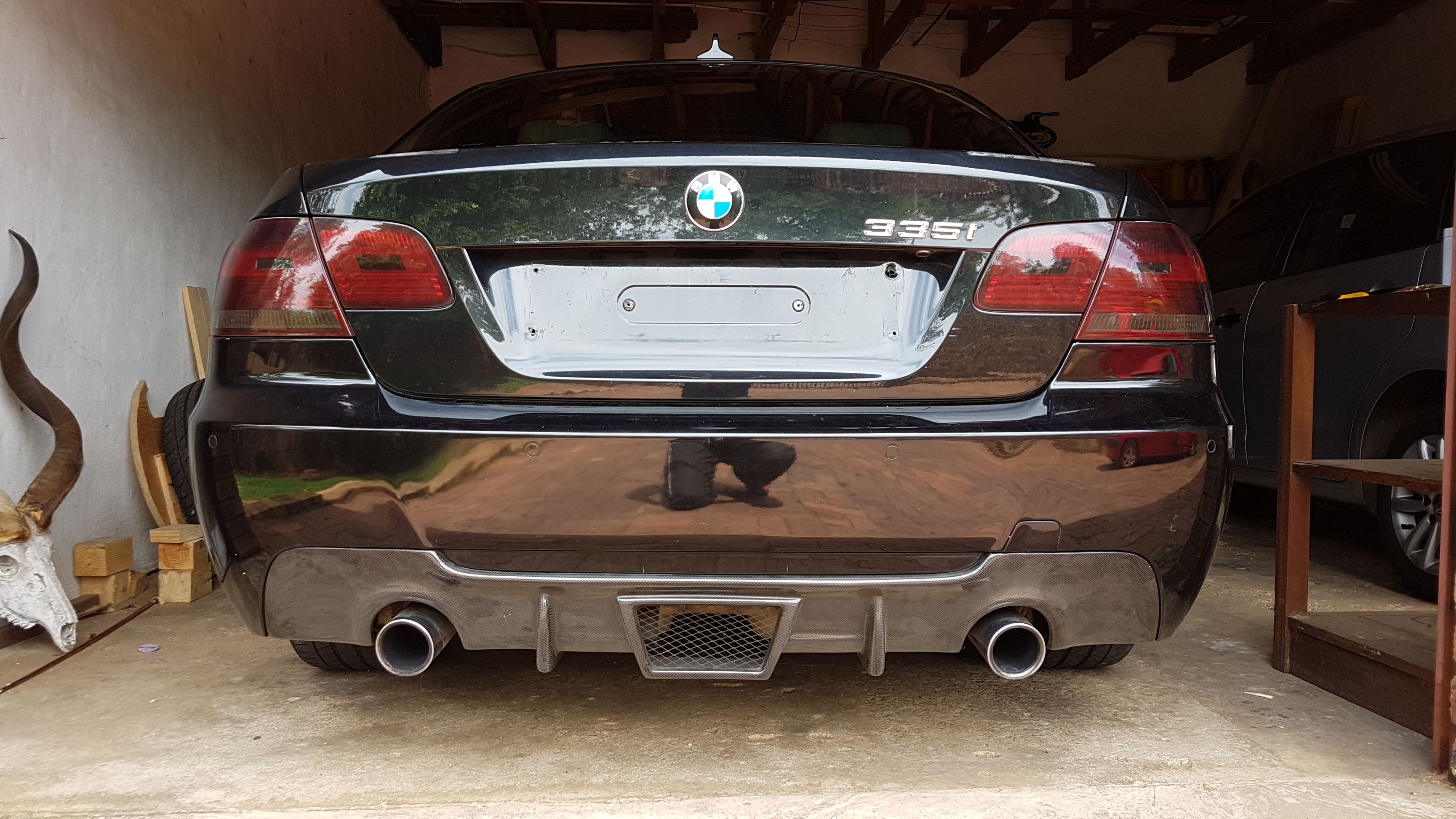

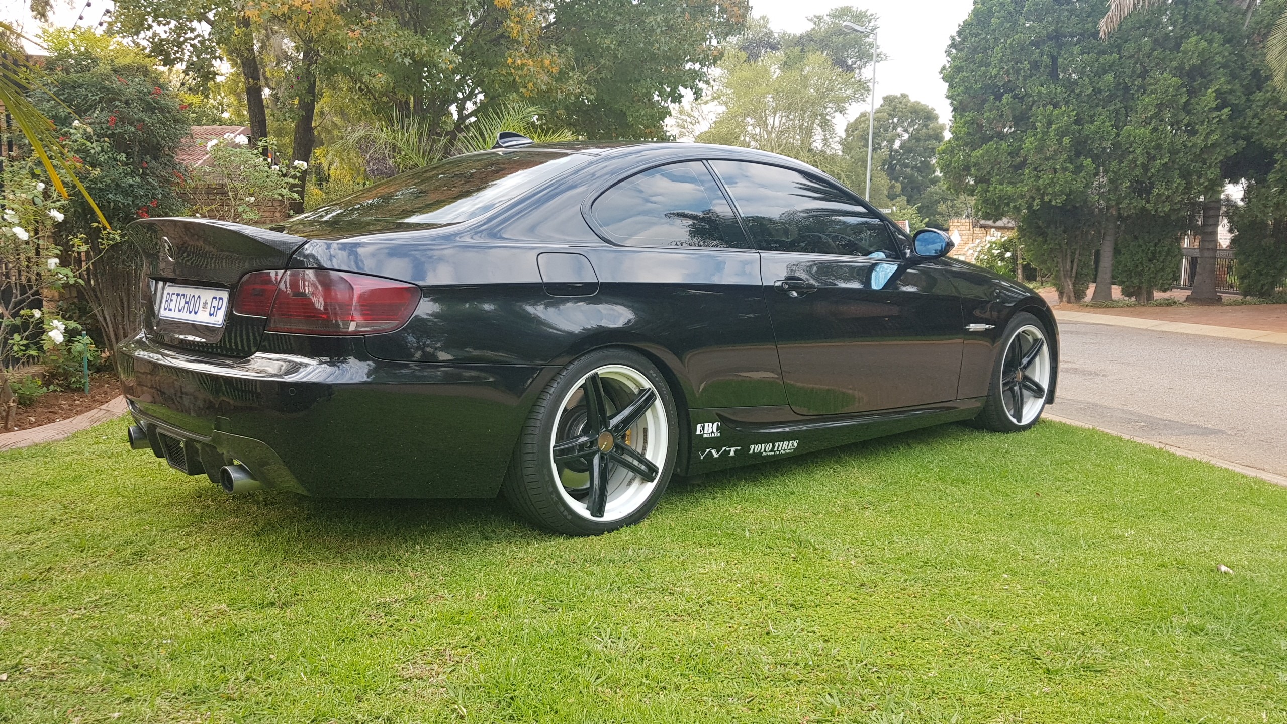

With the grace of GOD, my wife, Firi & Zaaheir/Rennzport, we managed to acquire a number of items from the to do lit.
Done -
Customs
* OEM bonnet Fitted and Aligned

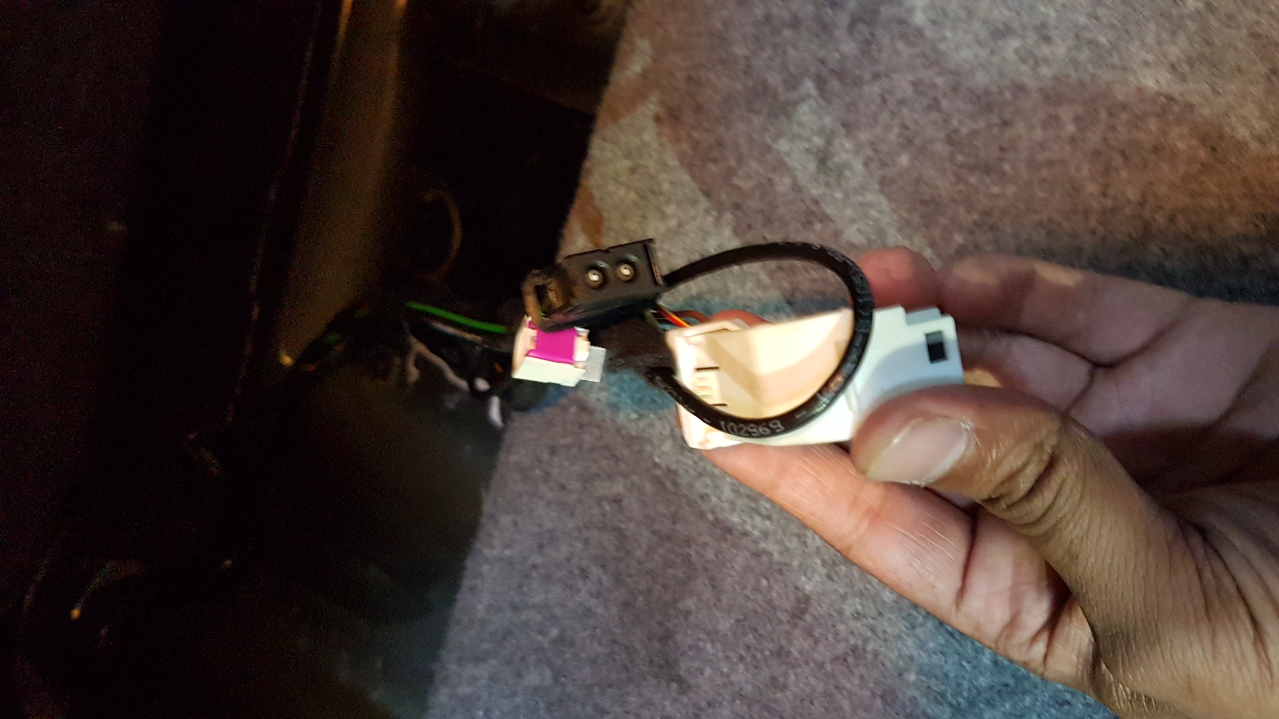

* Colour changing bluetooth angel eye Fitted
* OEM subs purchased and installed
Styling
* Carbon rear apron Installed
* Air scoops Installed
* CSL bootspolier purchased and Installed
- Supplied by CSP Motorsport

* CPE chargepipe + bov installed
- Supplied by Rennzpport

Here are some pictures of the new progress of the car
This was after car was fixed and back to running order
Wagner FMIC about to be installed
Mr Turbo Donwpipes Being Installed
Carbon Diffuser reinstalled
New Water Meth Kit Installed with Bigger Tank
Swopped my 313s with the Wife's Vosson for a different look

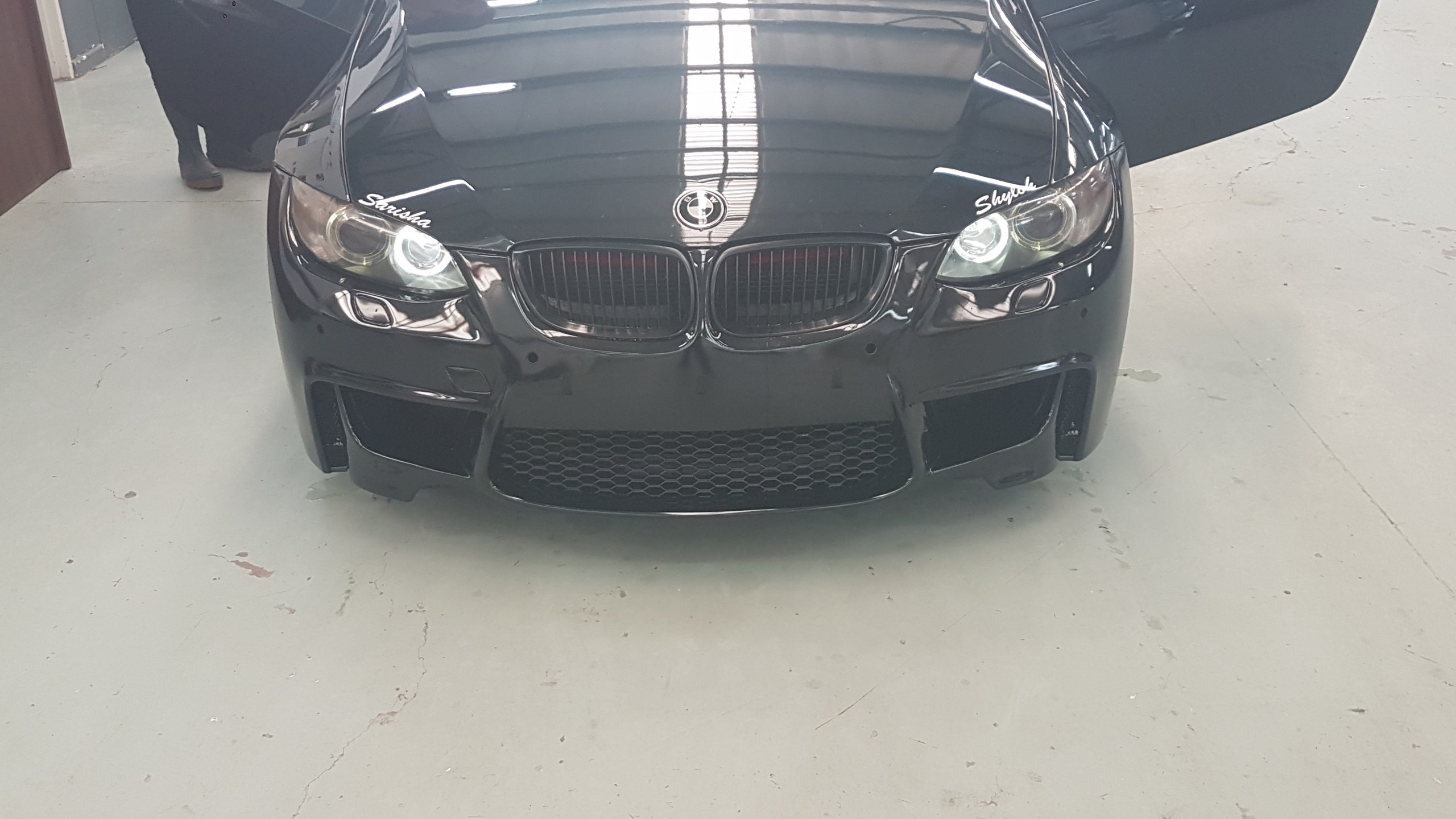

My New 1M bumper from Rennzport waiting to be installed
Air Scoops installed and prepped for Front Bumper Install

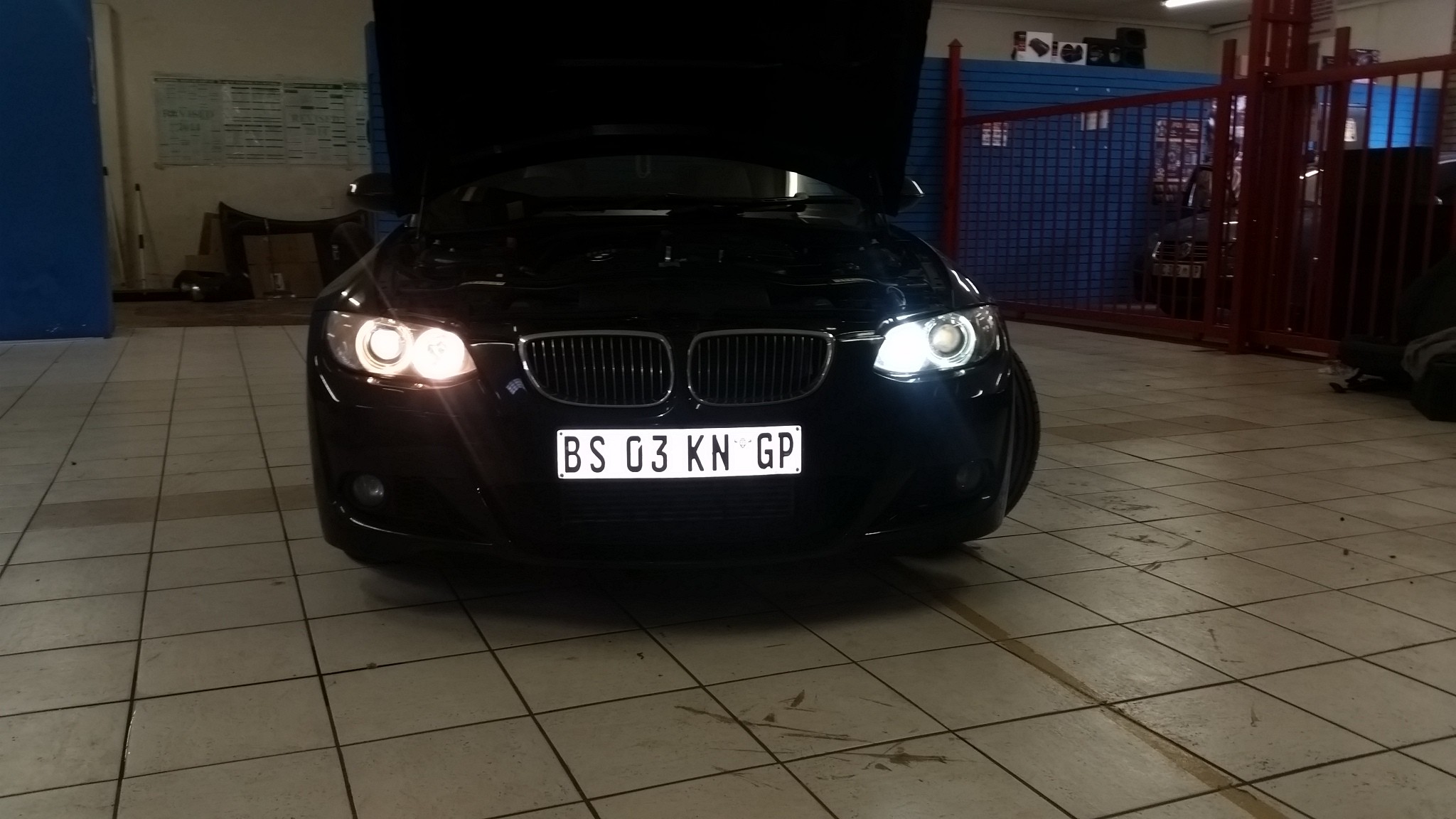

1M Bumper installed and aligned along with Angel Eyes (Colour Changing)

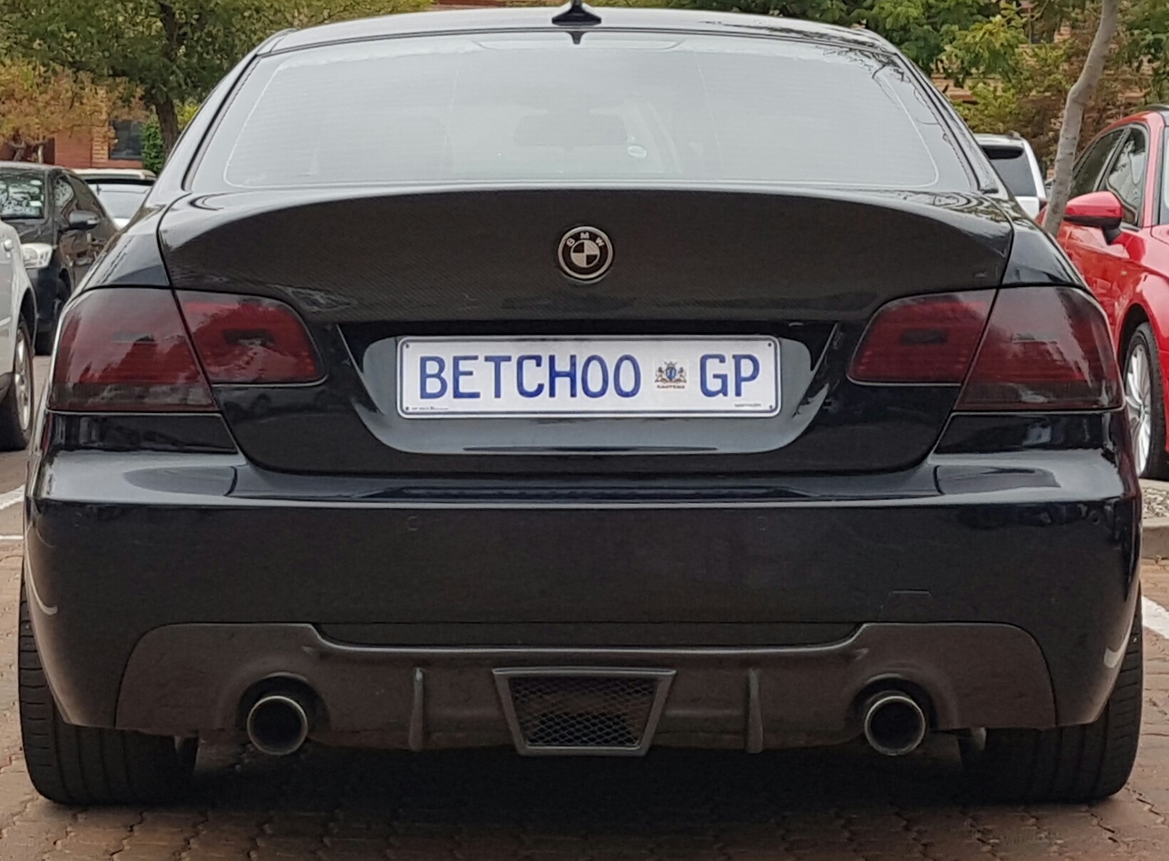

CSL Bootspoiler being installed & QA'd by the BOSS
Carbon CSL Spoiler & Rear Apron Installed

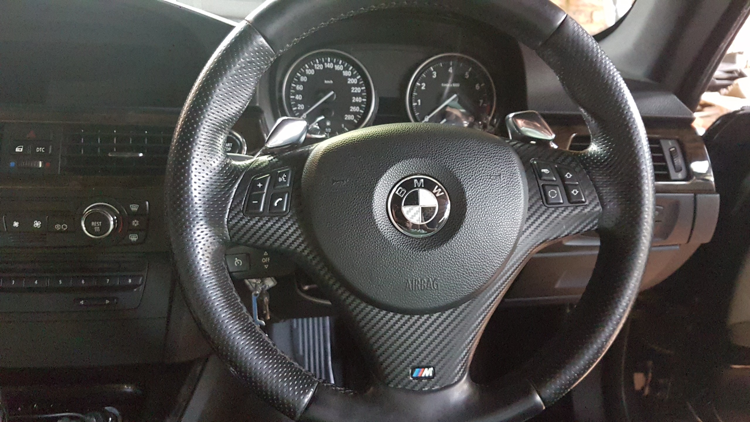

Custom Carbon Steering Done by Myself
Below Current Look and feel of Car with all done as per above write up
