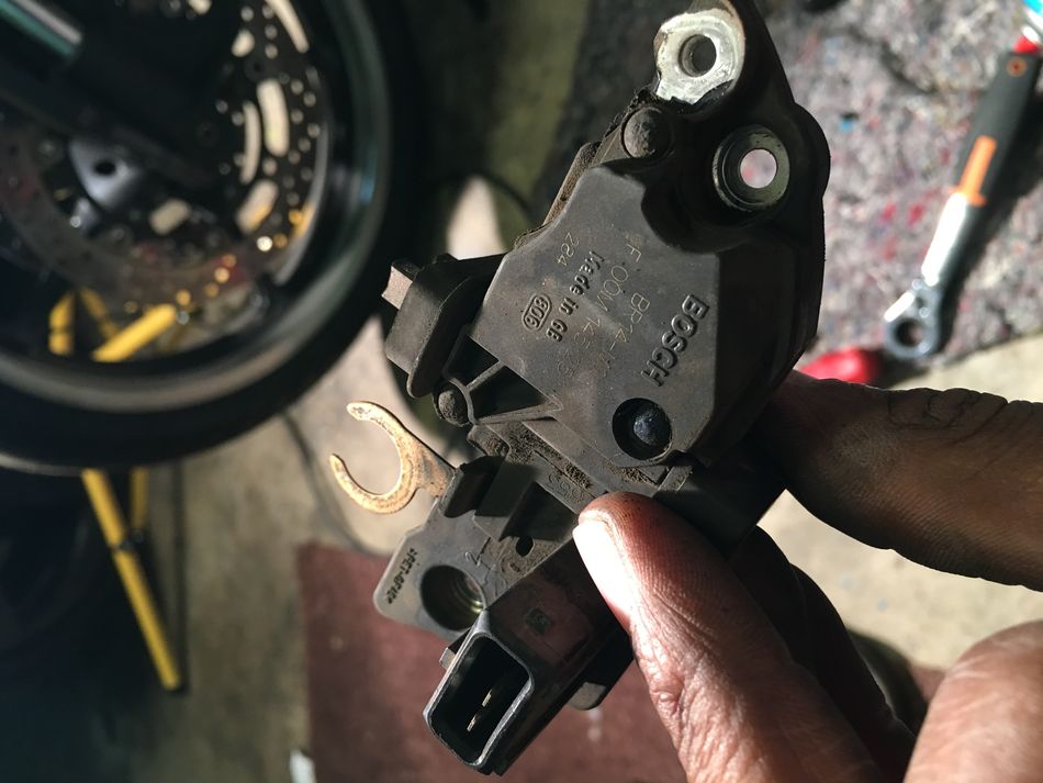

Got the alternator out yesterday, it was a quick and easy job.

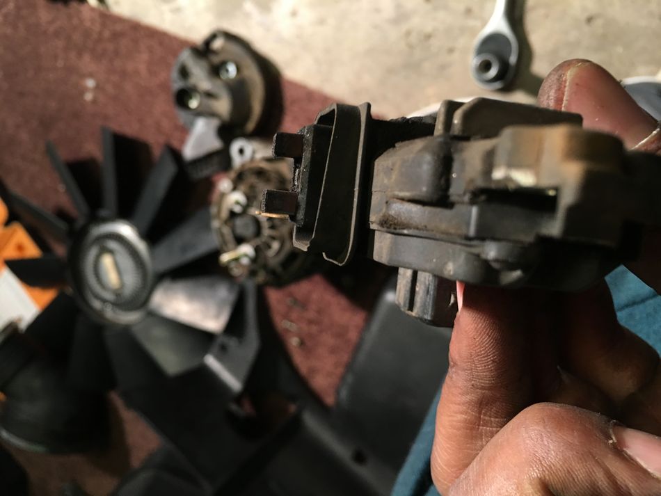

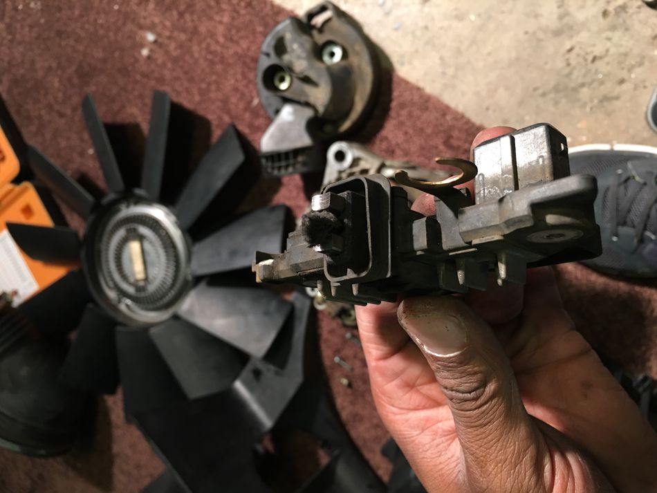

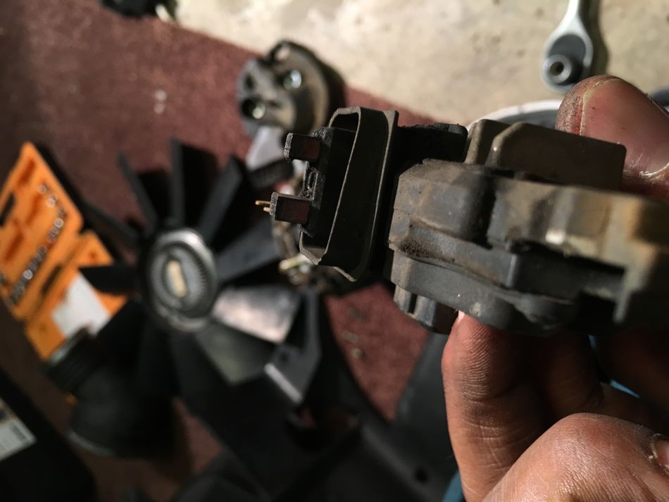

When I pulled the regulator out of the alternator, I noticed a bit of fluff on the bushes, its more like a piece of car-wash sponge.
This one is a bosch model..
The bushes don't have an even length.
Tomorrow is New regulator hunting day.

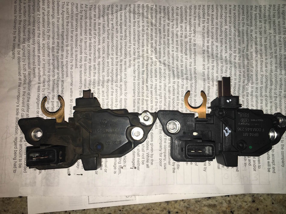

I popped over to Diesel Electric in Wynberg today and bought a replacement regulator.
Note the different size bushings
new VS old

Glad you got sorted :coolShake:

I do suspect that the piece of car wash foam on the bushes may have been the cause of the intermittency of this alternator light. Ultimately, I'm glad the regulator is replaced.
