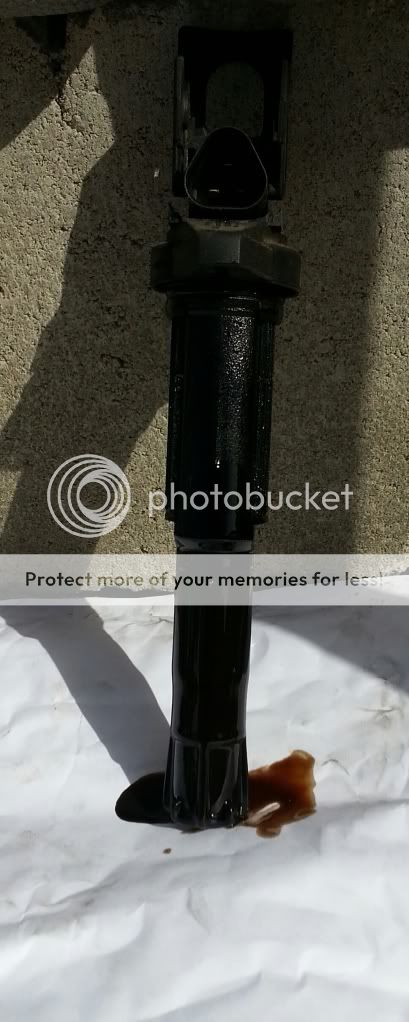

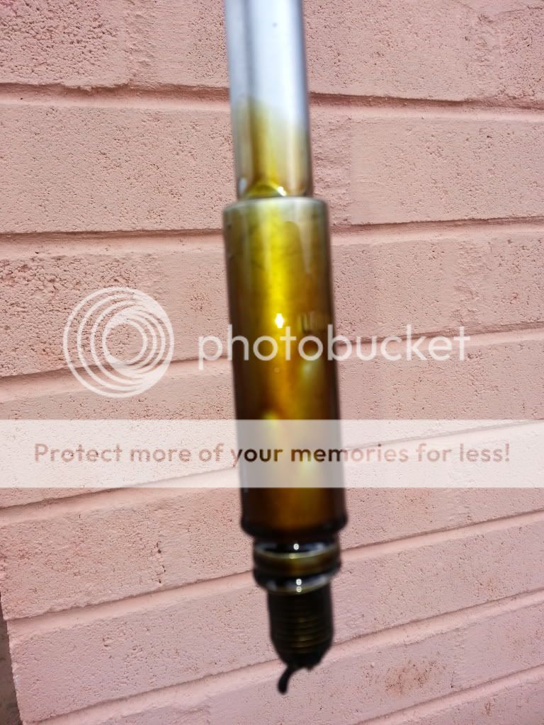

I did a service on my car over the weekend, when I changed plug 4 the chamber was filled with oil, the other 3 was fine.
What the coil looked like
After I removed the spark plug
What could cause this to happen? :

It a leaky cam cover gasket... Get it changed out. Agents wanted about 500 bucks for the e46 6 cylinder ones,dont know what the 4 cylinder ones would cost...
Die_Miek
Thanks. Are you referring the to tappet /valve cover gasket?

Pay special attention when replacing the gasket not to overtighten the valve cover. This causes the gasket to split and allow leakage. Have a look at the old one to see signs of what could cause the spillage.
There may be a ridge/dent in the cover at #4 that cause the premature gasket failure.

Tappet cover gasket was a weak point on the E46's and E39's :thumbs:

The plastic cover warps over time too so no matter how often you change out the gasket it will always leak. BTW the N42 is the worst motor BMW have ever fitted to a car, I wouldn't be surprised if BMW had outsourced the N42 from the cheapest engine manufacturer they could find who also used the cheapest materials that they could find...
