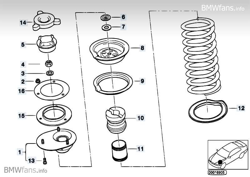

<b>Option #2: BETTER<br />
Swapped 96+ M3 upper strut mounts</b><br />
- (free if you have a 96-99 M3, or about $75 used on bf.c)<br />
- relatively easy to install<br />
- gain about -2 deg. camber (about -2.75 deg total per side 95 M3s, 96+ M3s will gain more ~3.3 deg per side)<br />
- camber not adjustable (what you get is what you get)<br />
<img src="http://img.photobucket.com/albums/v222/joenationwide/upperstrutmount.jpg" border="0" alt="" /><br />

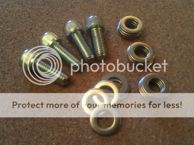

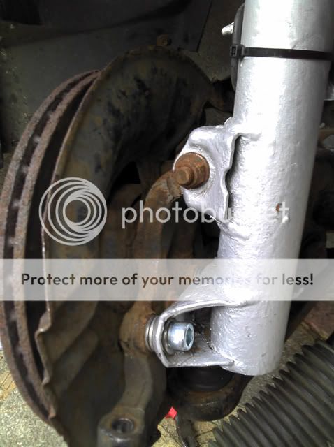

Here is Post 149
Post 149 said:
Techniques discussed for fixed front negative camber gain (non-adjustable) are:<br />
1. Installing 96+M3 upper strut mounts, Left to Right side, Right to Left side. <br />
<br />
2. Install shims on two bottom strut mounting bolts. One limitation to shimming is the length of the bolt, but replacing the bolts with longer bolts was not addressed. Another limitation to maximum shim thickness is tire clearance. <br />
<br />
Lowering the overall strut height gives a negative camber gain, and I guess you'd need to account for this somehow in planning your adjustments. <br />

</div>But since we are looking for 2.5 deg. negative camber, this shim size is is insufficient alone. <br />
<br />
I found another thread with useful shim information:<a href="http://forums.bimmerforums.com/forum/showthread.php?p=13066586#post13066586" target="_blank">Camber shims</a><br />
<br />
<div style="margin:20px; margin-top:5px; ">
<div style="margin-bottom:5px" class="smallfont">Quote:</div>
<table cellpadding="6" cellspacing="0" border="0" width="100%">
<tr>
<td class="alt2" style="border:1px inset">
<div class="smallfont">
Originally Posted by <strong>mariogto1968</strong>
<a href="showthread.php?p=13065880#post13065880" rel="nofollow"><img class="inlineimg" src="http://images.bimmerforums.com/vb3images/buttons/viewpost.gif" border="0" alt="View Post" /></a>
</div>
<div style="font-style:italic; font-size: 11px;" >Hello, I have been running camber washers purchased from Kormans for 9 years. With 5mm (0.19&quot;) shims i get 2.8 neg. camber with car empty. With car weighted 3.1 neg. I just did a track alignment and added 1 more mm. total 6mm (0.23&quot;) giving it 3.3 neg on both front with my weight and instructors weight in car with 1/2 tank of fuel. This works out fine with 0 toe, no uneven tire wear. If tracking car set toe to 0 or very small amount of toe out. After tracking car we remove shims and toe goes to a slight toe in which is fine for the street. I have a 1995 M3 with M3 lightweight springs. car sits about a 1/3 lower than stock ride height. I have 1.7 neg camber WITHOUT shims, so 6mm in shims ads in about 1 1/2 degrees neg. camber. Check the clearance on your wheel and tire inside to your strut. I do not have any rubbing problems BUT 6mm. is the max. i can run without clearance problems. I am running 235/40/17 on BBS 17by 8 wheels all around with 38 offset. YOU MUST USE LONGER BOLTS WHEN USING SHIMS. MINE CAME WITH WASHER KIT FROM KORMANS. Hope that helps you out, Tony</div>
</td>
</tr>
</table>
</div>Tony brings up wheel offset and diameter, which makes a difference regarding shims and their effect on strut/wheel clearance. <br />
<br />
Using your own parts seems easy enough. Looking around, the Bimmerworld shim kit gives 0.21&quot; (5.33mm) maximum shim using the entire kit. They do supply longer bolts. Their shims are aluminum where I would prefer hardened steel. The Korman kit P/N 31062036 is hardened washers and longer bolts, which sounds like a simple hardware store approach. <br />
<br />

My questions: <br />
A. By using longer bolts and 5mm (0.19&quot;) washers, do you get enough negative camber without involving changing the upper strut mounts on a 1995 M3?<br />
I don't want to buy someone's used upper strut mounts and disassemble my struts entirely if I can avoid it. <br />
B. Does anyone know the bolt specs required? (Grade 8) I can pull one and bring it in, but if someone knows, feel free to share.</div>

you can get more camber out of the front of the e36 with the shims if you fit wheel spacers on the wheels...
this is what it looks like:
you need to use 12.9 grade bolts and dont worry about it stressing something people have been using this forever without any negitive effects
an idea of how much chamber you can get on a slightly lowered car...
1 shim gave 2.5 degrees
2 shims gave 3.5 degrees
3 shims gave 4.5 degrees
i dont know what size the shims and bolts are...

Dont. Get 10.9 Grade bolts and hardened washers from a hardware store such as http://www.mrboltandnut.co.za/
The kits that places sell arnt even as strong as that and it will save you the shipping.
You do not want more that -2.5 on the street if you like your tires.
M12 bolts, 20mm or 25mm depending on how many washers you are using.
moranor@axis
2.5 is a good camber for a road car... the write up says you can only get 1* extra with shims and bolts, but you can get alot more with spacers if you want and you will probably want to space the wheels out a bit anyway because the top of them with me more inset with the new camber...
gconry18

calypso
Just remember, if you gonna be in the strut towers, its probably worthwhile that you install the strut tower reinforcement plates. Towers front and back are weak spots on these cars. Especially the rear ones.
Part 15 - I think they were about R100 each from the dealer
Part number: 31 31 2 489 795
