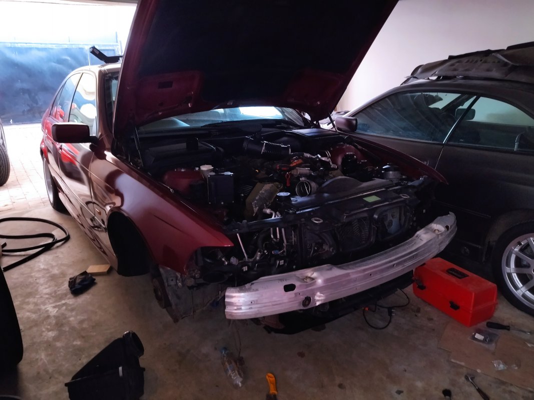

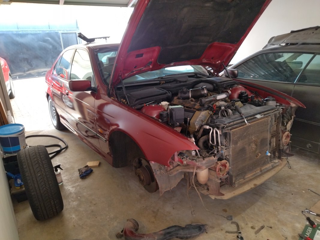

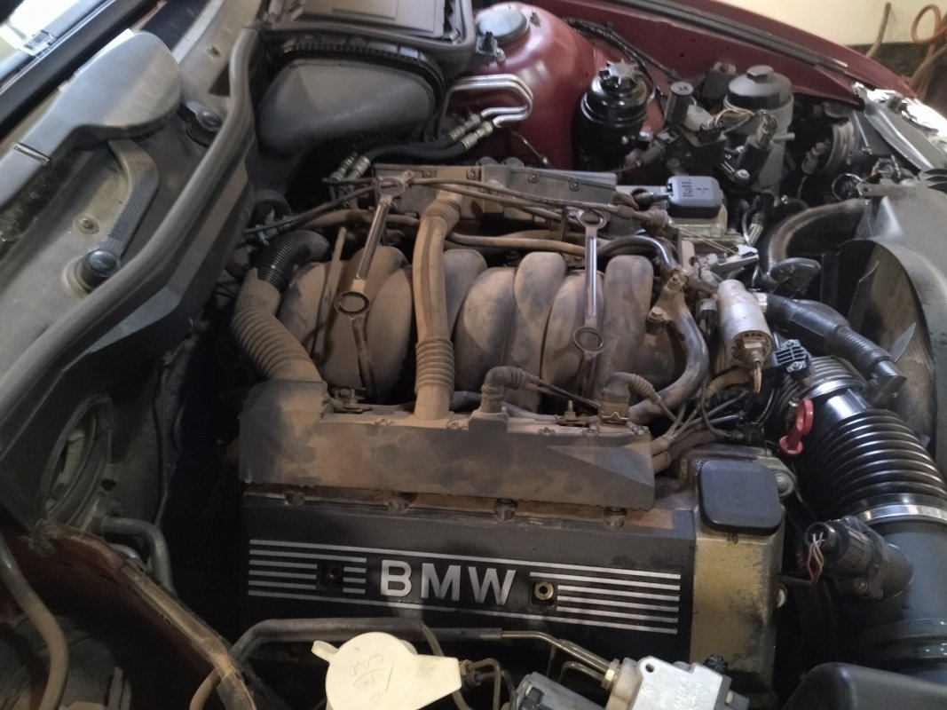

I am really impressed with the refinement and feeling of invincibility this car gives, notwithstanding the tired suspension etc... As I brought it home, a relatively well looked after 200k car in old man spec - my favorite! Car seemed to have been recently neglected which as you know, is the best kind of neglect. Issues include but are not limited to - difficulty in selecting gears, occasional misfire, death wobble, missing front spoiler, and the whole front had been poorly repainted but I could not find any signs of an accident. It seems the fan clutch failed which led to a fan explosion and much carnage. Said carnage was very poorly repaired. First order of business then was to sort that out and in typical fashion, get carried away and spend too much money while at it. Because that is the correct way of doing things.
An example of the carnage that was fixed with some silicone and an ice cream tub to seal a hole in the MAF?? How was this car even running?
Before:
After:
Yes, I did take it too far, but it is good to be thorough. At least, that's what she said.

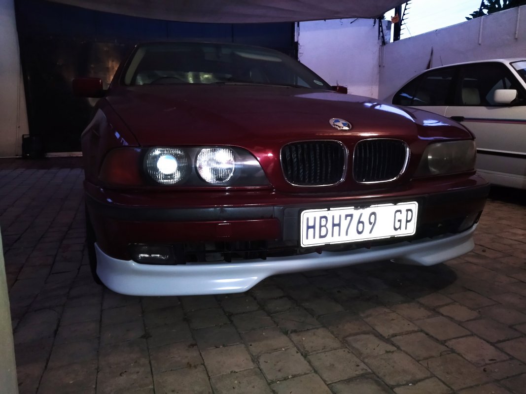

I procured a OEM spoiler at a rather heinous price, even after the ABM discount. Will paint once the bank account recovers.

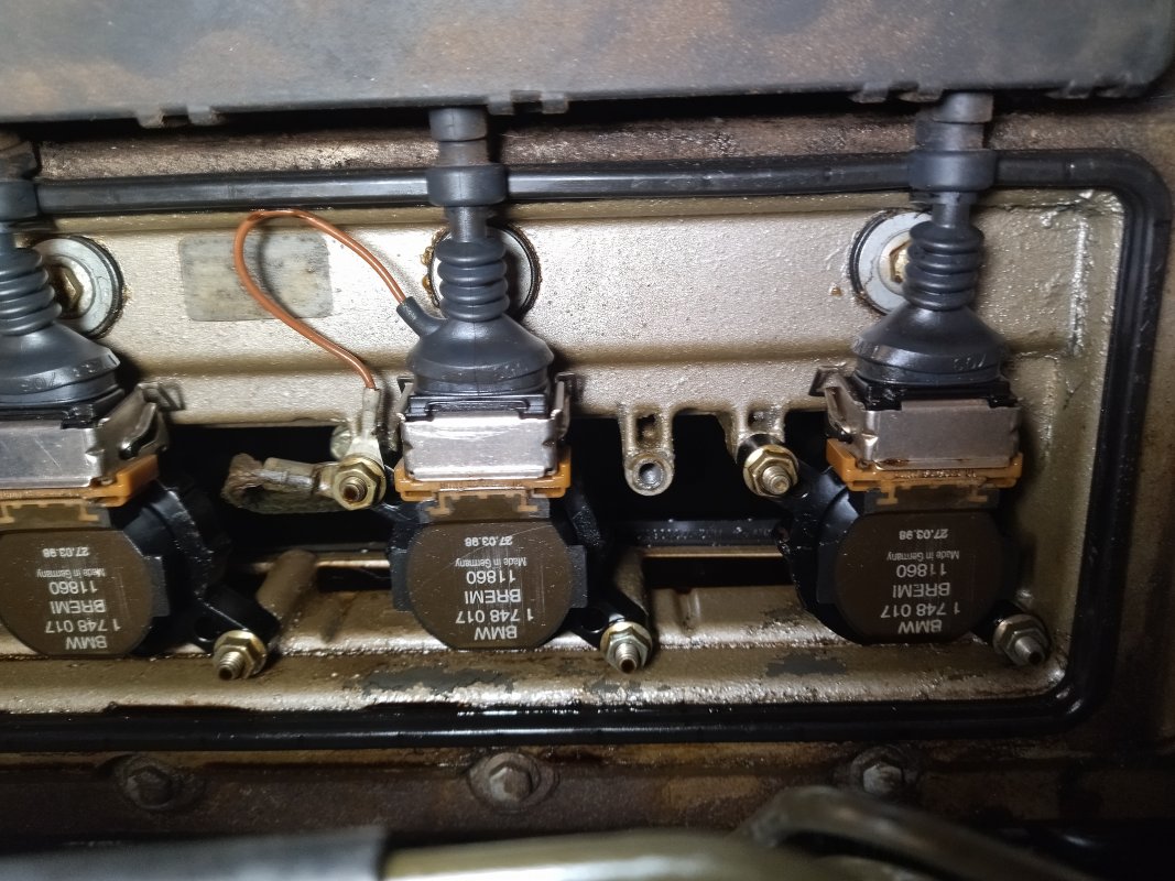

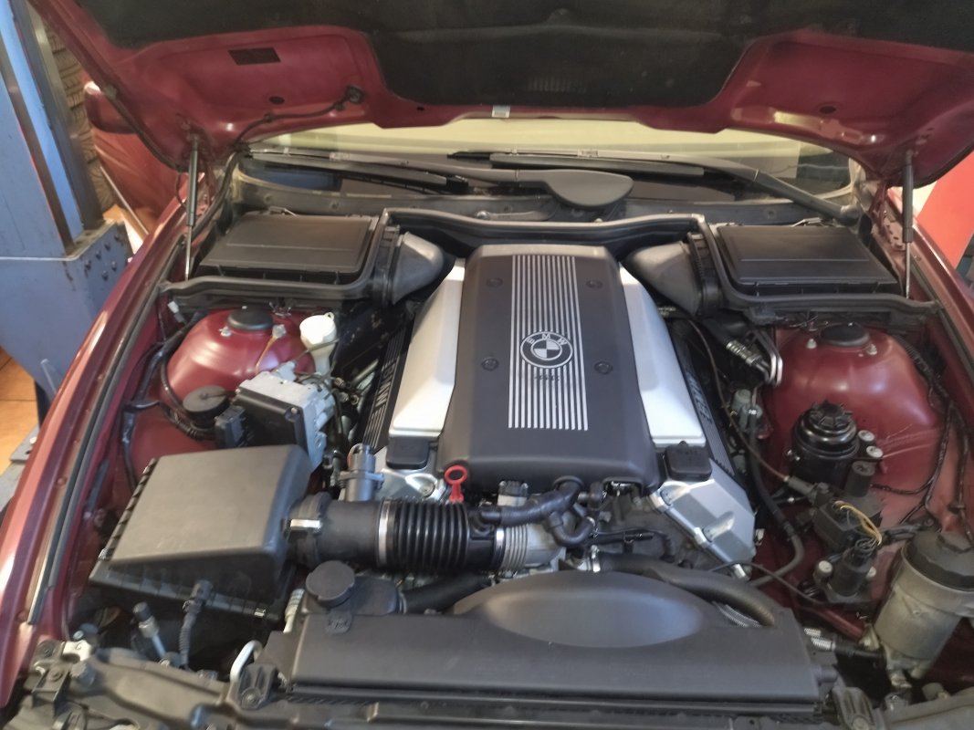

Now to do some general maintenance and sort out that misfiring which I suspected was due to leaking valve covers.
If only my wife was this dirty:

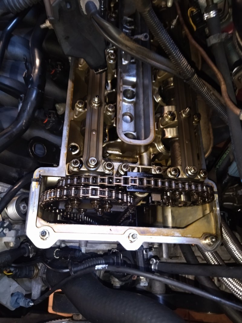

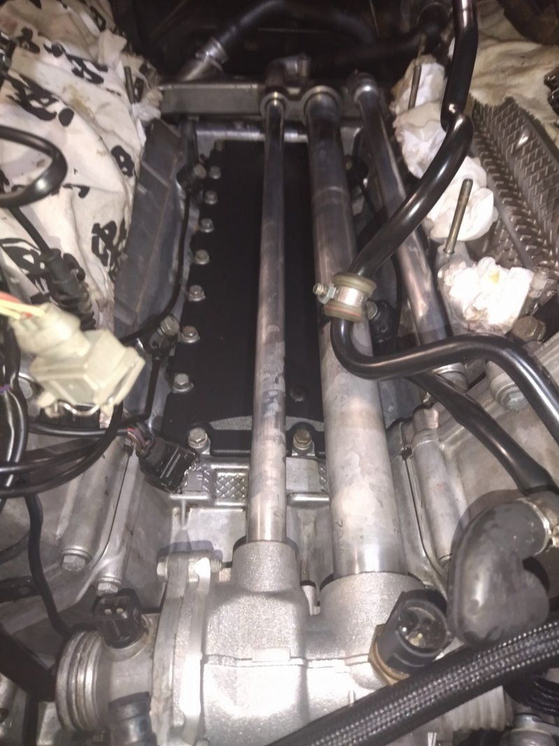

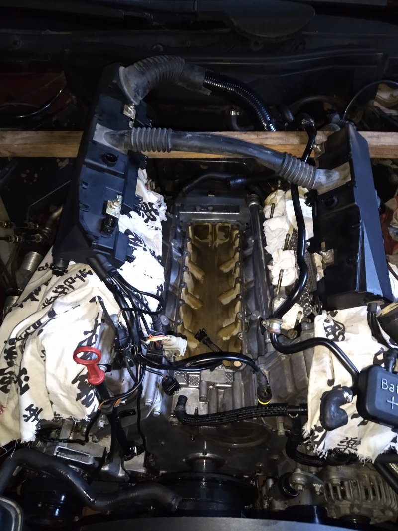

Looks like the previous owner kept the spark plug fluid topped up (y) That was about 250ml of oil removed from just the one head :rolleyes: Again, how was this car even running? I dare say we found the cause of the misfire... Otherwise there is very little varnish inside the motor and no broken timing chain guides from what I can see from the top of the motor :cool: now we can all breathe a collective sigh of relief...or maybe we should hold that breath for when I open up the sump...🧐

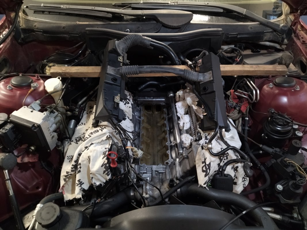

Seems I got carried away again. Figured while I was in there, I may as well do the valley pan gaskets and those silly coolant cross over pipes with new CCV and inlet manifold gaskets etc. Pity the wallet.

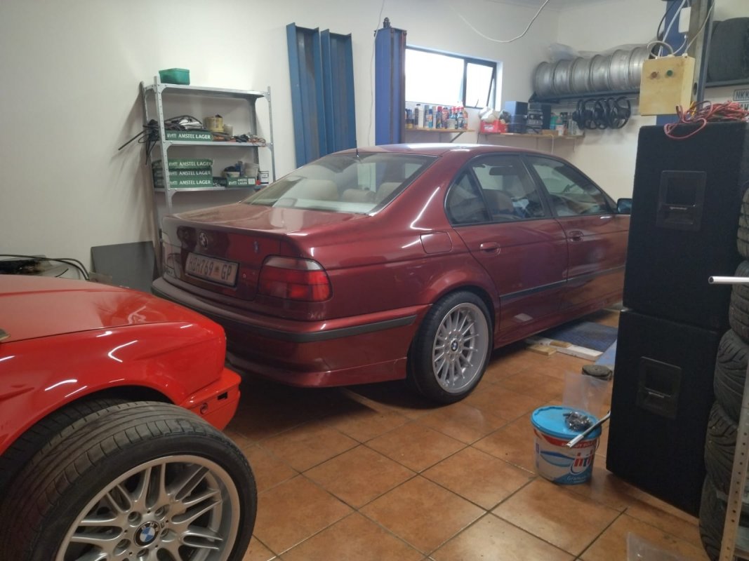

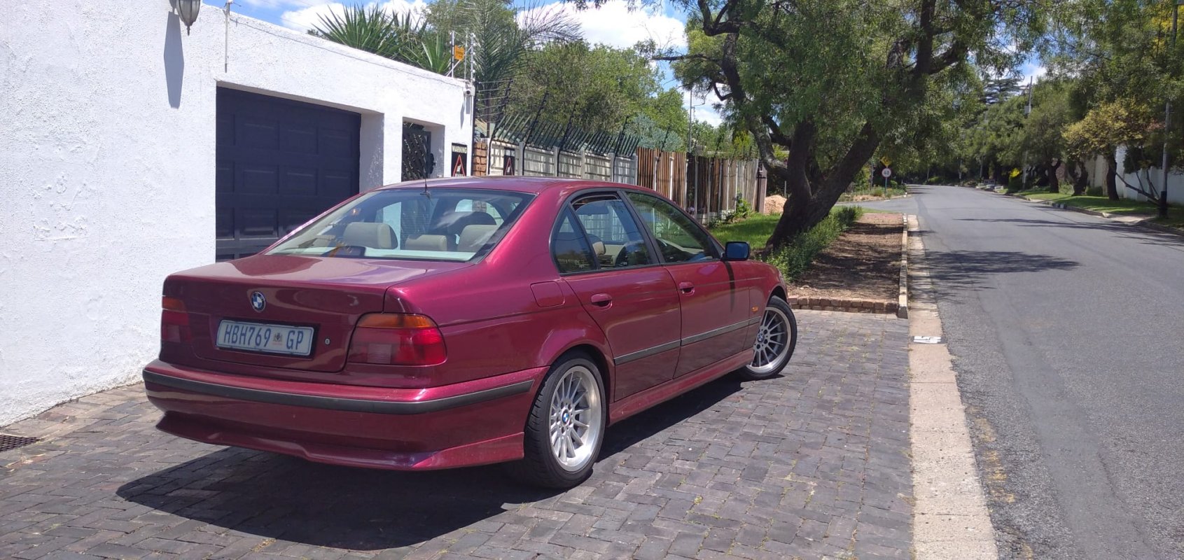

Anyway, it is all forgiven with a gratuitous pic of that rear end. It really is a good looking rear, no?

Yeah its the aero package bumpers that came on all the early 540 manuals. I think it is a much more unique look compared to the later M-sport/M5 bumpers

Finally got the car running after finding myself a little further in the bowels of the engine than intended.
Decided the water pump was just too exposed at this point to leave it alone, so in went a OE Saleri pump. Glad I did this as the old pump bearings didnt feel too good.
And all back together

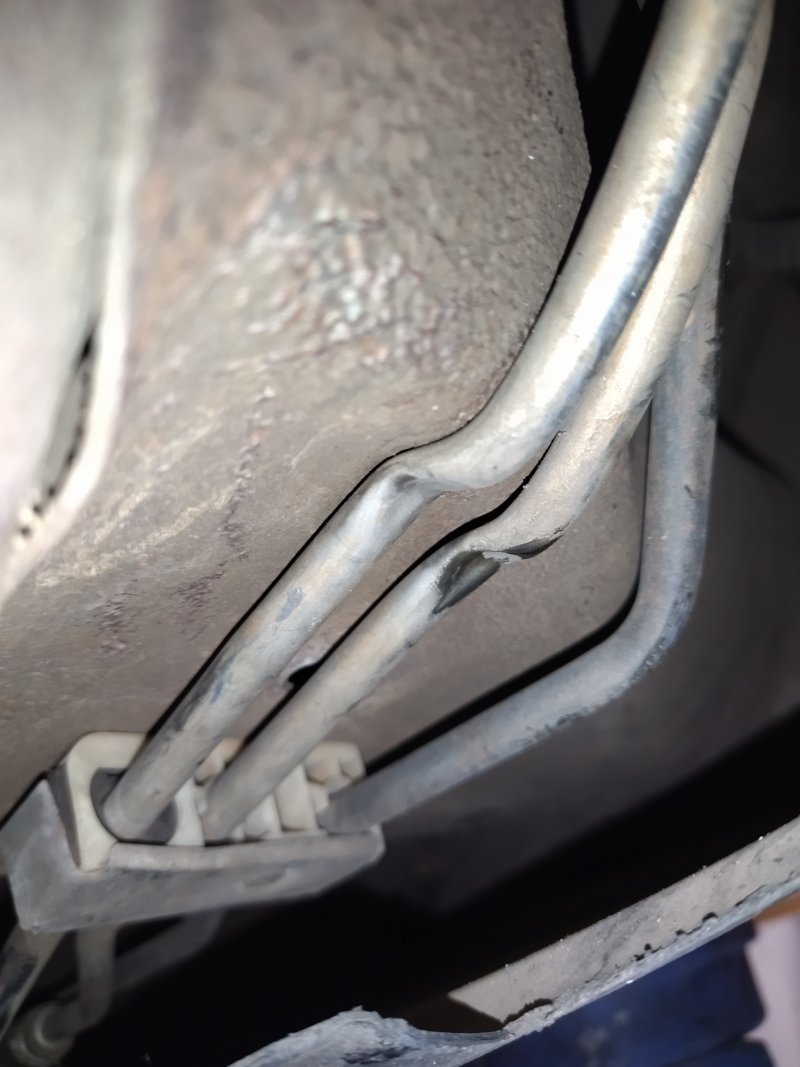

Found some very squashed fuel lines from a misguided offroad excursion. Again, how was this car running?
Pipes replaced, filters changed and car started up beautifully! Much to my dismay, the misfire is still there! 😖 😖 so I've ordered a INPA cable and will do a diagnostic, its probably an ignition coil or 2 as mine look like the originals from factory. Still need to replace the thermostat, awaiting delivery from BMW on a 95C thermo which opens 10C earlier than the stock one.

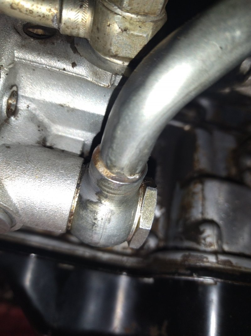

Much to my utter surprise, the only oil leaks from this car was from a powersteering line gasket and the oil level sensor. Got the PS line sorted, will do the oil level O-ring when I open up the sump. It feels weird to have such an easy fix to oil leaks on a 24 year old BMW. Touch wood maybe?

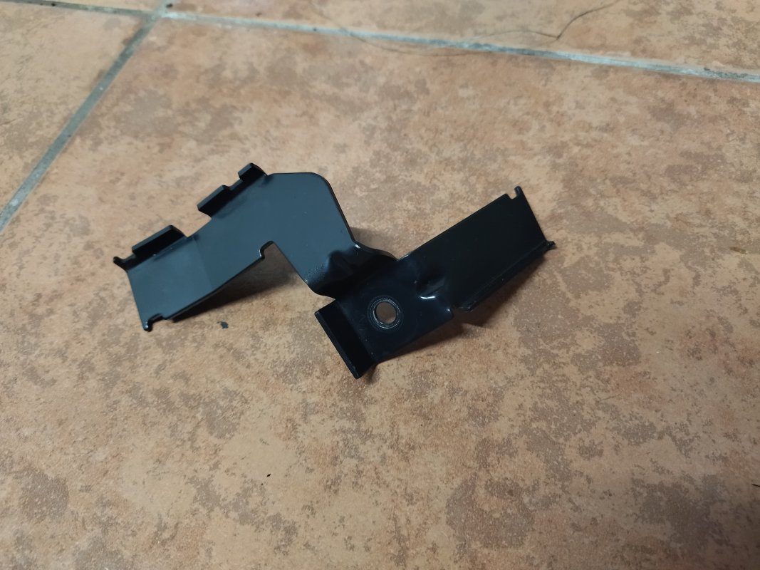

Oh, does anyone know where this bracket goes? I somehow have it left over...Im sure it goes on the passenger side of the engine to support the wiring loom, but cant for the life of me figure out where. Its making me feel quite stupid...

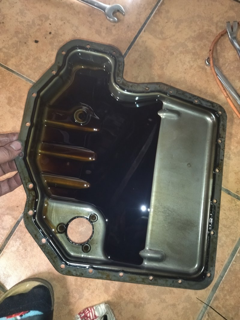

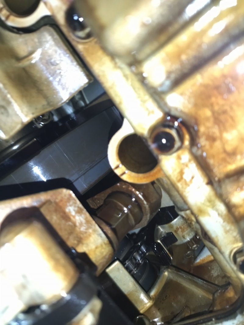

So for those who are sadistically following my escapades with this car; you can sigh your breath of relief. No plastic bits in the oil sump! This is good news indeed

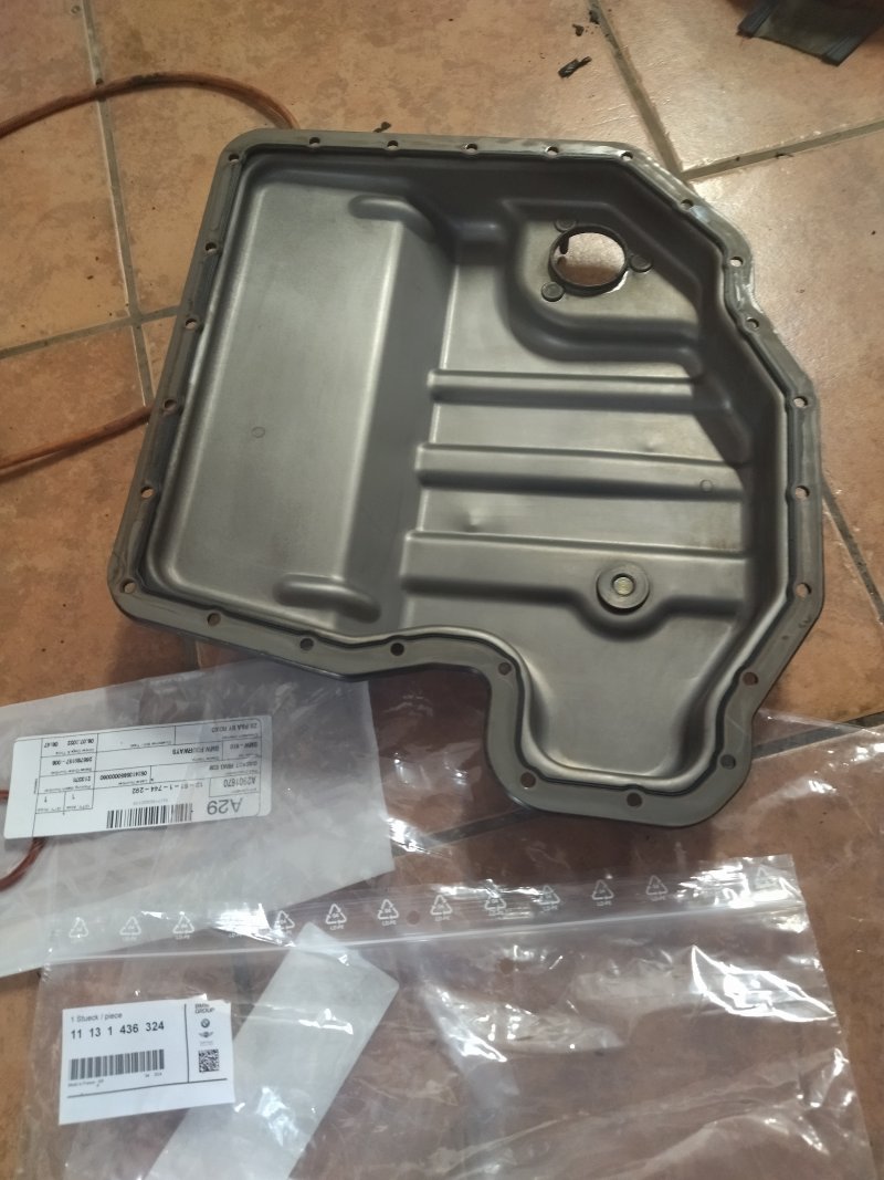

And there it is, a timing chain guide, resplendent in its intended position on the tensioner, not lounging about in the sump. Very good. Also not too much varnish, no sludge in the sump and no signs of previous entry - i.e, no gasket sealer on the sump gasket. These are all good things

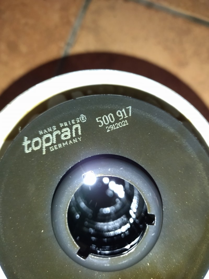

To my surprise, the oil filter had been changed after 29.12.2021...so the car has done about 500km on this oil (y) no funny business in the oil filter either.
Shiny sump ready to go back in, obligatory new gaskets/seals.

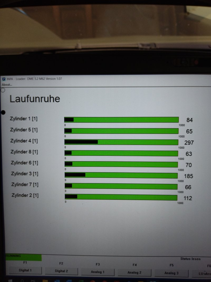

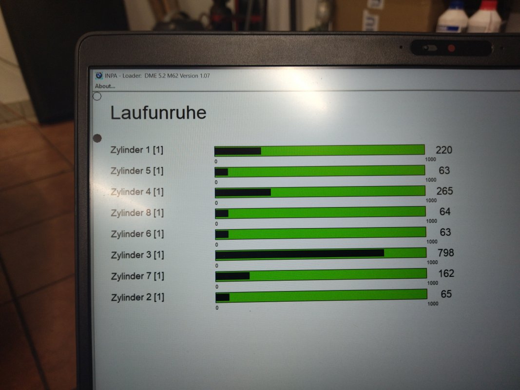

Time for some diagnostics, luckily I have a passing understanding of German. I swapped the ignition coil from cylinder 4 to cylinder 3, looks like my non-smooth-running cylinder followed the coil, so we have our culprit. Some more parts to order, hoping my tax return clears soon :rolleyes:
Before:
After swapping coil:
I suspect I have a vacuum leak on cyl 3&4 since they share a gasket and both have high readings...also I do hear a bit of a hissing noise from that side of the inlet manifold. Anyone have a smoke machine they recommend to test for vacuum leaks?

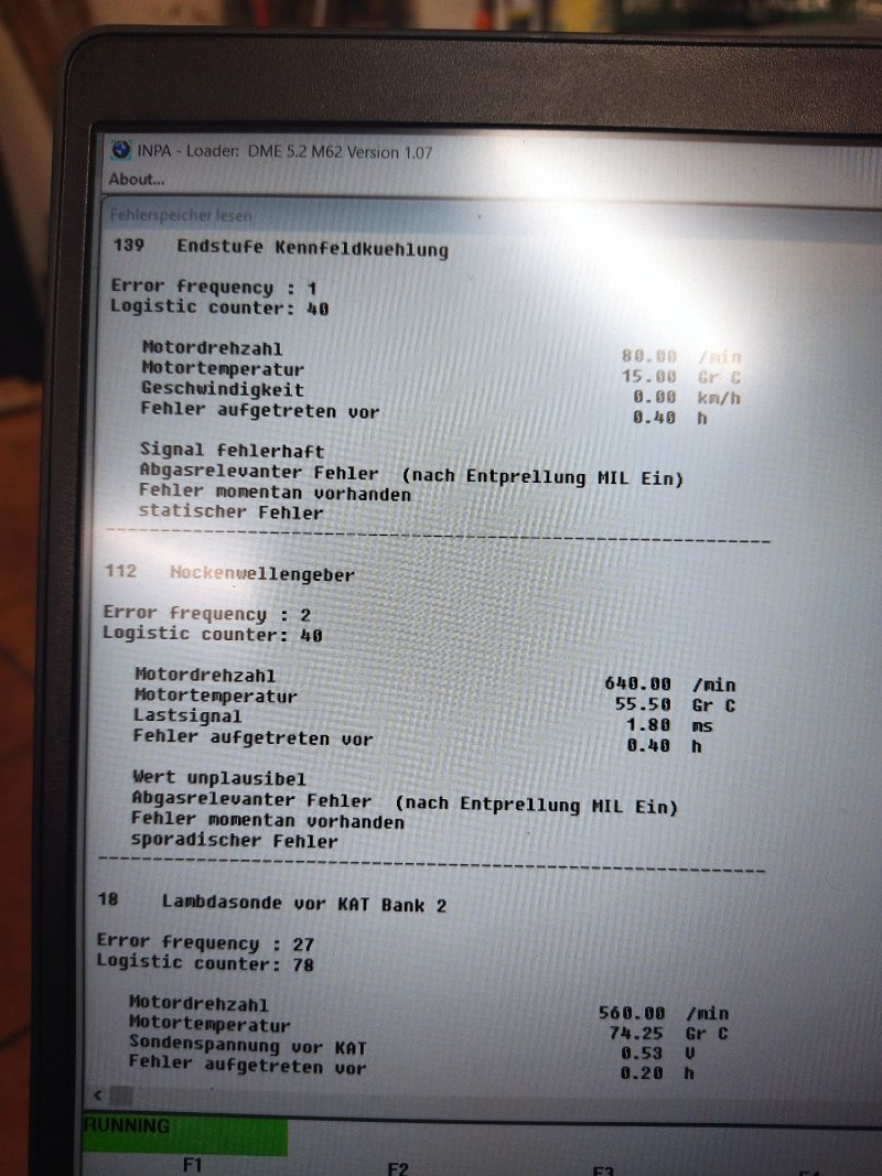

Next lady for a shave is the engine always dying when its started from warm. Generally at a fuel station, starts up, runs for 2sec, then dies. You then need to ref it like you is from Benoni to keep it running. Very embarrassing for such a distinguished machine. Pulled codes, I am suspecting camshaft position sensor, however, it does not throw an error when the engine is warm (note engine temp on diagnostic). it does have very frequent Lambda errors, not sure if I should be worried about this? Car only has pre-cat sensors and has been decatted somewhere in its life

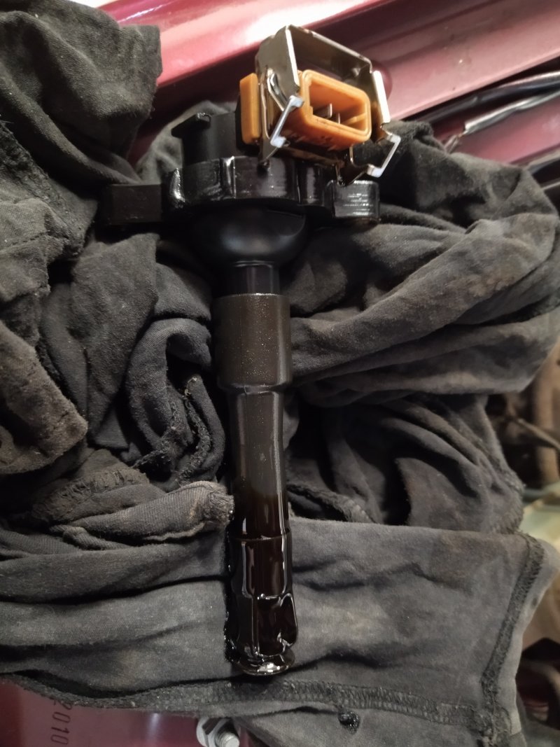

Small update. I procured some ignition coils which fixed the high smoothness value on cyl 3. Result! Took the car for a drive, it still misfires 😩 checked on INPA, cyl 1 was running very rough, tried swapping coils, spark plugs but misfire stayed on 1. Swapped injectors over and the misfire moved with the injector. Stole an injector from the E34 and it seems to be running good...for now :rolleyes: Why the injector would choose this moment to die after I had fixed the ignition coil is quite baffling

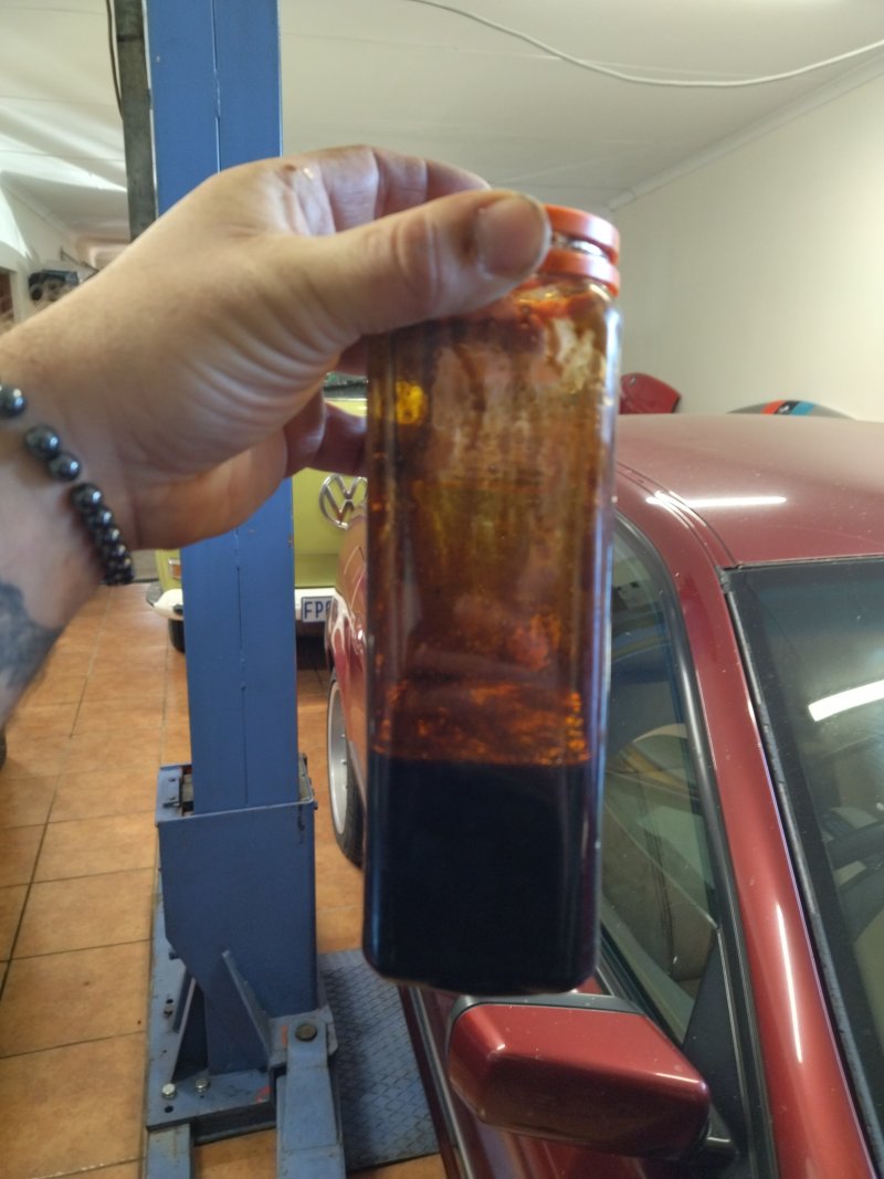

So I found some glitter in my oil :confused: M62 life FTW. FML. 🤦‍♂️ So timing chain kit is ordered with all the "while you're in there" bits ordered. Except for the bits I've forgotten to order, obviously.

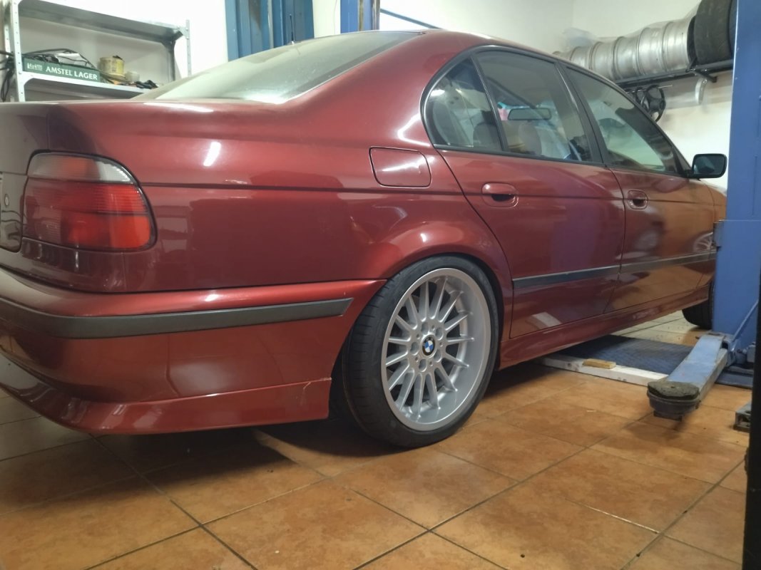

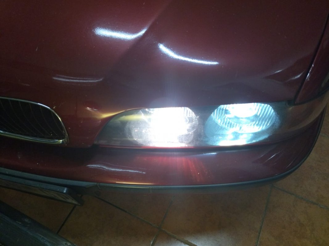

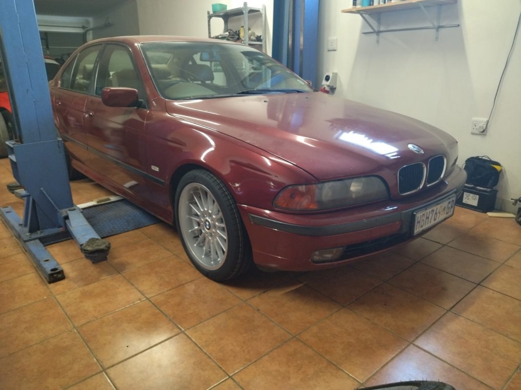

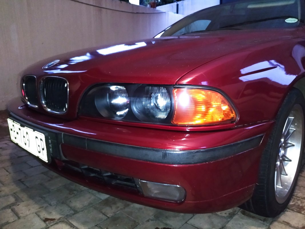

In the meanwhile, I've found a set of pre-facelift clear indicator rear lights, OEM xenons and one front light with the clear indicator...the search continues 🧐 Also a very rare set of Style 32s in 18" are on the car, not entirely convinced at this point. Will have to get the car running and see what it looks like out in the wild and with the spoilers all present and correct. I chose these wheels are they are an "OEM+" style upgrade
Ooooh, how good does it look when dropped?? The wheel to tyre clearance is about as tight as a fleas arse. But clearance is clearance...
