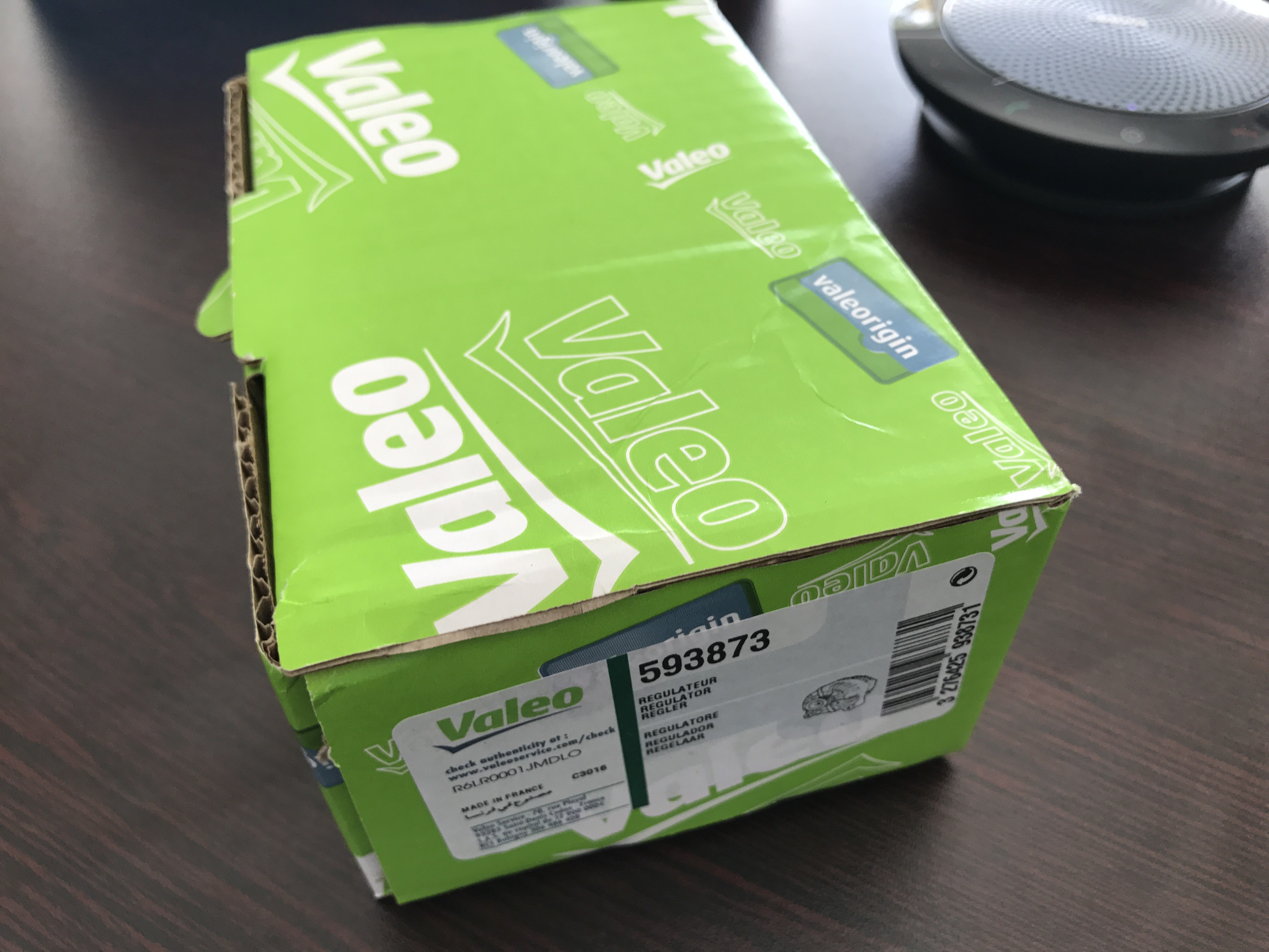

Hi guys,
Just my quick 5c on this thread. I suffered the exact same problem.
1. Took her to BMW. BMW said alternator was stuffed. And quoted R12,922.27 ex VAT and ex labour for a new alternator.
2. Phoned around and found several auto electricians that said they could refurb for R2-3k.
3. Ended up going to a 'recommended' auto elec of those contacted.
4. Auto elec refurbished the alternator for R2.5k.
5. Car still suffered the warning light issue.
6. Did lots of Googling, forum searches, etc.
7. Seeing as the battery was the original from new - and auto elec said that it may be because of problems with the battery - had the battery tested.
8. Battery was low on charge, but still 'healthy' according to battery centre and Lombards.
9. Decided to buy a new battery anyway. (R1.6k)
10. For a breakfast run the day after, I had no issues - so thought problem was solved!
11. Next day the warning lights were back....
12. Did lots of more googling and forum searches again...
13. Decided it was the regulator.
14. Tried to convince the auto electrician that it was the regulator.
15. He then tried to replace the regulator with a number of locally available options (as it was under warranty :) ) to no avail. Finally to find out that what was needed was a specific brand/part i.e Valeo!
16. Ordered the Valeo from eBay in the US (+/- R1.2k including expedited delivery)
17. Part arrived last week and was installed Saturday morning.
18. No more warning lights! :)
In summary, there appear to be 2 main types of alternators in our cars. The Bosch version and the Valeo version. It is important to understand which version - which determines which regulator to get.
According to the forums, some guys are lucky and the problem is just the battery, or a loose battery connection (either the battery connection or the little battery connector next to the battery). Others are the alternator and/or regulator.
Just thought I would share - in case any of you find this useful...
Regards,
Pete
