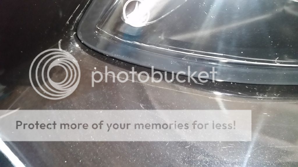

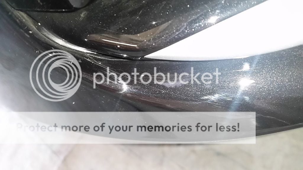

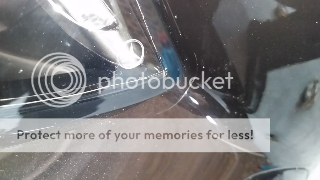

Over stretching of film leaves "waves" in the adhesive and causes distortions and breaking of the adhesive:
It is also much easier for this to happen with the cheaper material as we had been informed what film was applied to these vehicles.

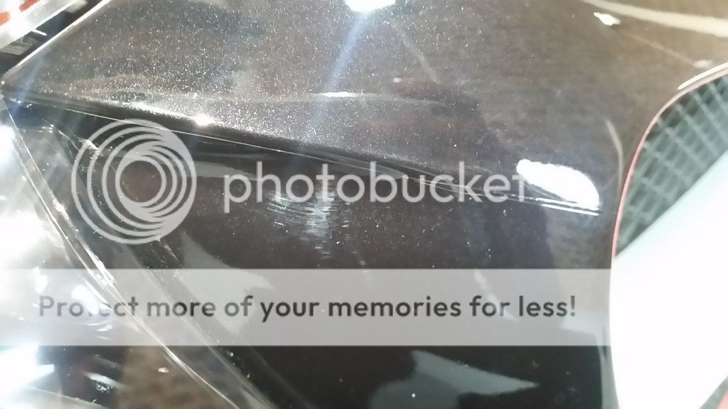

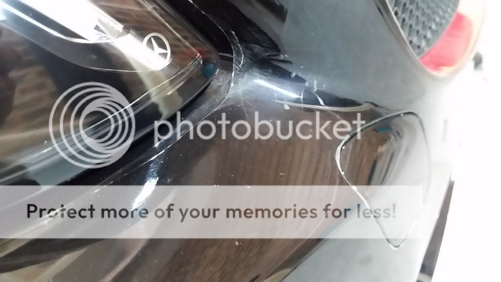

Lifting of the film along the edges (due to shrinking), incorrect trimming and bubbles in the fitment:

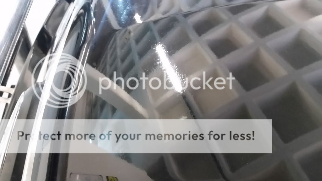

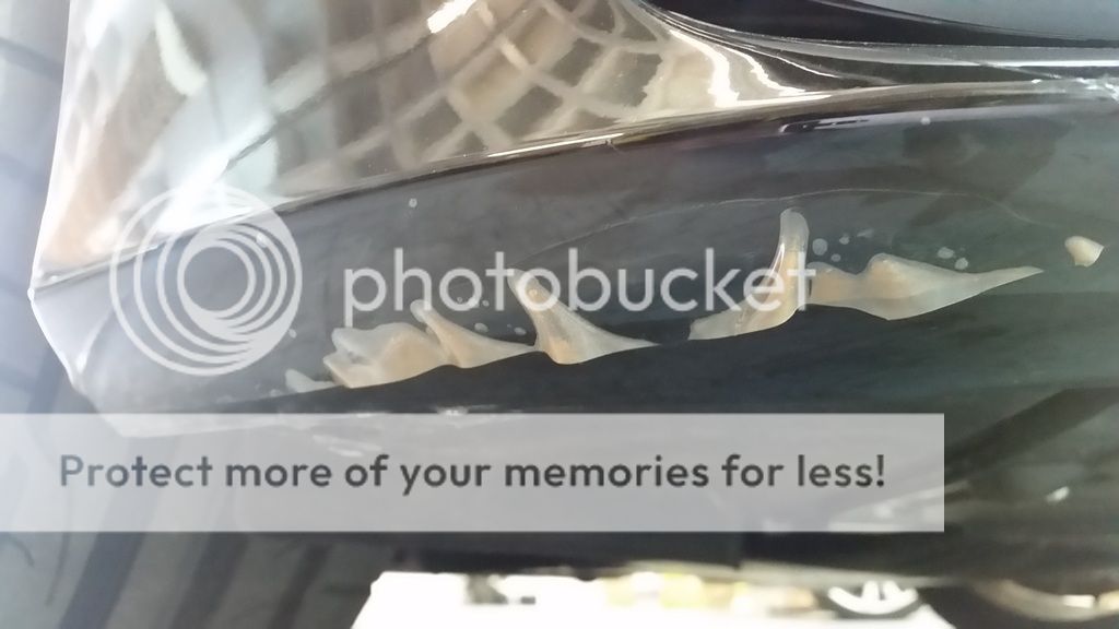

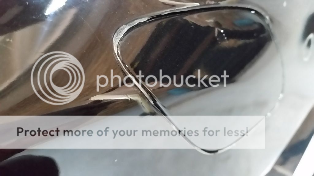

One of the other major problems we found was cutting through the film into the vehicles paint:
Unfortunately the cut paint required the bumper to be re-sprayed before we could fit our VPS PPF can be applied so that car was then taken away to a panel beater.
