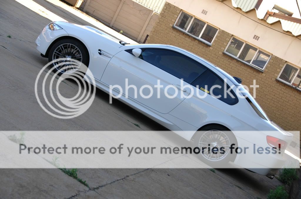

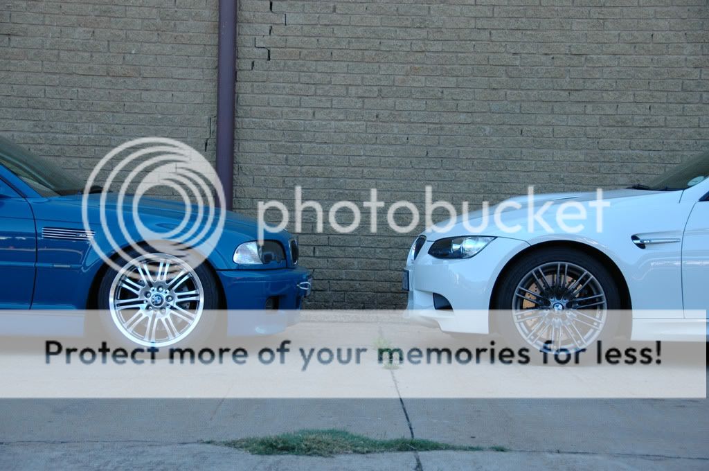

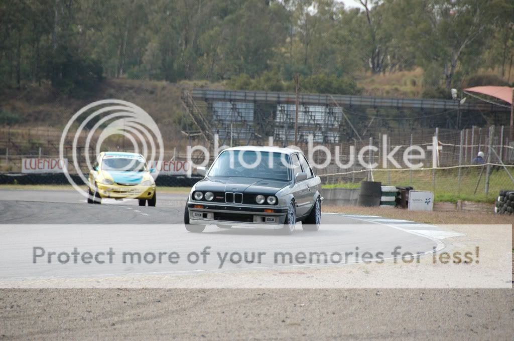

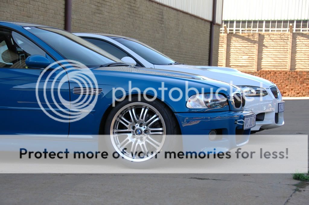

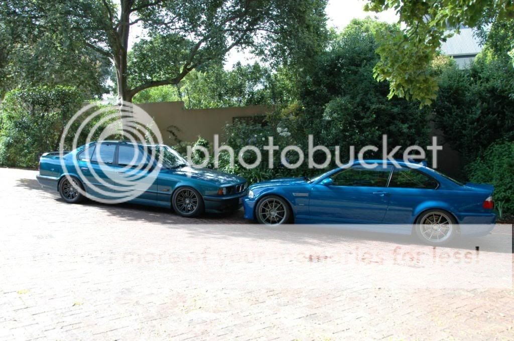

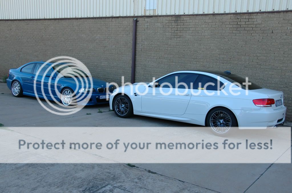

Anyway, here are a few pics of my current cars.
The blue M3 currently rolls on these grey mags.

freerider said:
Great looking cats! Whats with the day-glo yellow sticker in the e92's window?
That is an event sponsor sticker (ATS Motorsport) from the Krugersdorp Hillclimb. I just decided to leave it on there.
