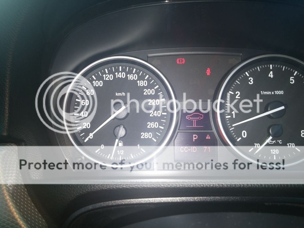

Hey Guys, so while driving to work today this error popped up on my dash, anybody experienced this before?
Weirdly enough my cabbie was services 2 weeks back and suddenly the service light has come on as well.
:smashScreen::smashScreen::smashScreen:
Magneto
Rear brake sensor?

Do you guys think its worthwhile to replace the sensor?
