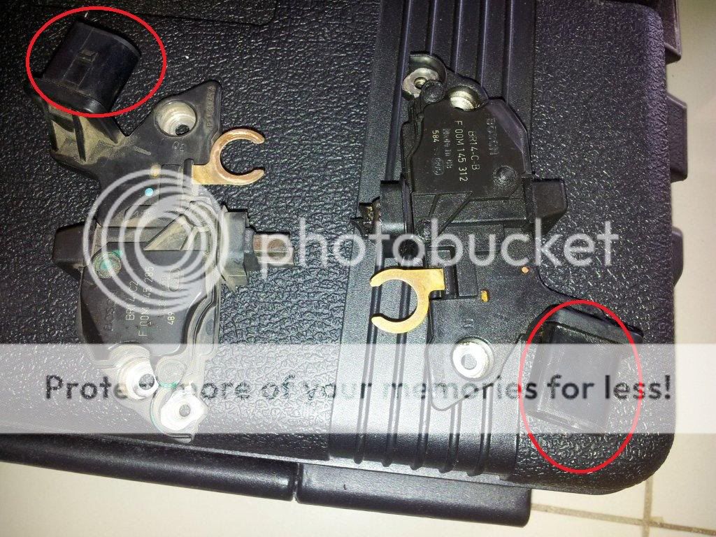

Apologies, it's a Bosch.
Also if it will help - I have the 150Amp Alternator.
A pic I took a while back of the 2 regulators as referred to in my first post.
Hey, sorry, OFF TOPIC- We have the same toolbox :thumbs:
Goodluck
