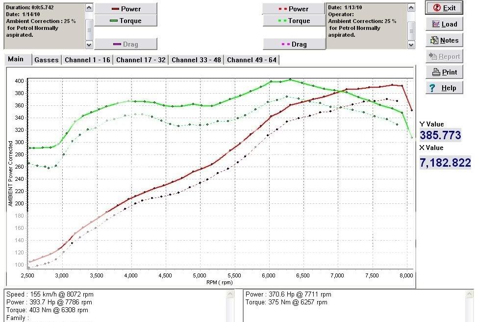

Ran a stock M5 today at KAR. Pump fuel, bone stock 372hp (277kw) on the wheels. The car seems to be mighty strong on stock form already. The suspense is keeeeeling me!
The owner was waiting for me at KAR & fetched the car from me as soon as I arrived and took it for a spin. He reported an noticeable increase in urge in the midrange & an eagerness to rev to redline. He was present during the runs. It made 388, then 393, then 394. Obviously still adapting. Chip & primary & secondary catts removed.
