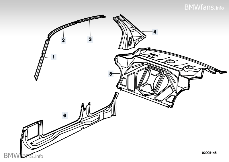

This sucks, how do I fix?
Phumi
BMW Car Club Member
OMG…This is horrific FUKC!!! What type of person does this to such a legendary car
Twinz
Forum - Support
Its a mess. Replace the broken pieces or find a creative way to fill it up...damn. :flyfun:
Nic_s
What about the local muscle car builders?? They work on cars that's basically just rust. So this should be easy for them?
rick540
Nic, good point, we have a few custom shops here....
Looking at it very carefully again this morning, is definitly not structural where they have cut and the rest of the car lower down is immensly strong, you can see the separate strengthening structure. it also rides on a subframe.
I also had a look at some track cars (E34's) where they have removed the rear shelf to save weight and the roll cage goes straight through that area.
So:
1) Fibreglass.
2) Rivet an aluminium overlay in.
3) Strip car and weld, probably not worth the effort.
4) Carbon fiber patches?
