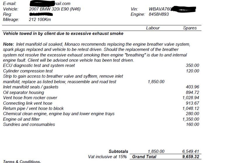

Do you guys know of cost implications? should this be out of my pocket and get push back from the ex-warranty guys

is this correct ?

Gave the go ahead to complete the job, as shes in need of the car. will keep you guys updated on the results of both the warranty suckers and the car itself

It was the CCV/PCV system as I thought and confirmed by other members above. It's a common issue on the e90s apparently.
The exhaust was flooded due to the excessive oil being sent to the combustion chamber through the intake manifold.
