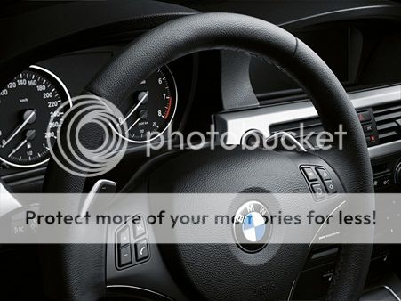

This is what I think about the paddleshift for the steptronic X35.
1. It does not look pretty on the eye especially the top part that is visible.
2. It is not very natural and intuitive to use because you have to use your thumb to downshift. Most of the time I found myself pulling on the paddle on the left and forgetting to use my thumb for the paddle on the right. Terribly confusing, the older you get. :=):
3. Only the right or left hand side of the paddleshift will ever be used, which does not instill a "racing" driving feel when using the paddles.

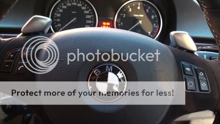

In comparison the M3 DCT (e90) paddles are just awesome. You can convert the M3 paddles to the 335 for a plug and play installation. See the DIY in the sources at the end of this review:
Here is another aftermarket version of the M3 paddles. Very good looking indeed:

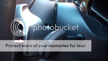

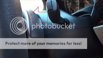

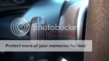

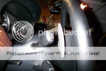

So I started thinking about the M3 paddles on my car. Cost wise it would be around R4,000 for the paddles excluding labour. However, I came across a number of reviews of 335 owners that have done this conversion and even though it is an easy plug and play installation the following problems were reported which made me re-think this option:
1) Some cutting behind the steering wheel is required even though "no one is going to notice it anyway, and you can't really feel it because the gaps are in places that your fingers never naturally are."
2) " The upshift paddle is too close to the windshield wiper stalk. - for someone with big hands/fat fingers, you're going to end up being annoyed by this, as the paddle is directly in front of the stalk, and your fingers/hands naturally place themselves in the area where you'd hit it if you're used to there being a lot of room back there."

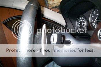

Now if you compare the above M3 conversion on the X35 with the stock pedals (below) you will see the stock pedals look better and provide sufficient movement and freedom for your right and left fingers:
