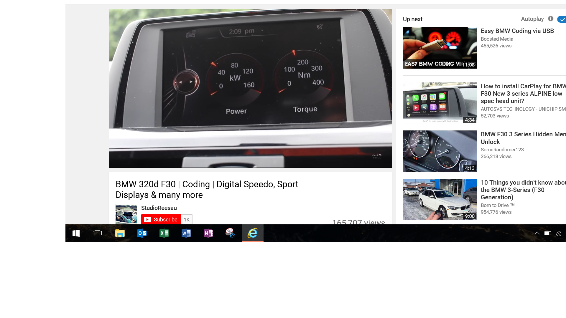

It looks like it can be coded even on normal small screen
TurboLlew
This can be coded with eSys or Carly.
You need to have the right version of software on the DMEs, NBT HU (big or small screen but it can't be HU Entry) and on older cars the DME might not be supported at all... in not, you will get the displays but they won't work because they won't get the 'inputs' they need. Worth a shot coding and checking if they will work if you really want them - you can always revert. A bit gimicky though and I doubt they are accurate at all if the posts online are anything to go by.
