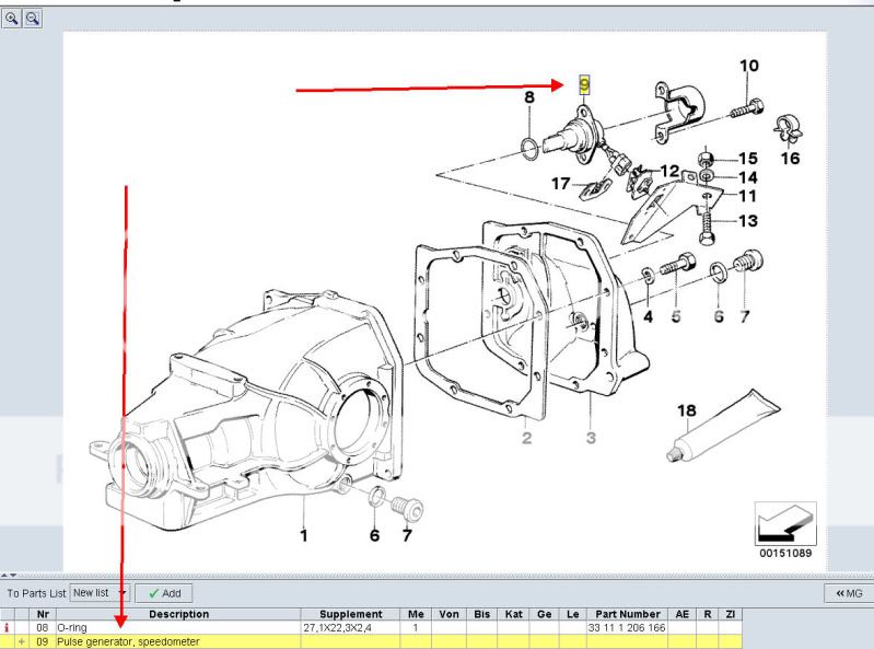

Where can I find the speed sensor on the E34? Everything is working fine on the cluster but it looks like my speed sensor has had it.

if you send me a pm with your mail can send u a picture from the BMW ETK with the part
and I have some time today
Gerhardm32
Thanks Adi, this can help me now a lot, especially the picture. I found that write up, but didn't understand where and what to search for, come next week I am under the car. I did that self test on the cluster and that's how I came across the fact that speed sensor must be my problem now.
