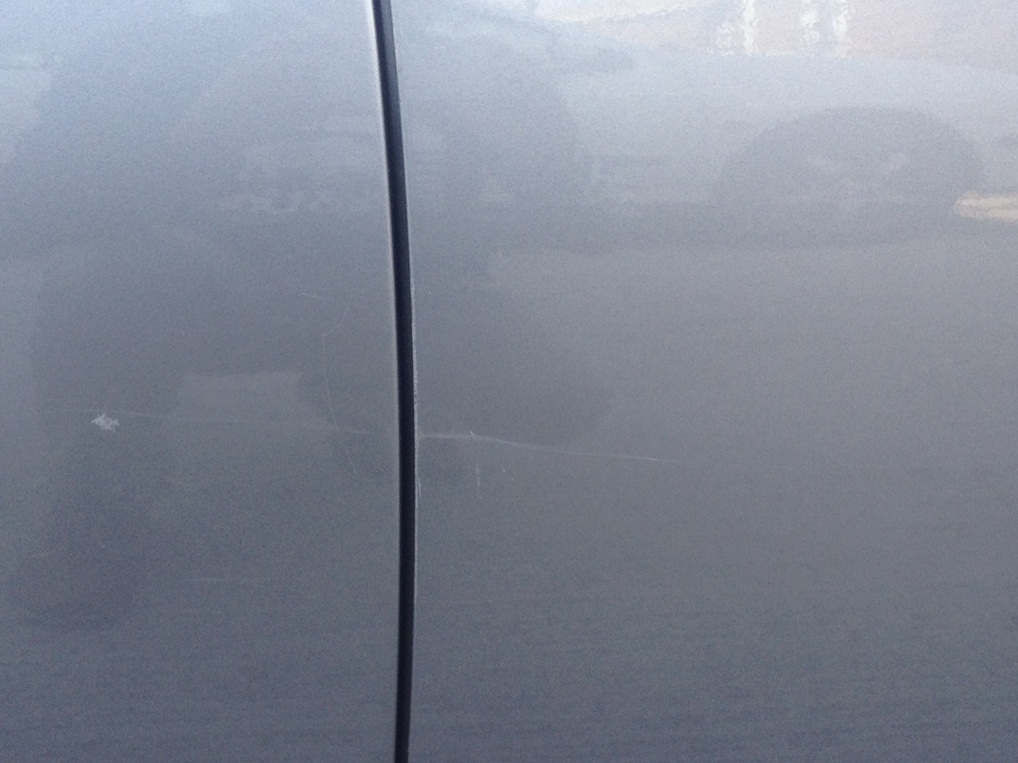

Good Day
I have a few scratches on my door, my nail gets stuck in them so it pretty deep:blueCry: [/b]. Any advise on what i can do to remove them would be greatly appreciated.

I only have like 4 scratches(4 scratches to many). So to spend 20K+ on a respray to repair those is a bit much.

Tried that the scratchers are to deep to buff out.

Thanks for the advice will try that, hope they have a colour close to space grey.
