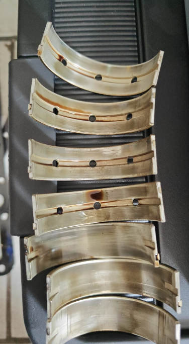

This car had 7500km oil changes basically the time I owned it (IIRC 40K)
Mains

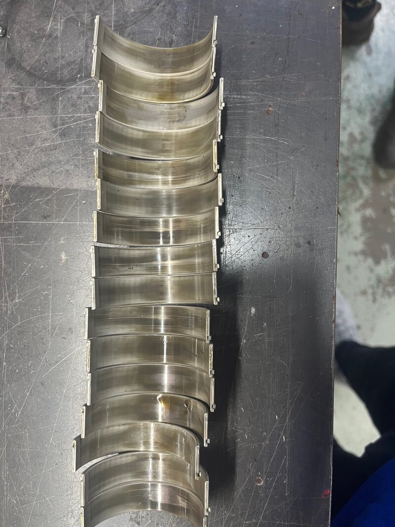

Didn't look too different.

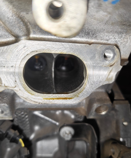

The carbon build up was also not bad.

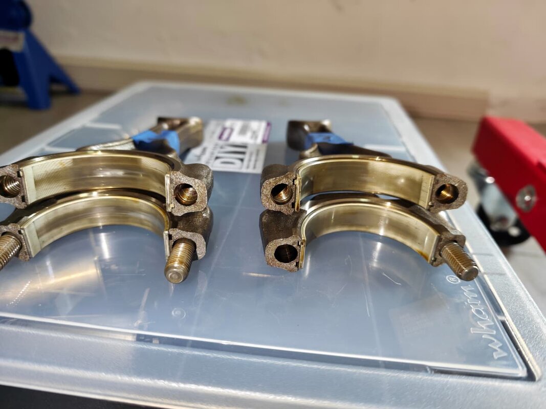

He is replacing rods (FCP) and bearings (ACL). Doing some other stuff as well apparently like nitriding the crank and more bearing clearance. Not replacing pistons but refreshing rings too. The valve guides and exhaust valves were the worst offenders in terms of wear. Oil delivery system looked good.
There was some pitting after cleaning so he will be doing new valves. Guides are not available from BMW so using Supertech IIRC.
