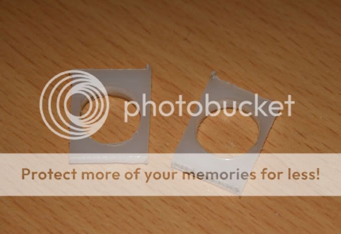

For scale that hole is 13mm and the ones I put in mine were 12mm and bearly cleared screw. The EOM have a 13mm hole.
The bushes are 17mm x 20mm. These are slightly smaller than original dimensions. I stopped worrying about the dimensions though when I realised that aslong as they fit its only the thickness that matters.
They will require sanding down to fit. This is a trail and error process as they require a snug fit but not too tight. I made mine so I could press them in using my fingers and slight tapping with a hammer to get them lined up properly.
