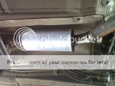

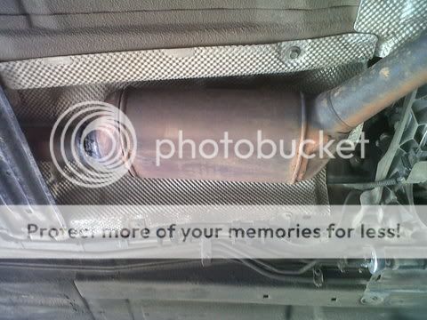

Cat, with sensor in front and back.

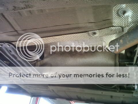

Cat cut out between Sensors

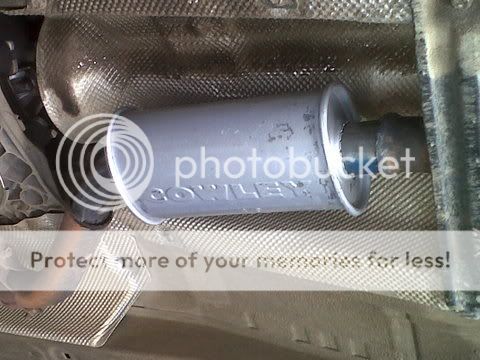

New Box fitted

No need to instal cat fooler as the box fitted between the sensor. You can c the sensor on the first pic to the left above the brace.
318 A/T 2005 N46b20 engine
