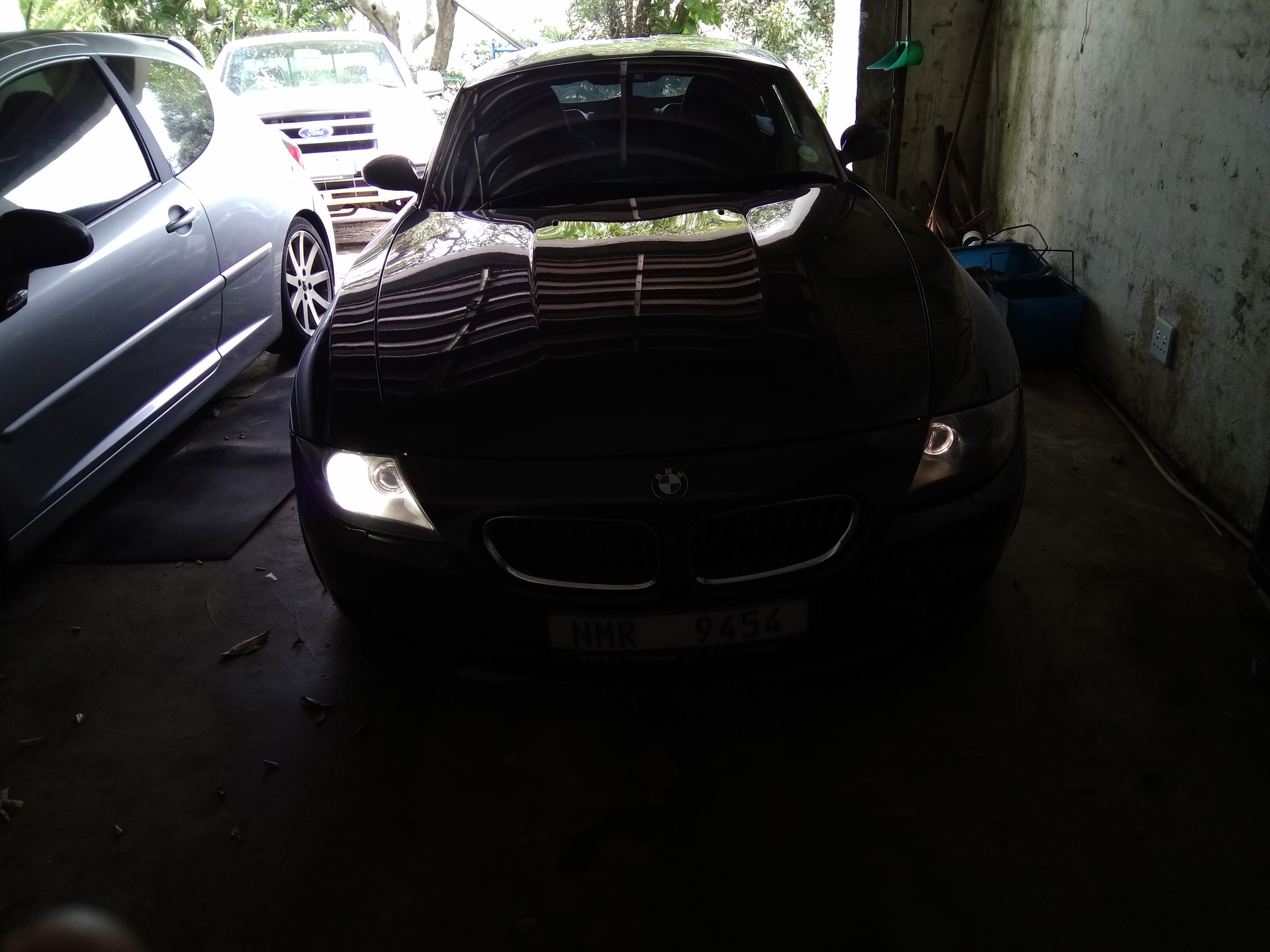

I decided to find a second opinion on the car. I drove to AE performance on 144 Peter Road and arrived on a Saturday 4th November.
Shawn Moodley (the owner) invited me in, and I let him know of my troubles. He asked me whether I wanted my issues sorted out today. I uttered a jubilant YES! But did not believe that he would be able to sort out an issue which Anand could not sort out after three months.
Shawn ordered all his mechanics to give my car priority and within 5 minutes they said they found the issue and all my problems would be resolved. The bracket for the airbox was missing! They proceeded to put a bracket in, and low and behold, the dead spot was gone!

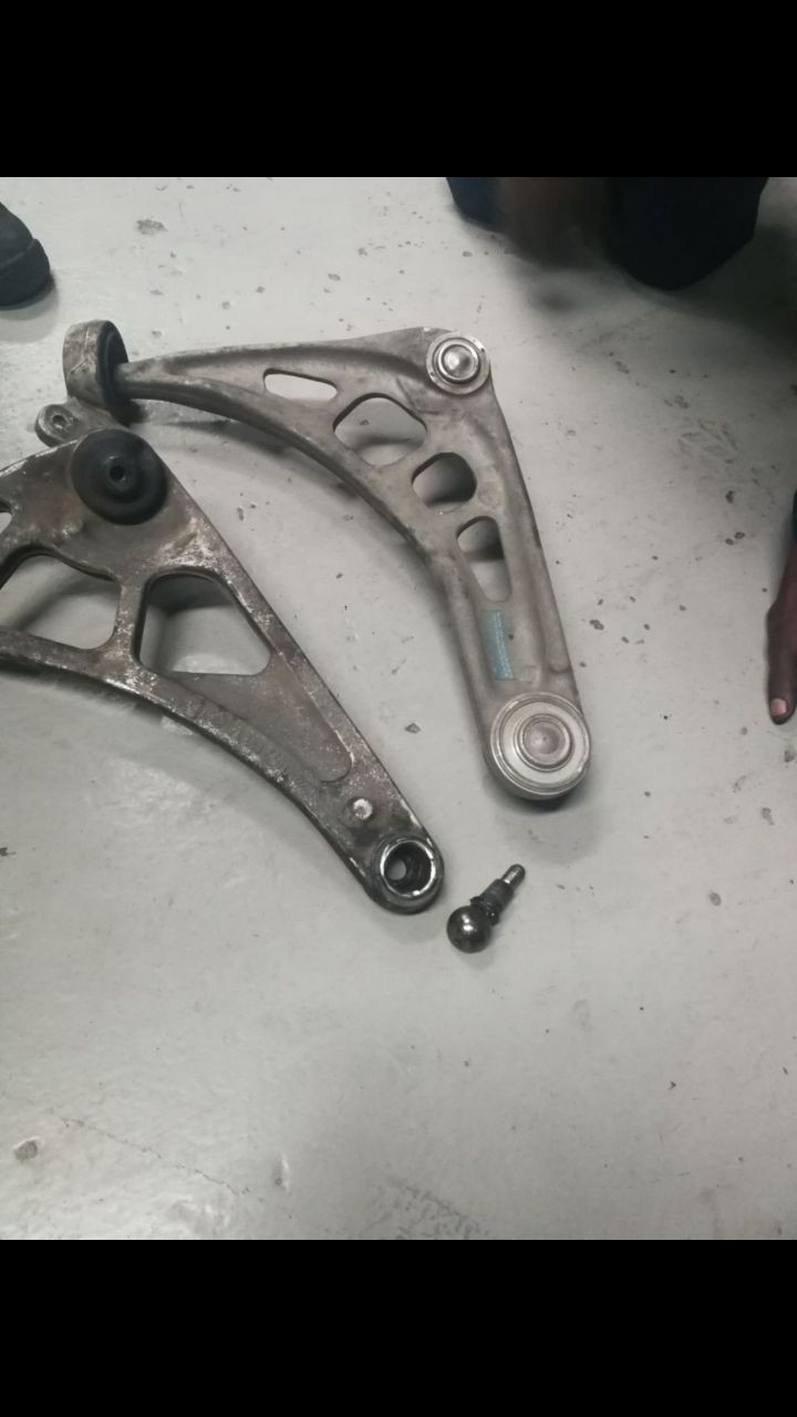

Upon jacking up the car to fix the fender, Shawn noticed the control arm was broken to the point where it was dangerous to drive. He also told me my airflow meter was faulty and even proved it by putting in his own airflow meter into my car and running it on the dyno. The car produced 20Kw extra!
