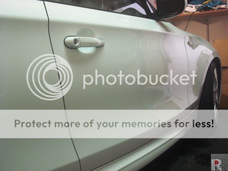

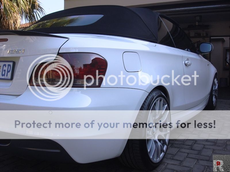

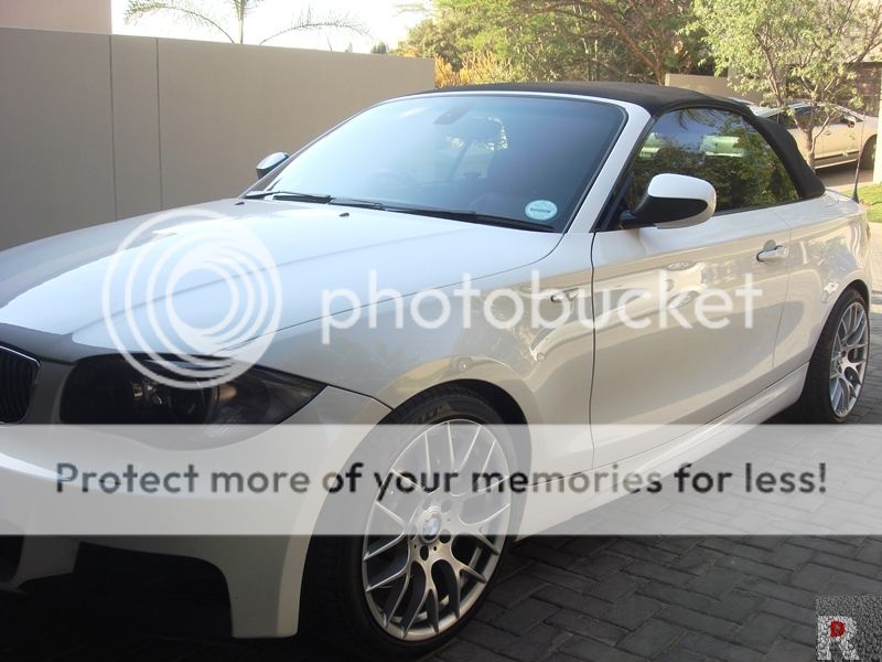

Before Pics.

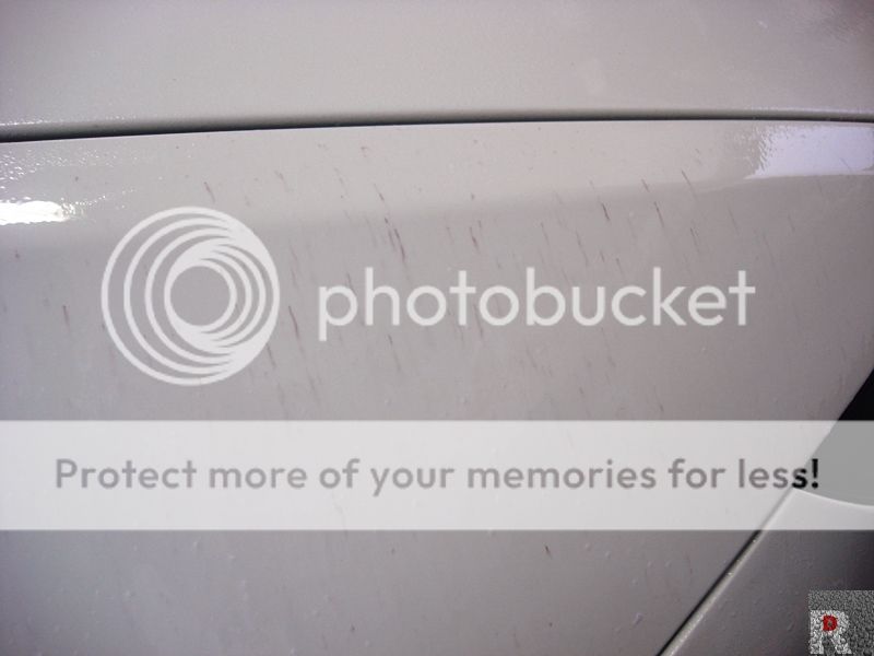

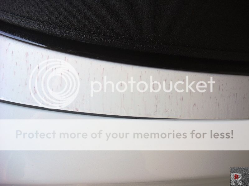

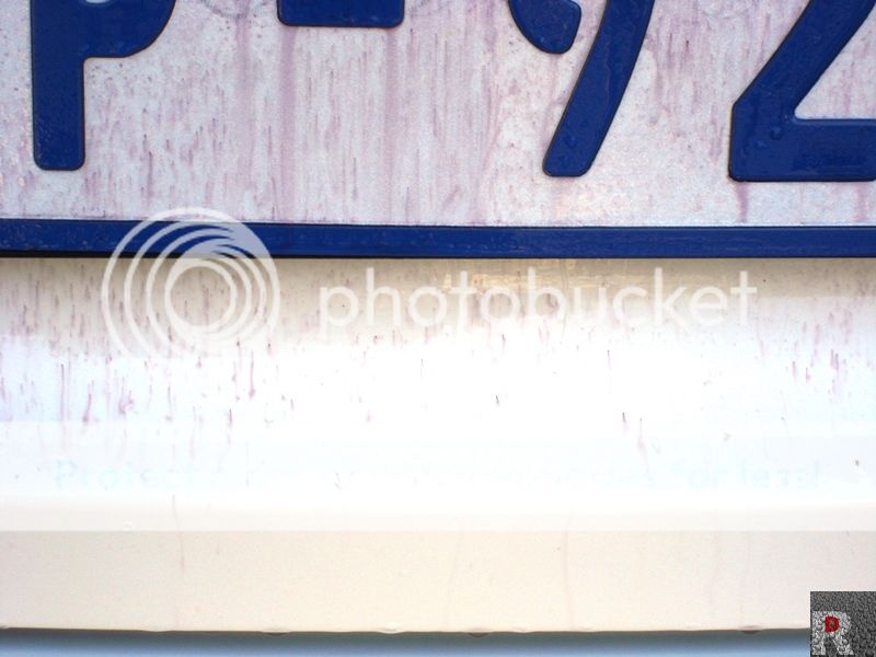

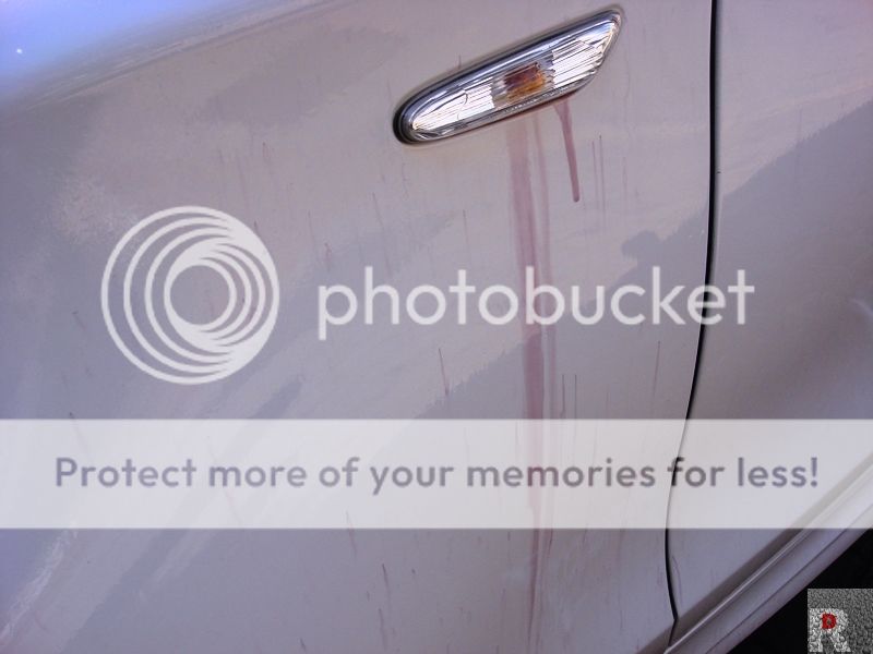

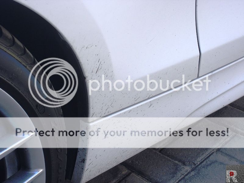

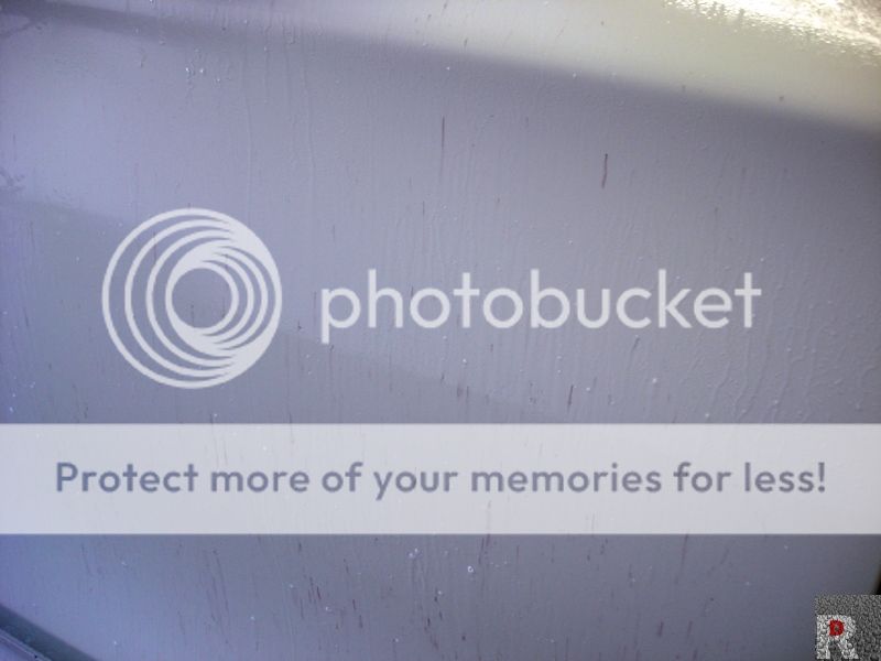

Must say Iron Out really works well and shows best on a white car

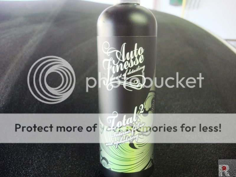

While I was waiting for the Iron Out to do its thing I cleaned the fabric roof using AF Total 2

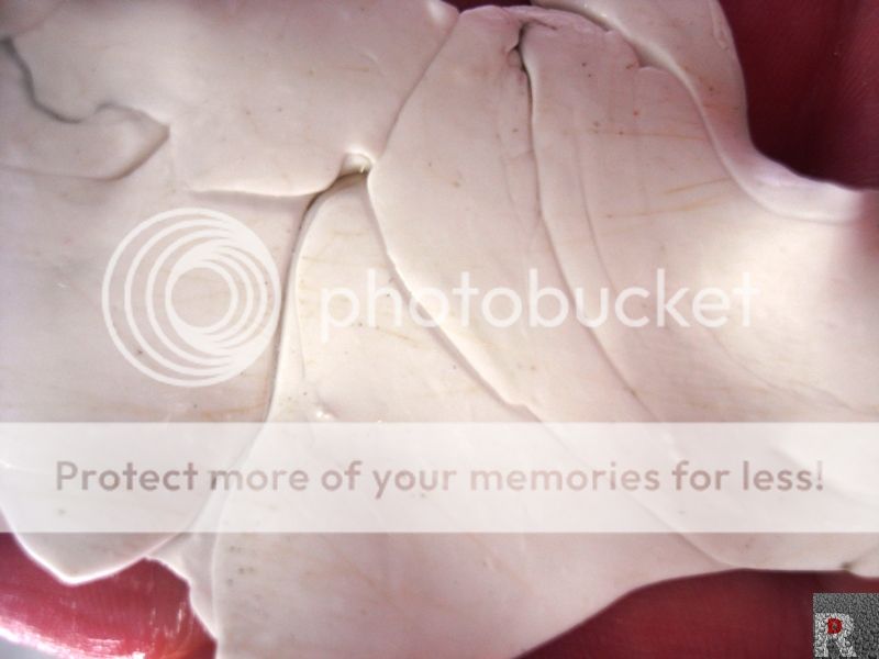

Clay

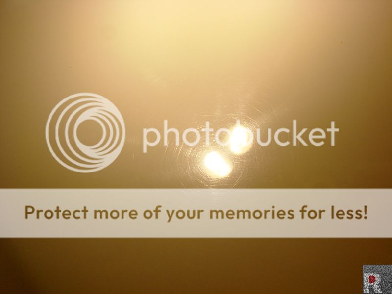

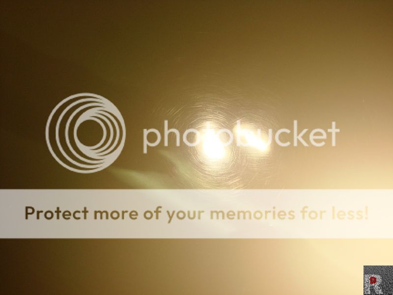

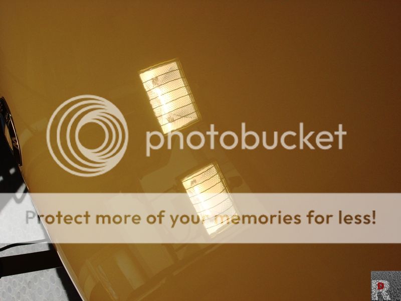

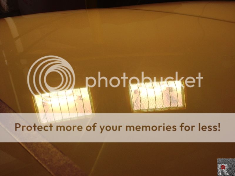

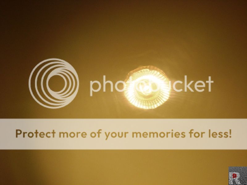

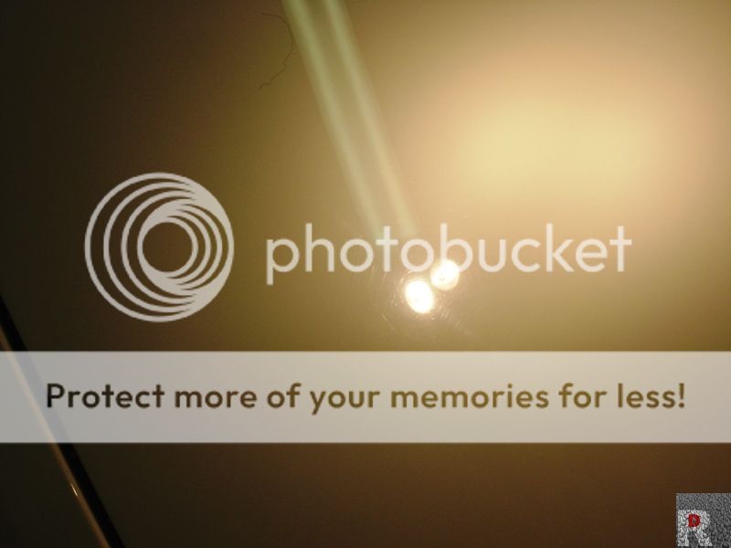

Paint defects

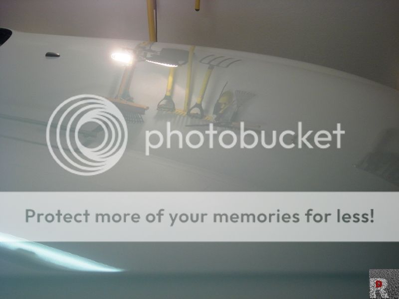

50/50 of the bonnet ( Well kinda )
Bonnet done
Before
After

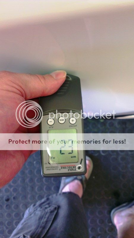

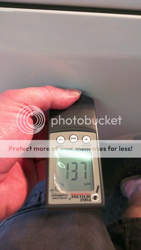

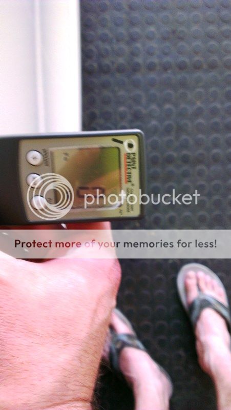

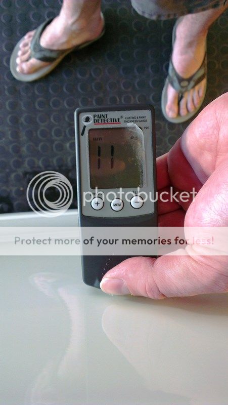

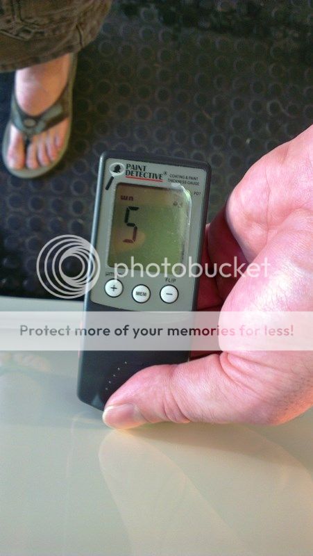

Now for the biggest mind boggle iv had in years
This must have had me stumped for about 2 hours.. I really couldn't figure out what was going on here. So as i was measuring the pain thickness as I normally this happened
So after a few calls and new batteries i still had the same issues. Eventually i had a car with 0 micron of paint on it. Where I had a reading 10min ago now read as zero...
Eventually after some reading of the manual there I found out there is a master reset .. So after that I had extra paint to work with :) :flyfun:

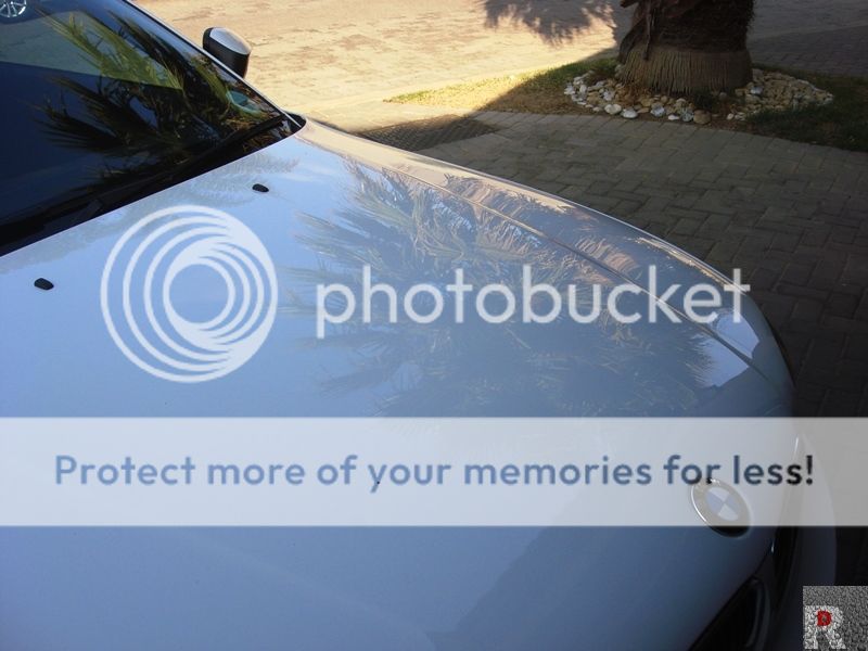

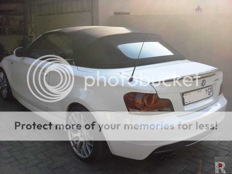

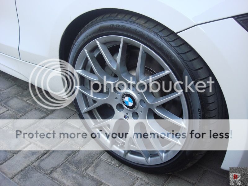

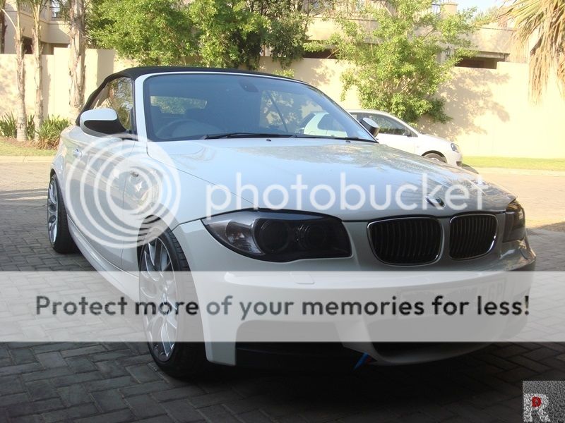

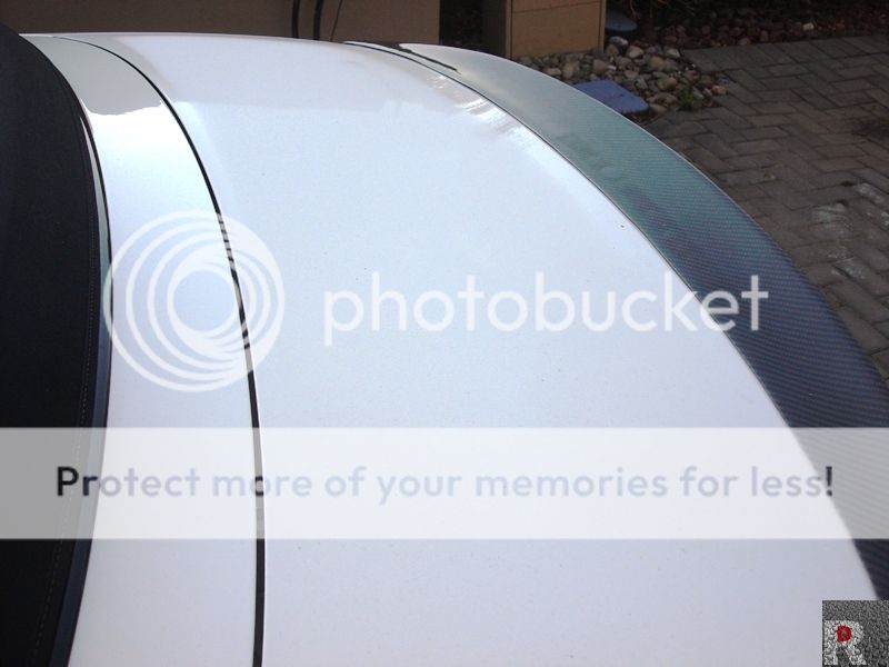

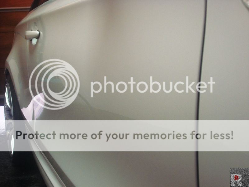

These are the only afters I have ( Blasted rain )

Paint depth gauge must have caused you a few questions.

Can you tell me what results you got from the AF products you used on the roof...
And if you were happy with them.
How much does it go for?
Would you recommend it for my kit?

Hi Fraser...with Lambchops permission I hope you dont mind me responding to your question. For soft top cleaning AF Total interior cleaner works very well. Simply spray the the roof to remove loose dirt...spray total onto the roof and using a leather cleaning brush/fabric cleaning brush scrub the roof in one direction moving from the front to the rear...then simply rinse off again.
The thing missing in the AF range for soft tops which is currently under development is the AF waterproofing treatment to be applied after cleaning.

That paint depth gauge got you scratching your head for a little bit hey… Great work Nick. :thumbs:
