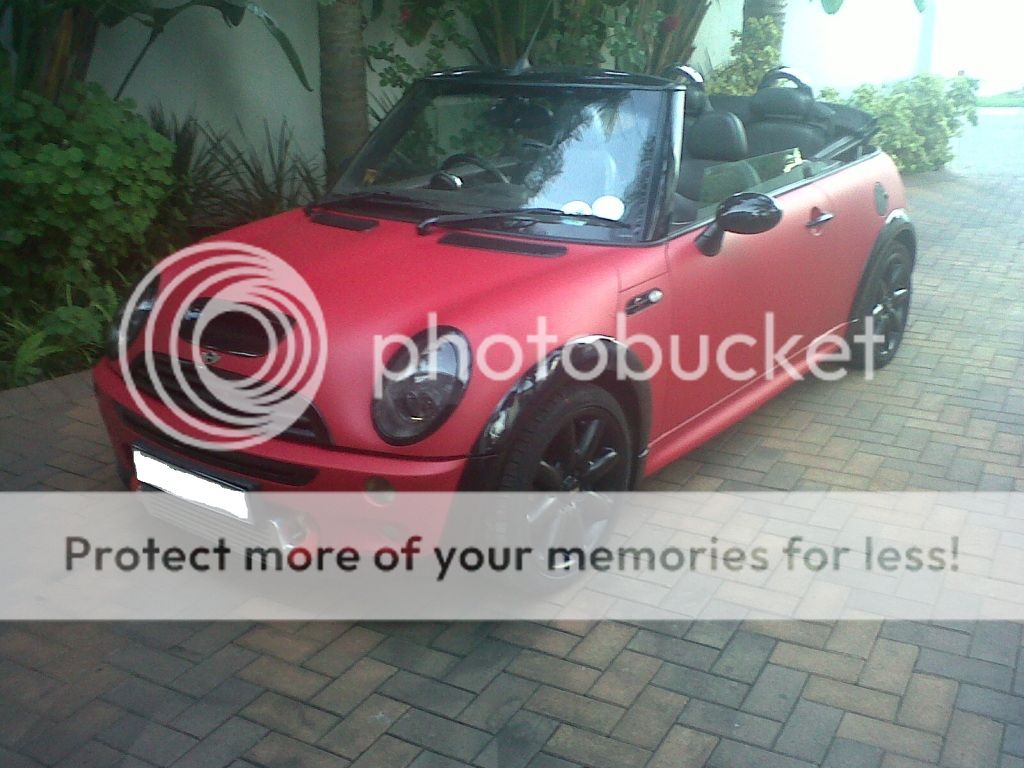

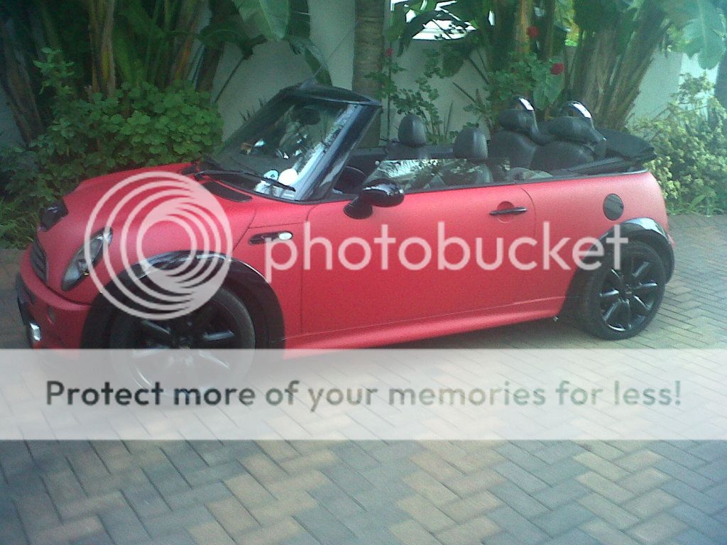

The Mini arrived looking all sad and stock :rollsmile:
Mods completed:
Wrapped in red and gloss black
Full exhaust
Intake
Front mounted intercooler (custom made)
Stage 2 base file loaded
Replace Fuel Pump (she was broken)
15% reduction Pulley
Gloss black wheels
Mods still to be done:
Stage 2 revised file
Street Cam
440cc injectors
Lots of red silicone bits for the engine
After Wrapping:

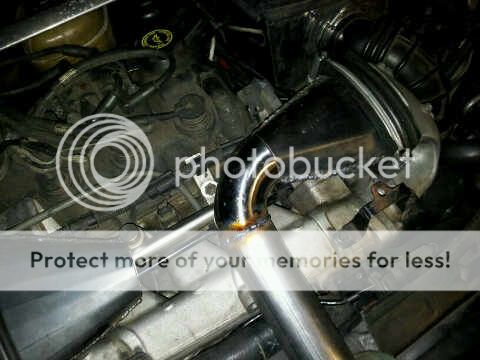

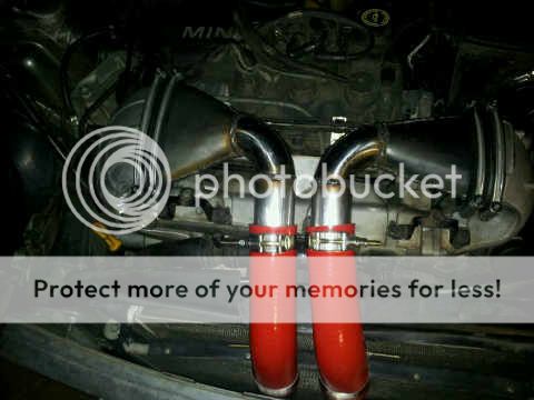

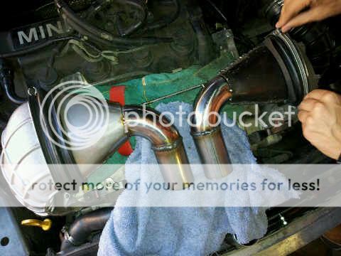

Intercooler piping being made:
Pipes mounted, just need to be made pretty:

SAC did the FMIC piping in carbon. Might now be a odd idea to smooth those out and make a mould of them, them make it in carbon. It will offset the added weight of the system a bit.
Willy
And while you are there, fit bungs to the pipework to measure tempratures. This can be very usefull for when you fit a IC waterspray system that compares the air temps before and after the IC.

need to edit pics the car looks pink :fencelook:
looks like you playing nicely with the engine :rollsmile:
