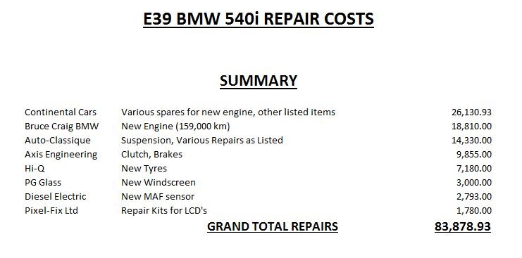

Problem is, when you start spending money on these cars, one tends to not stop. I wanted everything perfect, so over the course of the last 9 months - February to October - I have been "investing" (yes, I know it is not an investment financially, but it sure is an emotional investment) in "The Beast" so that she is back to what I want. I am almost there.
Herewith a brief summary of costs incurred. Must be noted that, before the motor transplant, I replaced virtually all seals and gaskets on the donor, as well as many other items. (I do have a very detailed list of EVERYTHING I bought).
