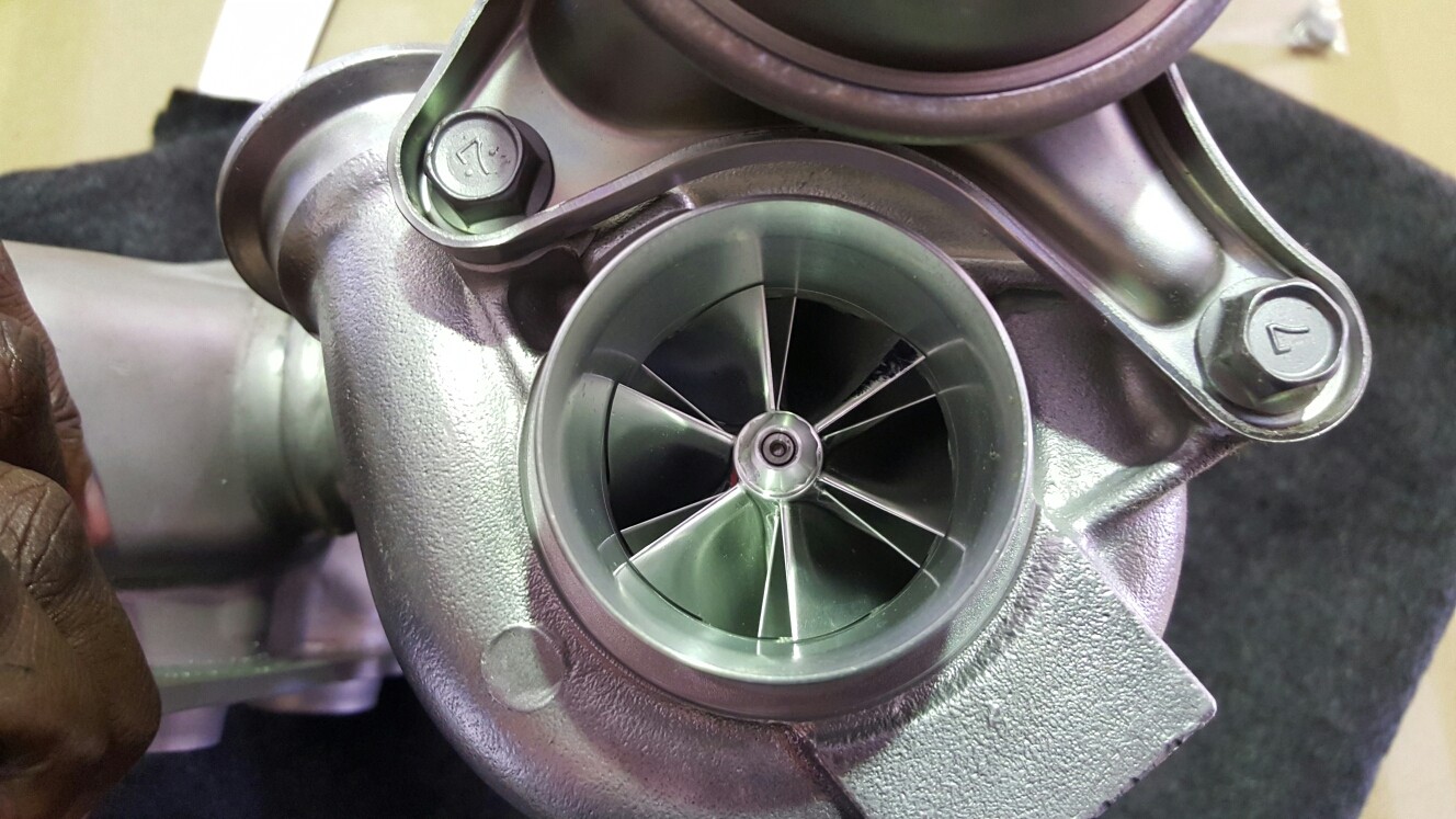

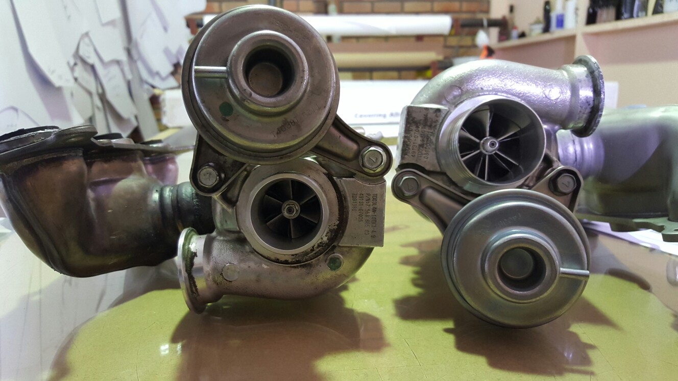

Have been working on this project for the last 2 months. It's FBO but only has a Stage1 Fuel-It pump, 2007 Auto. I will do a full write up soon and if anyone requires assistance or pic's I will gladly post or reply.

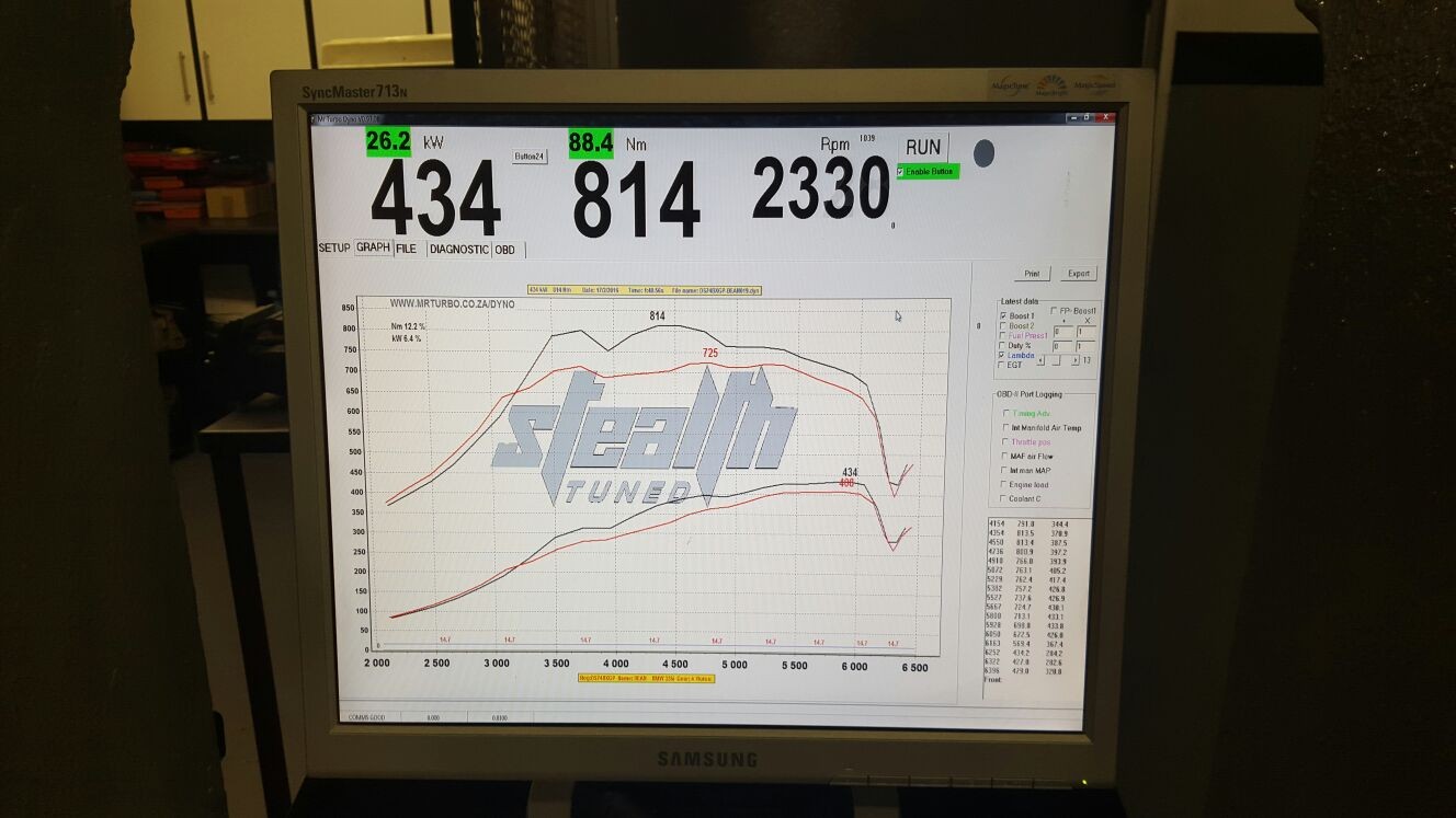

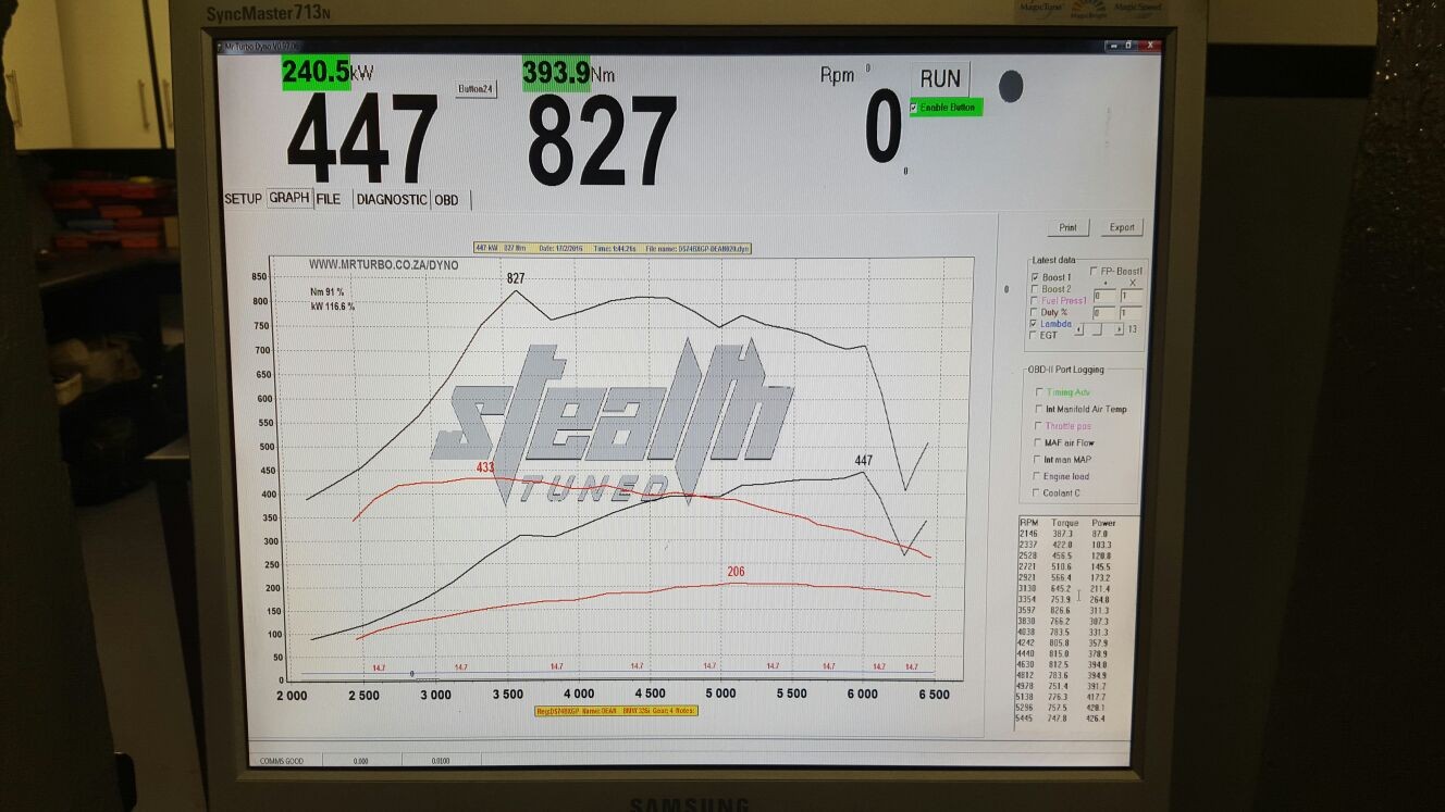

Stock figures were 206wkw @ 433Nm at Stealth HQ in Durban. After many logging sessions on the Pump & Race file (BEF) and optimising it I headed to HQ yesterday to do the final tuning on the E85 File.
Gains were 240wks & 393Nm from the stock figures. Only finished up this morning at 03h30, thanks to Riaz & Ashen for keeping shop open. Also thanks Kish for stopping by. I troubled alot of people during the build aswell so thanks to Sean (Axis), Gert, Afzil, JP & Peter.

Those are some very very impressive gains.
Thats a good 50wkw more than standard RB turbos.
Cant wait to see what sort of times it'll put down on the 1/4 mile.

Well done Dean.. your customer is going to be a happy chappy!... with more e85 and uprated pump it will break that 450whk mark happily...
Anyways 600 wheel HP isn't anything to be shy of with a sleeper look like that...
