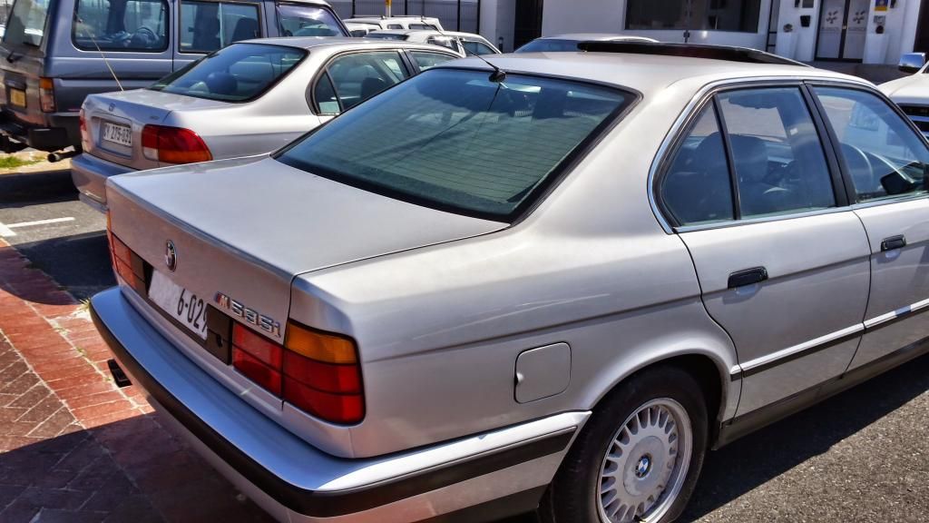

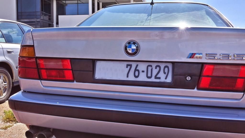

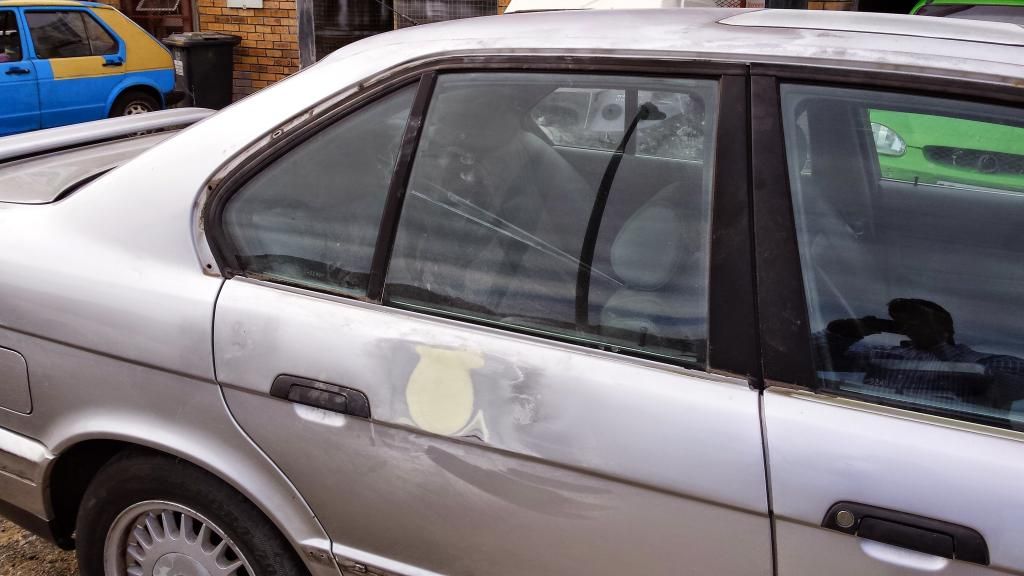

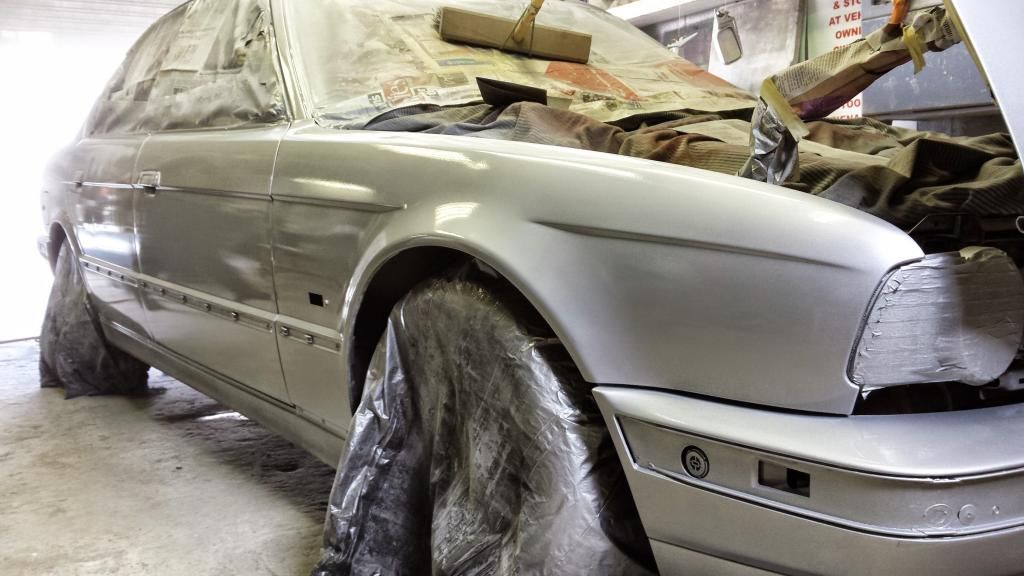

So I recently bought me a 535i E34 1991 model with 188k km.

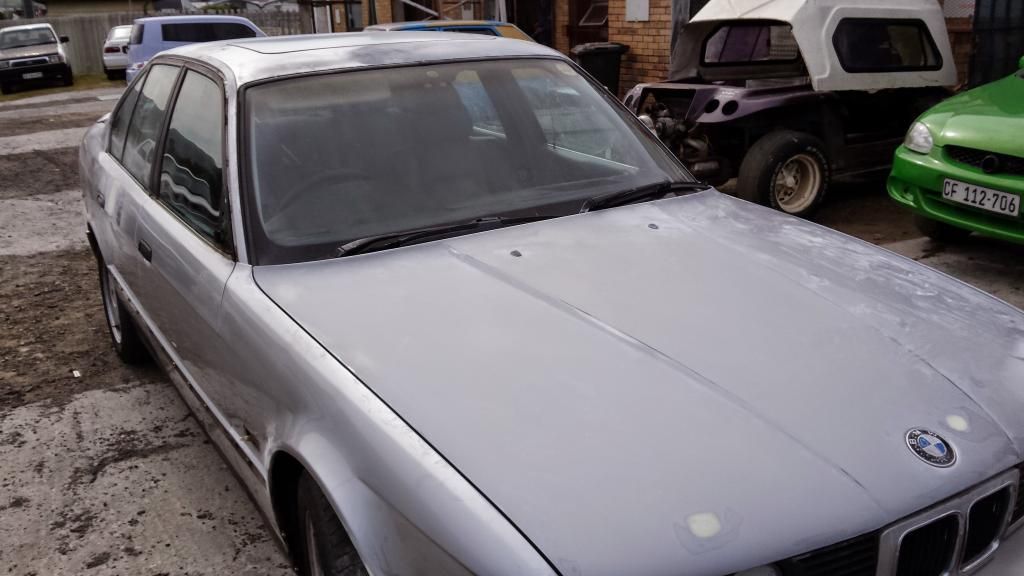

I knew there was some work to be done, and I immediately had the whole car resprayed. The progress can be seen in the photos below.
I'm happy with the outcome and next i will focus on getting the transmission sorted. I drove it this afternoon for the first time after the body work and then I broke down with a burnt clutch and broken release bearing.
I think it might have been man-handled in its previous lives. :cursin:
If you guys have any advice/comments on E34 ownership, please feel free to post replies.
Before:

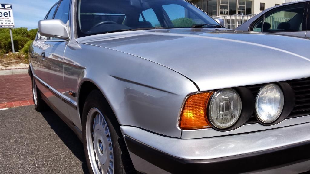

AFTER:
<a href="http://s904.photobucket.com/user/cloeterc/media/20141128_150916_zps0f507b0b.jpg.html" target="_blank"><img src="http://i904.photobucket.com/albums/ac243/cloeterc/20141128_150916_zps0f507b0b.jpg" border="0" alt=" photo 20141128_150916_zps0f507b0b.jpg"/></a>
<a href="http://s904.photobucket.com/user/cloeterc/media/20141128_150938_zps9aabaa1d.jpg.html" target="_blank"><img src="http://i904.photobucket.com/albums/ac243/cloeterc/20141128_150938_zps9aabaa1d.jpg" border="0" alt=" photo 20141128_150938_zps9aabaa1d.jpg"/></a>
<a href="http://s904.photobucket.com/user/cloeterc/media/20141128_151043_RichtoneHDR_zps53b6a98e.jpg.html" target="_blank"><img src="http://i904.photobucket.com/albums/ac243/cloeterc/20141128_151043_RichtoneHDR_zps53b6a98e.jpg" border="0" alt=" photo 20141128_151043_RichtoneHDR_zps53b6a98e.jpg"/></a>
<a href="http://s904.photobucket.com/user/cloeterc/media/20141128_151111_RichtoneHDR_zps52957382.jpg.html" target="_blank"><img src="http://i904.photobucket.com/albums/ac243/cloeterc/20141128_151111_RichtoneHDR_zps52957382.jpg" border="0" alt=" photo 20141128_151111_RichtoneHDR_zps52957382.jpg"/></a>
Almost there...

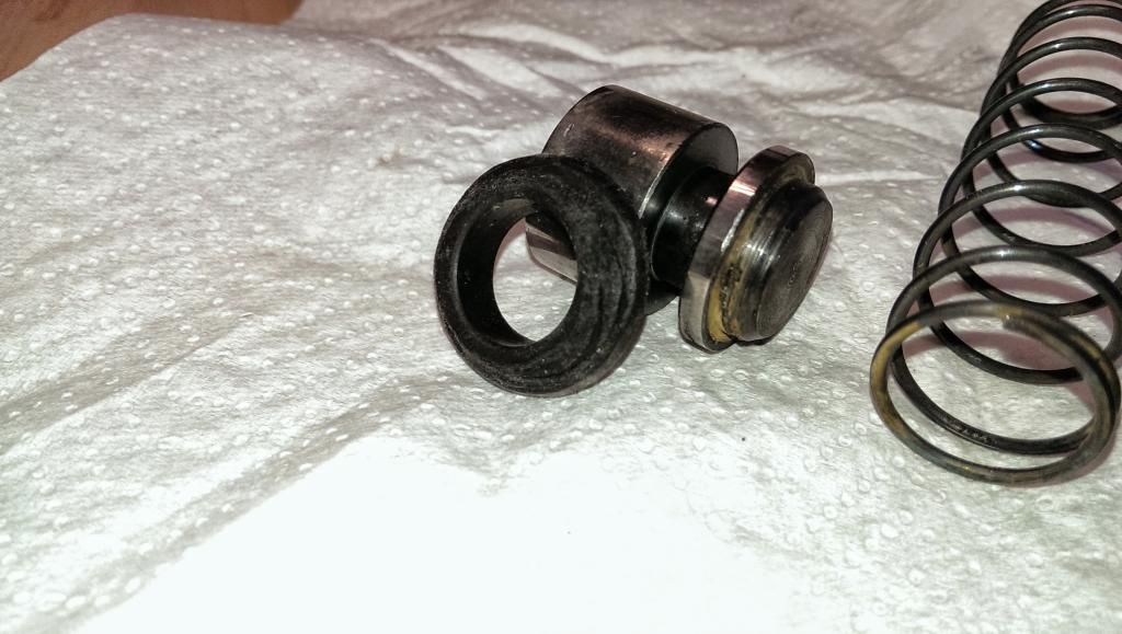

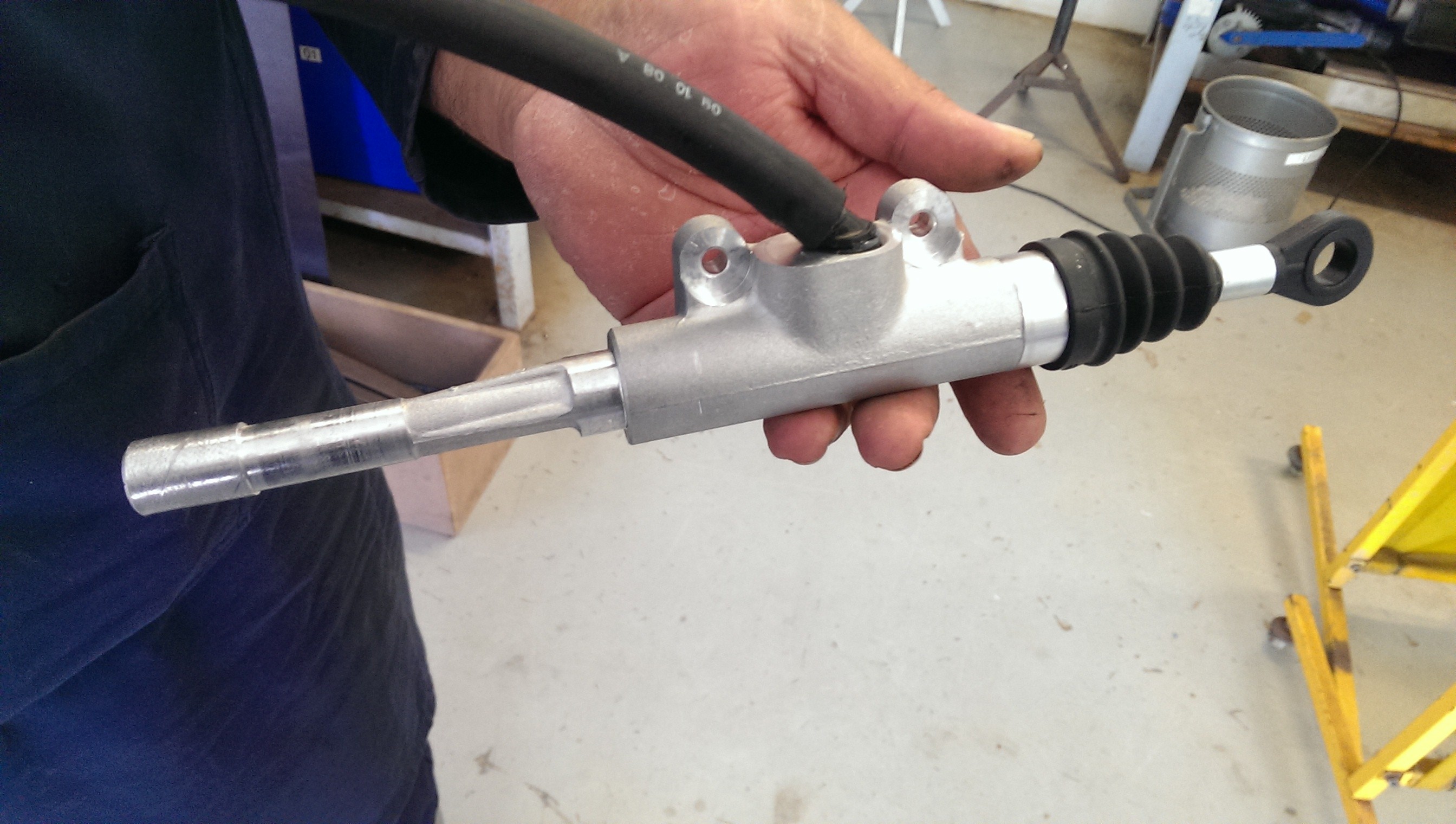

I've had to replace the clutch slave cylinder after being stranded without clutch and having to be towed in! :uhoh:
So after lots of scrambling for the right tools and lifting equipment, i replaced the part.
Here's how worn the rubber seal was.
Next on the list:
Front Left thrust arm bushings
Rear pitman arms
Oil change/Air filter and Oil filter
Interior work (to be done myself)
<a href="http://s904.photobucket.com/user/cloeterc/media/IMAG1668_zps365690b7.jpg.html" target="_blank"><img src="http://i904.photobucket.com/albums/ac243/cloeterc/IMAG1668_zps365690b7.jpg" border="0" alt=" photo IMAG1668_zps365690b7.jpg"/></a>
<a href="http://s904.photobucket.com/user/cloeterc/media/IMAG1657_zps64cf958b.jpg.html" target="_blank"><img src="http://i904.photobucket.com/albums/ac243/cloeterc/IMAG1657_zps64cf958b.jpg" border="0" alt=" photo IMAG1657_zps64cf958b.jpg"/></a>
<a href="http://s904.photobucket.com/user/cloeterc/media/IMAG1672_zps40f8f629.jpg.html" target="_blank"><img src="http://i904.photobucket.com/albums/ac243/cloeterc/IMAG1672_zps40f8f629.jpg" border="0" alt=" photo IMAG1672_zps40f8f629.jpg"/></a>

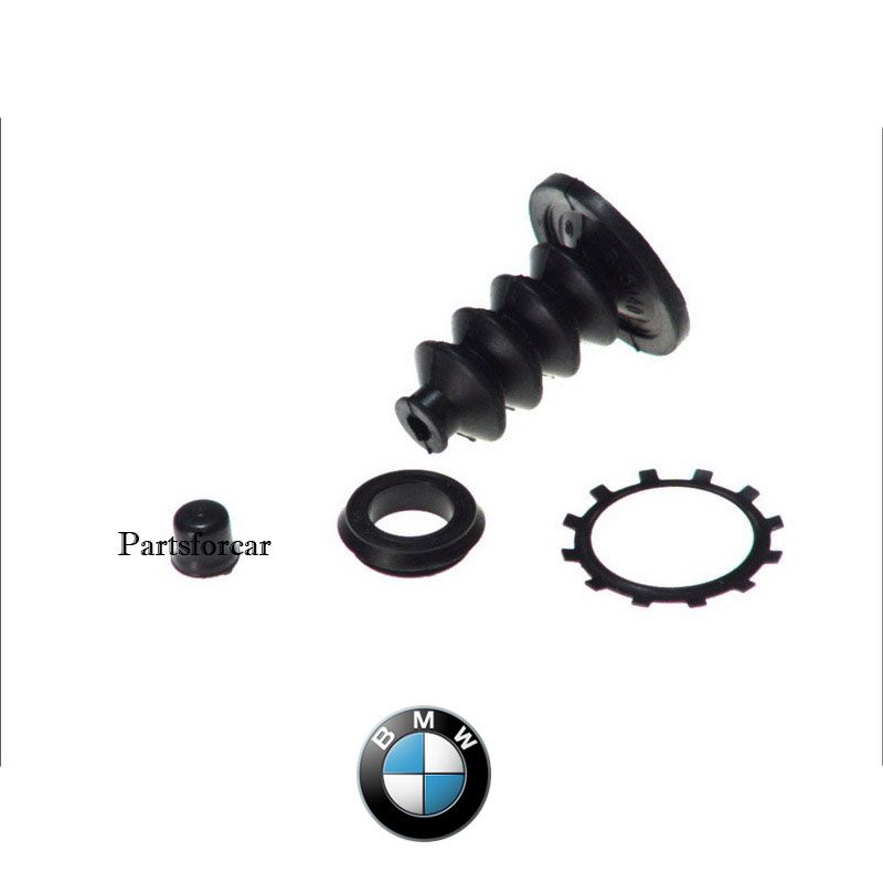

This is how it is supposed to look
<a href="http://s904.photobucket.com/user/cloeterc/media/D3-189_zps28cbe9b6.jpg.html" target="_blank"><img src="http://i904.photobucket.com/albums/ac243/cloeterc/D3-189_zps28cbe9b6.jpg" border="0" alt=" photo D3-189_zps28cbe9b6.jpg"/></a>

After this I replaced the master cylinder as well and bled the system numerous times.
The clutch still takes too low.
Could it be that the clutch itself is worn?

Guys, we bled the clutch system again today and even pressure bled it - to no avail. That clutch needs to be replaced. I am super down about it, but i do realize it will drive great again once we do this.
Besides, just like brakes, clutch is also a friction part, so it is just a matter of time for them to go. :banghead:

Bled the clutch with a pressure bleeding method from the bottom up, instead of pumping the pedal.
I found this video very useful.
Quite a few bubbles came out and after that, the pedal pressure seemed fine and also the engagement of the clutch was as high as it 'should' be.
All's fine for now.
