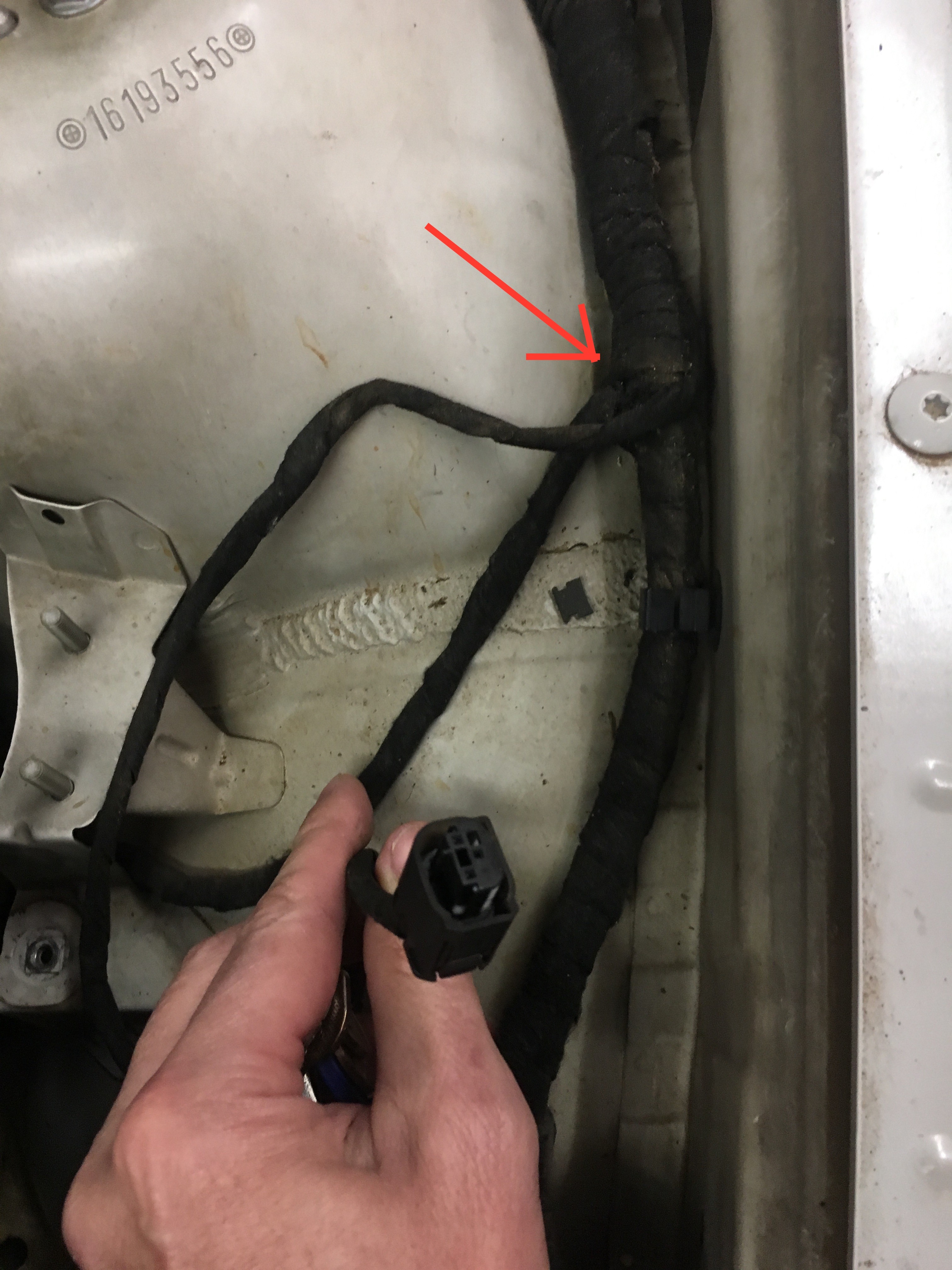

Thanks for the reply. I did turn the engine over by hand a few times after setting the Vanos timing. I agree with you on the plug. I am pretty sure they are all in the correct place. Oil and water, very important. I only have one connector still floating around without a hole to plug it into. It is not from the harness box, it is a connector on the passenger side (left) fender and cannot see anything it needs to plug into. I guess it is unused...
Mikkie
So, I thought I would just post a pic of that connector. The red arrow shows where it splits off the loom going to the left front light cluster.
Any ideas? Can someone maybe check in their E39?

Yip, that must be it. I have not replace the filter box yet, thus did not remember that there is a switch on it.
