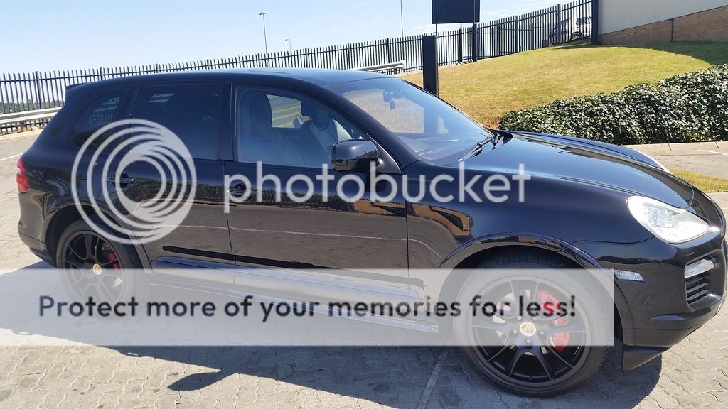

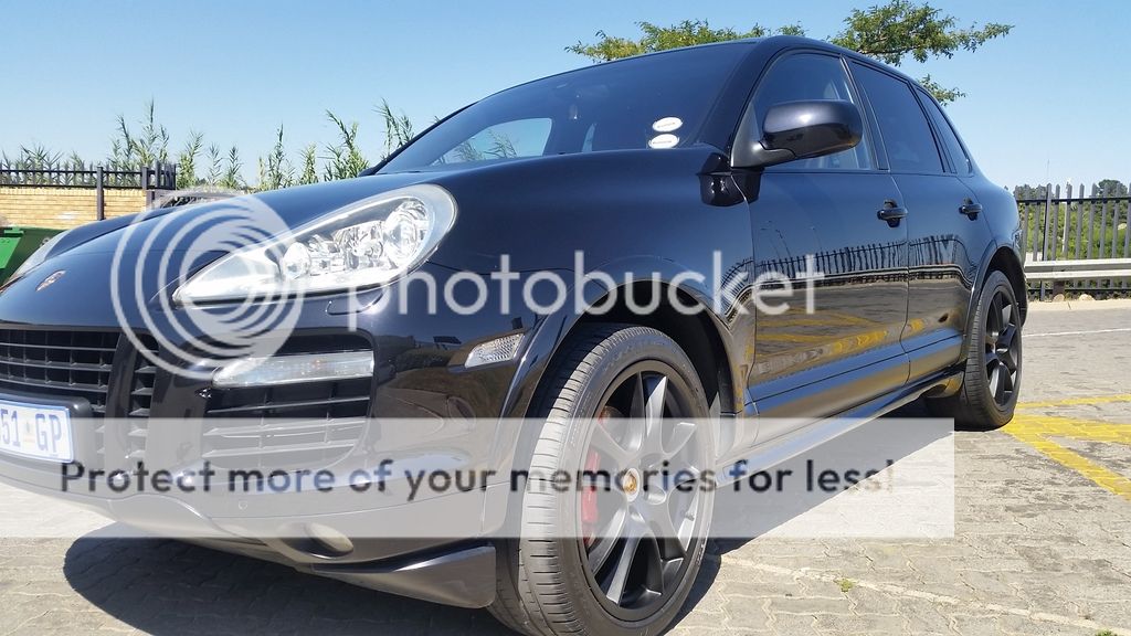

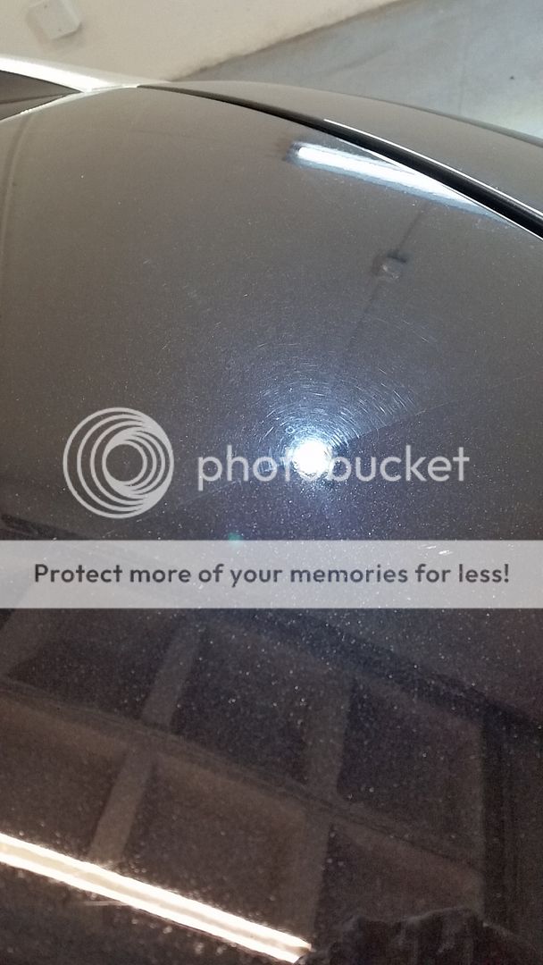

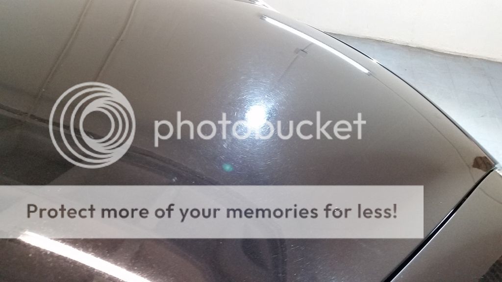

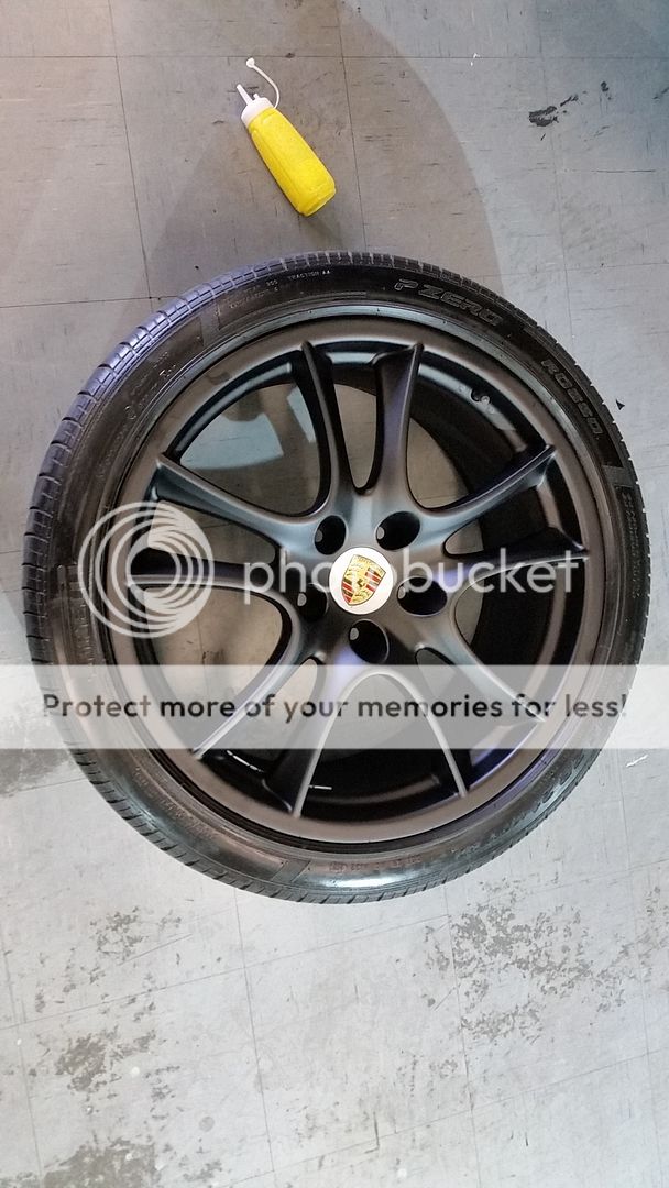

We really had our work cut out for us on this one. The car had some serious damage to the paint. It looked dull and had LOTS of swirls and RIDS. The owner purchased this car with the intention of selling it so the directive was to get it looking as good as we could. While it was with us he also requested for us to get the rims refurbished as he did not want to have to take the car somewhere else so we arranged that for him as well.

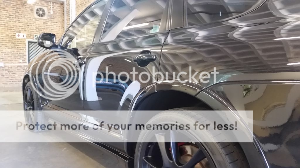

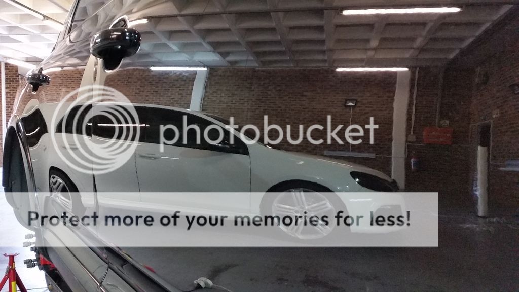

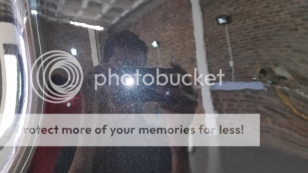

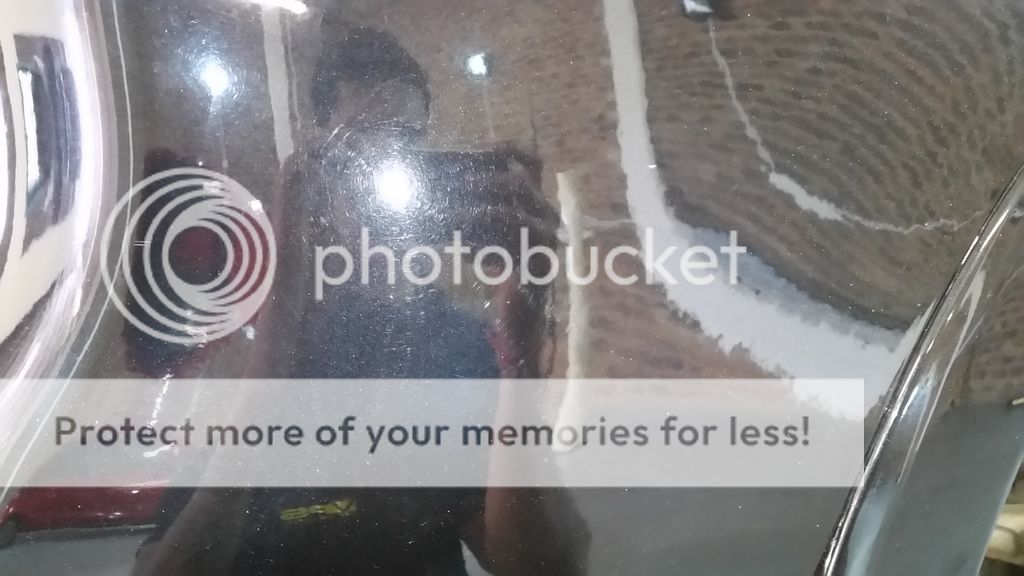

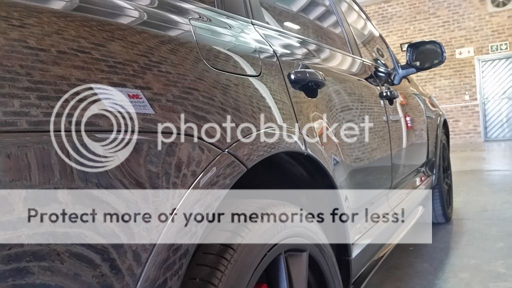

The entire car was washed and decontaminated using AF products. The paint was corrected using Scholl S3 on microfiber pad and then refined using Scholl S30 on a polishing pad. A layer of AF Essence wax was then applied.
Pics:
Before:
50:50:
Before:
After:
Refurbished wheel:
Reflections/Afters:
