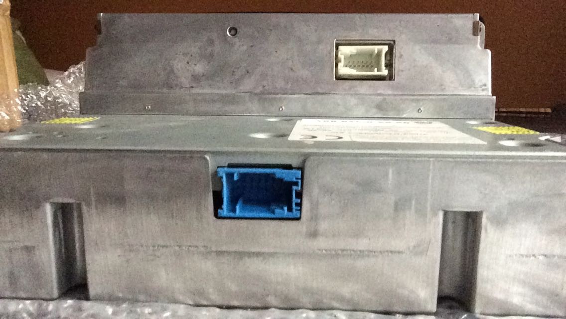

I''m from Indonesia, I have BMW 330Ci 2000 (E46) convertible VIN EH92997. I already bought Radio Cassette Navigation from Ebay, to replafe my old radio cassette (not CD )But I have some problem to replace it.
1. The input connector to new Radio Cassette different with the old one.

The new radio cassette and cable input.

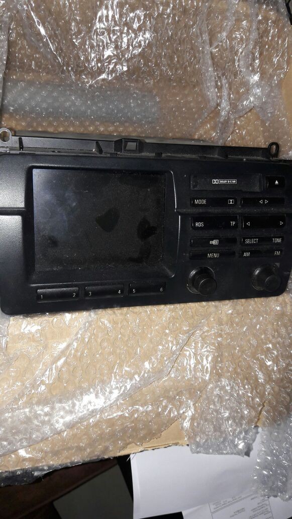

2. Inline image
My old radio cassette.
Could you inform, what kind cable harness can be use to connect to my new radio cassttee?
2. What is the NAV system can active?
3. What is the CD charger also can active?

New radio Nav and connector input
Old radio cassette

Thats the old style sat nav for these cars , I would suggest if you are going down this path , to get the newer widescreen sat nav . Its much better .
In order to fit that unit that you have or the newer unit, you would need the complete wiring system and modules for the radio , you only have the one part , there are a few modules that go with it , DVD drive , TV module , Radio module etc . And the wiring replaces your cars existing wiring , to each door as well .
Once you have those , everything wires up from the back to the front of the car then you would see the correct plug in for your radio as I believe the plug that goes into the radio head comes from one of the modules . You will also need the Sat Nav aerial as well .
The standard radio plug will not fit into that and there's no way as far as I know to modify it to fit .... Maybe there is but I dont know of a way .

accidentally i bought this radio monitor to keep original and as we know, wide screen (double din) type as common head unit now, and also in my bimber comunity no one has used this type :). Thats whay I intersted to have this one. Btw, if many parts should I provide again to fiit it, I Have to think to find the new models such as Dynavin or stay with the old one.
Thank you for your advise..
