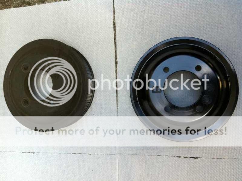

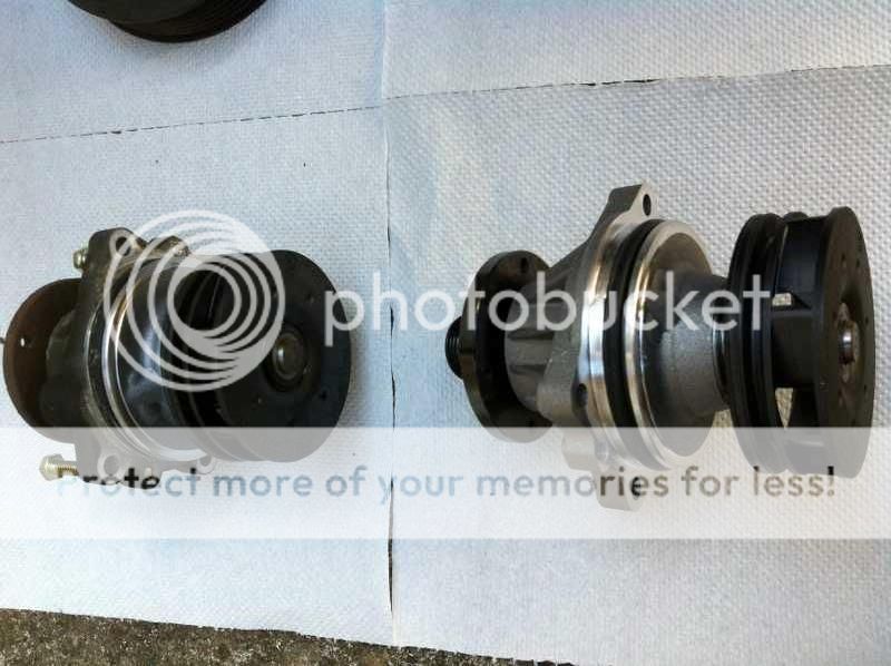

3) Changed Pulleys, Water Pump and Thermostat. Glad I did that. Power Steering Pulley shows fine cracks. Wouldn't know when that would fail.

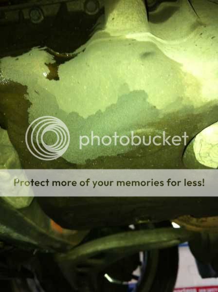

6) To be done after Oil Filter Housing Gasket - a fair amount of oil is leaking out.

3) Changed Pulleys, Water Pump, Thermostat.
Cracked Power Steering Pulley!
Changed the Water Pump. Old one is the original from the factory from what I can tell by the date on the part.

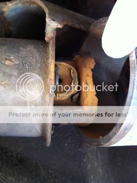

Perished Rear Diff Mount!

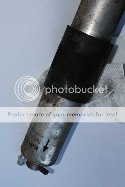

5) Did Fuel Filter yesterday. Quite a straight forward thing, just took my time to make sure it was done correctly. Again, the filter looked like the original part. Date stamp from 2002! Could have been changed, and the part replaced with one made previously. The clamps seem to be single use only - you can't tighten them back up. This is slightly worrying - service book stamped twice for this to be changed and current mileage is around 278 000 kms!

Fuel Filter changed on saturday:

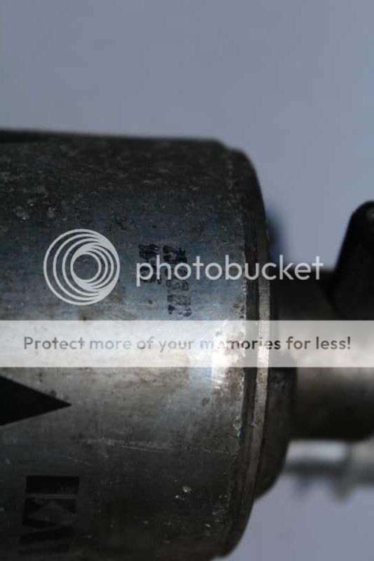

Fuel Filter produced March 2002! Pretty sure this is the exact same Filter as fitted at the factory.

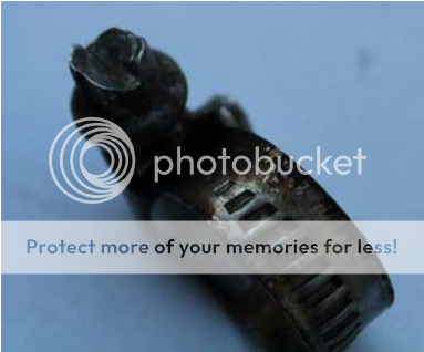

One of the Clamps from the Fuel Filter Lines. Note, this appears designed not to be reused.

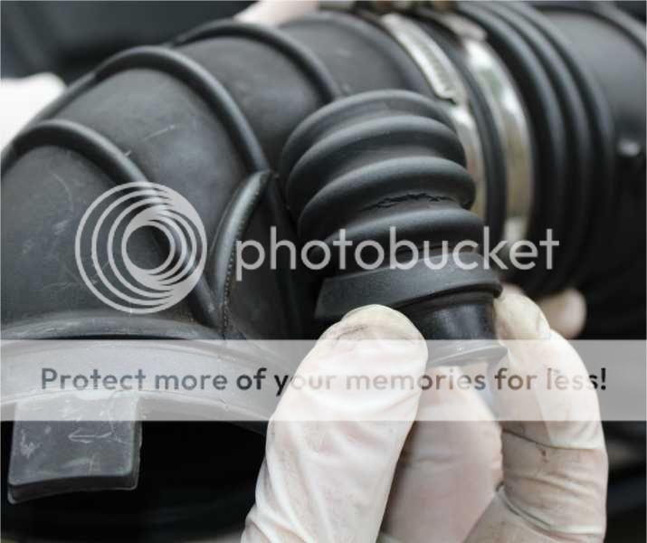

And finally, Perished Intake Boot that I replaced recently:

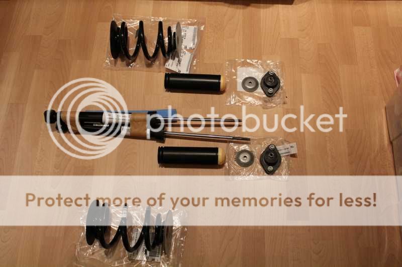

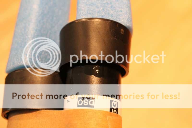

1) Bought a few suspension bits: Rear Dampers and Springs. Installed them myself. A relatively straight forward process.
Note! Always check your parts over. One of the Rear Dampers was leaking - I can only imagine what 30 000 kms would do to it. Let them know and no fuss to get a new part. :=):

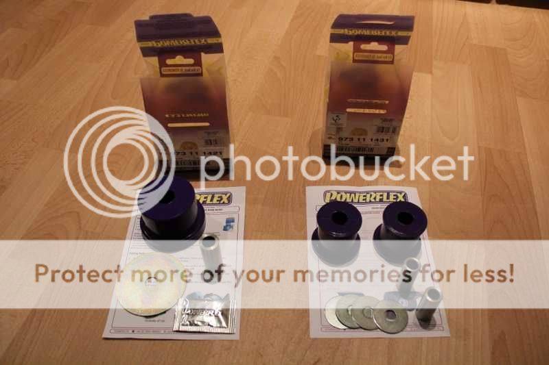

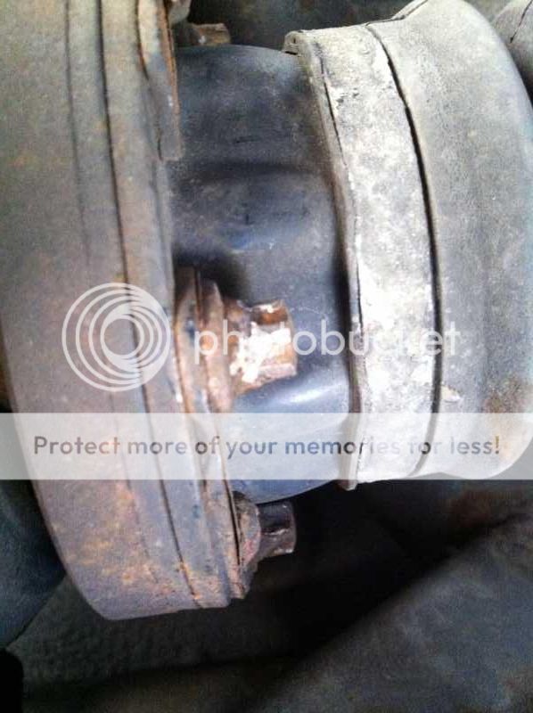

4) Differential Bushes. I had quite a tough time getting the Diff Bushes out. A combination of Rust, rounded off bolts and lack of time for the upcoming trip "forced" me to send in the car to get a couple of things done.
Power Flex Differential Bushes
Rounded off Torx Bolt in side shaft

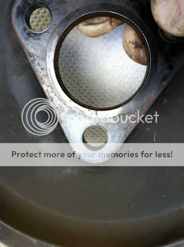

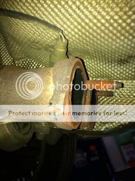

Exhaust manifold studs were in pretty bad shape and were then removed.

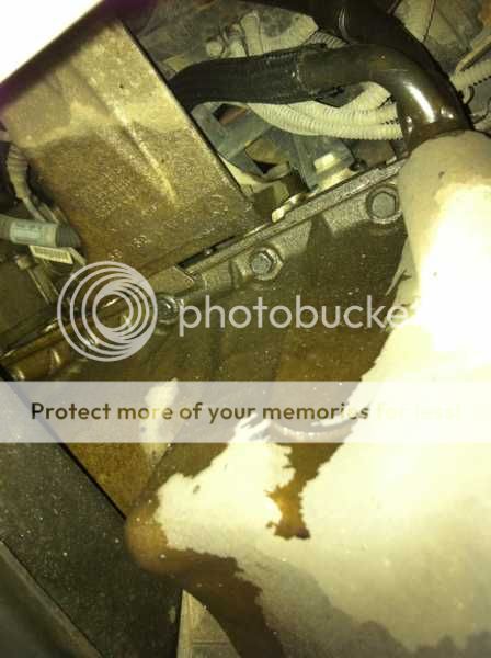

The extent of the Oil Filter Housing Leak was brought home a bit stronger. So this will be the focus of the next DIY.
