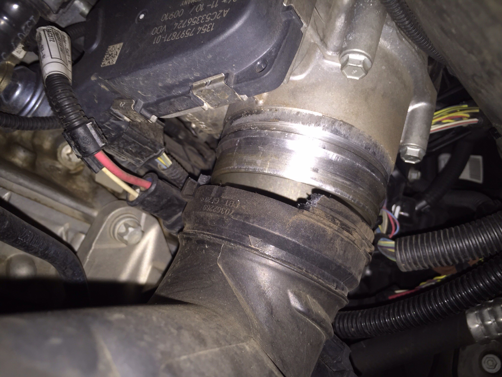

on my way home from the mall around the corner I pull away at a robot, hear a thud and suddenly no power. Accelerator pedal hardly responsive.
Then this error pops up
Drive it home gently as suggested, have a look under the hood once I get home and find this:
Anyone else experienced this?
SR20_Guy
It's an '11 e92 335i with n55
Boost pipe seems like it's given up. I'm sure there would have been a clamp on there right. Wonder where it's gone...

Sure, but why would this happen on a stock motor with stock boost? Perhaps previous owner had a jb4 :hammerhead::thumbdo:
S1NGH 911
This isn't common on the N55....
dvst8
Was more common in tue n54 but has occured on n55's as well.
More common on tuned cars but does also occur on stock cars. If your car is out of plan, look at replacing with the ER ones.
:coolShake:
FiRi@Rennzport
This ain't a stress bud. If you on plan get bmw to send a flat bed and get a new one.
If not as six has suggested just get an upgrade. There is no clamp to hold onto the intake manifold, but there is clip that hold it in place and I don't see yours there.

It's a relief to hear about non tuned cars for sure. I looked a bit deeper last night and spotted the circlip and the rubber o-ring laying on the splash guard. Kinda refitted it all but obviously it doesn't secure to the tb. Car is still drivable out of boost but it's not very happy naturally. Some fluctuating idle etc as well.
Trying to get a booking with bmw but with this free holiday car checkups they are so full and no courtesy cars available.
Agreed it's a fairly simple problem and I'm relieved it will be an easy fix.
